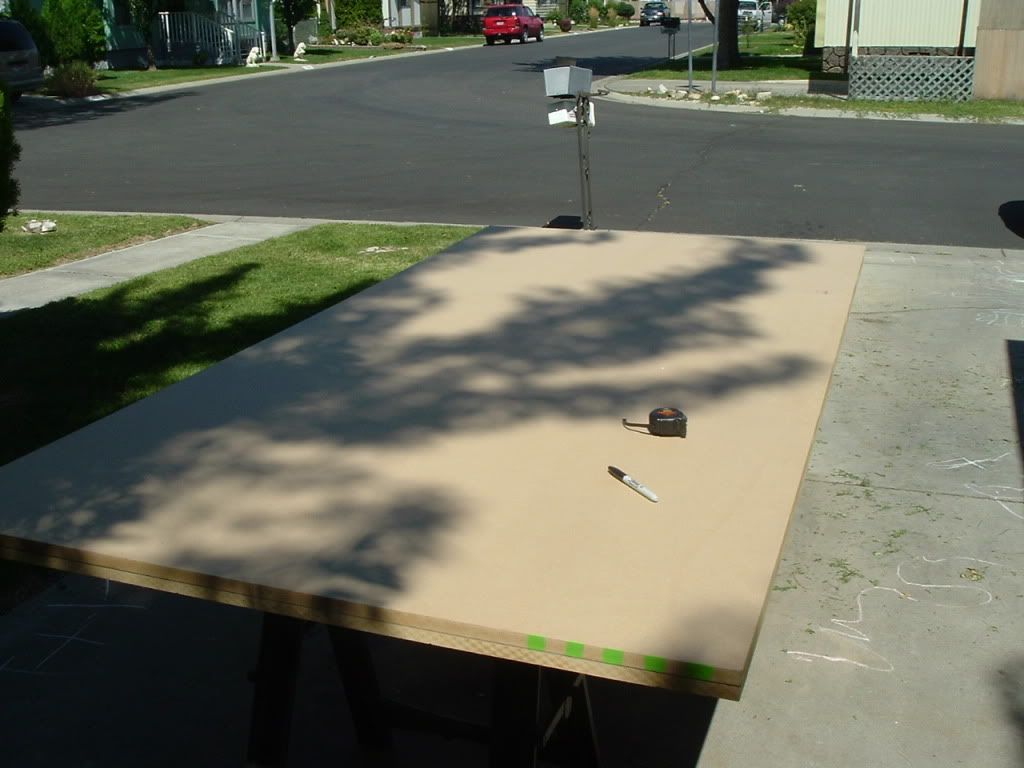

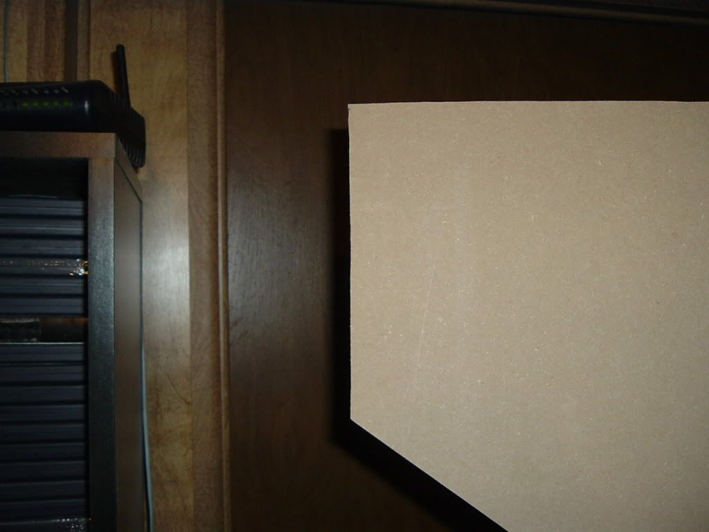

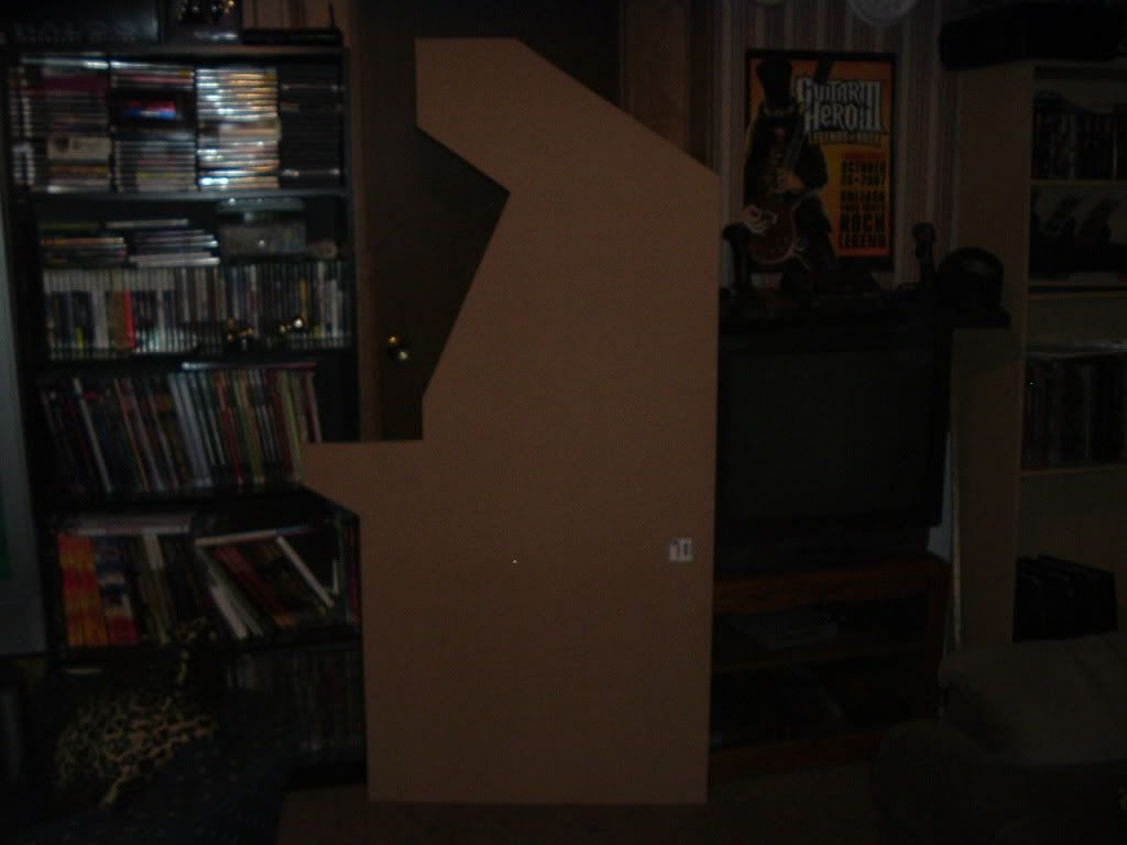

Ok, here I go. I've been lurking around this site and others for months now. I finally acquired my wood for my first cabinet! I can see this will be a longer term build though due to not having a lot of extra money to throw at this build. But for a first day I did get the sides cut. I'm feeling abit hot, but mostly very excited^^
Anyways....to the PICS!!
MDF is sooo much better when it's free! 3/4" btw
It really looks like the sides of a cab. WOOT!
Inside my house and a bit more vertical.
Side note, how can I round these corners (I know to clamp both cab. sides together) so they look even?

how to round the corners?
have you got a router or can you borrow one?
clamp both sides together,mark how round you want it and use a flush trim bit.

Yeah I have burrowed a router, I was just a little gun-shy on trying it lol. Well time to give it  go!

I would practice on some scrap material before you let loose on your cab. You wouldn't want to mess up your hard work.
In regards to putting the radii on I find its best to make a template and then use a flush trim bit to follow the profile. For a radius you just need something round to follow. You could saw/file a radius on a bit of scrap material and then screw/stick that onto your sides corners and then use your flush trim bit.
For perfect circles/radii, especially larger ones I make templates on a lathe. Obviously you may not have access to one but another thing you can do is to use something like a tin can. They come in many different diameters and you should be able to find something to suit your needs. If you cut the top section of the can away leaving the base and about 1/2" of the side you should be able to screw this to your cab (or to a scrap piece to make a template) and then follow the cans side with the routers bearing.
Also keep in mind when routing you want to remove as much material before hand before using the router, especially on thicker material. 3mm (1/8") is more than enough.

Wow I had not thought of the template idea. Thanks very much^^

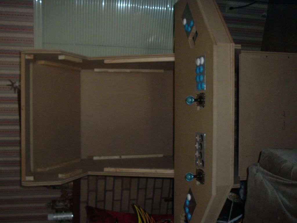

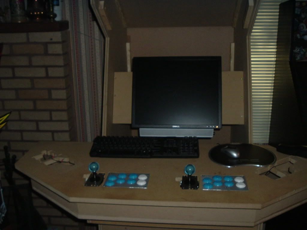

Ok, sorry for not posting for quite some time, But I have loads of pics. I have been working hard on this project and I think its coming out pretty good so far^^

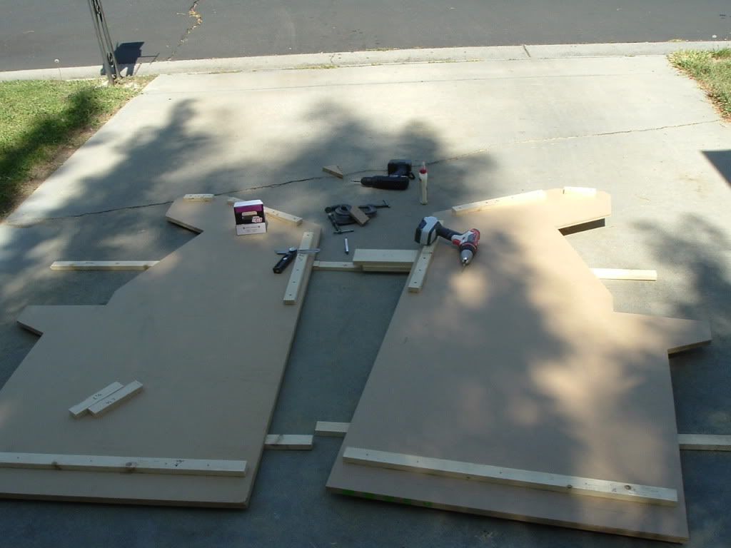

The same day I cut out the sides I manged to get the supports attached.
It was a mad dash to get the thing assembled before nightfall
CP time

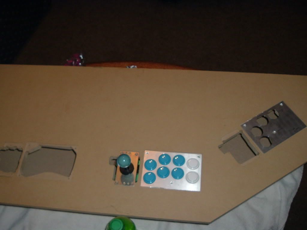

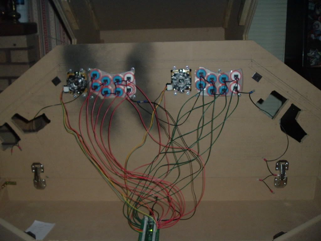

ok, now for some explanation and a warning.... First this is not the CP top I'm using. I made a grave error in measuring out where the controls were to be. I did this at around 3am......don't ever make measurements when tired AND then trust those measurements the next day without even double checking them before cutting >.> :banghead:
anyways.....

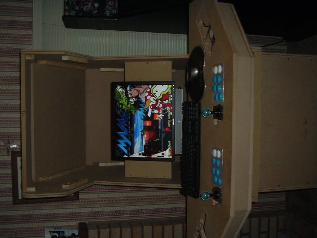

A week later, some hardware and a bit of wire later
love these joysticks and buttons by the way. Sanwa JLF sticks and Sanwa buttons

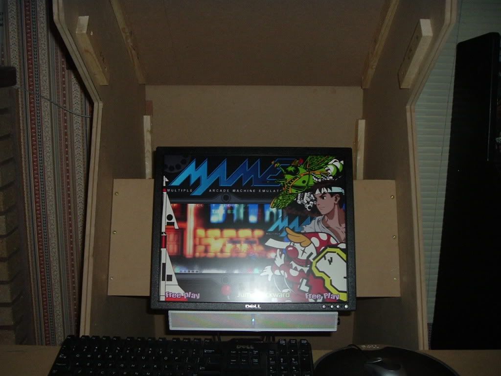

Here we go, working fine as long as I manually start an emulator or mame.

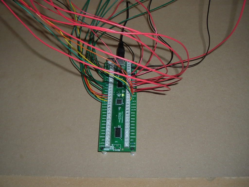

Here is whats under the CP at the moment. I will tie up, and clean up the wiring mess when I get the rest of my buttons, joysticks, and T-molding. I really like how the blind nuts and plastic tubing made perfect stand-offs for my encoder^^
Anyways thats all for now, next up is finding a speaker system and start buttons........tons to go^^
Oh and by the way I LOVE Hyperspin.....and I HATE it as well.........So hard to get going. I'm playing hell trying to get it going lol. But luckily I have a couple of friends that are trying to help me out with it.
cheers!  :cheers:

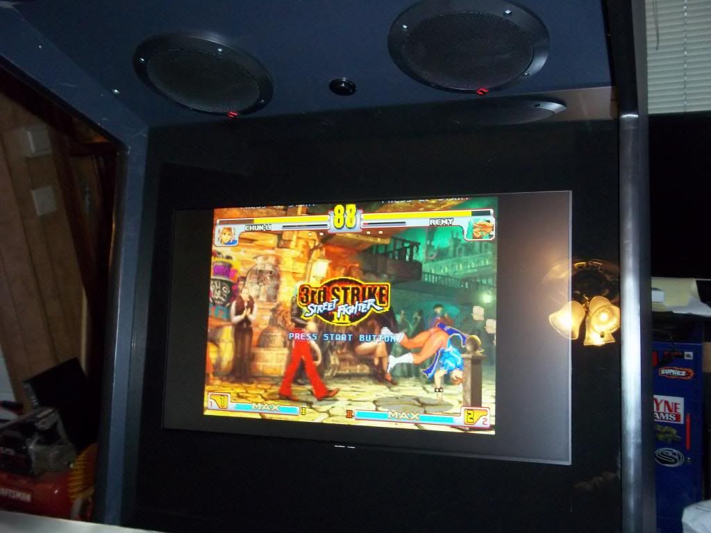

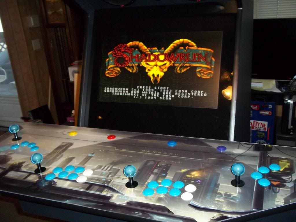

Wow this was a long time coming. I had to put this on hold as my house and life had come down around my ears for a while. But I never really left this forum. I would come here about every other day for the past 2 years just to get my fix. Anyways I've been really busy for around 2 months now and I'm excited to say that my cab is about finished!!
On to the pics!!
and
more
more to come, as it's not done as ya can tell^^
I had to get the thing painted and T-molding on it before Friday (Tomorrow) as I am going to have it at a local convention so I can run it through its paces.
and yes.......I hate to have to bring it there without a Marquee....it's killing me, but it's for a good cause lol.  :D
