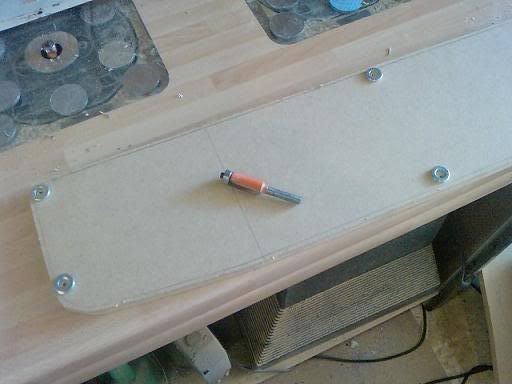

I've started work on the replacement CP for the cab on the left. I'm going to use 3mm acrylic but for a start I've been working on a CP template to use to route the acrylic.
I stripped the CP and traced the outline on some 12mm MDF:
I jigsawed the profile out leaving 3mm or so to clean up with the router. As the metal CP is so thin I used some washers to raise it slightly so it would run along the bearing and allow the cutters flutes to clear the top of the MDF so all of the material was removed:
Then it was just a case of trimming the excess on my router table:
I've not finished the router table as yet but you can see the top panel swings up to allow easy changing of cutters and adjusting the cutting height. I need to mount two lock arms I've made for it to keep the top panel elevated but a tool box works for now  :D
Pic of the template after cleaning it up a little:
Then just a test fit on the cab:
Not too shabby if I do say so myself :)
I need to get some black 3mm acrylic to continue with the CP now.

I used the MDF template I made to route out a piece of black 3mm acrylic to make a new CP:
Although its a perfect fit it sits just slightly too high so I'm going to get a CP CNC milled from 2mm aluminium.
You can see the CP I am going to make here. I'm going to have RGB joysticks, RGB lit buttons and RGB lit arrows around each joystick. I seem to amassed eight LED Wiz's so I may as well put three to good use.

The black acrylic I ordered was six 300x300x10mm sheets. I needed to remove the excess material before template routing the rings. To do this I used the circle jig I made based of Javs design/how to.
Its basically the same as Javs, I just screwed it together instead of gluing it and made a knurled knob to fix the sliding block. I also added another t-nut with a long M6 bolt which acts as the pivot.
I marked the template out and drilled a 6mm center hole and countersunk holes in the corners to fix the material to my work bench.
In the end I attached the material to a scrap piece of MDF as the two surfaces of the work bench are not parallel and it was causing the acrylic to bend. It was then just a case of setting the cutting radii and cutting the rings out.
Just a safety reminder here, I had one of the bits break on me as I was routing. Always wear eye protection guys!
Pic of the routed out pieces:
Now I just need to attach the pieces to the template and route off the excess material. I have ordered some more flush trim bits which should be here tomorrow.
