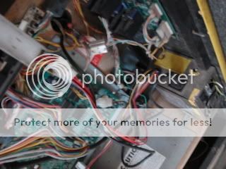

rangerfreak1
  • Posts: 6
  • Last login:September 04, 2008, 06:01:32 am
Re: how do i convert my old arcade hard drive to a usb drive
« Reply #6 on: August 30, 2008, 11:10:38 am »
what about my rush the rock power supply that looks like this.thank you for your time and have a nice day
SirPeale
  • Green Mountain Man
  • Posts: 12963
« Reply #7 on: August 30, 2008, 11:26:11 am »
Check where your original hard drive plugs in.  You'll need an adapter to get the CF adapter powered up.
http://www.pacificgeek.com/product.asp?ID=42714&C=202&S=-1
This shows the cable.  I looked for just the cable by itself, but didn't come up with it in a two minute search.  I know it's out there, but I didn't search too hard.
