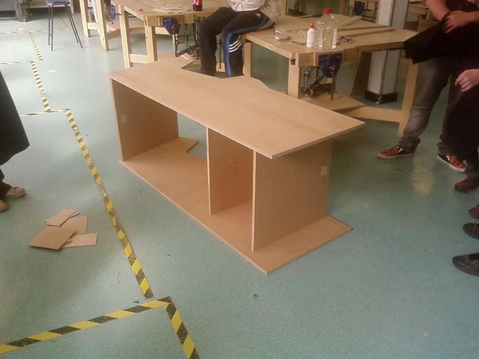

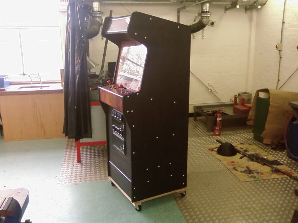

« Reply #23 on: March 19, 2008, 03:09:33 pm »
! well after months of thinking and redrawing here is a pic of my side panels finished !
its not the best picture in the world as i took it on my phone but you get the idea !
not bad for a 16 y/o ey !?
looking at that im hoping my 20 screen is gunna fit !  ???

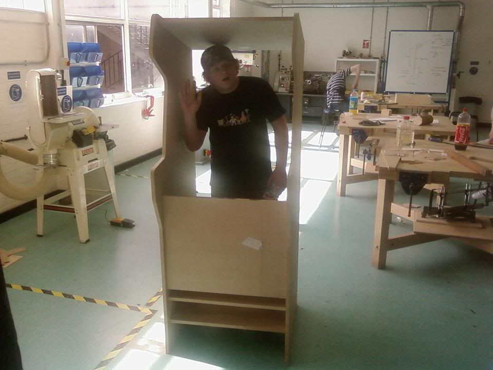

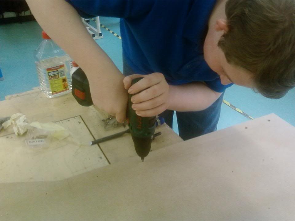

hi
todays update,

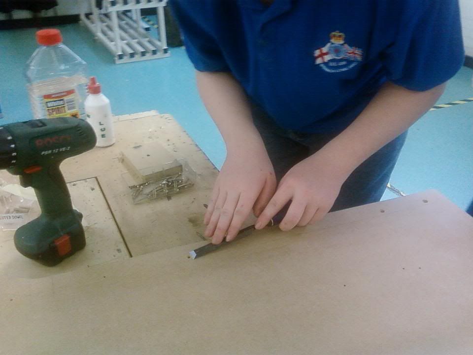

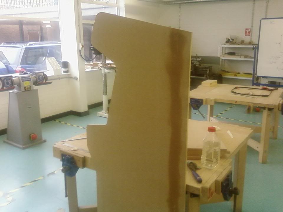

first think to do was to get the side panels apart and after a bit of pushing and shuving and a few wedges here and there they were finaly apart and it was tec groupies 1 - sticky tape 0 ! BUT the tape left a nasty stick residue on the sides so with some white spirit, a cloth and a chisel i got it all off
next thing to do was to countersink the holes for the screw on panels
then as the sides were risen around the countersink i chiseled them smooth
then it was finally after a few hours today and months of sitting about time to put the bits i had together for the first time! luckily it seemed to go ok.
then there was just time to get a quick snap of the thing stood up with joe giving us a wave !
next update wednesday

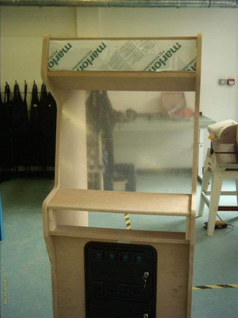

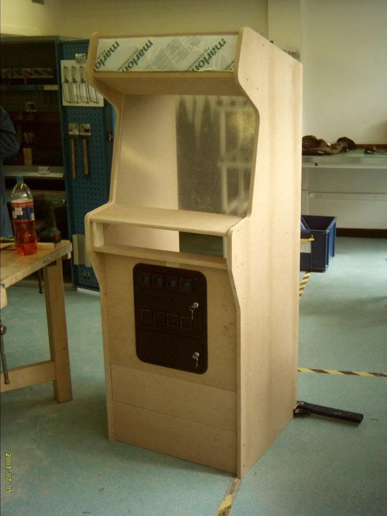

current status.... Well im really getting there now, most of the building is done and its soon onto the painting, with 3 hours officially and any time i can get after school its a race to the finish but i can see it getting closer !
(will upload pics in bout 10 mins photo buckets being anoying).

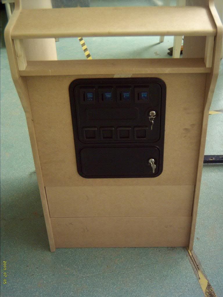

Good work buddy, that coin door looks familiar ;)

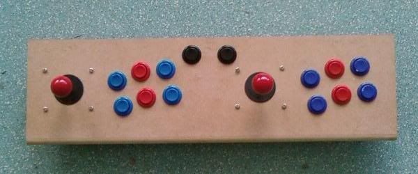

You will need to drill a 28mm (recommended) but you could get away with up to a 30mm hole using a Forster, spade or holesaw (depending what your shop has)
The OD (bezel) of the standard (Happ etc) button is 33.5mm.
If you come up with a design you like then let me know and I  can print you out a full scale 2d model of the CP so you can use it to mark the hole centers etc for drilling.

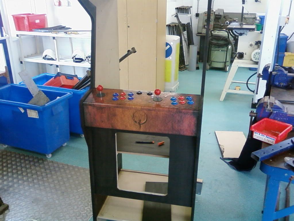

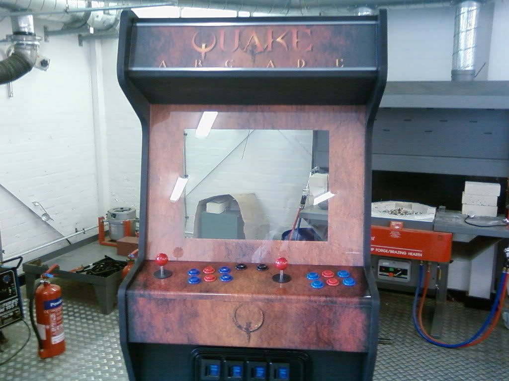

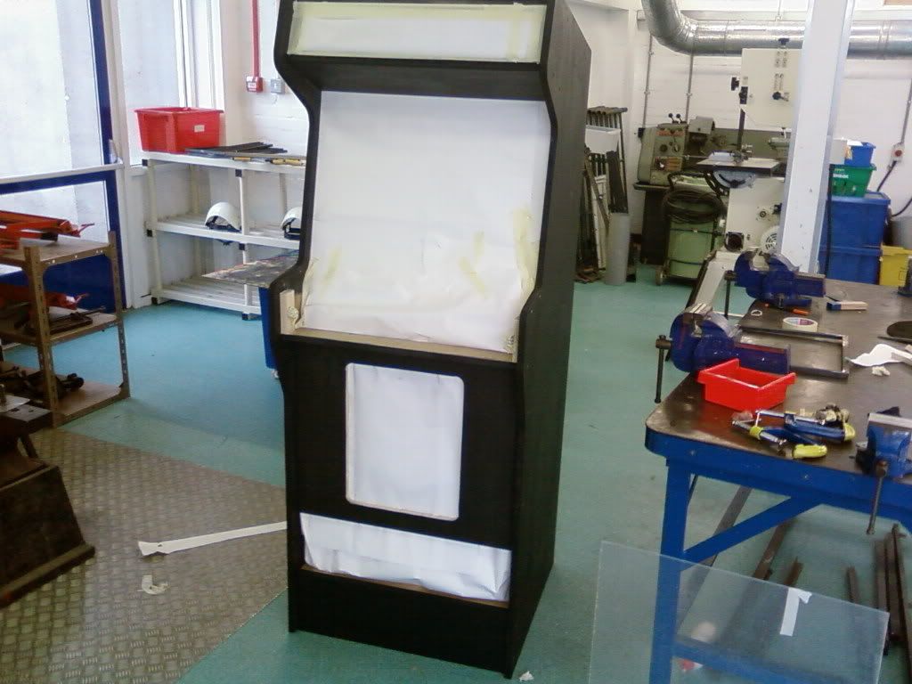

i will keep it short and sweet! don't wanna offend anyone here but i may be bringing a moon patrol shapped cab into the world but not for moon patrol !
got the CP done on thursday
and then on friday night i got it all done with artwork and fitted into the machine
then before i went home friday i had it all masked up ready to spray paint tomorrow (monday)
what does everyone think?
« Last Edit: April 27, 2008, 03:12:24 pm by david656 »

david656
  • Posts: 485
  • Last login:June 01, 2017, 10:06:24 am
  • Big Man!
Re: Moon Patrol cab built from scratch !
« Reply #38 on: April 29, 2008, 01:02:07 pm »

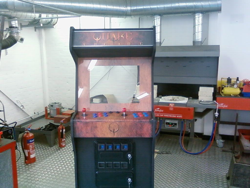

yup ! Quake !! its all matching the CP, the front panel, the bezel and the marquee which when fitted will say 'Quake' and then underneith 'Arcade'
although it will be mostly mame i will try and get the quake games into mameWAH and it gives me a excuse to make another cab and network them !
and before anyone says :-O "thats a console game.... get it right!"  actually for a short time it was a arcade game... check klov for details BUT although the marquee will be very simiar to the original all the artwork is my own compilation.
do people like my artwork used? i will maybe upload it all for people to see
« Last Edit: April 29, 2008, 01:04:38 pm by david656 »

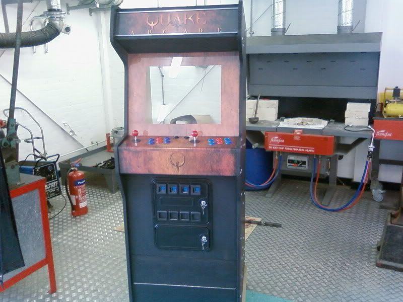

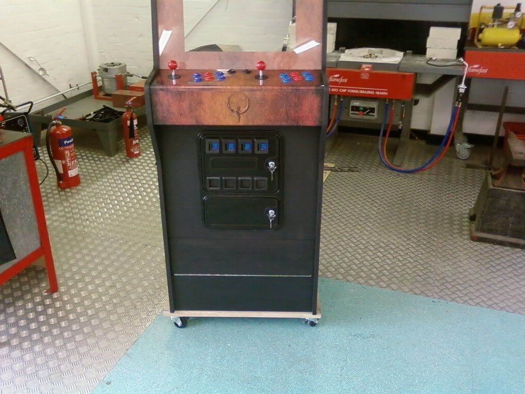

the machine is finito ! DONE !!!
