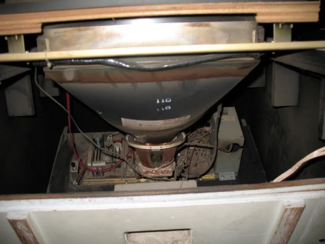

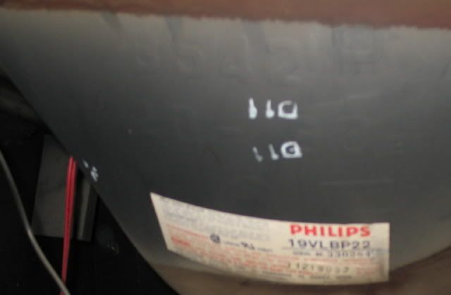

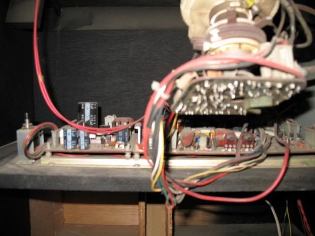

I just recieved a Magical Spot cabinet from Universal, inside the cabinet I have what I believe is the stock monitor and a Mr. Do board.  The Monitor inside has a sticker on it with the number 19VLBP22 (I know model numbers are rarely on the tube, but I can't read anything on the boards.)  The board for the monitor appears to actually consist of 4 boards and one box.  Here are some pictures of what I am talking about.
This is a closeup of the sticker w/ the number on it.
This is a shot of the tube w/ the boards in the background.
This is a shot of the edge of the boards, because of their location it is very difficult to get  a shot of the face of the boards, they are also too dusty to read much of anything on them.
I have found knobs for "Bright", "V-hold", "H-hold", "V-Pos", "H-Pos" but I can't find a "V-size" and the image is about 12 pixels too tall for the screen.

1. What's this monitor/how can I find out?
2. What should I try to adjust the size?
3. What should I try to fix the "faded" area?
4. What should I try to fix the flutter?
5. What options do you suggest for hooking this to a computer?

Still on the search for info.  I pulled the chassis out of the cabinet, dusted it off, and took some better pictures but the camera is off with my wife for the day so I can't upload them.  In searching the links in the ***...before you post*** thread I found 1 picture that appears to be the chassis I have.  It is the one ID'd as a "Kagi" but there is no more info about it.  Searching seems to be getting nowhere, I did find some reference to the monitor being incorrectly ID'd, but can't find any good info with the new name either.  I would like to do a cap kit and if the examples in the recent "what does a cap kit fix" thread are correct then I expect I will have a much improved monitor.  I don't however know where to find such a cap kit for this monitor since I don't yet have a positive ID.  If I can't ID it can I replace the caps by searching out caps to closely match the ones on the board?  Is there some sort of standard for labeling them that I should be able to decipher and order new ones.  Failing all of that can I run this tube w/ a different chassis?  There is NO burn in whatsoever and I have great hopes for making this monitor behave again.

This is a picture of the boards w/ wires
Here's the boards w/o wires for a better view
