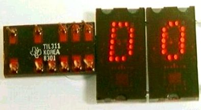

I have my control panel wired for 2 players, 6 buttons each tied to the same inputs (RGB LEDs, 3 ports per button) on a LEDWiz LED controller. Both joysticks are Williams 49 ways going to seperate GPWiz-49's. Both Player 1 & 2 start have RGB LEDs wried seperately to the LEDWiz. That left me with 8 ports free for other things. I was thinking of Joystick mode indicators but 1. I don't have any more room on my CP to put LEDs in 8 directions and 2. I want to indicate 49 way modes (DEFINATELY don't have room for 49 LEDs!). ANyways, I was thinking of 7 segment LEDs when I ran across a cool little chip designed way back in 1972. The TIL311.
It has a dot matrix LED display that shows HEX 0-F and takes 4 inputs to select a number. It also has a really nice ruby red case that's reminiscent of 1970's LED watches. Almost perfect for the 8 ports left over on my LEDWiz. I say almost because there's no V or H for the 2 way modes but there are good alternatives that make sense. Finding a chip made back in 1972 isn't always easy and the TIL311 was no different, I found them at Mouser for $26 each. Ouch! However, in my search, I also found them under a different number, still made by TI in the late 90's! The DIS1417 is the same chip. I found the DIS1417 on eBay from the seller westfloridacomponents for $2.50 each and $2.65 shipping. He usually lists them in lots of 4 for $9.99 but you can email him for whatever quamtity you want. Now this is much better. $12 I can handle. FWIW, he sent them first class mail with delivery confirmation and I had them in 2 days. Not bad FL to AZ. Here's another picture for size reference:
I plan on using 2 next to each other on a small circuit board along with an inverter (74LS04) and whatever glue components are needed and will mount them above each joystick on a vertical portion of my control panel (It's a Namco Cyberlead Japanese sitdown). There's a nice glass covered instruction card holder that I will cut a chunk out of and mount these boards so the chips stick through and are covered by glass. I can then use the following table for displaying the modes:

Now I have this all worked out in my head with the exception of a couple of small details that I haven't tested yet. I need to see what the LEDWiz puts out when the output of a port is not active. I expect it puts out nothing so I may have to use some sort of pull up to prevent false signals. The TIL311 has a built in latch that goes low to trigger then input of new data so I'll have to figure out where to pull that in from. Maybe take the signals into an 4 input OR gate and use it to strobe the data in a little delayed from the inputs. I want to avoid getting too complicated. I know all of this could be done with a "simple" microcontroller but that's beyond what I know. At least right now.
Any ideas?? I just wanted to share cause I think it's a pretty cool little chip and it kind of matches with the cabinet's LED marquee and of course all of the LED lit buttons. Lastly, Here's a pic of them lit up:
