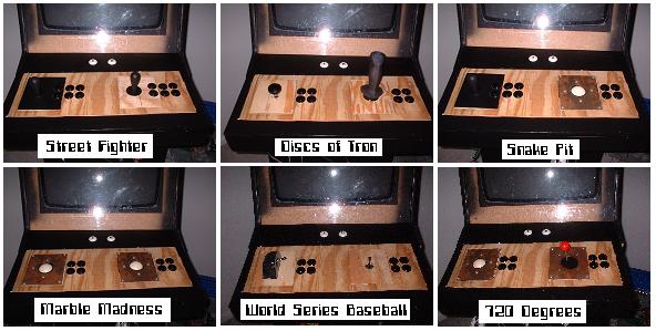

I just finished converting to a modular "piece" panel over the weekend inspired by a thread I saw here several weeks ago.  I had a 24" wide single "classic" control panel that I replaced with a fully modular "piece" panel.  The panels are interchangable down to 2" wide spacers.
 Joysticks (4 and 8 way) and spinner are mounted on 4" wide panels, a set of 6 buttons on 6" wide panels, a 3" trackball on a 8" wide panel and so on.  I also have 2", 4", 6" and 8" spacer panels along with different joystick types so I can make pretty much any layout you can imagine within the 24" wide original cabinet.
  My "regular" fighter layout has two joysticks, two 6-button panels and either a spinner or 4-way joystick panel in the middle.  However you can swap it any way you want (joysticks on the right, tron style, dual joysticks for tank games, etc...) by just moving the pieces and spacers around on the 24" rails.
  I used RJ45 panels and a USB hub under the panel to connect individual panels and it works great.  Each joystick or button panel occupies one RJ45 slot and I duplicated some ports so I can connect (for instance) two joystick panels to the same port on the IPAC.  You can hot swap the controls - both USB and RJ45 connectors.
   I also came up with a pretty innovative way to mount and lock the panels so there is nothing visible from the top of the panel and also each panel can be swapped with no tools in a few seconds.
  It was a lot of work to make all of the panels and wire them- but the net result is pretty cool.  Something simple like swapping the spinner for a 4-way joystick takes less than 15 seconds since you just pop the old panel up, remove the USB connector, plug in an RJ45 connector and pop the new panel in.  Alternately you can reconfigure the whole panel in just over a minute.   You don't need to buy duplicate controls and its easy to add new ones at will by just mounting it on a blank panel.  Also the cabinet maintains its nice classic 24" wide look - no frankenpanel.  Finally I was able to keep my pinball buttons on the side and front - which I would have had to give up in a rotating panel scheme.
  I'm still finalizing a few of the panels (trackball, top fire joystick) and I have some minor cleanup to do (painting the edge of the panels so the space between them is less obvious).  I'll post some pictures in the next week or two.

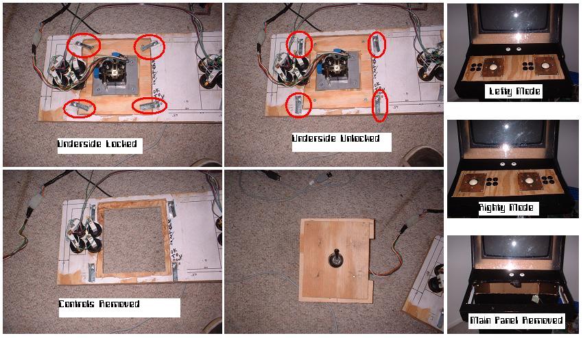

Here's the key:
  The panel slides under the bezel and then locks down on dowels drilled in rails both front and back.  There are holes in the bottom of each panel which match the dowel locations exactly.
  In this picture I propped a joystick panel up on the back dowels/rail and under the bezel showing the position it might be in just prior to inserting it.  You rotate the panel down onto the back dowels which locks the back lip of the panel under the bezel.  The panel also gets set onto matching dowels in the front dowel rail.   You can also see the edge of the two RJ45 wall outlets and my slide out keyboard tray below the panel.
  This gives each panel only one degree of freedom.  All other movement is stopped by the dowels, rails or bezel.  You basically have to pull the panel straight up from the front edge to loosen it at all.
  The only panels you pull up while playing are joysticks - so each of these panels has a roller cabinet latch on the inside front edge.  The other panels don't require a latch.
  The setup is surprisingly robust so far.  Pressing the joystick forward (even very very hard) does not generate enough moment on the cabinet latch to break the seal because you have a 3" arm working to rotate a 11" panel with a latch at the end of it.  You basically have to yank the joystick straight up (i.e. vertically towards your nose - not a normal direction of movement) very hard to break it loose during play.  On the other hand you can easily lift the front edge of the panel up with your hand and overcome the roller latch to swap the panel.
  Just pop the front edge up, wiggle it off the back dowels a bit and then pop the new one in and press the front edge down.  Each panel has one RJ45 or one USB plug (i.e. for trackball or spinner), so there is no real work there - you can hot swap all of the panels - both USB and RJ45.

FYI,
  I just remap my existing layout to play asteroids - I have a six button fighter panel with the extra seventh thumb button for both players.
  The bottom row buttons on the player 1, 2 panels can be mapped to be thrust, fire, rotate and the thumb button on the player 2 panel is hyperspace.  If you do the mapping in the software right then you can duplicate the original button layout very closely without building a separate set of panels.
