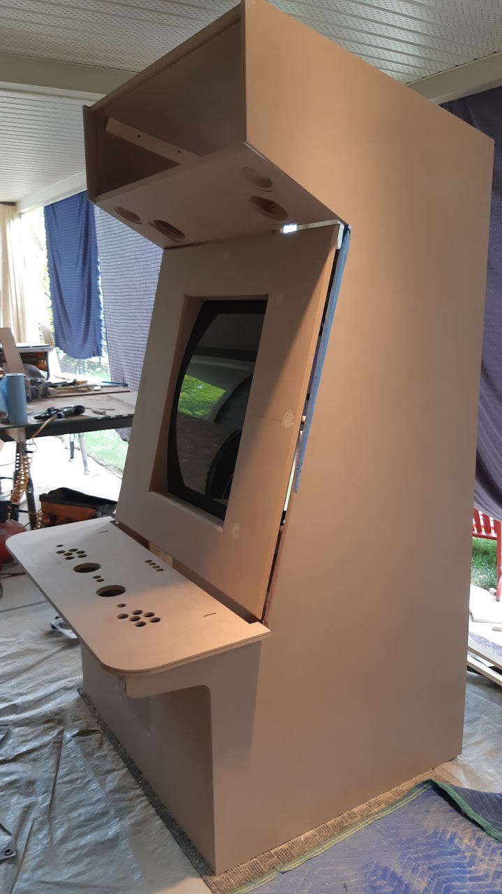

Today was a monumental day, screen was mounted and spins better than I could've imagined, only takes a finger. Only thing left of the initial build is the screen bezel, and installing hinges for the back door. Should be ready for disassembly and then paint by Sunday. Project should be complete within two weeks. I'm amazed how little I've had to deviate from my designs, a couple tiny little adjustments here and there but altogether everything worked out.

Thanks for the kind words. The CRT is the heart of this project, I just don't find myself playing my LCD cabinets ever, and a big reason is because of the LCD.
I'm happy to say the initial build is 99% complete at this point, the only thing left is to mount the back service door, hinges are already installed just need to clip on and adjust. Wood filler and sand the front bezel so it looks like one piece, and change up my marquee mounting as I wasn't happy with how aluminum angle looked, I'm going to inset the diffuser and just use t-molding. I'll take some photos once I get to that as I need to disassemble quite a bit before I can work on it.

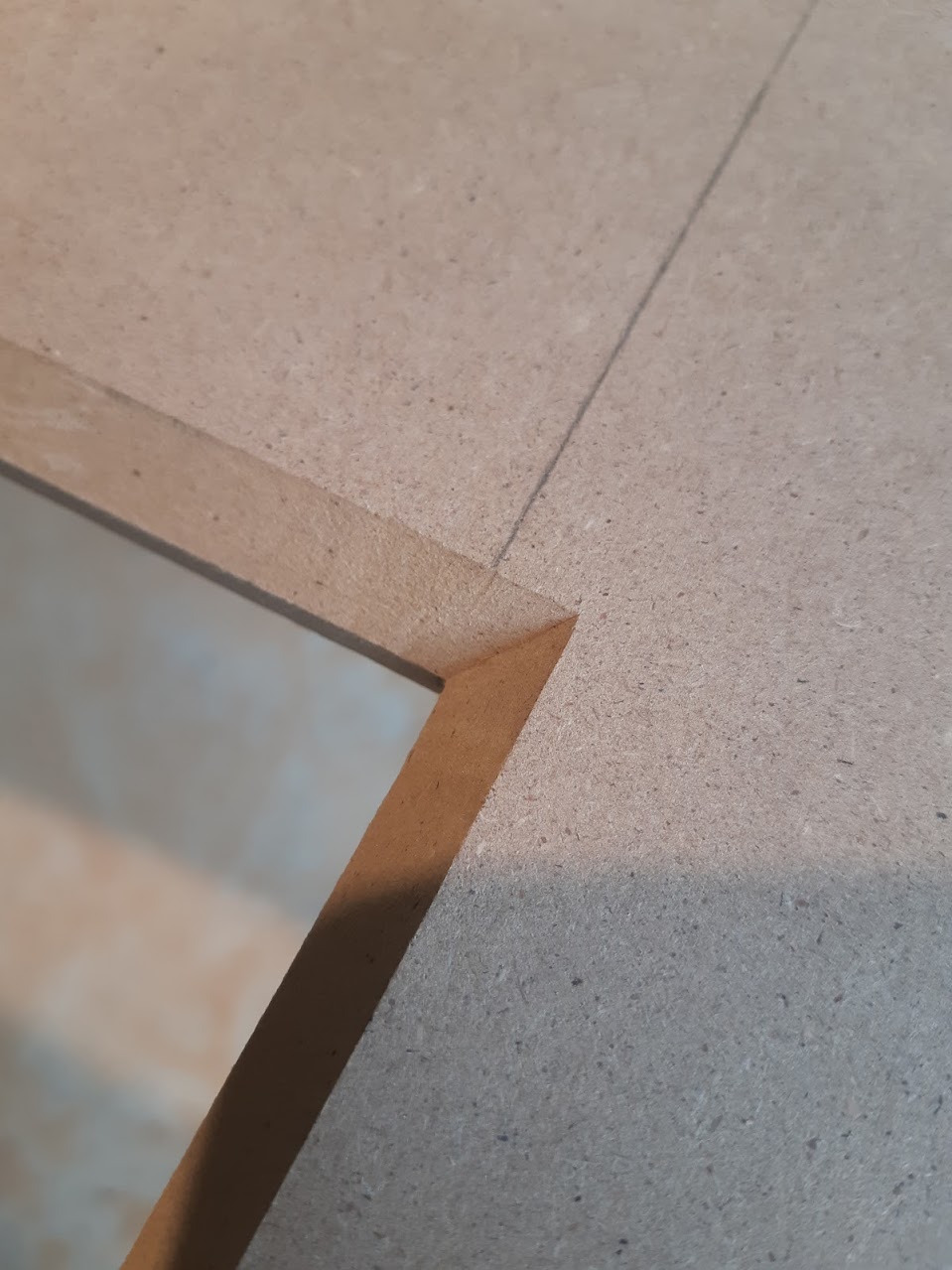

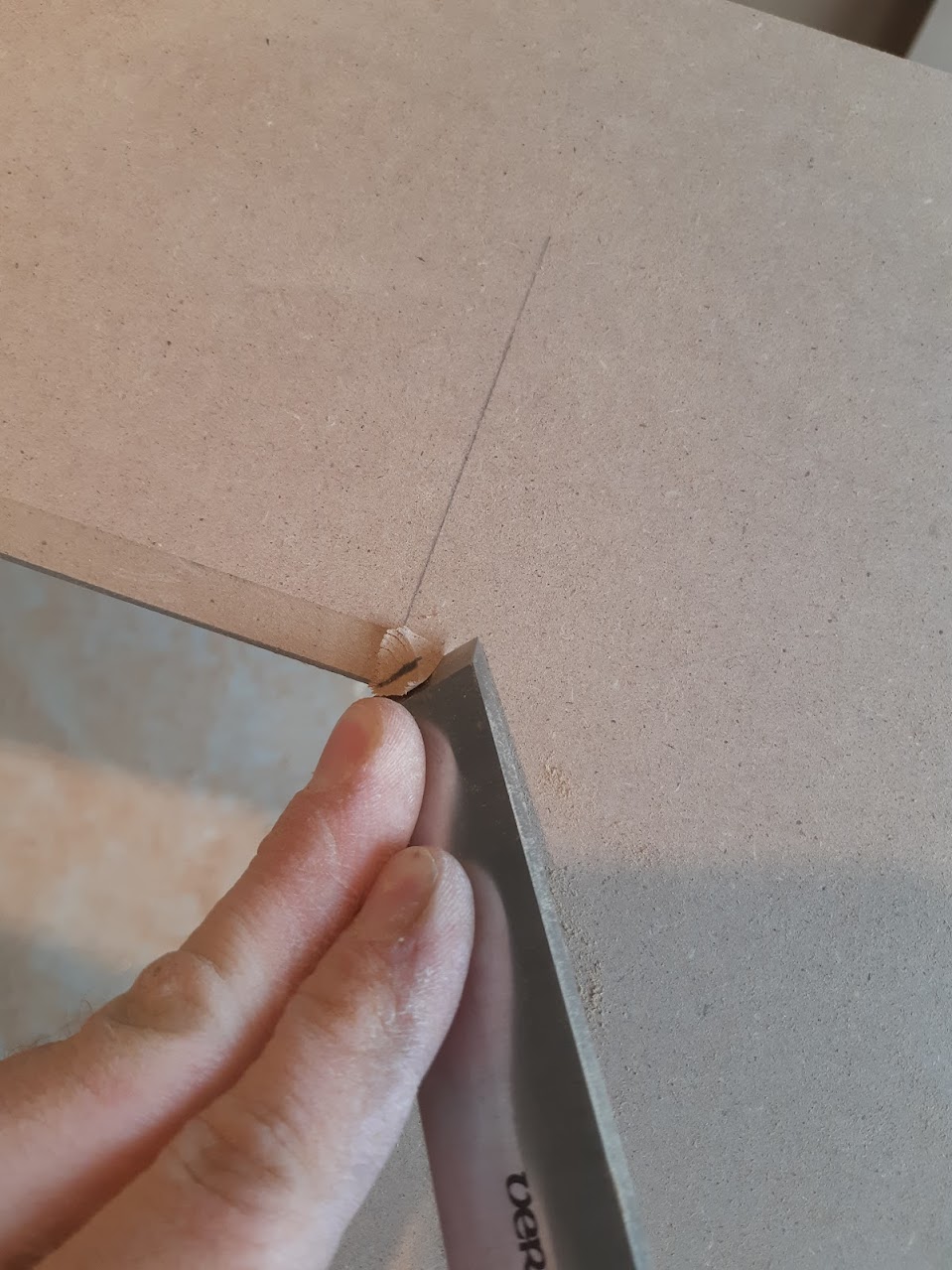

Put my stupidly expensive flushing chisel to use... Glad I spent the money for all the inside corners on this thing, probably the most expensive tool I bought that I didn't already own.

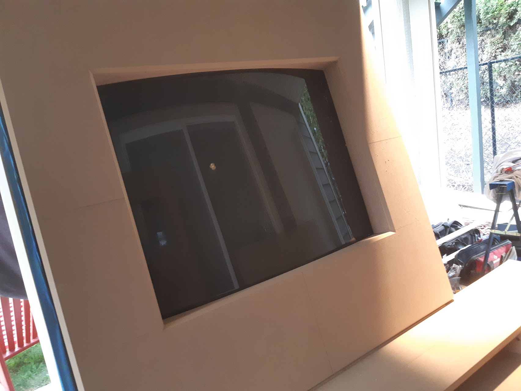

The bezel turned out decent, it's not perfect by any means, getting the radius for the screen was incredibly difficult, and took an entire day just for those 4 pieces. I ended up murdering the original TV shell which made me a bit sad, and used it to draw out the radius, then used a jigsaw and sanded. In hindsight I'd probably have attempted a 3d scan and made a router template, but I have doubts about the accuracy of that without proper scanning equipment.
Spins perfect with 1 finger. Mounted the control panel with dowels so it can easily be removed. Amazingly I managed to get the screen and bezel within 1mm of center, which was the part I was most worried about with this project. I did add too much gap at the back of the control panel, I only ended up needing about 1cm for clearance and did around an inch. I might put weather stripping brushes to fill that hole, or just leave it. If anyone has any other ideas I'd appreciate them, the screen spins into that gap but only a very small amount, so whatever I filled with would have to be flexible, non abrasive, and return to position.

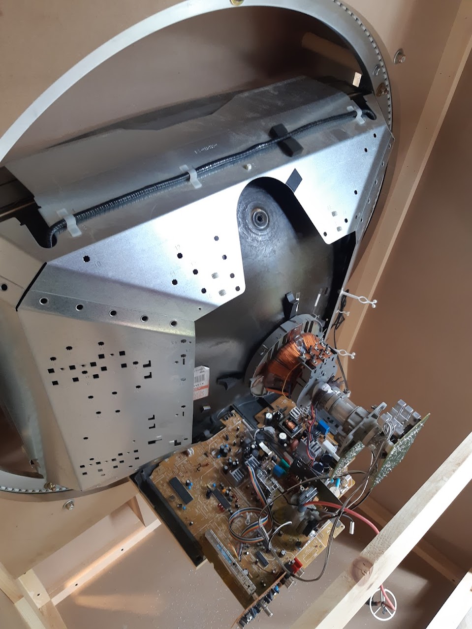

Since I already cut up the original shell I figure I might as well use the original PCB mounts. Makes it easily serviceable and clean. Just enough space for it to spin in any direction. I'll want to block the direction at some point to avoid people spinning and getting the cables tangled and destroying things, but I'll do that after I'm happy with the display calibration. It seems to like spinning left more than right for purity, but this will be much easier to test now than it was just flipping the tube over by hand.
Something I found interesting is that the exact location where I have purity struggles, is where it looks like they tack welded a plate over a seam in the original tube frame at the factory. I'm not sure if this is normal, or why this would have been done over just welding the frame itself. I'm almost thinking this might have been a hacky repair down in the factory for some reason, though it might just be standard. Can't say I've ever noticed on another tube before, and the location made me wonder. Either way I managed to get the purity to an acceptable barely perceptible issue before, I know I'll be able to get it good with enough playing around with magnets. I also ran my degaussing coil over the metal shield while I had it apart, as I suspect it might have gotten magnetized.

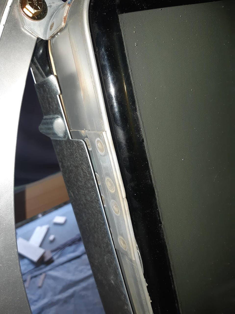

« Reply #25 on: April 30, 2024, 12:19:03 am »
Correct, it's not as aesthetically pleasing this way as the bezel has to sit out a tiny amount, but I wanted it to be as simple as grab the bezel and turn it so that I'm motivated to do it.

Big update day. As the project is now finished outside of adding games and 1 3.5mm-RCA cable that is too short to be cable managed.
Monitor is mounted and cables routed successfully. Used the original PCB mount on some 2x1s and then a 5lb york iron plate to counterbalance so it wouldn't spin on it's own.
Pixelcade marquee and speakers installed, busted off a tab from one of the tweeters but managed to rip out the driver and resolder it without damaging the visible portion of the speaker:
Some simple stoppers at each end of the rotation
As cable managed as I care to do, everything is routed out of the way other than the 1 cable mentioned prior. Once I have that I'll tie everything up a bit better:
Made a 3d printed mount for the amp. Extended the volume pot so I can mount it on the back panel once that goes on:
The screen ended up working out excellent. The mistake with trying to correct purity using magnets was actually putting them on the back of the shield. This worked while running, however as soon as you restarted the TV it would undo your work for some reason. Flipping the magnets to the other side of the shield worked perfect. It now has very good purity on both horizontal and vertical positions. The screen also does not need to be turned off for the degauss circuity to recharge, so long as it's been running for 5ish minutes you can simple turn it off, grab the bezel and spin the whole screen, and turn it back on.
For a front end I'm using big box and just designed a "Confirm Orientation" screen with some graphics which is actually platform selection. I have games separated into vertical and horizontal games in their respective platform. I've then made a fake vertical theme to go along with a modified version of (I forget the name of the theme I modified...................). I ended up doing the vertical theme a bit different since theme videos are always horizontal and I didn't want to remake them for each game.
Lots of adding games to do, and marquee banners to make now. Configuration is very easy now that I have a couple games setup, I can mostly copy configs via RDP and then just tweak screen position and controls on a per game basis from the arcade when I add them.
Overall everything worked out better than I could've hoped. Things I would change would be less gap behind the control panel for the screen to spin, the top only has about .25mm clearance, the bottom has way too much. I would remove all hard edges from the side panels, it turned out okay but the t-molding would definitely sit better with some slight curve to the top edges. Not something anyone would ever notice though.
Also I ordered 43cm Taito official stools since my control panel height is the same as a candy cab. This might have turned out to be a mistake... The screen is simple so massive that at 43cm eye height is a little low in vertical orientation. I'll probably just make some risers with cup holders/wallet basket/ token holders to put under the stools. Or resell them as much as that pains me. It'll be a couple months still until they arrive.

Nice work. Does the bezel sit flush in horizontal mode? Or is that gap as seen in the last picture (Dodonpachi) by design?
TheRetroCarrot
  • Posts: 42
  • Last login:July 26, 2024, 10:32:36 am
Re: Project Too Big and Spinny
« Reply #36 on: May 15, 2024, 10:55:45 am »
The gap is always there to allow the bezel to rotate entirely, I might put some weather stripping brushes/sweeps in the gap, but I'm not really bothered by it. It's more visible in the photos because the back panel is off and I have a light shining back there, with the back panel on it's all black. The bottom gap is larger than it needs to be, that ended up being a design error. I had to have the acrylic for the control panel laser cutting outsourced so I decided to live with it. Typical Canadian markup of 2000% wanted 200 bucks for a tiny sheet of acrylic and nobody locally would cut it... Meanwhile Al from Pixelcade cut me one for $20 and threw it in with my marquee order.
If anybody has an idea for a material to fill the gap I'd love to hear it. The weather stripping sweeps tend to be a lot stiffer than I'd want, I need something very soft and flexible enough to allow the screen to rotate in and out without being scratched.

Here's a visual for brainstorming. I'm sure there is a perfect material for this I'm not thinking of. Just needs to be flexible, snap back, and most importantly not scratch the finish on the bezel.

Velcro tape (the soft part, not the one with the hooks)?

Aha, I didn't think the bezel was supposed to be fitted when you rotate the screen. I figured you would just rest it on the screen area and gravity would hold it in place after a rotation of the screen. If you remove it between rotations it should be less complicated to fill the gaps, right?
