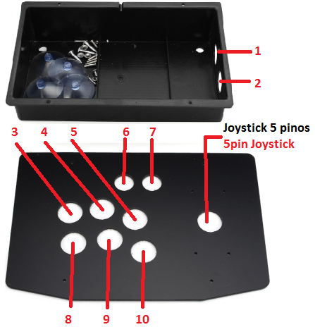

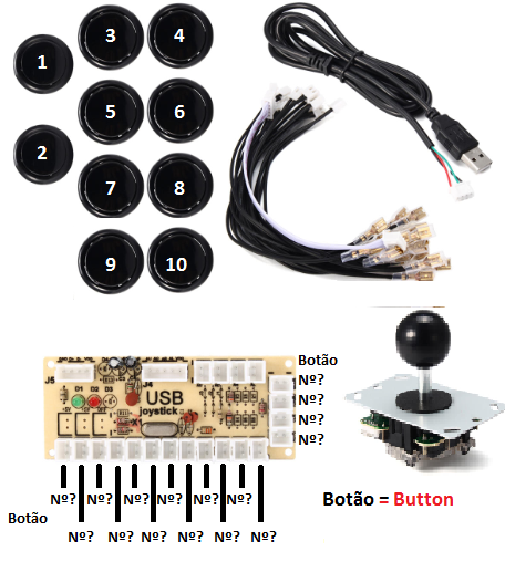

Sou um novato em arcade, Raspberry Pi e Retropie por isso pesso a ajuda de voces.
Comprei no banggood.com uma caixa e uma placa zero delay com joystick e botões para usar no RPI com Retropie, nâo sei a função de cada botão ou onde ligar na placa
(Figuras abaixo).

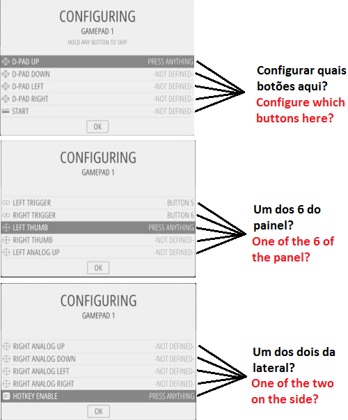

Outra duvida se refere a configuração no Retropie, quais botões configurar para que?

You have too many buttons there sport.  I can see you having some issues with that layout.  This place is called build your own arcade controls, so get some wood and make a proper control panel, not that plastic junk.
You need a bigger control panel area for those buttons if you are going to keep it.  Forget about the encoder and wire the buttons and joystick directly to the GPIO on the raspberry pi.
You can use the encoder if you want, but I keep them for bigger projects.

Connect the buttons to the zero delay controller. D-pad up/left/right/down is your joystick. The ABXY + L1/R1 are the buttons 3-5 and 8-10. Select and start are 6 and 7. Don't use 1 and 2.
The rest in Retropie/Emulationstation isn't used.

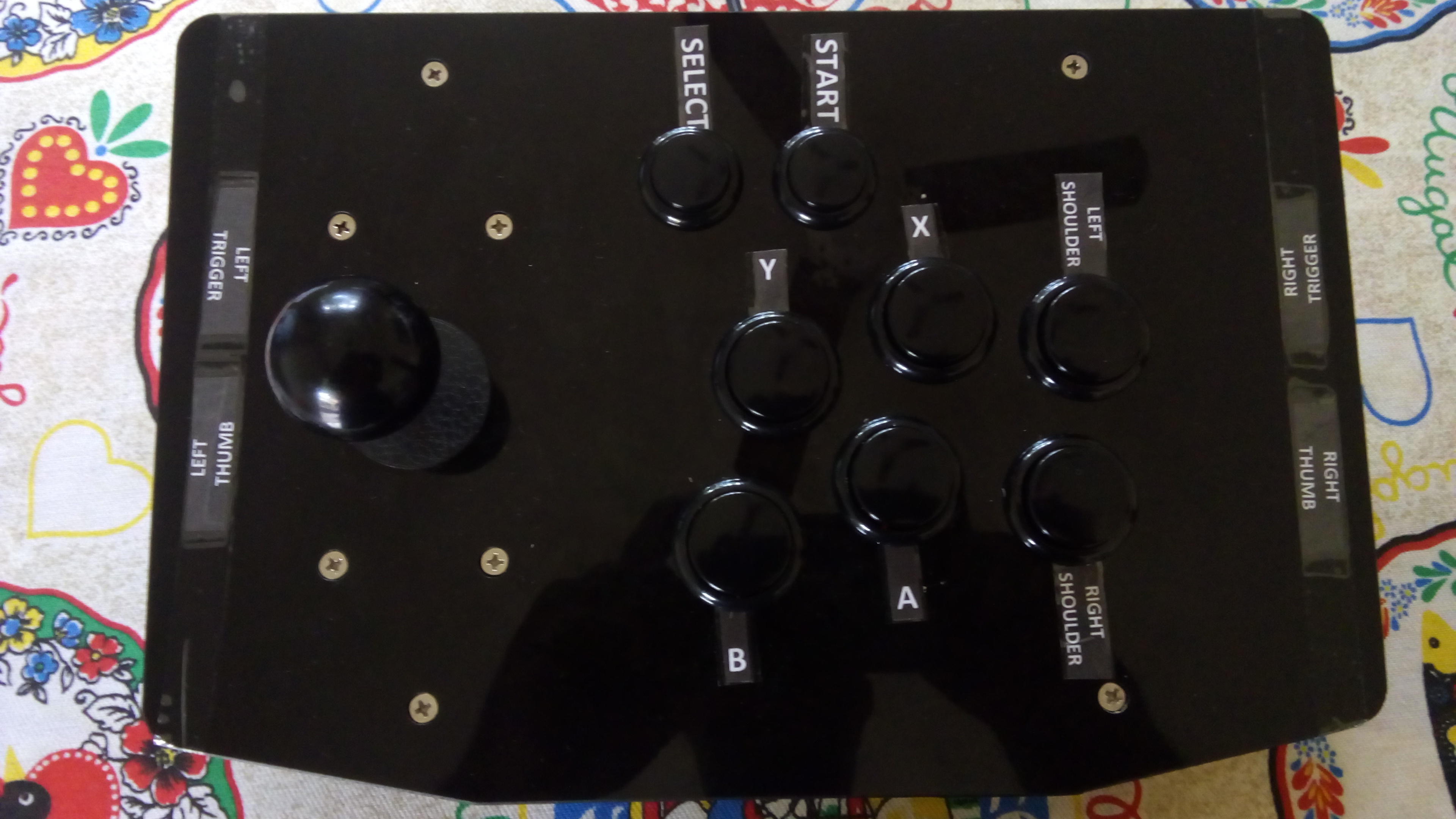

muito obrigado pela resposta, finalmente consegui montar meu gamepad, só falta mais duas pequenas duvidas:
1- Em  Retropie o que devo escolher para os botões 3-5 e 8-10?
    Para o joystick sei que devo escolher D-PAD up, D-PAD down, D-PAD left e d-D-PAD right, e para os botões?
2- A escolha fica em qual posição no gamepad ( L1 e R2 no centro dos botões? no lado esquerdo? os do lado direito são que escolha?).

There's no definite answers, as that depends on the emulators and games you are using/playing. Also it is preference. You can change the button layout for RetroArch emulators on an emulator or a rom basis anyway (https://github.com/retropie/retropie-setup/wiki/retroarch-configuration)
More information here for example: https://retropie.org.uk/forum/topic/5220/arcade-buttons-how-many-layout
