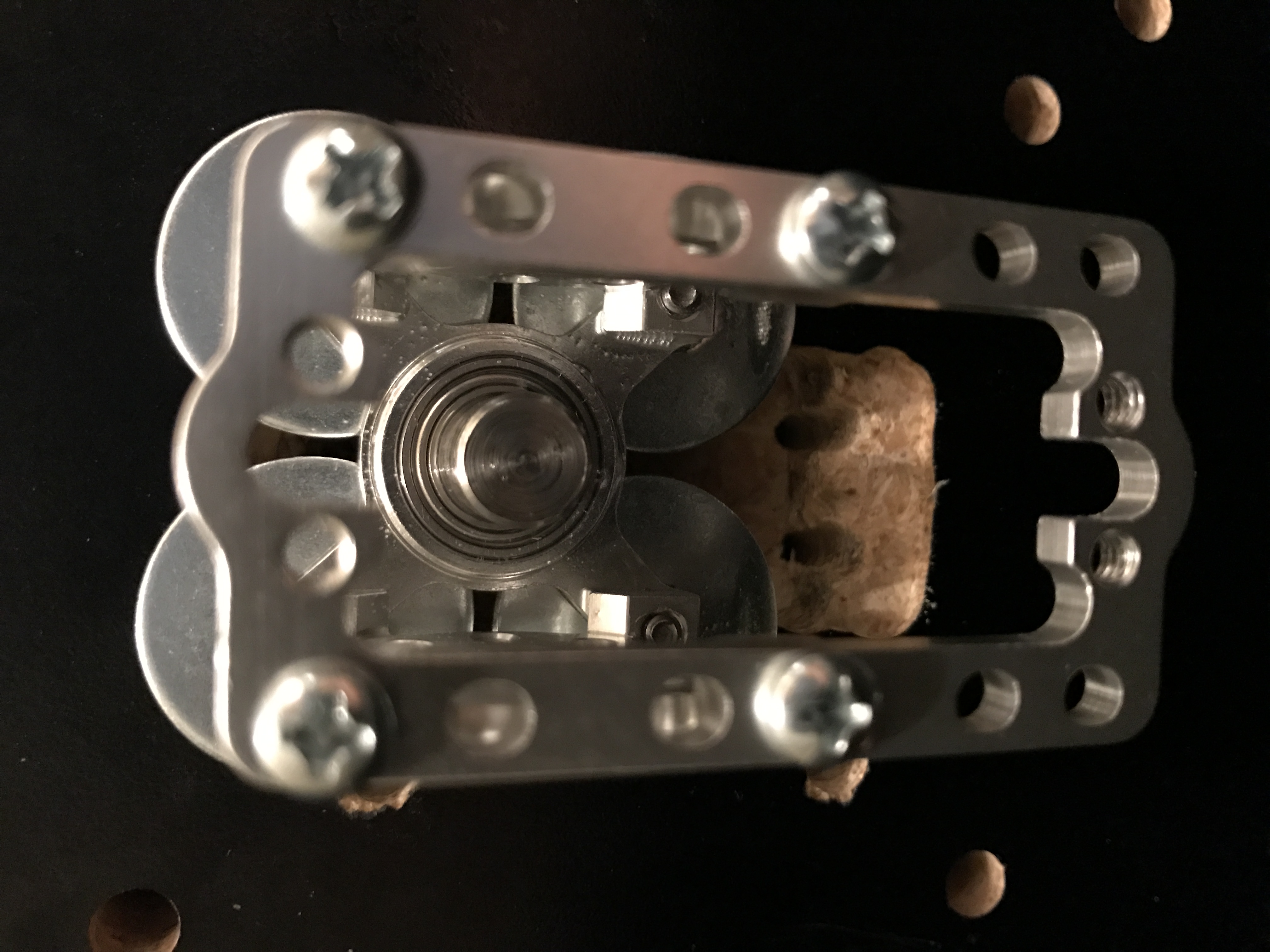

Route out space on the front for one of the pillow blocks, and face it outward (flat side down).
If you don’t have a router, you can get a longer shaft and longer 6/32 screws (2in maybe?). I routed out the space because the monitor would be pressing against the bezel otherwise, so bear that in mind -- you want clearance there so the monitor doesn't drag against it.
Drill out holes for the long 6-32 screws. Be sure these are square, and straight!
Mount one of the pillow block bearings on the front by pushing the long screws through.
On the back, slide on 4 of the 1” washers, then slide on the other pillow block, with this one flat side facing the front of the cab.
Then put on four of the small washers on the screws.
Then put the two side tapped pattern mounts on, vertically. Be sure that they are turned the right way; they have an inside and an outside. You want maximal space inside for the shaft and the coupler.
Tighten the screws from the front; the side tapped pattern mounts are threaded, and will be drawn onto the screws.

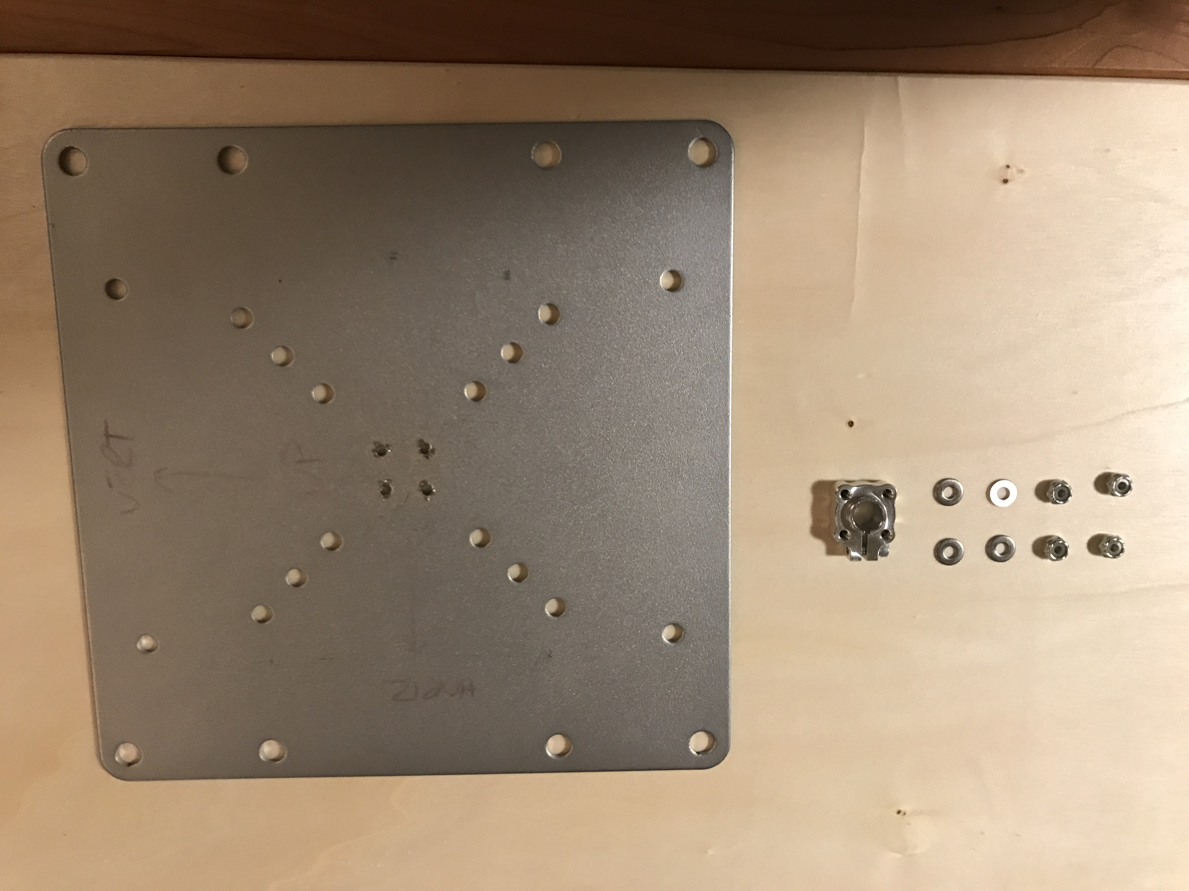

The monitor and shaft

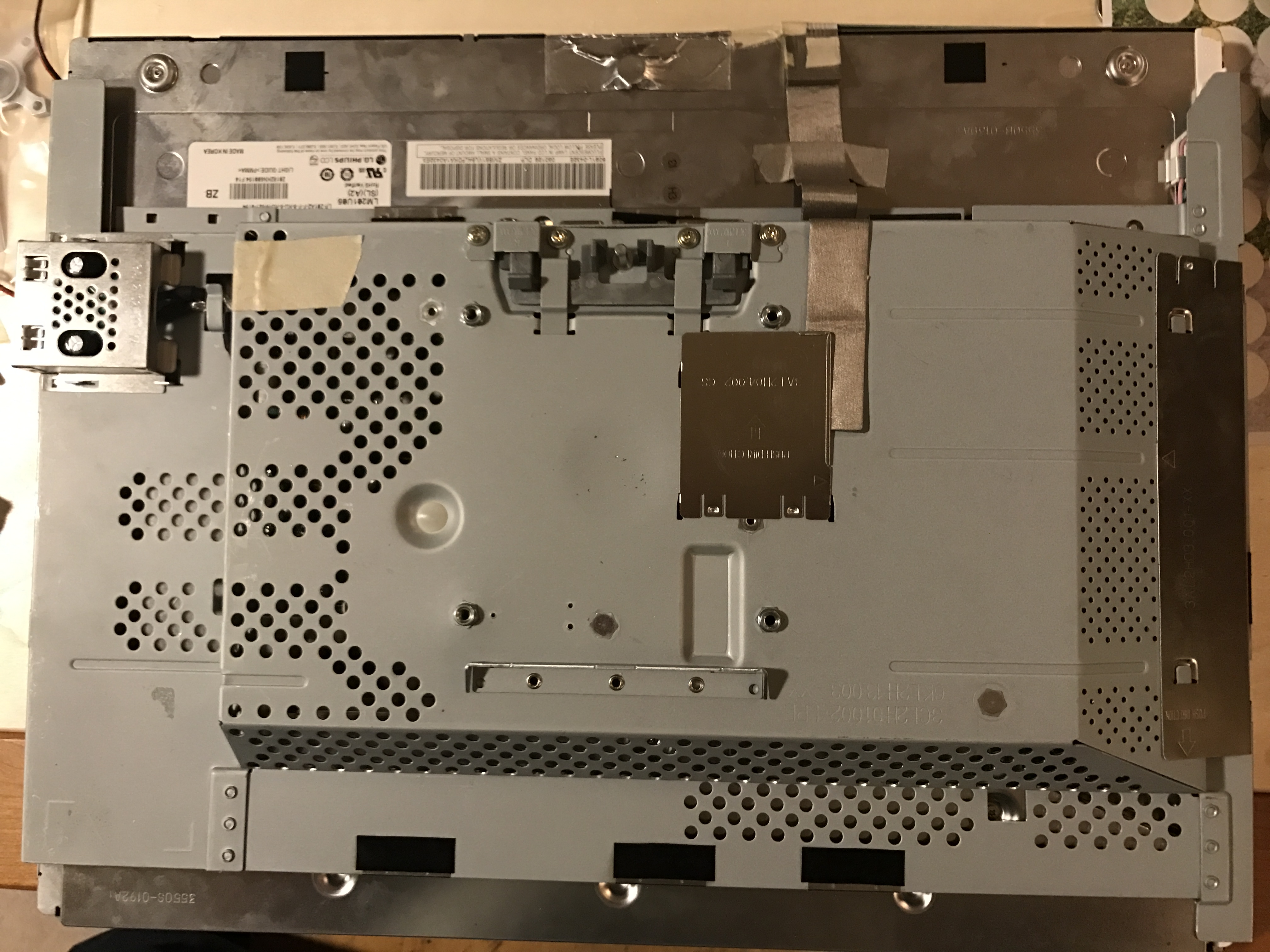

Debezel your monitor, if you need to. I did, so that i would have enough clearance at the corners when rotating. I also covered the silver up with electrical tape after debezeling.

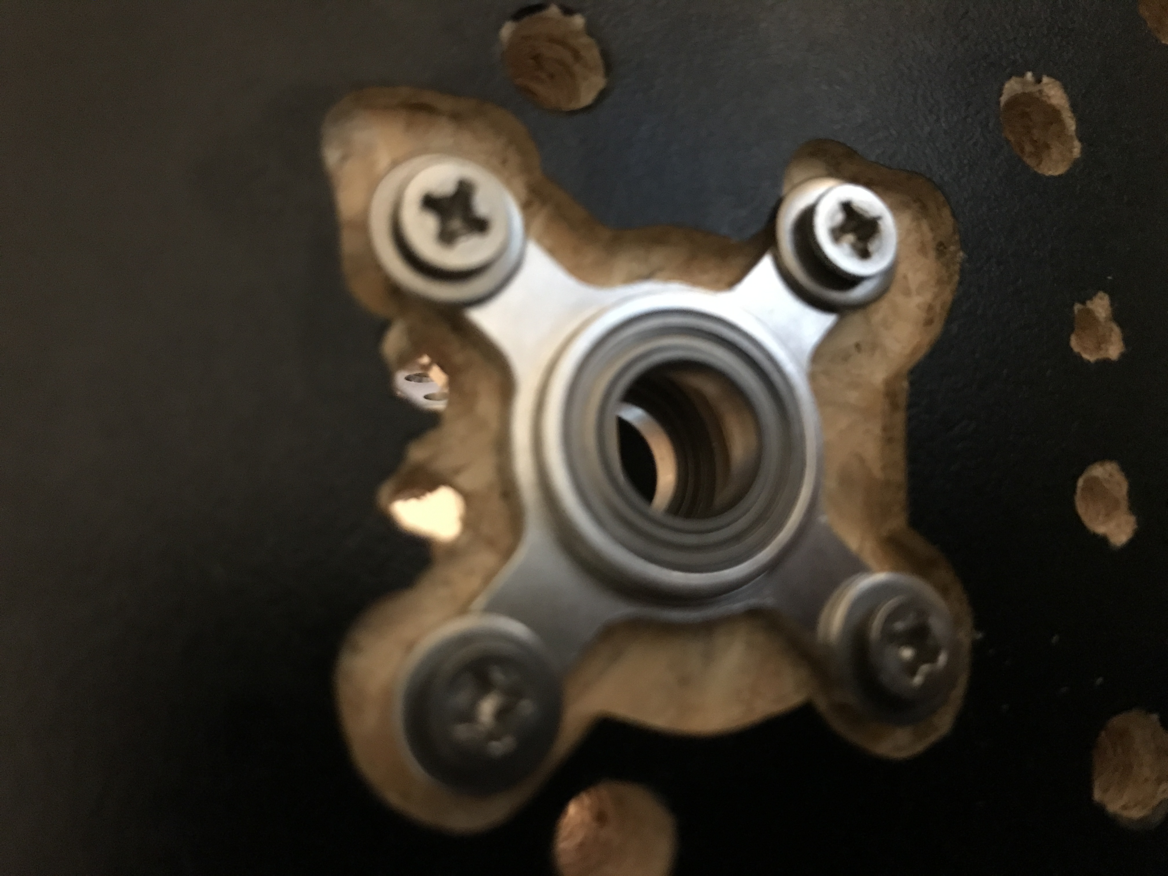

Put the clamping hub on the shaft, but don’t tighten it up.
Carefully measure where dead center on the VESA plate is.
Mark the location for the holes to attach the clamping hub so the shaft is centered.
Use a drill bit for metal to drill the four holes. Again, these must be square, at a .77” square pattern on the diagonal.
Insert the shaft in the clamping hub, and tighten it down with a hex key.
Put a spacer on the shaft here.
Using 6-32 screws and 6-32 nuts (I used locking nuts on this one) attach the clamping hub and shaft to the VESA plate.
Using a sharpie clearly mark on both sides which way is up in horizontal, and which way is up in vertical. Vertical should be 90 degrees counterclockwise to horizontal.

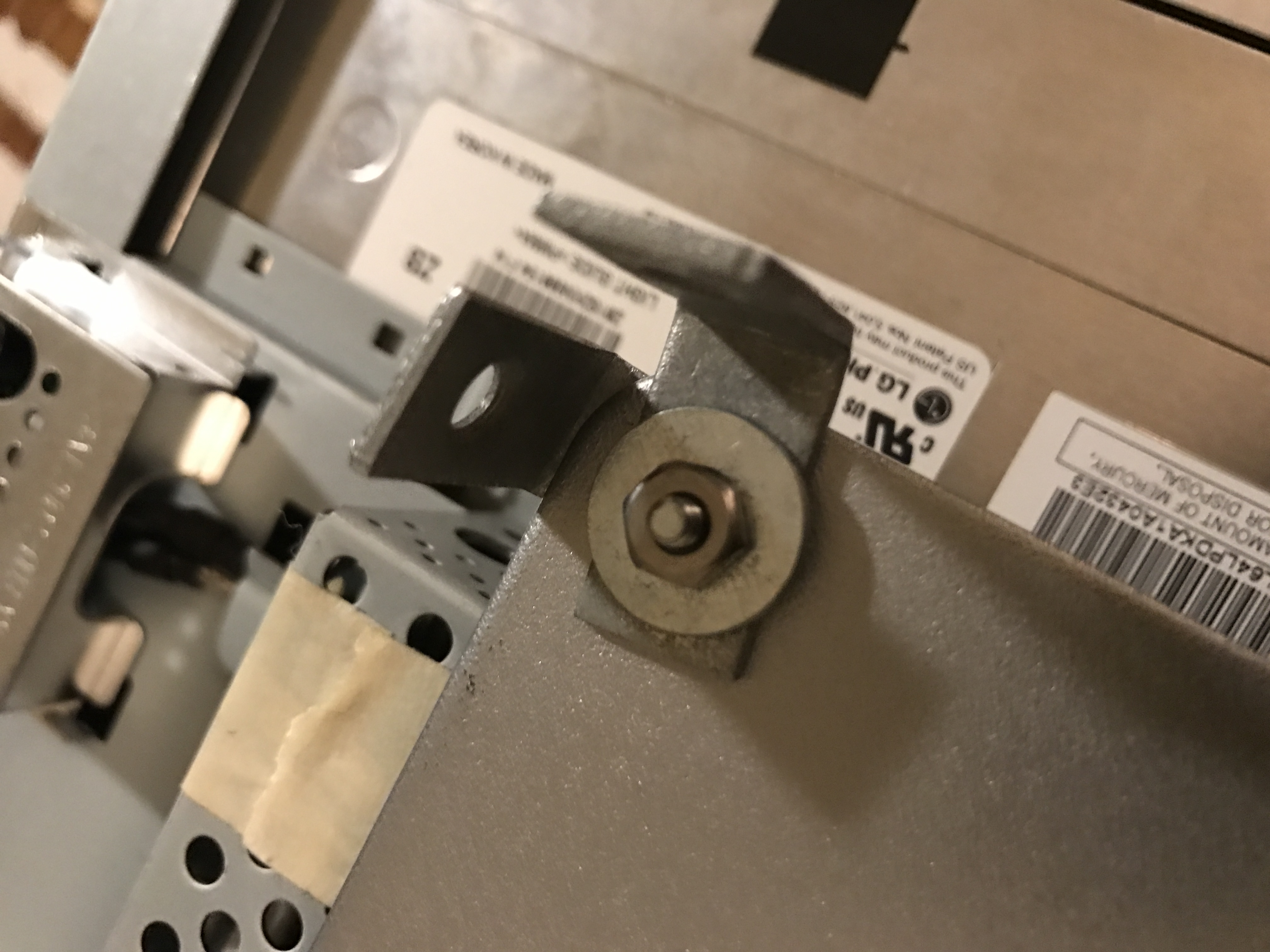

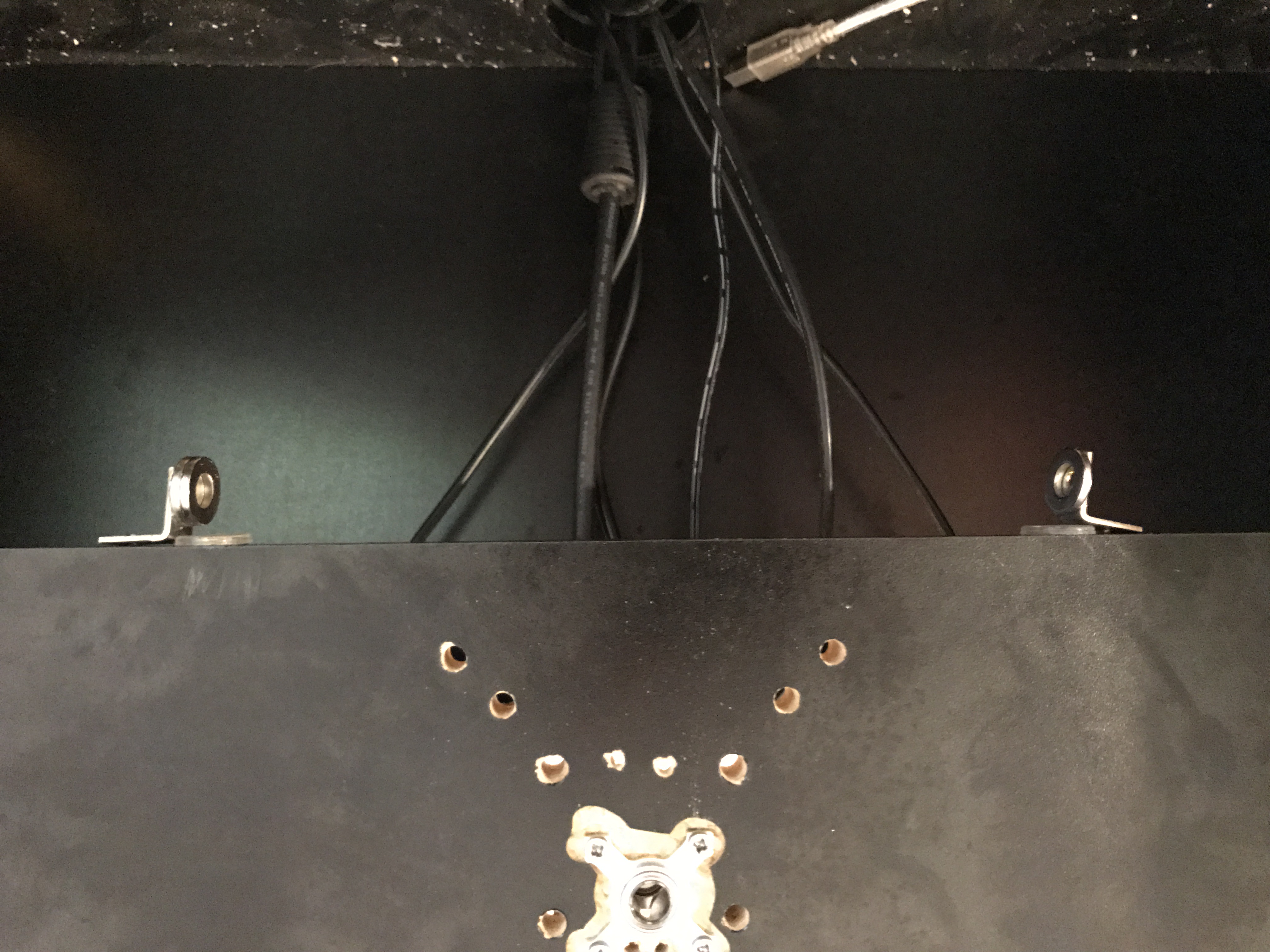

Take two of the angle brackets and mount them on that corner using whatever screws and washers and nuts make sense. Don’t tighten then all the way yet, but tighten enough that it takes some friction to move them around. You want these mounted so that they stick backwards far enough to hit the back board..
Now when you spin the plate, those angle brackets should bump against the bottom edge of the back board that supports the monitor and stop it at perfect horizontal and perfect vertical.
Put vinyl bumpers where the angle brackets hit that bottom edge. Now the monitor won’t be dead level in either position, so adjust the angle brackets until it is level in both positions, and then tighten that latch assembly down tight.
Take the other two angle brackets and use superglue to stick a magnet on each one, on the outside of the L.
Mount those two angle brackets on the bottom edge of that back board, against the edge of the vinyl bumper. You want the magnets facing inwards towards the center. Test that when you turn the VESA plate, the brackets on the VESA plate are catching lightly on the magnets. Make sure they don’t catch TOO well – the magnets are strong, and the servo can actually burn out or strip gears trying to pull away from them. I speak from experience. So make sure that the magnets maybe don’t quite touch the latch fully, etc.
Once it feels like it works, attach the VESA plate to the monitor using 4 more 1” washers and the VESA screws. Now is why you needed “Up” labeled in sharpie. :)

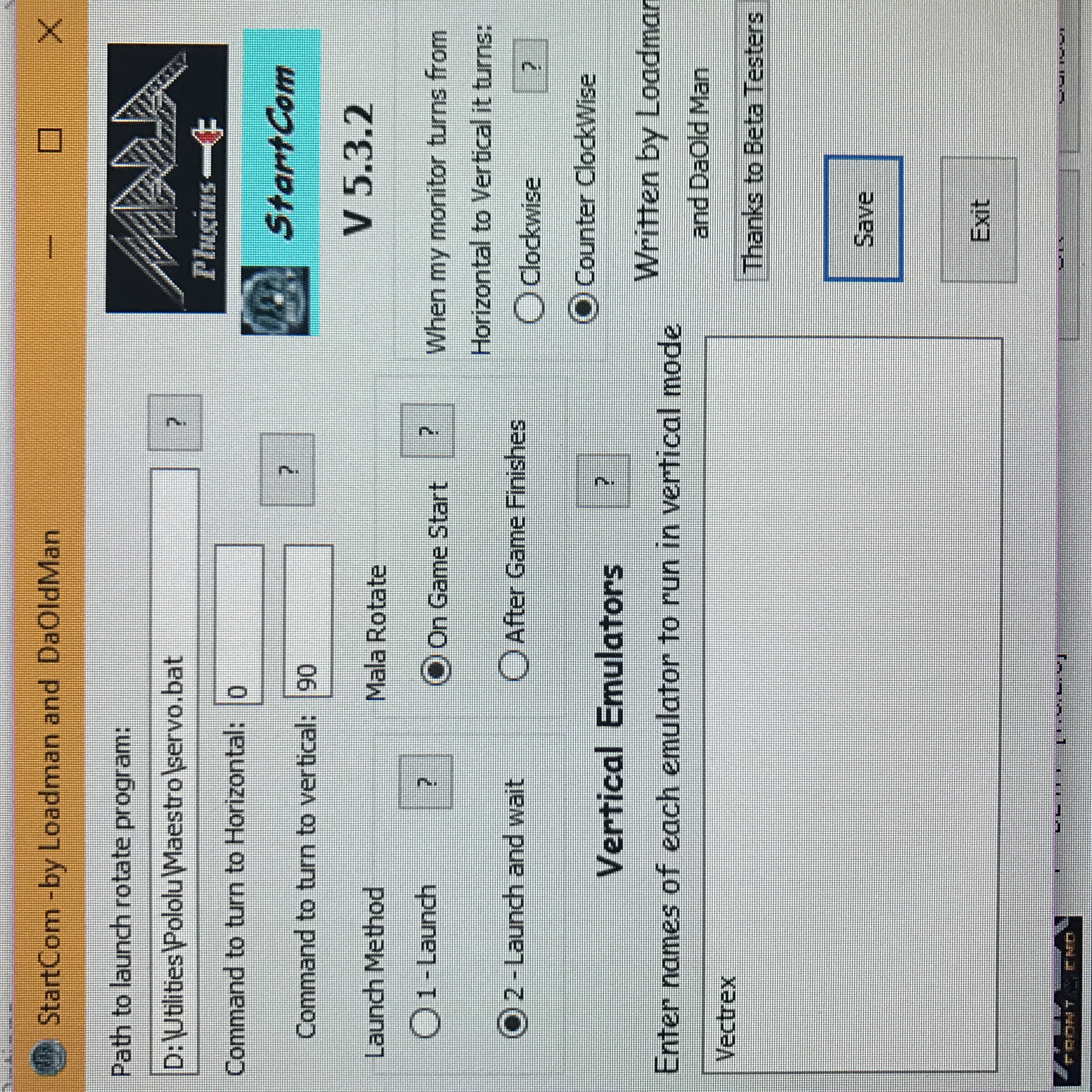

Once satisfied, install the mrotate plugin from DaOld Man, if you’re running a frontend that supports it, such as MALA. If you’re not, find out if your frontend has the ability to run executables with parameters.
I had trouble getting startcom installed under Windows 10. I couldn't register comdlg32.ocx in Windows 10:
RegSvr32
The module "c:\windows\system32\comdlg32.ocx" failed to load.
Make sure the binary is stored at the specified path or debug it to check for problems with the binary or dependent .DLL files.
The specified module could not be found.
  • registering comdlg32.ocx manually in Win10 just kept saying the file was corrupt.
  • doing so from an admin-level command prompt didn't make any difference.
  • running startcom with a copy of comdlg32.ocx  in the folder gave an error saying that the .ocx wasn't registered.
  • leaving a copy in the startcom folder and running startcom as administrator did the trick, and the ini was created!
Now, in startcom, set values thus:
Put the path to servo.bat in the “Path to launch program” line. Make the command for horizontal be 0 and for vertical be 90. Choose “Launch and wait” for the method. Choose “On game start” for the “Mala rotate” choices. Choose “Counter Clockwise” for the direction. Then hit save.
Go into your mame.ini and set autorol to 0 and autoror to 1. And rotate to 1.
Refresh the games list, possibly using Mala’s handy "redo metadata in all game lists" button (I forget the exact name) under Game Lists. This will make sure the games that are supposed to rotate do.
