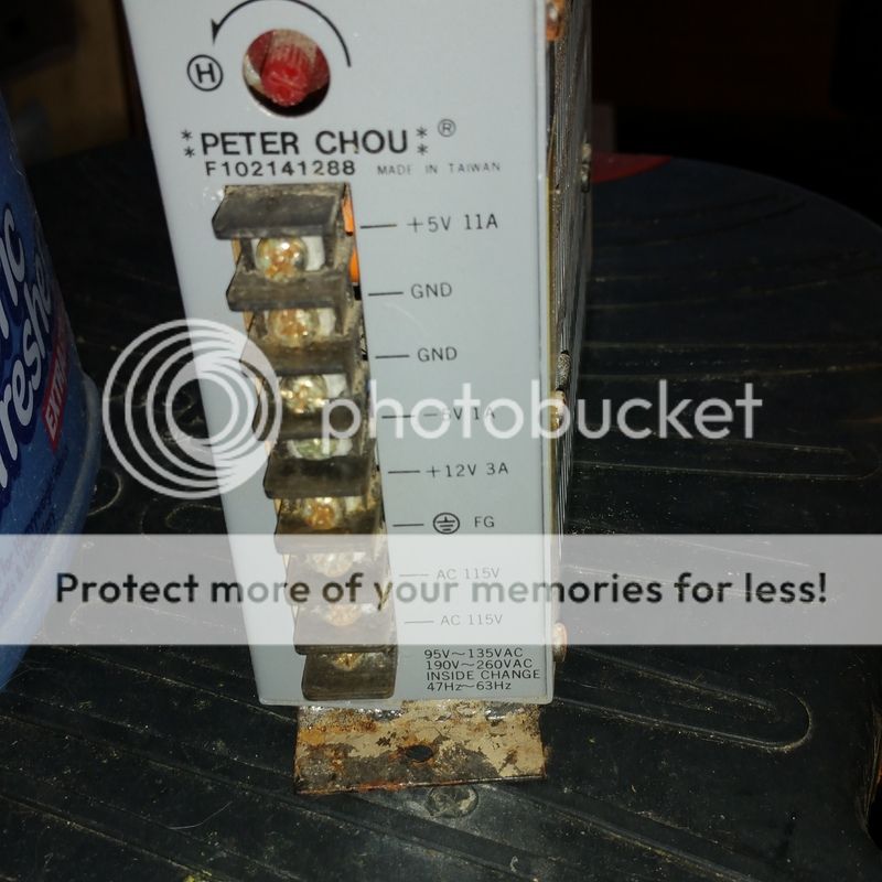

Going at it again , with trying to repair my Arcades. Starting with Galaga 88
I purchase a new PCB. To replace a rusted damaged  chip roms.
The power supply was badly rusted . I want to replace it . which Power supply should i purchase..
that is compatable to it. ?
Heres a pic of what was in it..

Any switching power supply should work, I sprung for Suzo Happ but the Chinese ones are fine too, just don't fire them up unless they are under load.  Might want to get a throw away JAMMA board for test purposes so you don't fry a 400 board on accident.  ;)

Re: GALAGA 88 restore Need advice to which Power supply
« Reply #3 on: April 19, 2016, 07:36:50 pm »
Yeahh I was afraid of that  Def NOT china product, I think all there stuff suck..
 but i'm not sure which size power . I cant find any on flea bay.  do it have to be +5  11A.
and which kinda jama bd should i get to try thats cheap..

-5 is only needed for a few games, most notably Midway games such as Mortal Kombat , +5 is good for 95% of all JAMMA.

« Reply #8 on: April 19, 2016, 09:39:04 pm »
 Yes i want to replace it , but the ones i see online says
+5 15 A          i have +5 11A
+12V  2A         i have 12V 3A
can i use this one
http://www.ebay.com/itm/Happ-15-AMP-Switching-Power-Supply-Arcade-Multicade-8-Liner-Games-/111914266505?hash=item1a0e9c2f89:g:IsIAAOxyKsZRvz5Q
« Reply #9 on: April 19, 2016, 09:47:05 pm »
Yep. Go for it!
