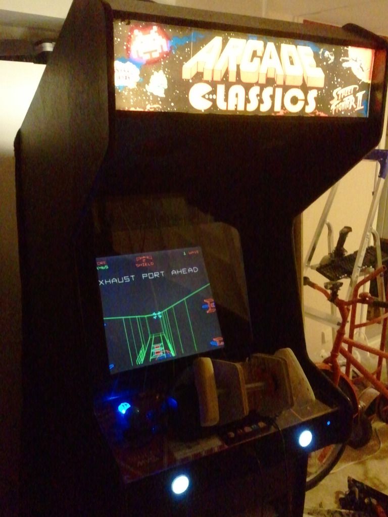

  • Im building my childhood dreams.....
Starwars YOKE controller on a budget
« on: November 26, 2015, 09:00:24 am »

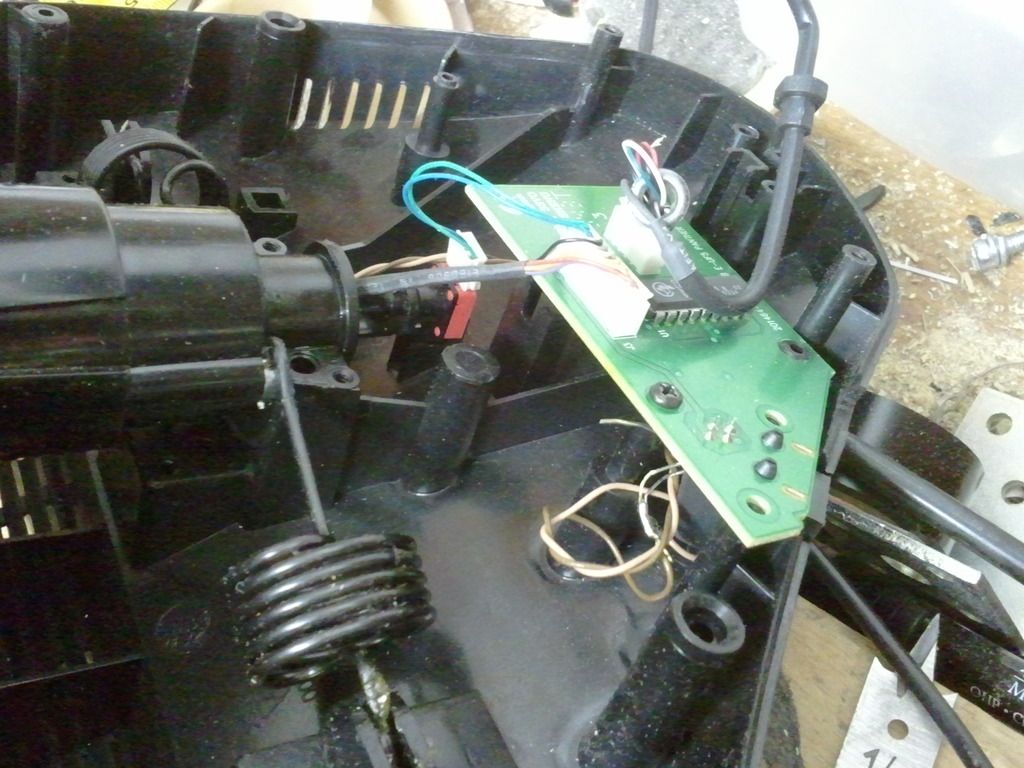

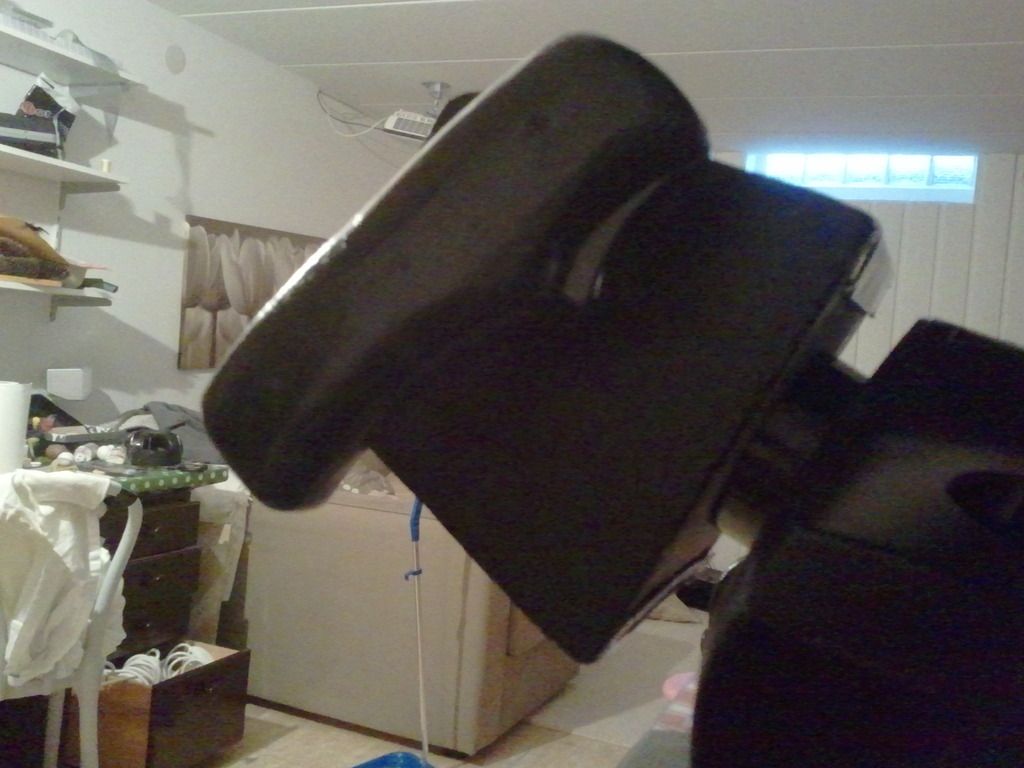

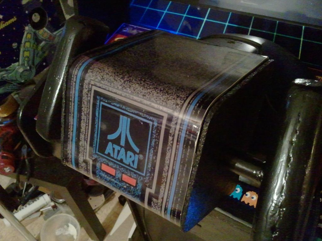

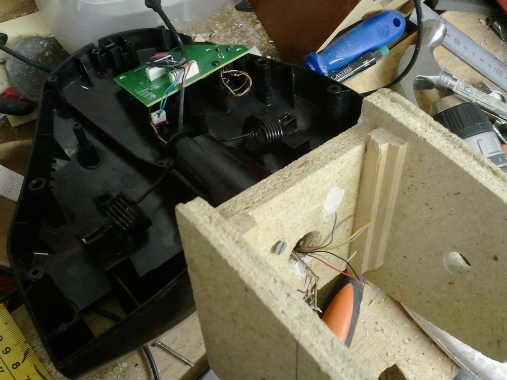

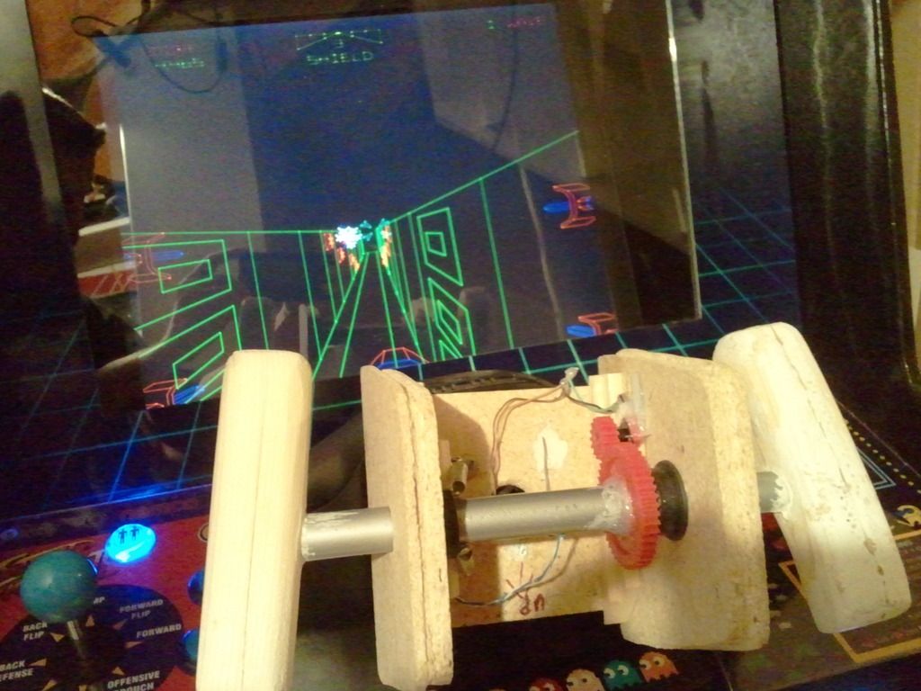

A little experimentation on what's possible to create on a super thin budget and a lot of imagination :)
Using an old wingman steeringweel = 5$
http://images.bidorbuy.co.za/user_images/063/2534063/2534063_140425071220_1301070400_180970405_1-Fotos-de--Vendo-Joystick-Timon-con-pedales-Wingman-formula-gp-LOGITECH.jpg

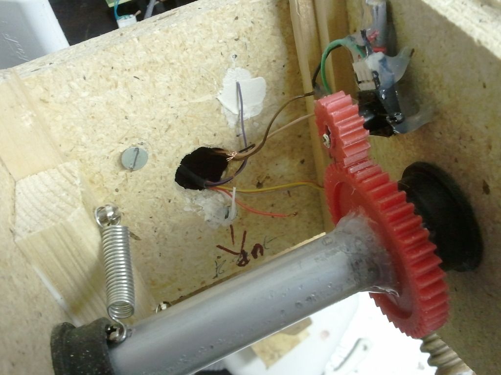

Using the foot controller sensors gas/break. to steer up/down as the original "yoke"
firebutton conected too one of the wheelbuttons.
thanx to http://arcadecontrols.com/hosted/yoke/

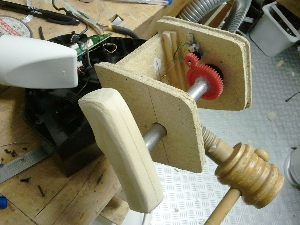

exelent blueprints, the woodwork was easy. Switching the steeringwheel to my own creation.
Plastic cogwheels from a discarded toyset (lego cogwheels would do exelent)
Steelrod from discarded lamp. Spring from discarded wingman pedals

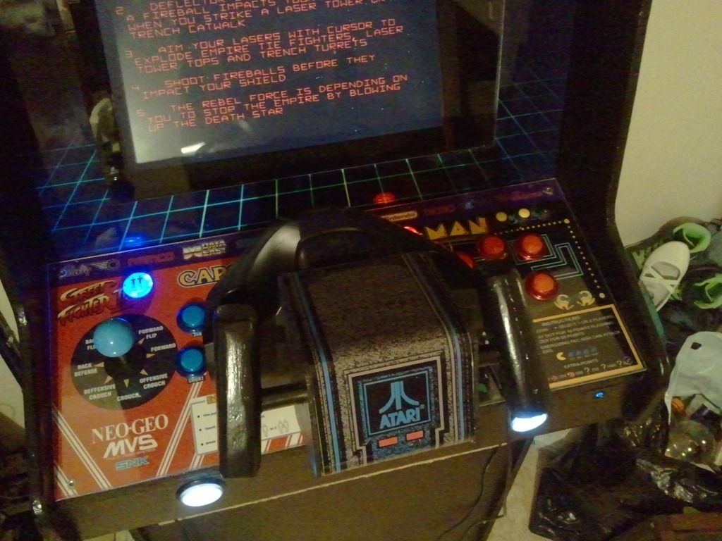

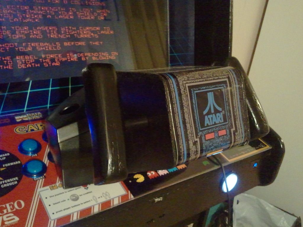

Aluminum plate bent over the midpart with a local photostore printed "Atari Starwars yoke texture" found on some arcade site and photoshopped by me.  = 10$

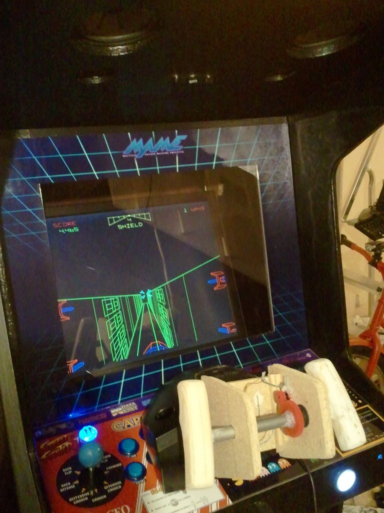

End resault after a lot of tweaking in the Mame64 analog steringweel sesitivity =  100% AWESOM Starwars arcade gaming!  :droid

 One thing,  drill a hole through the pipe,   and put in a bolt that sticks out.    Place rubber bumpers on the ends,  or glue bumpers to stopping blocks.    Screw stopping blocks in place,   preferably made out of hardwood, cutting board material.. or something dense and strong.  (or maybe just use two bolts for the stopping blocks, with rubber bumpers surrounding them)
 You want stop blocks,  so that the pots do not get turned too far... and break.   Someone is libel to do it, even if you yourself are careful.
The stopping blocks will also help define your controller feel and range...  not to mention, allow for accurate calibration.
 If you had placed the gears more towards the center,  it would have been easy to place the stoppers on the side of the yoke.
 Not sure the kind of pipe you used.. but it should be like 2mm thick,  to handle the torqued impact stop.
 You probably want to remake the thing out of a more solid wood, or thick cutting board material for strength.   Again, due to bumper force and solid mounting...  so that the whole assembly wont tear apart.
 Edit: If you cut the trigger spring in half,  you should have room to place the top buttons in place.   It would also be good to anchor the mini micros with some tiny screws, or metal pins that are glued in place.   Impact stress might eventually move /break the hot glue.
 Also, you might opt for leaf switches instead.  They will last longer, feel and react better.. for the triggers.
They also may eliminate the need for any return spring.. as they are in fact springs themselves.   Not sure about the depth..  so double check it.. but it should work fine when split in half.

 I meant,  that if you institute stopping blocks.. the impact forces upon them can be quite powerful.   The power will seek out the weakest link (breakage)..  and that could very well be the choice of using particle board  -vs-  solid board.    Also,  the joints will also be stressed too...  so if the construction isnt really strong.. a whole side might break off the bottom plate, for example.
 (My initial device was a mere small machine screw that bumped into a rubber padded wood block set that Id glued in place.   The forces eventually broke the block off.   Hence, my advice to use something like a metal bolt set with bumpers - that goes through the actual shell)
 Rubber bumpers will help,  but even then a person can generate quite a bit of force in a quick-twitch flick of the wrists, in the heat of battle.
 Re-enforce all the corners with blocks, much like the ones you have in the rear.
 Additionally,  it seems you simply glued the handles to the metal tube.   This may also stress-break at end of travel.   To prevent this,  I had made two donut shaped collars that were cut at the correct handle angles.   I screwed glued and screwed them to the inner side walls of the handles, using small screws.    Then,  the tube was inserted into the collars...  and I put a long thin bolt through the collar top,  and into the steel tube.   This locked the tube to the handle quite well..  yet could be taken apart if needed.
 Another option,  is to cut the ends of the tube a bit,  and make it so that you can bend two flaps 90 degrees, and screw them in place.
 Yet another 'not so great' but dooable option, could be to tap threads into the tube ends, and lock it down with an internal & external nut.  I dont recommend the typical use of threaded rod, as the threads anywhere else would shred stuff.. such as the bushings / etc.
 The spring return could use some tweaking too.   A quick helper may be to mount each spring end to opposite diagonals... to give more distance.   They should be stretched out a little to create tension.   It looks like if you turn one direction, the other spring will sort of bind up currently.
 Wood is fine for a decent yoke.  Just have to make sure its well built to take the abuses.

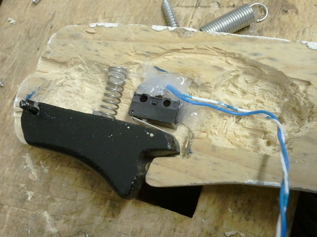

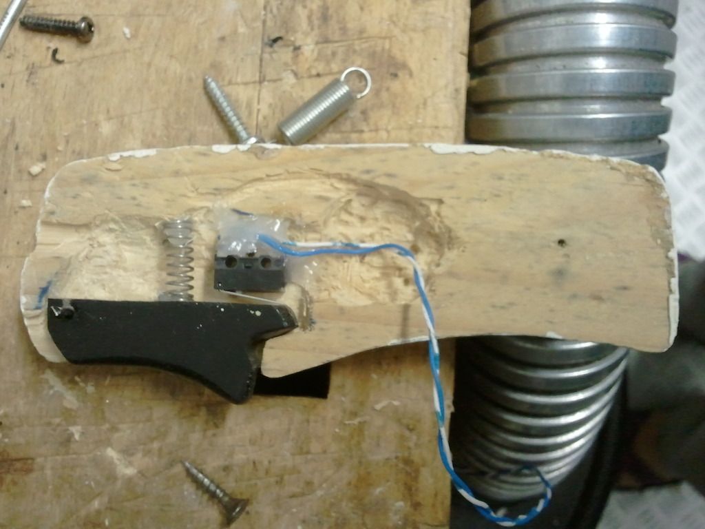

I'd like to know more about your Plexiglas trigger.  Will your next version have thumb buttons?  I can't tell you if you need them or not, it has been a while since I played.   check out some PC based Star Wars games.report back with any mods you made to this yoke in order to play them.
  :D thanx for the kind words!  I believe it should work for any game supporting joystick X and Y axis!
what can i say about the plexiglas trigger...its sawed out of ordinary 5 mm thick acrylic clear plastic. think it was from a discarded pen holder!
its pushing on a pressure breaker switch bought on Ebay for 1$ for 5 psc :)
he thumb button i didn't try to implicate because its not needed for the game to be played. there is 4 buttons in the mame64 version but they seem to do the same thing. firing the lasers and eventually firing the torpedo in the exhaust port ?

Yes im going to redesign and make everything smother. Actualy dident putt so much time into this project,  probably even replace the steering wheel base with something locking more like the original.
The springs could relay be stronger to give it a better force feeling. the wood setup is strong enough to take the force with some more wood glued to the base. the feeling right now its mush too week!

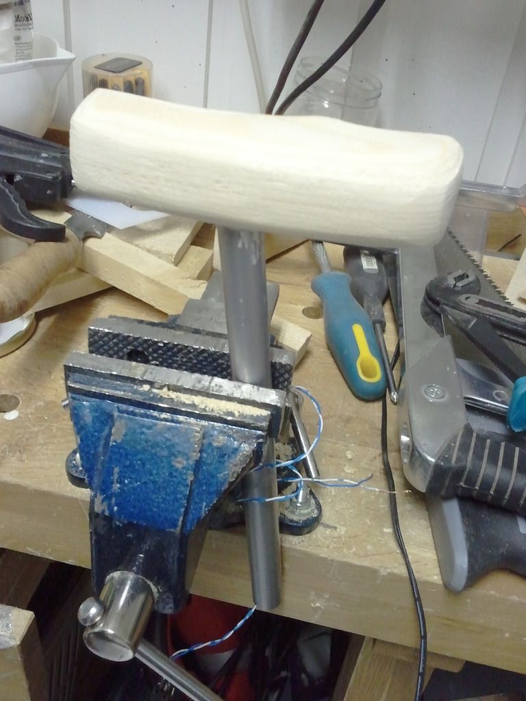

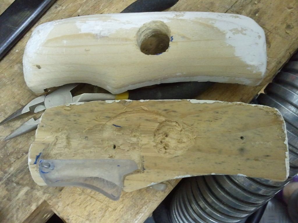

What kind of wood did you use for the handle?  Where did you find the pattern for the handles?  That link you gave used star wars themed lollipop holders.  Anyway.  Is that pine? How thick is the wood?  Thanks.
The handle with the trigger its some kind of Heat-treated aspen from a sauna. (saved the wood from when we removed our sauna)  ;D
The other one is pine!
found the patterns on a site selling the real deal!
Photoshop it with a measure of tying out diferent sizes, before i found my own measurement that felt like the on i played in a museum some time ago.
12.3 cm high
4,9 wide
 and 3.2 cm thick
White dot in the middle is the drillig mark for the metal bar
« Last Edit: December 09, 2015, 03:56:03 pm by evilfred »
