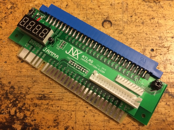

This is great if you're wiring a cabinet from scratch. But for those who already have a JAMMA cabinet and looking to not re-wire anything, you can get a nifty adapter from JammaNationX called the JNX v1.1 Atlas Adapter:
  • This is the JNX Atlas. It is both a Voltmeter and Pandora/Blue Elf JAMMA adapter. The pinout can be changed between Pandora/Blue Elf and JAMMA pass through simply by moving two jumpers. The JNX Atlas supports both CPS1 and CPS2 kick harnesses. Just plug and play.
Anyone who knows James aka XianXi, you know how top quality his stuff is, definitely deserves a plug.
Most of the game I tried seemed to play well, but I did notice some slow down when fighting a boss in I think it was Metal Slug.
There have been reports that Final Fight and Sunset Riders has some screen tearing, only via 15khz RGB and not VGA.  Could you confirm this?
