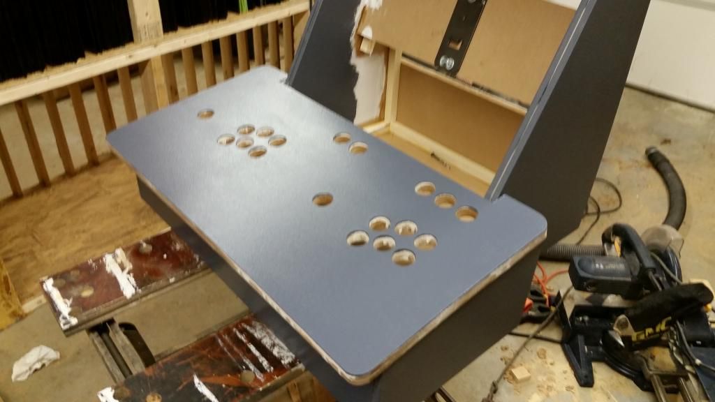

Mostly just wanted to say thanks for others here with skee ball builds.  I learned a lot from you.  Especially this one:
http://forum.arcadecontrols.com/index.php?topic=91011.0
A few years ago I obtained a really old SKEE Ball unit for $300 and this year finally got around to getting it working.  The electronics were in sad shape so after much hemming and hawing I just decided to gut the entire thing and wire it all up to an LEDwiz controller.  It has turned out fantastic.  I'll attach some pictures.

This is the guy that made the Model S image: http://www.johnkalnin.com/skee/
His site has tons of great diagrams, images, flash stuff, etc.  For example my LEDwiz wiring is nearly identical to this: http://www.johnkalnin.com/skee/LEDWiz-wiring-diagram_wRelay.jpg  One exception is that I don't have the light on top, instead I use the solid state relay to run the solenoid that releases the balls on start.

That's cool man.  I think I'm actually the odd man out here as I have no intention of writing any flash.  I've never done a bit of flash before, but have a good understanding of .Net and all the environment resources at my disposal so I went with that.  The LEDWiz interface is a wrapper around the .dll provided by GroovyGameGear.  Yes, this all pretty much ties me to a windows pc, but I have plenty of those laying around and so far it runs pretty well on an old one.
I'm all for sharing resources.  My code, all the images, and sounds are up on github.  That's where I'll push all the development - more for my own personal organization than anything else.
It occurs to me now that folks might not be able to compile it, so I can make an .exe available for anyone that wants to see it.  It works with a keyboard similar to how your flash program does.
