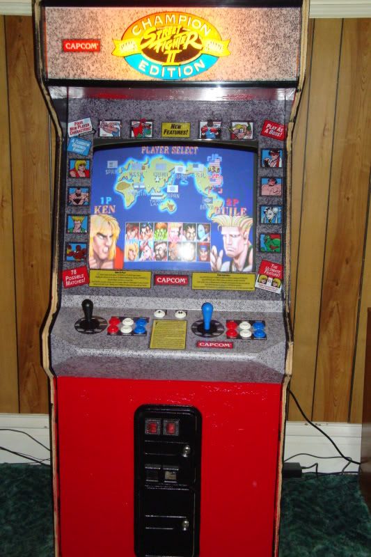

Classic, I call BS on this.
1.  The reason that all 4 player control panels built today and as far back as over 20 years ago is because angling the outer players gives the two inner player more shoulder room.  If you make all player's controls straight across it will require a larger than 48"W panel (most likely 54" at least) to fit everything and give all players the same space to play as the angled 48" panels.  We have built 100's of 4 player player angled panels and have not had 1 complaint on the playability and function.
No, you don't want it straight across. You want the actual Joystick base to be straight mounted like all the midway style 4-player cabinets. Placement stays the same, joystick orientation is straight like P1 and P2.
No need for a new "wider" panel.
2.  If you want the player 3/4 controls moved up to the extreme top of the panel like in this picture you sent it will cause player 3/4 to have to reach up and over player 1 and 2's controls making play uncomfortable for all players.  The owner of the cabinet "Pierce's Arcade" complained of this after we built this machine with these controls this far up (although he also made this request and later regretted it)
Where is this coming from?  They don't need to move the controls...the joystick base just needs to be re-angled.
3.  The reason the street fighter's buttons were so close together is because of the space limitation problem Capcom had with the normal 19" monitored or 25" monitored cabinets.  They had to fit 6 buttons in the space normally allotted for 2 buttons on these classic cabinets.   Normal button spacing for us and most arcade machines back in the good ol days were at 1.5" center to center from one button to the next.  This is the most comfortable layout for ADULTS hands to play at and how we and many other cabinet manufacturers today build their machines for Adults.
Bovine-feces. I can see how this would pass by someone who is unfamiliar with arcades, but it ain't gonna fly here.
A majority of Street Fighters were conversion kits, that were installed into Dynamo cabinets. There is also the Big Blue cabinets that I believe were commissioned by Capcom at a limited run. I'm a little foggy of the history, but I do know that their reasoning is false.
There is no space limitation for in the CP for 2-player 6-buttons.
Dynamo Z-back:
Big Blue:
Does that look like they had problems with space??  Look at the button spacing, nice and tight, ergonomically placed.
Believe me, if you play on the current placement for a while, you will definitely develop hand cramps/strain.

It doesn't take long to rotate 2 of the joystick graphics, and squish the button labels closer together.  He thinks this is going to take long because of the "straight" placement of P3 and P4, which isn't what you're asking for.
I mean, with paint drying time, I can see this taking maybe 2 weeks. Re-cutting/drilling/slotting the wood and plexi shouldn't be more than a couple days. Artwork changes -- an hour tops.
Here, I don't know if this will help, but I did a quick photoshop edit of your photo you originally posted. Buttons placed closer together, and P3 and P4 joysticks indicators: angled to match the P1 and P2 sticks.
