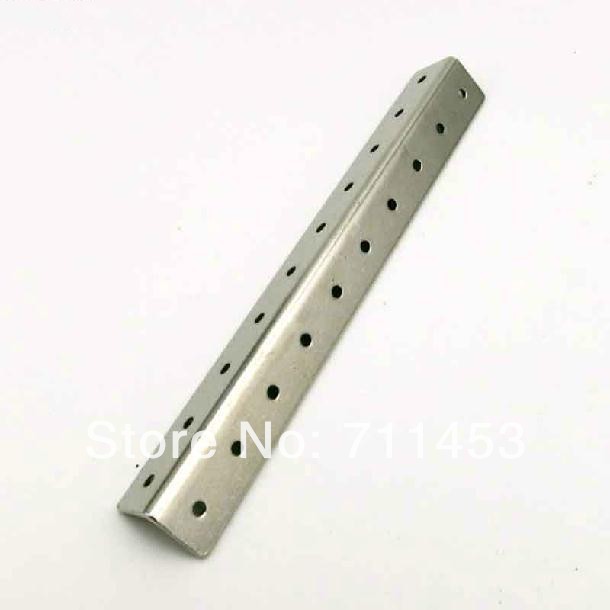

I used pieces of angle iron that look sort of like this: http://i01.i.aliimg.com/wsphoto/v1/594819189_2/L-shaped-Angle-Iron-Axle-Bracket-Iron-Plates-20-Holes-for-DIY-Model-Accessories-Robot-Body.jpg
Actually, the stuff I got at the local hardware store came in a length of several feet that I cut as desired, and it had every other hole elongated which made it even easier to use (less precision required).
I mounted that stuff on the cabinet, and attached the CP using 4 carriage bolts.  Works like a charm.
