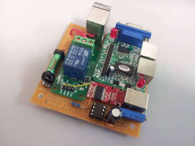

Sorry guys have been so busy lately.
Here is the completed automatic KVM switch, this allows use of two graphics cards hooked to one machine.
It will allow display 1 to be connected to the arcade machine on bootup, once windows/linux loads the KVM will automatically switch to the second output.
a hacked HD4890 using calamity drivers.
The purpose is to allow native bios support for configuration maintenance, then to load a hacked 4890 to have a wide range of resolutions available
Here is a picture of the custom kvm
very poor video of it in action in the machine.
and it working on the bench,
Currently working on a machine gun mode for the Namco recoil gun!

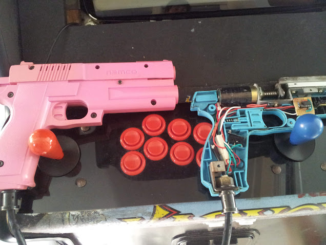

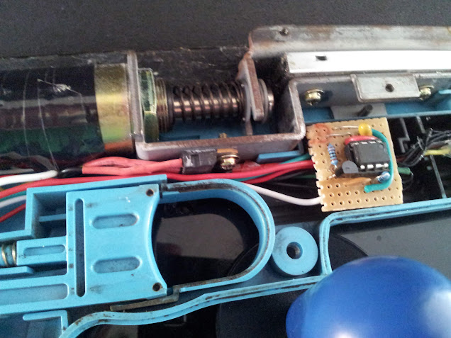

Another update,
Automatic mode for the Namco Recoil gun,
for games that call for rapid fire and for when you just want to use it :)
controllable by a toggle switch for on or off

Hey all, here is the guns in action
!http://www.youtube.com/watch?v=Ad2rFNhMCA0

That's an amazing work what you've done with the auto-switching mechanism, I wish I had the knowledge to do stuff like that.
I'm just a bit confused because from your previous video I understand that there's a point where the switching is done and there's a sound from the relay, but in your last video it looks like you have edited it at 0:30" to cut the switching that (at least for me) is the most interesting part. No criticism, maybe you just wanted to focus on the second part.
From what I understand, the gun's modification is in order to enable continous fire, isn't it?

Calamity
  • Moderator
  • Posts: 7503
  • Last login:Yesterday at 05:35:19 pm
  • Quote me with care
Re: Sneak Peak at Epicfatigues Epic Arcade
« Reply #11 on: March 04, 2013, 05:29:57 pm »
Thanks! Well, I can't solder at all, but I'd say for me it's more of a matter of knowing what to solder, I even have difficulties to identify electronic components. I just mean that being able to assemble electronic devices opens a new dimension which I'm a bit afraid to explore  ;D
