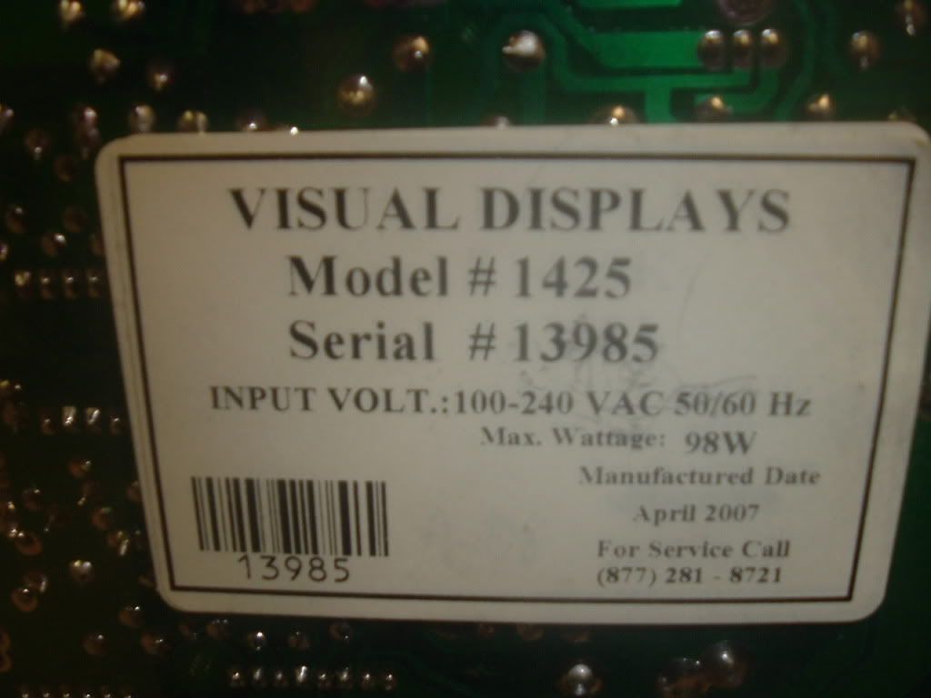

The nameplate has a phone number, did you try calling it?
My guess is that this is a monitor that has been "put together" by one more of a few companies that managed to find boards that were left in circulation when Pentranic USA closed? ALS, Budget tubes, who knows, the black metal frame suggests that any way?
It uses a CH288 switchable chassis originally made by Rodotron, but may be a copy as for the past number of years we are the only company in North America Rodotron would sell to.

Thanks that helps a lot, I may call that number,  I tried googling the name of the company and nothing came back. I got this off eBay and figure it was surplus left over and the company that built it is out of business....they had four to sell.
Either way your info is very helpful - Thanks again

Let us know how you make out with the phone call, I did some checking/ google... leads to Budget Tubes, ALS....
I noticed some issues with the setting on the controls on the neckboard and hate to say it, but be prepared for some more issues. Good news it fired up.
Re-wire it using the yellow wire not the white and hopefully it will sync up and the rest of the issues will be set-up. I will be happy to try to help.

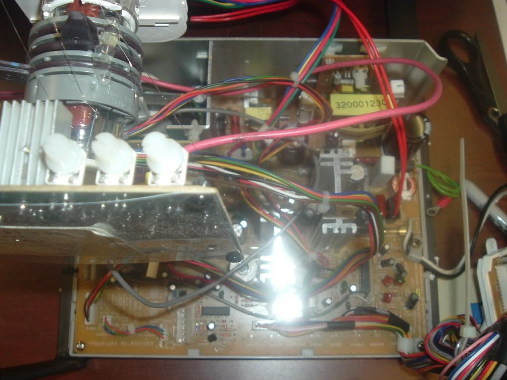

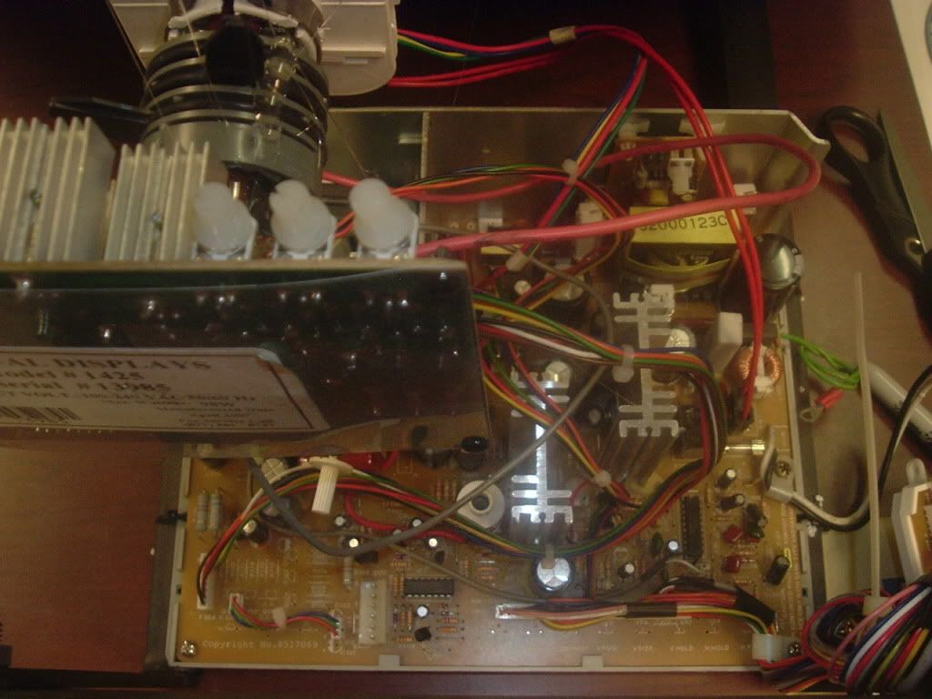

Ok, I got my VGA amplifier from ultimarc and wired this up, I tried using just the yellow wire first. It looks better but still really dark. The colors aren't vibrant.
I was under the impression the arcadevga 3000 card has the 5volt output on pin 9, so this "should" work. I wonder if there is something i am missing on this board to crank up the brightness? I turned all the normal stuff but am trying not to do too much until I sort this out for fear of throwing it out of wack.
There is a "sub bright" knob on the neck board, is there anything else I need to look for?

if the first post pic is accurate, it appears the drive is cranked up.
the chassis are decent... Does this tube look new or does it look like it's been pulled from something (old TV etc) a tube can be old as dirt, but if it's been sitting around doing nothing it could be okay. they stopped making CRT tubes quite some time ago, you aren't going to find a tube with a 2012 date on it.
i'd suspect the heater voltage is mismatched or the tube is really worn down.
i'd check the heater voltage...you might luck out and find it's low causing this problem. if not...  :dunno

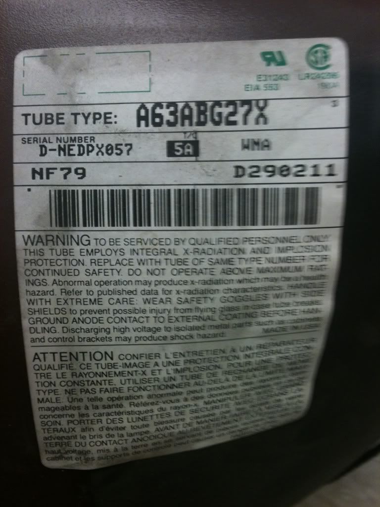

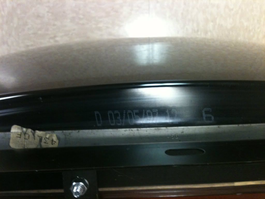

Here's the label off the tube
Date etched on tube itself 03/05/97
Label
lilshawn

WOW... hey rick, check this out... http://www.searspartsdirect.com/partsdirect/part-number/A63ABG27X/0057/060
was just gooling the tube number to confirm the heater voltage and bam, sears parts direct has them still.  :-\
EDIT:
oh yeah, the heater voltage i have confirmed should read 6.3 volts. It's a CR23 socket so it should have the heater on pins 9+10
sometime printed on the solder side of the neck board there will be some letters designating the pins. (G1 gnd etc) You are basically looking for "H"... i ripped this pic just as an example...it's not the same but it's similar.
if you power on the monitor and read the DC voltage on the 2 pins  it should be 6.3 (or very close to...I would say 6.0-7.0 would be acceptable) use caution when poking around the back...there are nasty voltages that can kill you dead if you start getting all poke happy.
