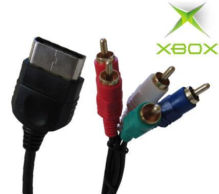

hardware only solutions- any xbox
find an LCD monitor or TV that supports Component (green, blue, red RCA) video.  I don't think s-video or composite are worth messing with after comparing them to Component.
Get a high quality component to VGA converter
Get one of the VGA output timer boards that converts from xbox to vga + jamma.  I bough one of these for testing and will be throwing it on eBay soon.
software + hardware- xbox 1.0-1.5
The cable lilshawn linked to is an option if you don't mind soldering.  It will require a bit of software change using Frostythesnowman's (refered to as frosty most of the time) sofmod patch or hard mod bios to properly output.  I personally find that native 1280x720 via VGA is the best looking solution if your monitor doesn't support the same resolution via component cables.
I made my own just to try it but I doubt I will do it again since I have found easier solutions.
I will be adding the LM1881 and other items in the link lilshawn posted just because I want to mess around with hardware based scanline generation but the etra hardware is not required at all as long as your monitor supports sync on green and you don't care about SLG.  Basically any monitor that has DVI as well as VGA will support sync on green.  I picked up the monitor in the pic above from goodwill for $12 after finding it on this list of monitors that support sync on green: http://ps-2.kev009.com/sog/
If you get a monitor that supports sync on green and you don't want to mess with SLGs, it is super easy to do what you want.
get a standard xbox component cable + this $1.90 cbale from monoprice:
http://www.monoprice.com/products/product.asp?seq=1&format=2&p_id=6025&CAWELAID=1329452164&cagpspn=pla&gclid=CJnBkISqkrMCFUZgMgod62kAqg
+ this $.68 coupler from monoprice:
http://www.monoprice.com/products/product.asp?c_id=104&cp_id=10430&cs_id=1043009&p_id=3002&seq=1&format=2
With a frosty patch on your softmod + your xbox (1.0-1.5) set to allow 720p + a sync on green monitor, you are done.  I have personally done this and it looks great.

hey Sharp, i've got a softmodded xbox and i'm using the monoprice cable in your link with the MS hd pack with the frosty vga bios and i'm getting these faint vertical lines on across the entire screen.  Any ideas on how i can fix that at all?  Also wondering if you know of a do it yourself route for scanlines in coinops instead of purchasing a slg?  Thanks
sharpfork
  • Posts: 618
    • KADE
Re: Best LCD monitor for ORIGINAL XBOX
« Reply #17 on: October 25, 2012, 03:47:22 pm »
Is 720 enabled in the Xbox dash?
Do you have it set to narrow or widescreen that matches your monitor?
roxashd9999
  • Posts: 8
  • Last login:July 08, 2015, 09:18:41 am
« Reply #18 on: October 25, 2012, 03:54:03 pm »
Yep 720p enebled in MS dash and screen set to normal, i have a dell 2007fp which is 4:3

So i tried to take a pic of what you asked for but its not clear enough to read.  it says its displaying 640x480 at 60hz and that optimum resolution is 1600x1200
Your monitor is running at 480 instead of 720.  I forced mine to go into 480 and it just looked fuzzy, no line issues.
Your cable looks correct but that doesn't mean that it doesn't have issues.  I see two potential issues off the top of my head--> crappy cable or monitor that doesn't support 720 that is messing with the image when it converts it to 480.
What is is your monitor brand and model?
Have you tried the xBox on your computers monitor or TV with VGA in to compare?
Have you tried the component cables into a TV directly?  The colors will be off with the VGA mod but you should still see a picture and still be able to tell if the line issue is there.
I have had a simliar vertical line issue when I bought a cheapo component cable off fleabay.  But, a bad cable really doesn't explain why your monitor is running a 480 instead of 720.

wtf? that just works with a simple component to vga cable? assuming there wouldn't be any issue with 480p either? confirm plz thanks :burgerking:
sharpfork
  • Posts: 618
    • KADE
« Reply #32 on: November 08, 2012, 12:34:28 pm »
That cable setup + frosty bios (512k+) or softmod hack + monitor that supports Sync on green and correct resolution (I use 720p = 1280×720) and you are good to go.  You can add a few other components to support non sync on green monitors and SLGs if needed.

I've tried 5 or 6 older monitors, mostly Dells and Samsung and have never run into the problem with the resolution. showing correctly.  I mostly pick up LCDs at goodwill for bartops for friends and family if they meet the following criteria:
  • for VGA in, they either have both DVI + VGA in or they are on this list as working if they are VGA only: http://ps-2.kev009.com/sog/
  • they have component in (by far the easiest to setup with a console)
  • they are 17" or bigger & cost less than $20 and are worth a risk
When I get some time, I'll try to see if the Dell I'm using on my VGA bench testing system officially supports the resolution & is documented or not.  I haven't really given this much thought other than trying to help figure out why roxashd9999's setup isn't working like it should be.  I'l also ping my buddy rablack97 who is testing Component -> VGA converters to chime in here.

I use nothing but Dells, they are cheap as folks are getting rid of the 4:3's for the widescreens.
I softmod all of my xboxes.
Now Frosty's dual boot vga softmod hack has it's pros and cons, but you have to have the right setup.
SOG monitor, 1.1 to 1.6 xbox.
You can't remove the DVD rom from your build using frosty's dual vga hack as the code somehow looks for the drive, and you can't even trick it by taking the board out.  It takes a fully assembled functional DVD drive to work.
In my testing it seems to be very picky in regards to the monitor, MB, and the program running.
The dash will show crystal clear and as soon as Coinops booted i got lines and flickering.
So it's a trial and error if you go with the softmod vga hack, you will have to do some tweaking to the monitor, and the xbox settings...
This is the cheap route.....using a monoprice vga to component cable, HD xbox cable, and an extension adaptor....
http://www.monoprice.com/products/product.asp?c_id=102&cp_id=10235&cs_id=1023503&p_id=6025&seq=1&format=2
http://www.ebay.com/itm/NEW-HD-Component-AV-Cable-for-Original-Xbox-/390400069193?pt=Video_Games_Accessories&hash=item5ae5a84e49
The more reliable way is get one of these.......vga cable, and an xbox HD cable
http://www.ebay.com/itm/5RCA-YPbPr-Component-VGA-Audio-Video-Converter-1080P-/390201866611?_trksid=p5197.m1992&_trkparms=aid%3D111000%26algo%3DREC.CURRENT%26ao%3D1%26asc%3D14%26meid%3D3574943772380201650%26pid%3D100015%26prg%3D1006%26rk%3D1%26sd%3D390201866611%26
It can be decased to fit in small areas.  It's 35.00 but for the quality of picture and resolution its worth it.  Tons of resolution and zoom modes.
I got rid of the flubber etc, by installing a 5v delay relay to the monitor and my amp.  Then usining the external delay from KADE, i hooked up a small SPST relay to the converter.  So basically whats happeing is i'm letting the xbox do its thing before sound and video is activated.  Once everything fires the xbox is at the dash.....This is for softmodders though....hard modders can manipulate the bios....
http://www.suntekstore.com/goods-14004188-h3y-2_dc_12v_delay_timer_time_relay_0-10_second_w_h3y-2_base.html
