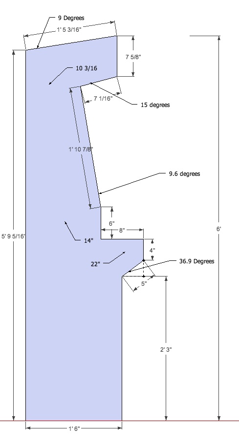

At this point I was back at the drawing board, which I liked, free to do anything, build anyway, be unique. So what did I do? What a lot of other people have done, based the design off of Knievel's slim (unique alright  :laugh2: ). After some research I got the approximate dimensions and made some alterations. Here is a sketchup drawing of the side profile for anyone that might be interested in my design.

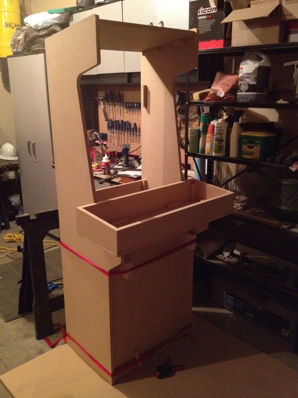

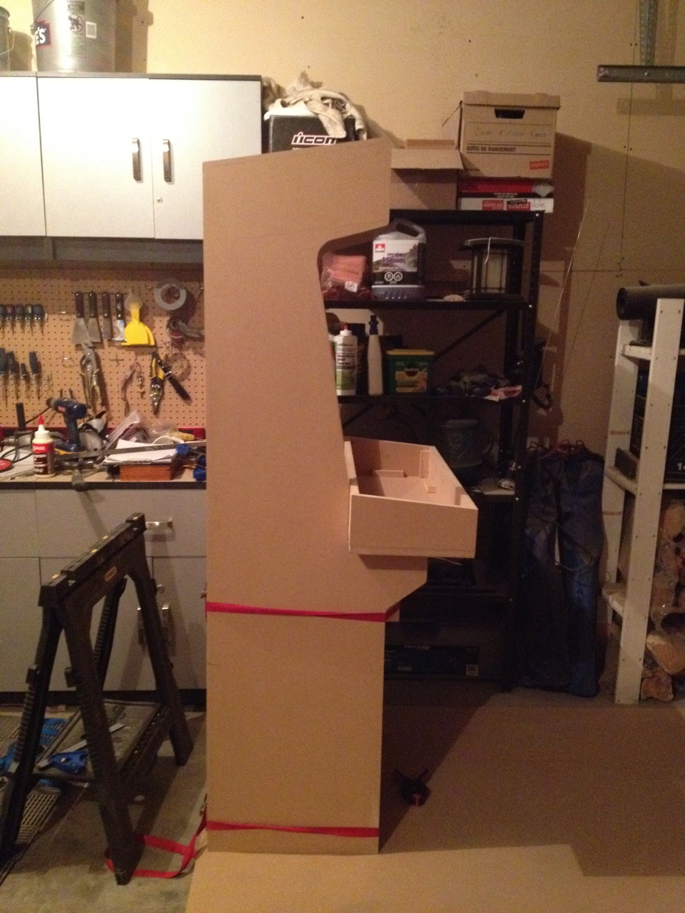

Fast forward 2-3 days later, I have the exoskeleton of my cabinet! (ignore the CP, I will get into that later)
For anyone wondering the width of the cabinet, I made it 24" between the two side panels, thus 25.5" edge to edge.

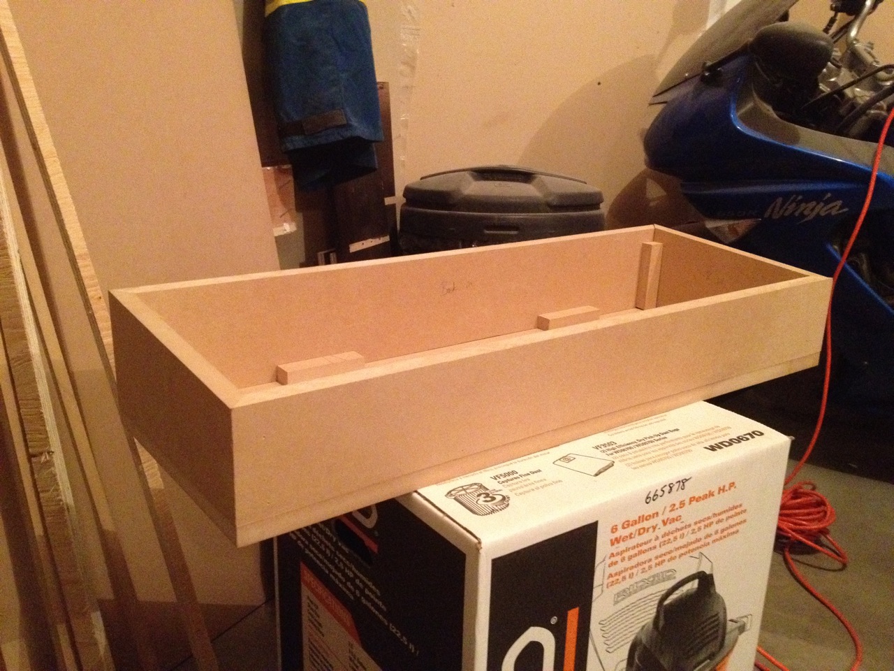

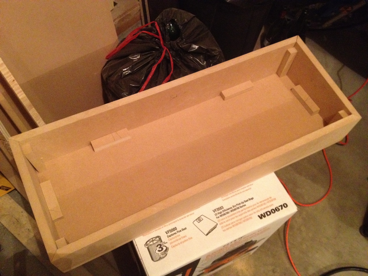

I also spent one night building the base of the CP, this was the first time I have ever tried miter cuts and it turned out so so. Not horrible not perfect, liveable. Anyway if I can give anyone some advice it woudl be to make the side panels the entire height of the CP base, instead of what I did. I fastened the side panels on top of the bottom panel. This will require a bit of bondo and sanding later .....
Here is the first question, what is everyone using for control panel top? It seems like its 5/8 MDF and 1/8 plexi? Home depot only seems to sell strange thickness' such as 0.080" 0.157" 0.118" etc. Which of these is the one I should use to get the nice 3/4 total height and be able to hide it all with T-Moulding?
