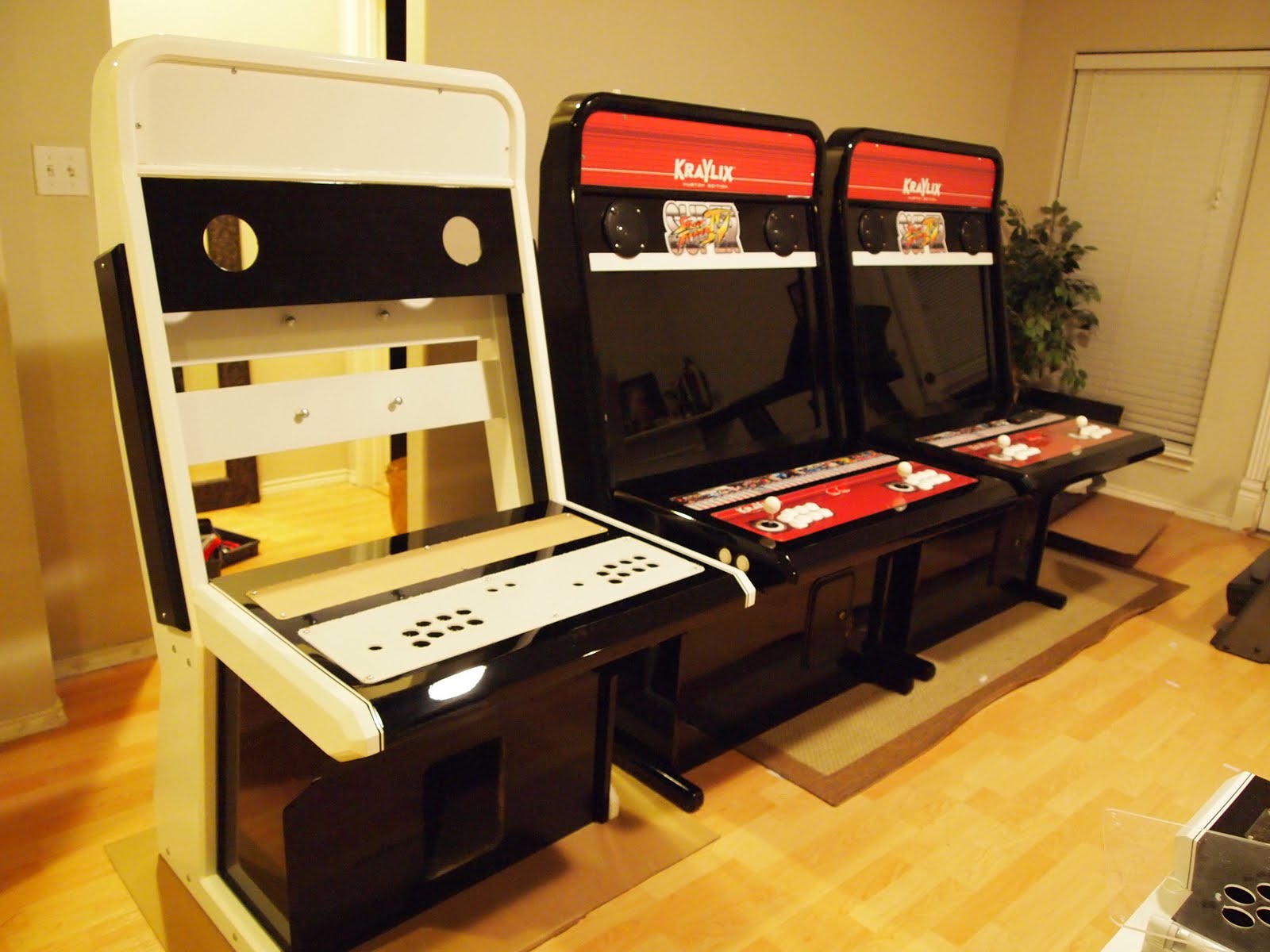

You'll want to get in contact with Kray.  He makes custom Vewlix cabinets for consoles.
He has sites here:
http://customvewlix.blogspot.com/
and here:
http://www.kraylixarcade.com/
Example pic:

Yeah, now that I see that site, I've seen Kray's work before and it's pretty amazing.  As you'll see on the site though, he's not cheap either... and you'd be dealing with shipping from TX to NYC... woof.
