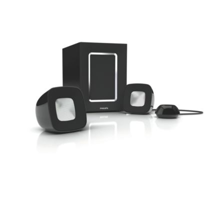

I bought some cheap 2.1s from Wal-Mart and could not be happier.  And they had a remote for volume control.  The only downside is that I needed a headphone cable extender because the lines from the mini speakers to the sub were only about 4 feet long.  Not the end of the world.  For under $50, I can not complain.  The sound is more than sufficient.
As for the sub, it is pretty darned small so if you need to pack things in your cab, it would work out nicely.  All 3 speakers are very compact in design.
link:
http://www.walmart.com/ip/Philips-2.1-PC-Speaker/14913320
Should be available in your store.
