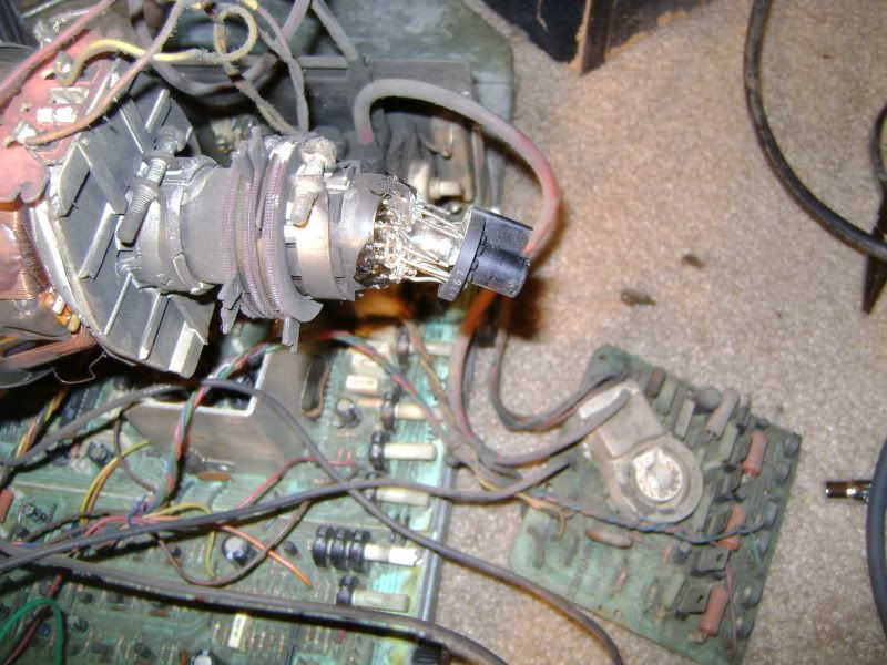

Ok so after removing the monitor from the cab I noticed this..  I'm not going to go all CSI on this but I'm pretty sure what happened here is some kid thought it would be funny to dump his soda into the fan on the back of this cab.. this would explain why the monitor board had a bunch of brown sticky substance all over it..  :applaud: nice job kid
Well a day passed of me checking all the soldering and connections on the monitor board and was contemplating whether I should just replace the whole monitor or get a cap kit and try to salvage this..  but then this happened..
My fiance was walking by it when her robe got caught on the corner of the neck tube area and literally snapped it.. thing exploded and made a loud hissing noise.. sounding like its last gasp of air.  Not a big deal, nobody got hurt.  Well, guess I kind of have to get a new monitor now.. Anyone know much about what kind of monitor is good/compatible for this game?

It's just a standard res shelf mount monitor.
 If you can find a 19" TV (older) you can probably do a tube swap.

I've been trying to figure out how to connect the Outrun wires to the new monitor..  The previous board had 2 spots for both molex pieces but the new monitor has only one spot so I'm just trying to figure out how I need to rewire them.. and what size molex piece I'll need..  hopefully this will at least fix the no picture issue.  *fingers crossed*

Well..  before mounting the replacement monitor in the cab I wanted to test it first.  Connected the wires, turned it on, and still no picture..  in fact it started to smell like something was burning so I unplugged it immediately.  Plus I wasn't even seeing any neck glow

I connected the wires to the monitor but was getting nothing, then I noticed one of the fuses on the bottom of the cab was blown, (32V?).. I found a 250V fuse layin around and put it in.. don't know if that's bad.. but it turned on the monitor!
I was getting all these black & white diaganol lines scrolling on screen.. no sound/no picture.  I pressed the Test button inside the coin door and I got to a blue screen with some scrambled scrolling words..  I changed around the wiring until I finally got it to stop rolling but it's still kind of messed up..  did I connect these wrong or am I missing something?
I know I connected the RGB wires correctly.. and I think the white wire is ground.. but I wasn't too sure about the blue/white striped one..
Then the power cord had 3 wires coming from the monitor.. but I only have 2 wires running up to it..?
I ran all the diagnostics and everything tested good when asked to press, steer, shift, coin, etc..
all the music and sounds played except for #13.  Voice 4..
After I exit the diagnostic menu it does nothing, screen just stays black..  no sounds/picture.  When I try to coin up it does nothing, well.. it seems to record it in the book keeping menu and also the service credits shows up there too when I press the service button..
What is wrong with this thing??!!?
