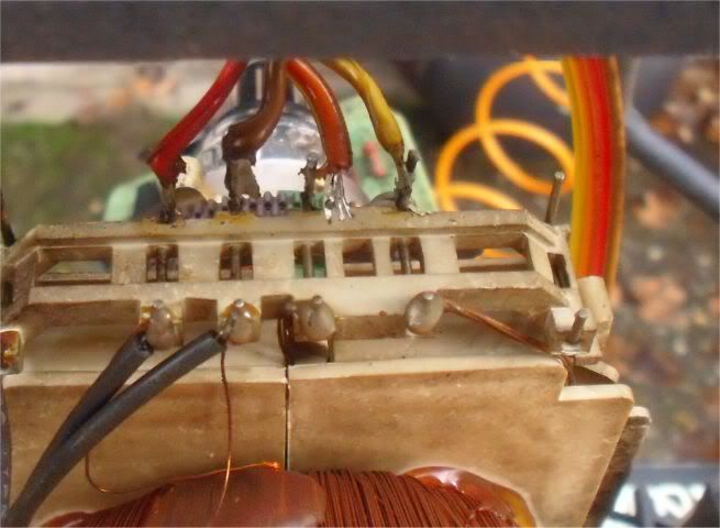

First thing I saw was a bad solder joint here (the orange wire next to the yellow wire):
That will be an easy fix, but where is this connection for?

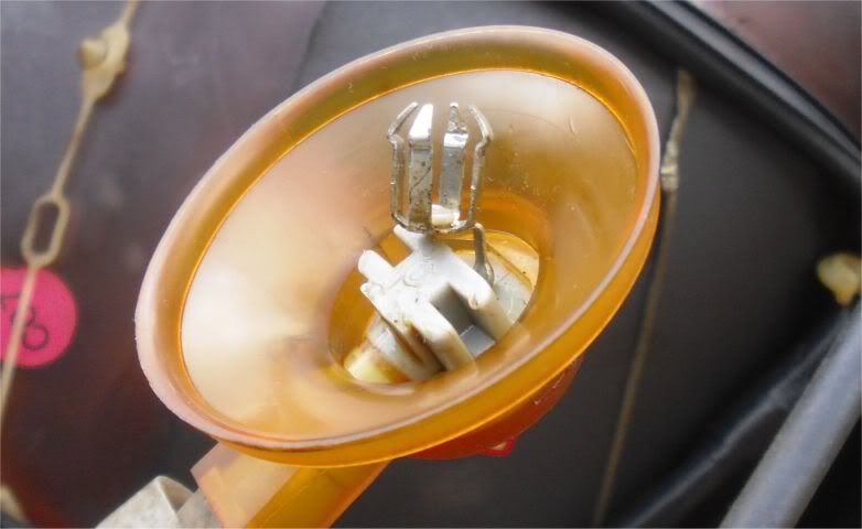

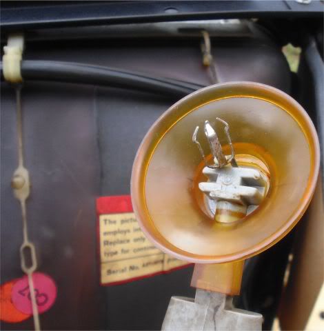

Then I noticed some problems with the suction cup. A few little plastic parts inside the cup were broken off:
What can I do about this? Buy a complete new suction cup? If so, where do I get one, complete with the wiring (grey wire, blue wire and little orange wire)?

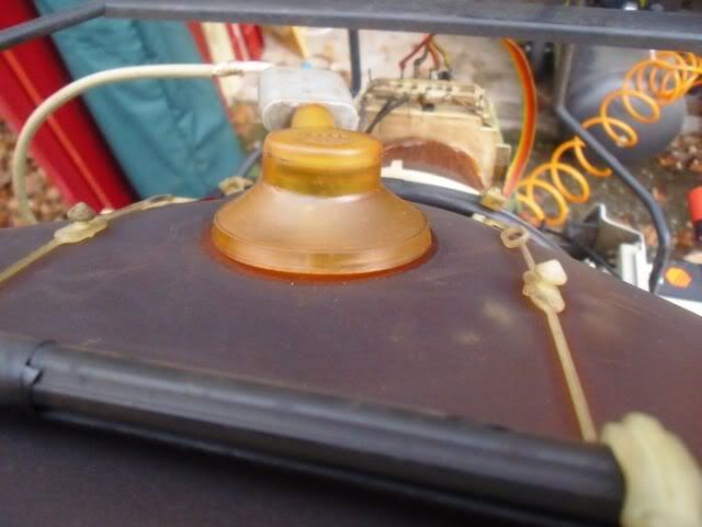

Last thing I noticed is that the suction cup isn't firmly attached to the monitor:
This is probably because the sticky grease is gone. Is it special grease and where can I get some of this suuf?

I think that's your yoke connector.  Very important.
As for the "grease" it doesn't help it stick, it's to prevent moisture from building up under the anode cap.
That's an unusual connector for your anode, but it looks like it just pops right in to the anode hole.  There's only one wire there, and it's heavily insulated.

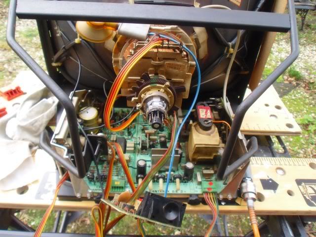

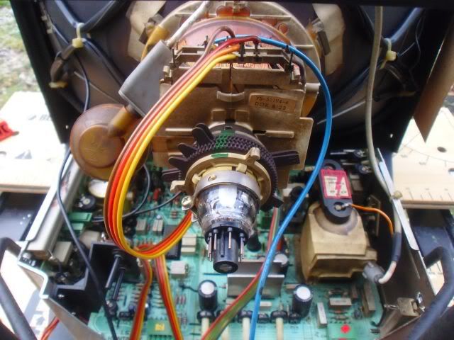

No, there is also a blue wire, you can see it better on the following photo. It is connected with the neckboard.
And there is a small orange wire which comes out of the high voltage cable, you can see it in this photo on the right bottom side:
But how to solve my issues with the suction cup?

I have the same issue with the cup with mine. The problem is that they chose the wrong kind of plastic for it. It's "see through" and that kind of plastic gets harder over time. I'm sure there are more scientific ways to describe it, something about thermoplast/ thermo-harder/ weak-makers etc. etc. but the result is the same. It sucks. I mean, it doesn't suck anymore.
On my monitors they tried to "fix" it with some kind of gel which seems to not really work.
The typical two wire set-up is weird too.

Oh, I did 'fix' the suction cup witht two component glue, it's solid as a rock again. But I have to determine if it's really OK in a live test of course, just waiting for the game board, Vanguard, which is on its way.
