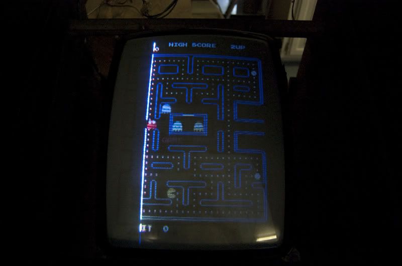

I've re-capped it. Checked all the soldering, adjusted every dial I can find, everything seems to be ship shape.
The color and picture look as sharp as it did in 1981 - the part you can see, anyway... But as you can see, the left side of the screen has really bad foldover. If I adjust the width any higher, the right side folds over too. I also can degauss my tube, there is still discoloration in the lower left side of the screen.
Is this a width coil problem, a HOT problem, or should I re-cap all the brown film caps? I can't find any flaws in the tube or neck.

So you already recapped these boards on the monitor:
main board
XY (hor/ver) board
video interface board
power supply board
And you still have foldover? Then replace both vertical output transistors on the XY (hor/ver) board.

I don't have much electrical repair experience beyond capping a monitor.
Which two are the vertical output transistors? Are those TR306 and TR352?

double check caps for correct polarity.
 then recheck:
c306 2.2uF/50v
c303 47uF/50v
c310 22uF/16v
