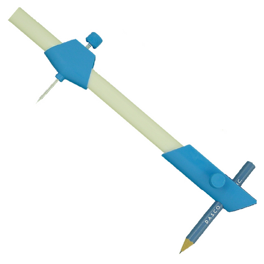

Drafters have a tool called a "beam compass" which is essentially a metal bar with a pin on one end and an adjustable holder for the drawing tool on the other. You could probably fabricate one out of stuff you have in your house, unless precision is a must.

I'm a draftsman by trade so I lean towards a beam compass. The one I have will draw 36" circles. It's surprising how large of a circle you can draw since you only need the radius. The string and pencil trick is certainly a close second.
As for cutting a circle, the easiest/best way is to use a circle cutting jig with your router. Perfect every time.
http://www.woodworkingtips.com/etips/etip102000sn.html

I personally use a piece of wood lath or aluminum flat bar with holes drilled for the nail, and one for the pen/pencil just large enough to fit the tip of the pen/pencil through.  That way little or no tilt can occur.
Maybe I am just anal retentive, but thats my personal preference.

Personally I just make a router jigg and cut at the same time I measure.
1.  Get yourself a nice sheet of 1/8 inch plywood.
2.  Remove the plastic base plate on your router
3.  Trace the plate on your plywood.
4.  Use a yard stick to draw a large rectangle extending from your plate tracing (4 feet is good).
5.  Cut out the whole rig, drill holes in the plywood where the screw holes were on your plate and screw the plywood back on instead of the plate.
Now what you have is a compass set with a router on the end rather than a pencil.  You can use a yardstick to measure for the pivot hole to drill.  Your circle will be twice the width of the length from your hole to the inside edge of te router bit.
When you are ready to make your circle you put the piviot hole in the apropriate place and literally screw the whole thing down by putting a screw through the pivot hole and attaching it to the piece of wood you are cutting.  Now it's impossible to cut a bad circle as your router is locked in a circular path with no "wiggle room".
You have a small hole to deal with from where you mounted the rig, but that can be filled with putty and no one will ever know.  This method can be used for outside cuts as well, you just get a scrap piece of plywood the same thickness and butt it up against the piece you wish to cut.

If you search "router trammel" on google you'll get a few online versions of what Howard says above. Router is the most accurate way of cutting a circle, bar-none.

Okay, okay, I missed that. :dizzy:  To make a circles up to 5', I bought a 5' metal yard stick at Lowe's.  I have various sizes of rulers and yard sticks.  I use one of those router attachments to cut circles up to 24"'s.  To make curves that big, I buy 1/4" foam board that has 1/2" squares on it and draw the curve out.  I made a header for my bookcase/entertainment center that had a 5' French curve in it and that is how I did it.  I just traced the pattern onto my wood, cut it with the jig saw, and spent my good ol' time sanding it smooth.  A belt sander can really take off the wood.  I then used a smaller sander once it was very close.
BTW, with a protractor, I was just reading the instructions........yep, it does semicircles also.  Says here, you can stop it anywhere you want.
http://www.greatbigstuff.com/draftingtools.html
Also, I think I meant a compass:
http://www.lowes.com/lowes/lkn?action=productDetail&productId=142040-1431-1405&lpage=none
From the website:
"Add a longer 1/2" dowel for larger diameter circles"
Sorry, I should've just found this in the first place.
