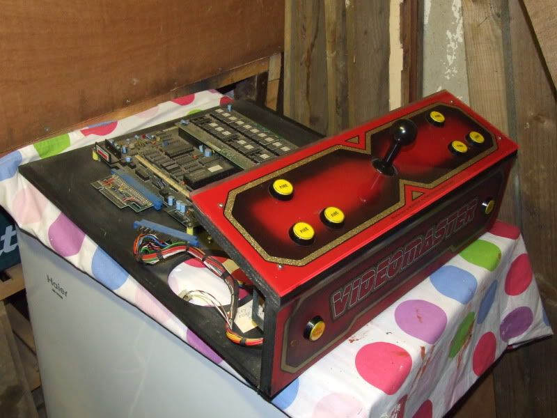

i think them cabs have the pull out tray cp.means the control panel slides out.
Looks like you are right, Ive just found a pic on the net
saleem
  • Posts: 437
Re: My Cab Project
« Reply #9 on: August 14, 2009, 06:24:18 pm »
if you look in that pic you posted,see the insides? where all the wires are,thats an alternating power supply if i aint mistaken for a jamma set up.
yours should be similar.

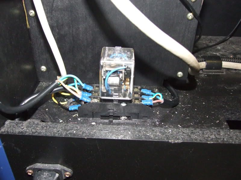

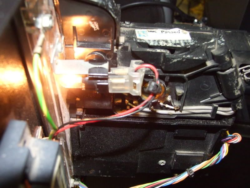

I collected it yesterday. The cabinet needs a little attention. The fault it had was simple to repair, Every pin on the line output transformer was dry. I fitted the AVGA card, Connected it all up and it works spot on. Just need to give it sound and a controller interface. It is a jamma cabinet with a Sega system 16 board and adaptor.

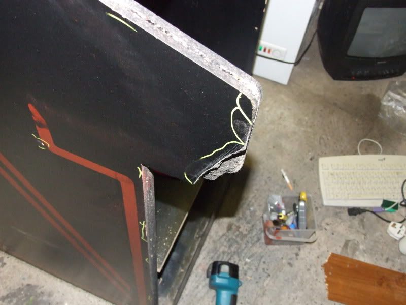

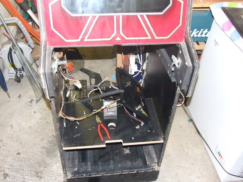

Ive started the body work. It needed some attention to the cabinet, A few chips and a broken corner. Ive repaired it with P38 car body filler. Ive stated to rub it down, Once it has been rubbed down, It is going to be painted. Ive put the game board on ebay as I have no use for it. When I stripped it, I found about a tenners worth of 20p's.
Some before, During and after pics here

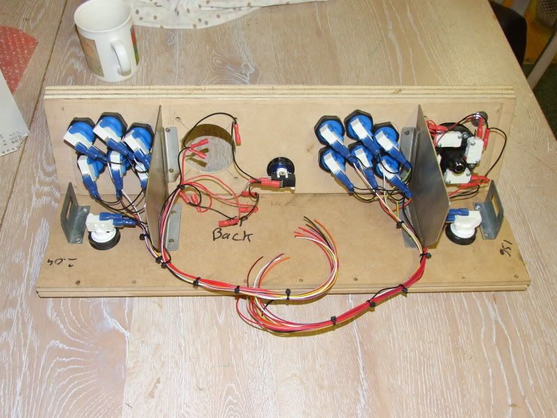

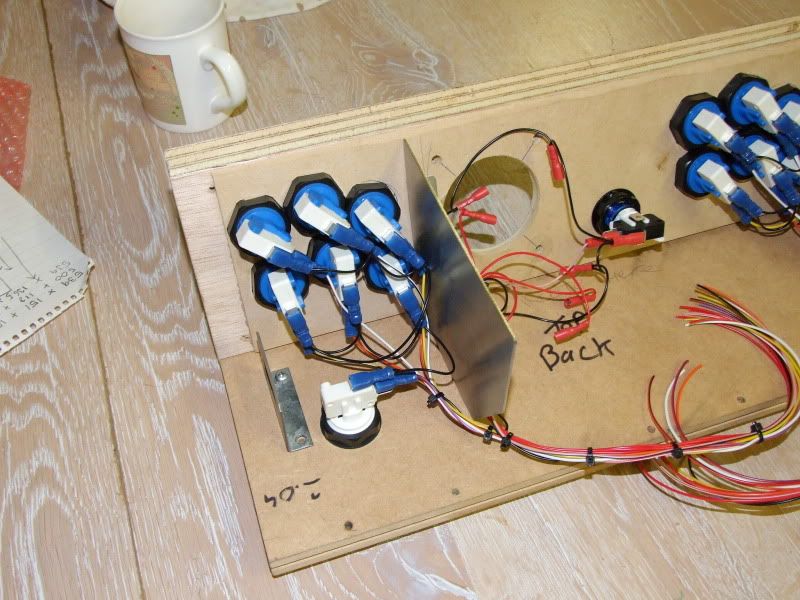

Nah, Im Rewiring it, Fitting a computer that is already done and fitting I-PAC. Im still keeping the coin mech though, A money box with a bit of fun attached.
I use my Fruit Machine as a money box, Problem is, When I win any money I spend it. Not a very good money box after all, Still fun though

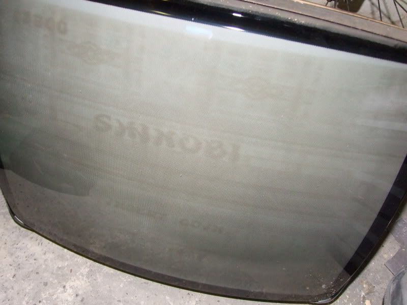

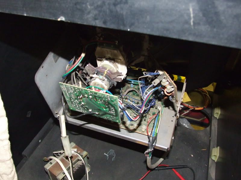

Ive decided to replace the tube, 22 years of playing Shinobi has taken its toll. The blue is flairing but the tube is scared to hell. Ive gotten hold of a tube but its a 21", Mine is a 19". Ive wired the scan coils and tube base from the chassis to the replacement tube, It all works fine with a cracking picture. Ive now got to alter the metal frame to get it all to bolt together.

« Reply #16 on: August 25, 2009, 05:20:25 pm »

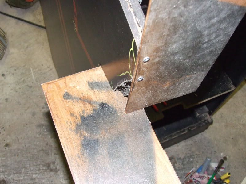

The tube is fitted now. I bought a new piece of 18mm plywood to mount the tube and chassis. I had to use the original tube base for the tube drive
I took wires from the original tube base to the new tube base.
The new screen mounting, Just needs painting black
The old tube

Kept the monitor electronics?  Did you do a cap kit beforehand?

I did use the original PCB. I havnt fitted a cap kit but Im going to. I dont think there is a cap kit available in the UK so I will have to make up my own kit. I was a TV engineer for 9 years, The bloke that I worked for is still going so I will pop down to him and get the caps.

« Reply #21 on: August 25, 2009, 09:12:19 pm »
Sounds like a plan..  :cheers:
It will most likely solve any color shift or bleeding you may be experiencing on the CRT.. although it sounds like it's looking pretty good as is.

Ive just ordered a cap kit and width coil from Bob Roberts. To be honest, I dont think it needs a cap kit, Im just fitting one whilst it is all in bits. I needed to change the width coil as I fried mine. I used a metal allen key cos I couldnt fine my plastic one. It got really hot and melted, It still works, I just cant adjust the width.

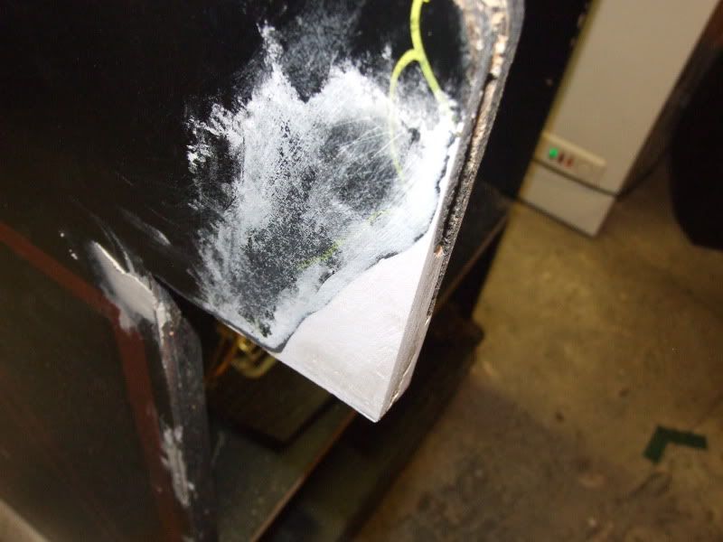

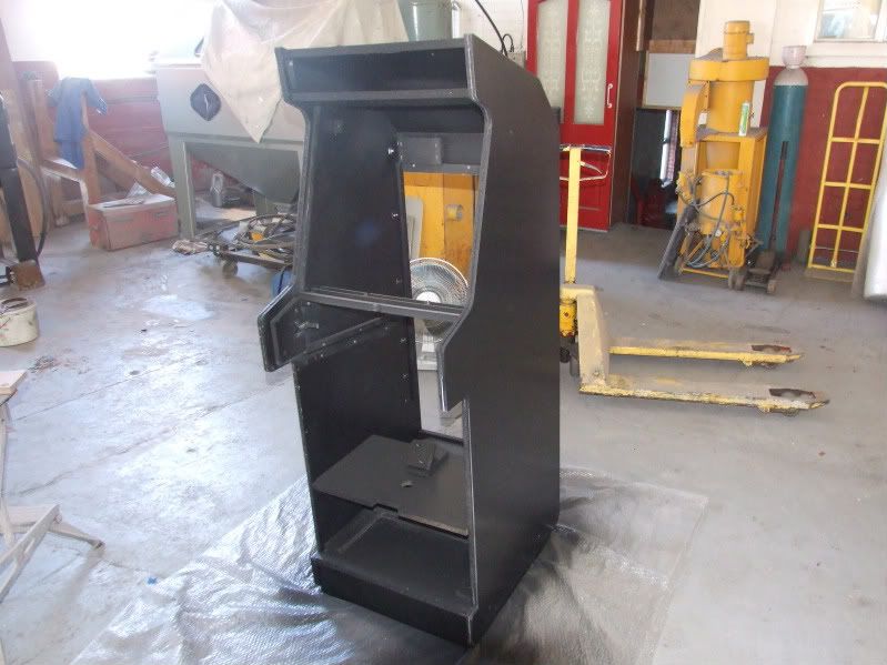

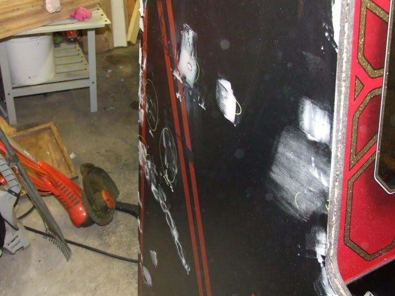

Just a quick update. Ive filled and primered one side, The top and the front of the cabinet. once the other side is finished, Im taking it to be painted. I need to get the artworks, CP, T Molding and controls sorted out next.

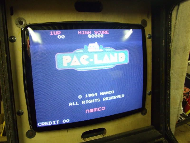

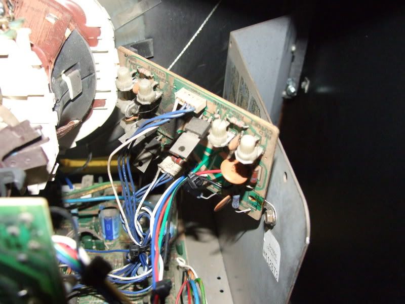

The cap kit and width coil came on and Wednesday I fitted them on Thursday. I took the cabinet to be painted on Friday, It is ready but I was too late to pick it up.
« Last Edit: September 05, 2009, 06:25:47 pm by Avinitlarge »

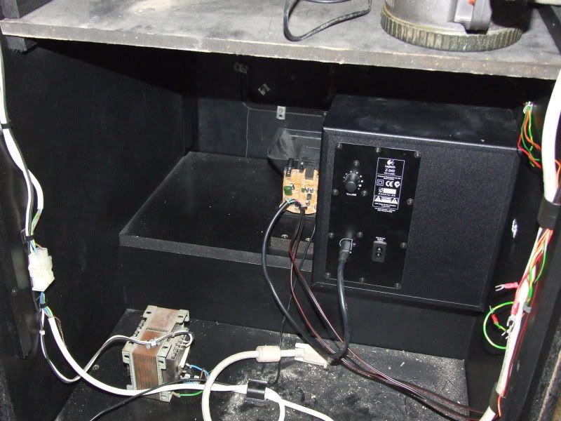

The cabinet is painted and back at home. Ive started to rebuild it, Didnt get very far though. Ive ordered 2 new locks and the T Molding too.
Im gonna try and get more done tomorrow. Fitting the new Labtech speakers is the next job.

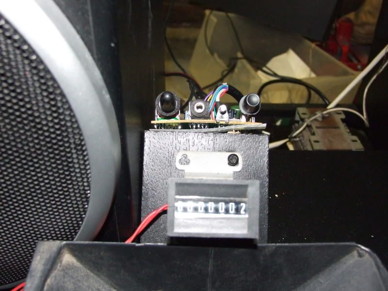

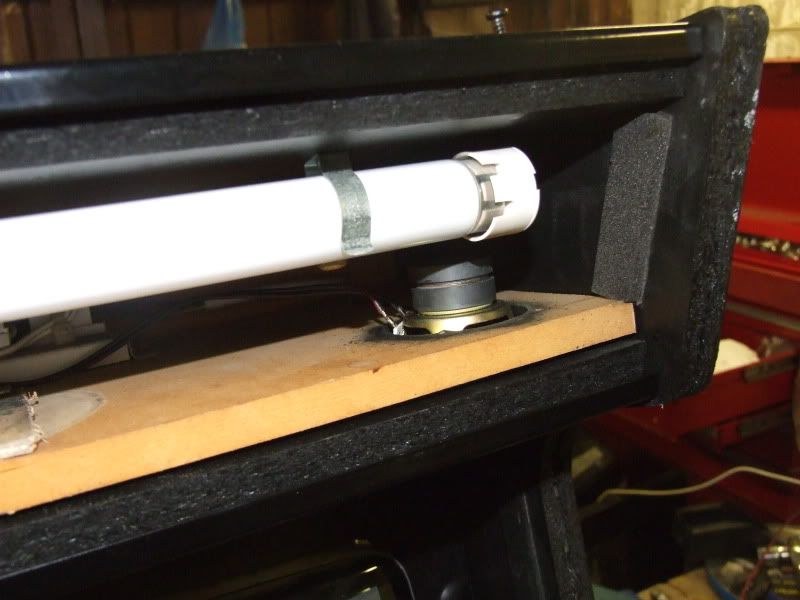

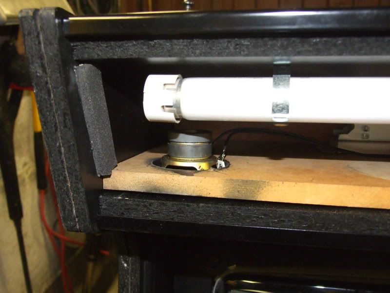

Ive got the speakers fitted. One of the satellite speakers had the volume control and power switch mounted in it. I shortened the cables from the main sub/power supply then mounted the PCB on the top of the coin counter. The satellite speakers are only small but sound really well. I also fitted the marquee light whilst I was at it.

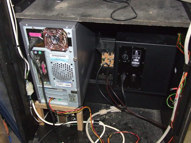

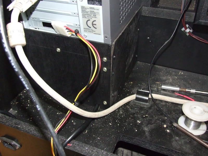

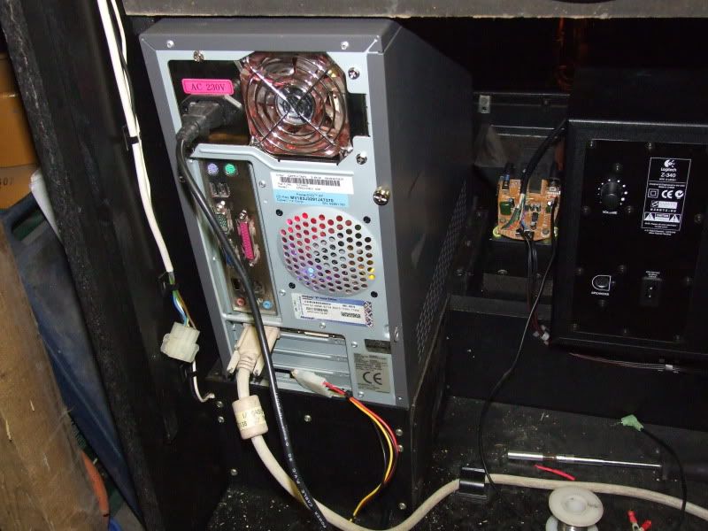

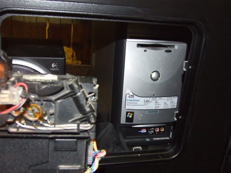

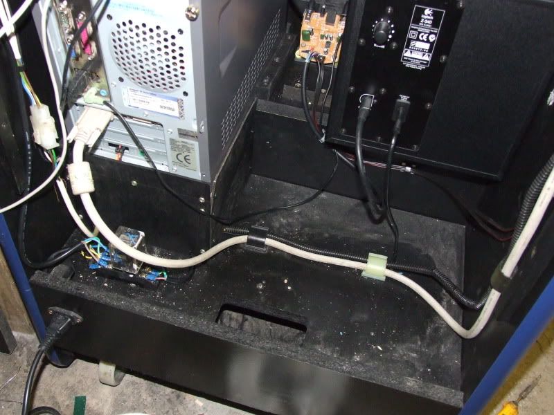

Ive just got the computer mounted, It was a tight fit but I got it in there. I had to make a bit it a frame to hold it in place though. The bulb holder for the coin reject came yesterday so I fitted that too.
« Last Edit: September 16, 2009, 07:56:37 pm by Avinitlarge »

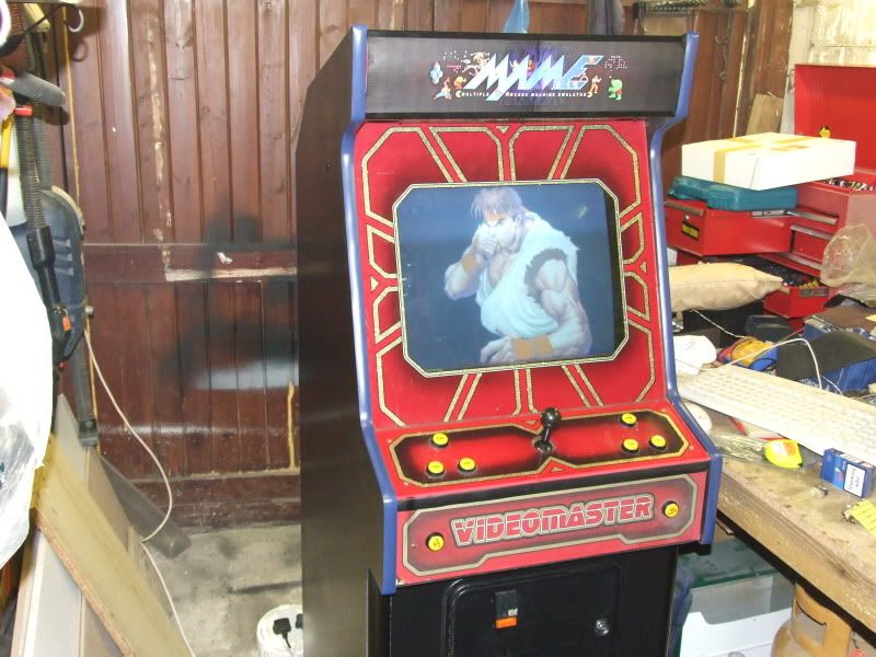

This is as far as it gets for a while. Ive got other things my money has to go on, Birthdays, Christmas etc.

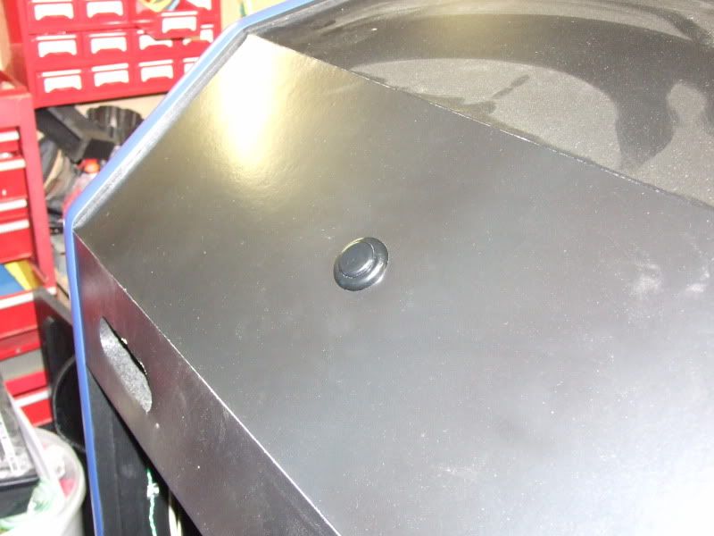

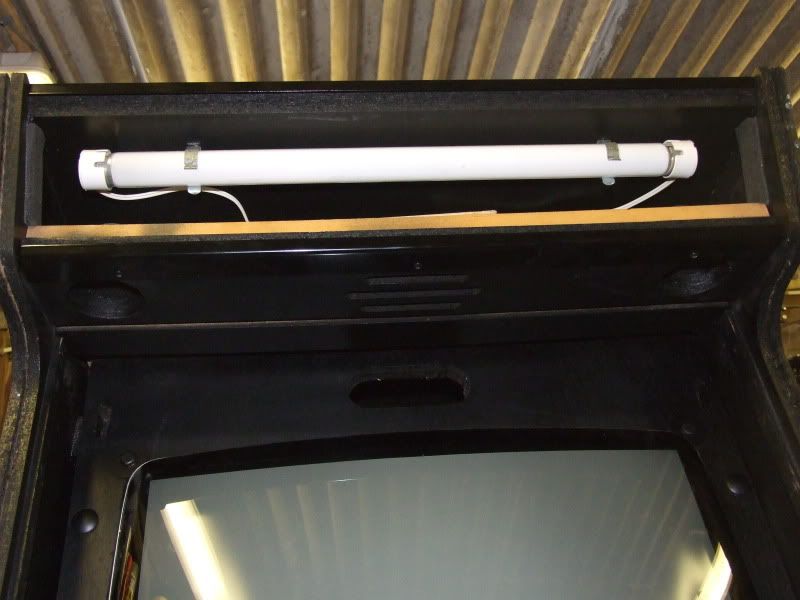

The T Molding came today, That is fitted. Ive built it back up so Nothing gets lost or damaged.
I need to get the CP, Screen bezel and marquee sorted. I also need to finish sorting the frontend out. I am using maximus arcade. Apart from that, Its done.
The Marquee in the picture is just a paper test one, Nothing permenent.

Videomaster is a neat name for it as well, or make the marquee match the cab....MAME MASTER

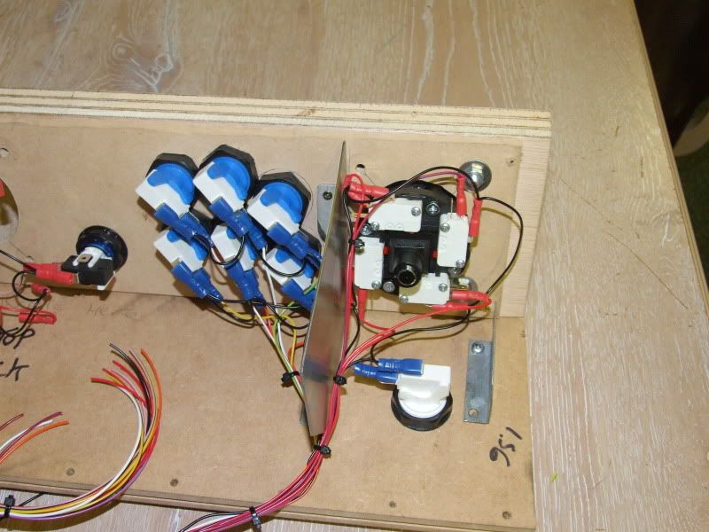

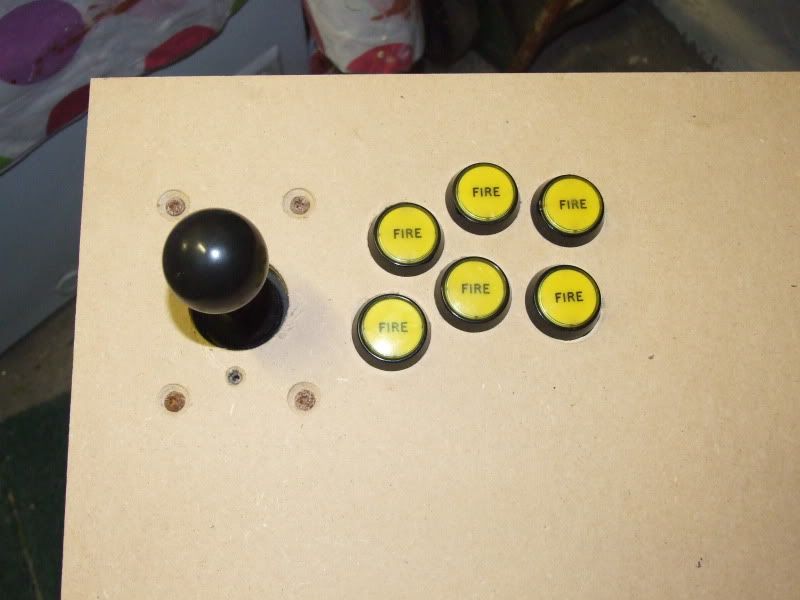

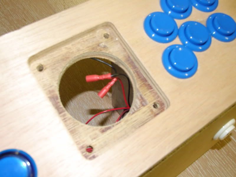

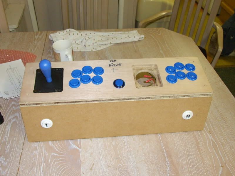

I decided to finish my USB gamepad hack today. Now all 3 buttons work, The 1 & 2 player buttons work and the coin mech works as it should. Dont think I will bother with a mini-pac or IPac. When I add the new controls, I will just use another hacked gamepad. Its easy enough to do and its alot cheaper. I just wish I had enough money to get it totally finished. :hissy:

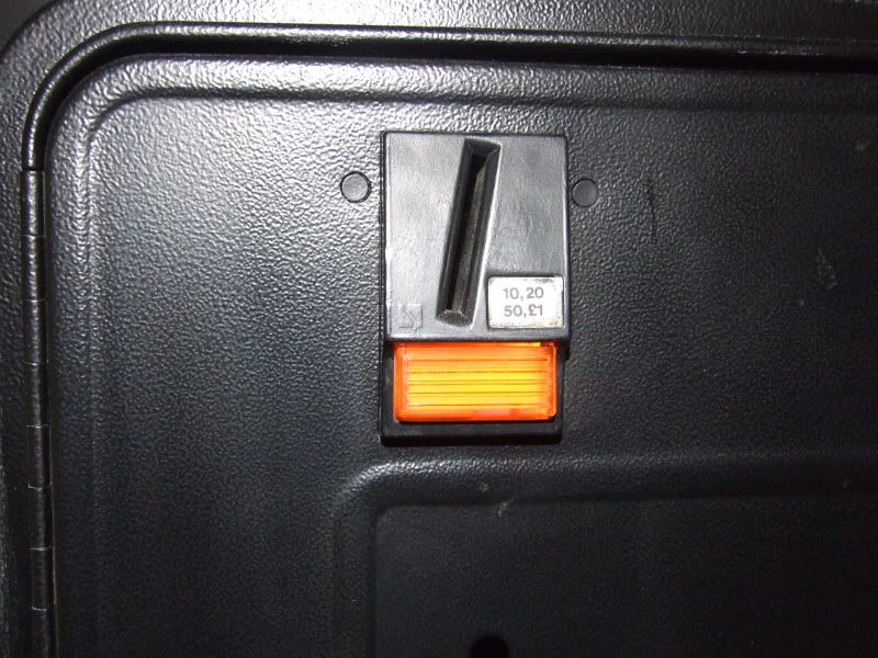

Ive just replaced the coin validator. The coin Validator I had fitted wouldnt accept the new 50p. I used my old fruit machine coin validator with the coin seperator removed, altered the routing plug, Converted it from a top entry with bottom reject to a front entry with front reject . It now accepts 10p 20p 50p & £1.

This is the very last thing for definate. Fitted an industrial relay to turn the Monitor, Marquee and Sound on. They all come on and go off when the computer is powered up and down. I just get a horrible cracking sound from the speakers when it is powered down, I need to take a look at that.
I also tidied the wiring up a bit.

Ok, Maybe the relay wasnt the last part. Ive fitted a power button. Ive mounted it on the back so the kids cant get to it easily. It is wire in parallel with the power button on the computer. It also has a 2 pin plug so I can disconnect it if I need to remove the computer.

Ive also made up a dummy control panel from a spare piece of MDF, Joystick and buttons. I had. I just wanted to see how it looked and felt. I am happy with it.
BTW, This wont be my proper control panel, Just a Tester.

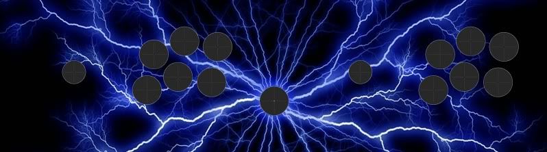

Ive finally designed the CP front and CP top. Ive also done the marquee. They may not be everyone's cup of tea but im happy with them
CP Template
CP Top
CP Front
Marquee
« Last Edit: October 05, 2009, 02:20:10 pm by Avinitlarge »

Ive finally made the CP. I thought I had bought everything. Today I realised I had only bought one joystick  :censored:
The Buttons are IL from Ultimarc, The JS is a Happ Comp from Gremlin and the Wire came from Swallow AM.
The 2 Stainless Support bracket were made at Anchor Stainless in Sheffield (The home of Stainless Steel) by my mate that owed me a favor
Franco B
  • Posts: 3766
Re: My Cab Project
« Reply #38 on: October 17, 2009, 02:38:54 am »
Red and black euro cabs for the win!  ;D
Yours is looking great. You got a bargain too!
I like what you have done with the CP, very tidy  :applaud:
Mine has the same kind of CP opening mechanism/PCB mounting board. I was thinking of making a new CP for mine but its a fabricated steel job and it would be a ---smurfette--- to reproduce. I probably could do it but the layout isn't too bad. Its only three buttons but I'm only using it for Jamma and Neo Geo MVS carts. The spacing is a little brutal but I think I will cope. I think I'll just get the CPO reprinted as its a little beat up.
Great job on all of the wiring/electronics, you definitely know what you are doing :)
CP Top
Do you have this lightning artwork? If so could you email it to me? TIA!
