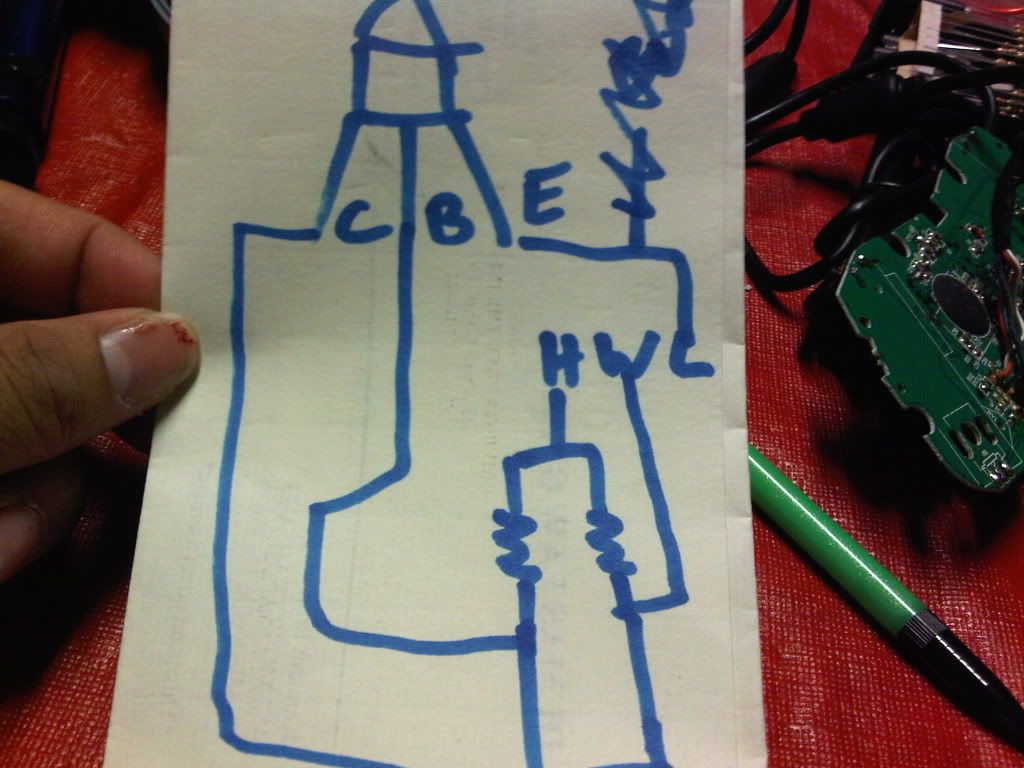

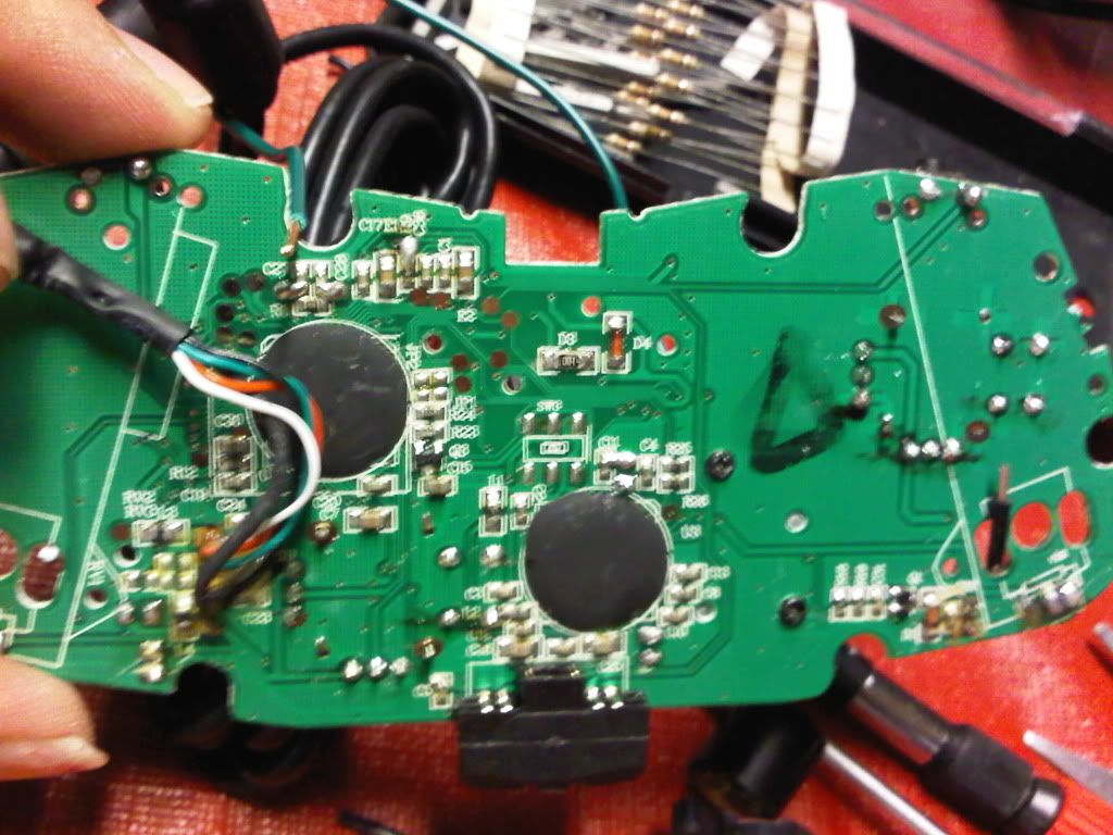

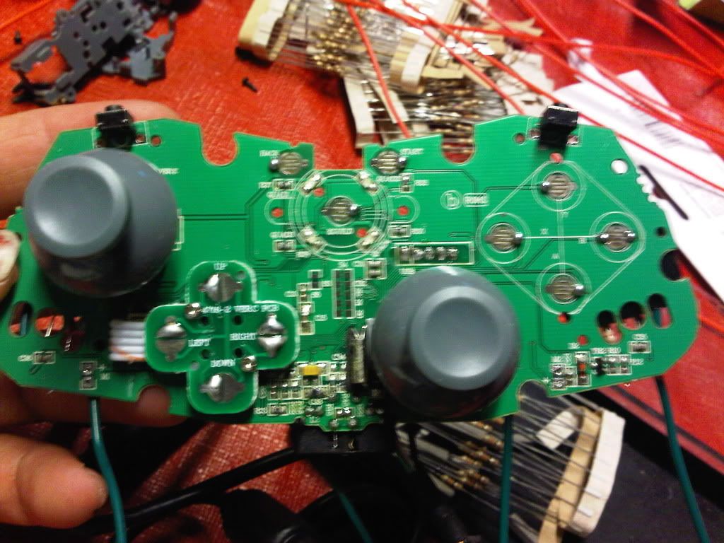

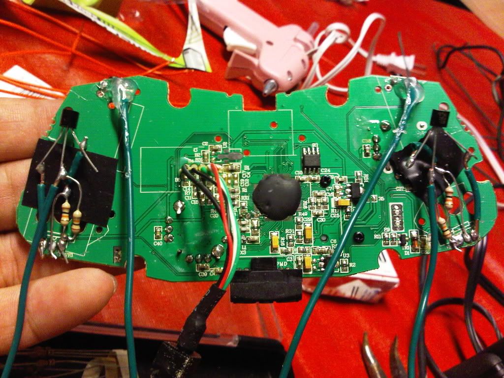

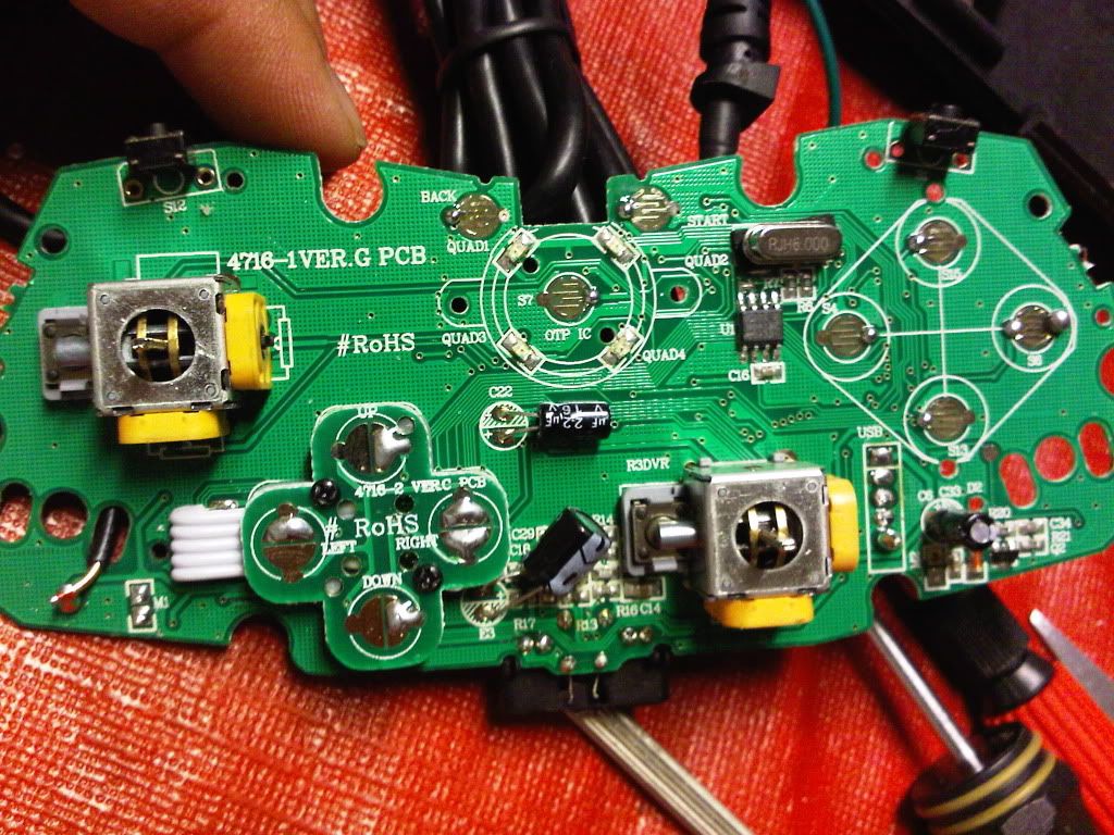

ive got two pcb boards. not the same.. one hard and one easy. but i dont know which is which. also i know aobut the 2 resistor and npn transitor but i dont know the high low wiper. heres the pic of my two boards
GAM 4716-1 ver. E Front
http://i901.photobucket.com/albums/ac211/dppham/IMG00039-20090714-2220.jpg
back
http://i901.photobucket.com/albums/ac211/dppham/IMG00040-20090714-2220.jpg
4716-1 ver. G PCB Front
http://i901.photobucket.com/albums/ac211/dppham/IMG00041-20090714-2221.jpg
back
http://i901.photobucket.com/albums/ac211/dppham/IMG00042-20090714-2221.jpg
this is the trigger resistor, trans i went by.
http://i901.photobucket.com/albums/ac211/dppham/diagram.jpg

Hey, missed this the first time around.  I'll have to look when I get home, I have my own diagram, I don't go by high / mid / wiper / whatever...  I just wire mine base on position: outside, inside, or middle.

thank you i'll be waiting for your respones.  one more thing.. does both of those pcb board need the transistor resitor

in refers to the point on the inside of the PCB, out is the point closest to the outside.
Also, if you open it up and it looks like this, you have the older (easier, doesn't need transistors) PCB.

i have one that looks like the older version.. so if i don tneed transistor. how will i hookd up the trigger for it?
Re: Madkatz 360 controller Joystick Arcarde mod (harumaN need y0 help)
« Reply #6 on: August 10, 2009, 07:25:54 am »
Leave the pot on, and just connect a wire to the center leg.  That's all.

im sorry making it compicated for you.. i did this like a month ago.. and i thru away the pod. is their another way to make it seem like i hav a pod on?
« Reply #8 on: August 11, 2009, 12:54:24 pm »
Hmm.  You can add resistors where the pod used to be, but I'm not sure what the values would be.  I only remove them for the new version PCB (when I have to use all the transistors).  You may have luck with a search at shoryuken forums.

on the picture u shown up on top.. where the right top button , theirs two gray wires. whats that for?
« Reply #10 on: August 12, 2009, 05:04:46 pm »
I think the second grey wire (far right) is just the other end of the first, curled around out of the picture.  Looks to be the wire for the RB.
