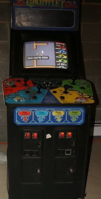

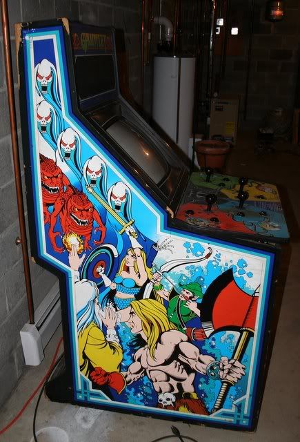

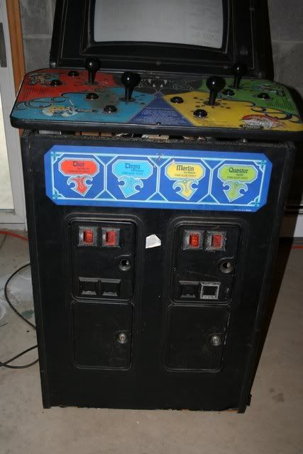

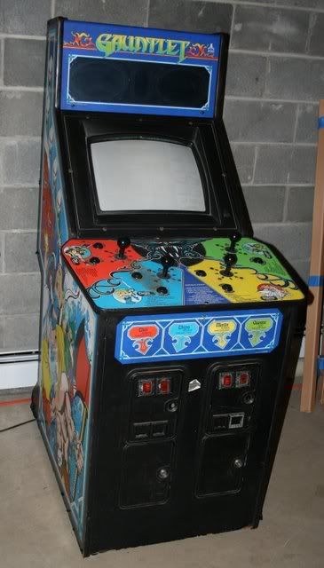

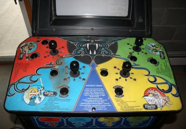

Probably a bit premature to be posting this as I won't get to it for a while, but I pickeed up a Gauntlet cab today.  Gauntlet was always one of my favorites back in the mid 80's.  I put a lot of quarters into it.

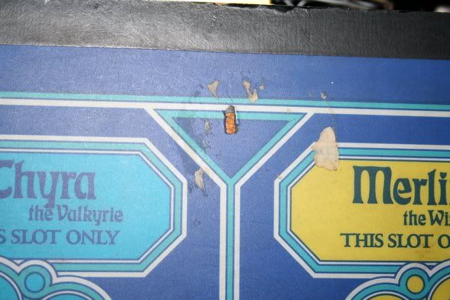

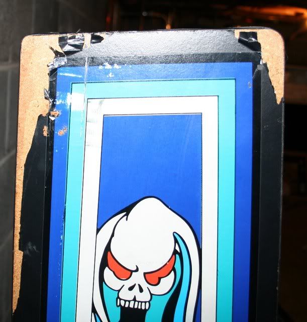

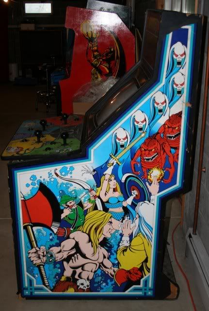

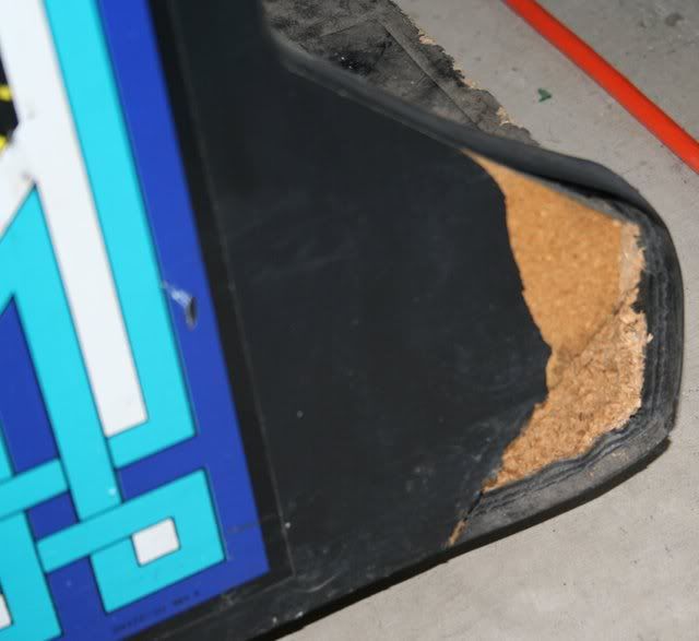

Left side is in pretty good shape.  The black vinyl is peeling is spots, but the side art is in pretty good shape
The right side is also in okay shape.  The top art work is ripped off and again the black vinyl is peeling all around.  Unfortunately, the previous owners kid decided to peel a good chunk of artwork off about an hour before I picked up the game.  It's just taped back on right now.

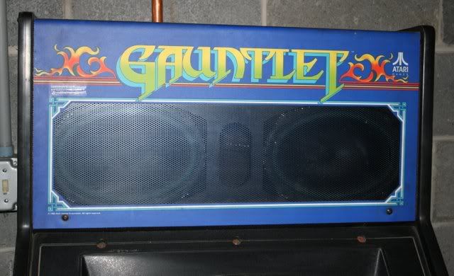

Upper marquee looks to be in good shape and just needs a cleaning
If I find problems with it, arcadeshop does have a repro:
**EDIT: I cleaned up the marquee and that mark on the left side came right off.  I'll be fine with the original one!

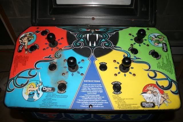

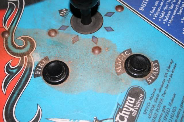

Control panel is in rough shape.  Hopefully it will clean up with a little elbow grease as there are not any good repro CPO's available.  Definitely needs some new ribbed t-molding
Front is in good shape but the decal has marks on it from the control panel.  The control panel opens up and has a metal piece that lets you hook it on the front of the cab in an upright position.  That has caused the marks on the decal.
I'll probably replace this with one from arcadeshop:

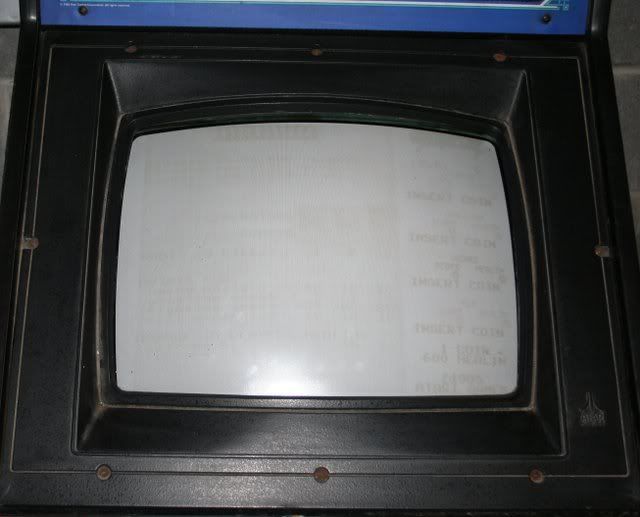

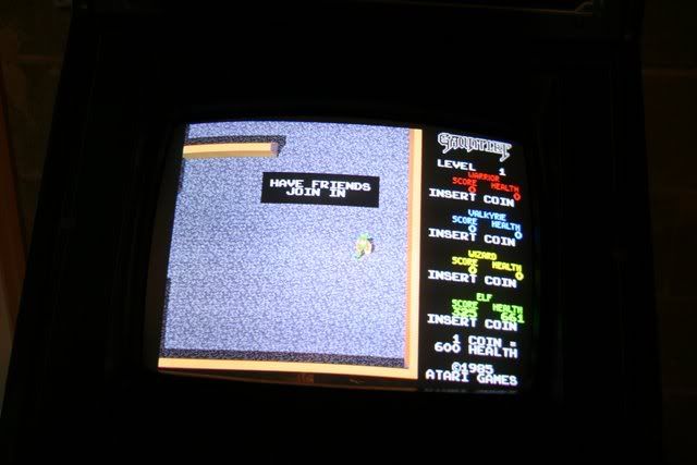

Monitor has your typical Gauntlet burn in on the right side, but the picture is nice and bright

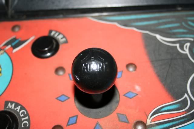

Nice looking Atari logo sticks
I need to look into the sticks as a couple of them are not hitting a few of the diaganols.  I've never seen this type of stick before.

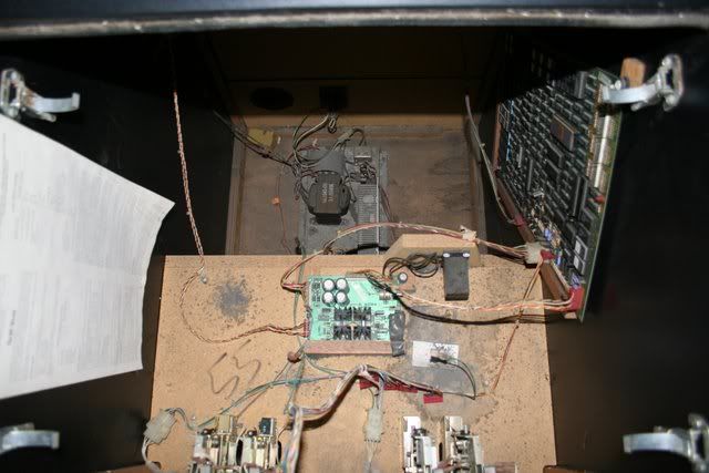

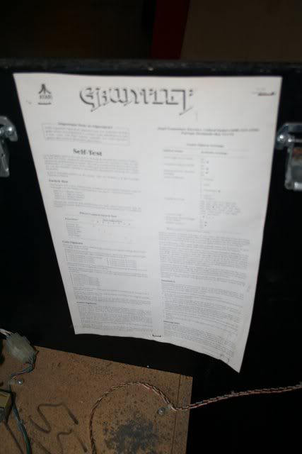

Still has the settings sheet on the inside
Control panel is just sitting on top in the pictures, it does push down correctly.

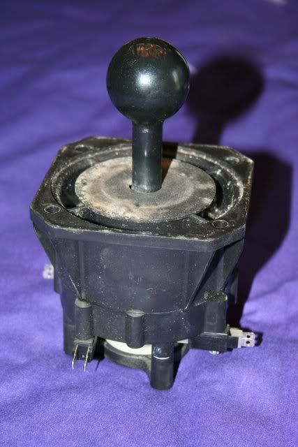

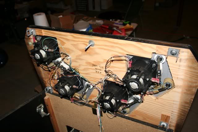

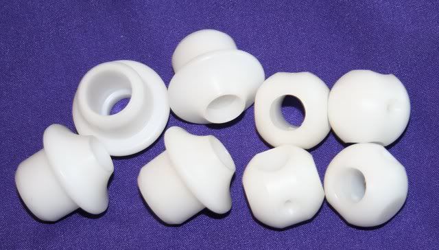

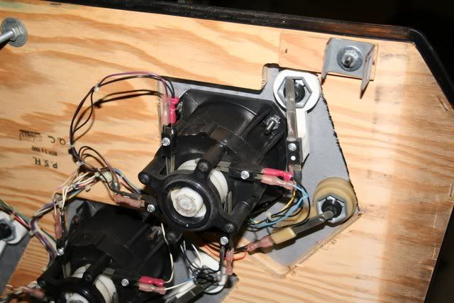

Can someone tell me about these joysticks
For leaf sticks, there is a lot going on there.  What's going on inside those big bases?

I used a magic eraser on the control panel.  While it did a great job bringing back a nice bright color to most of the panel, it was no match for the big stain  :'(
Here is the before and after (doesn't show well in the pictures, but looks much better in person)
I may decide to go ink jet and get a replacement from arcadeoverlays.  The big issue is that the original CPO has a texture to it that won't be reproduced on the inkjet.

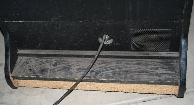

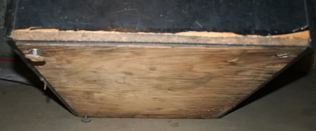

The game was really wobbly so I decided to take a look underneath.  Missing two of the legs
I replaced them with these nylon castors which are really incredible.  This game moves around really easy on the concrete with these on it.
I was missing the t-nut (I think that is what it is) that one of the legs screws into.  Where can I pick one of these up?
I also took a better look at the cab.  Definitely need to do some work on the back support

Try a little "Super Clean" on that control panel or one of them "Citrus" type cleaners.
The Super Clean does a pretty good job on stuff like that. Be warned it may irritate your skin though. (I've used it so many years now it doesn't bother me....mechanic)
Just all depends on what caused that stain.

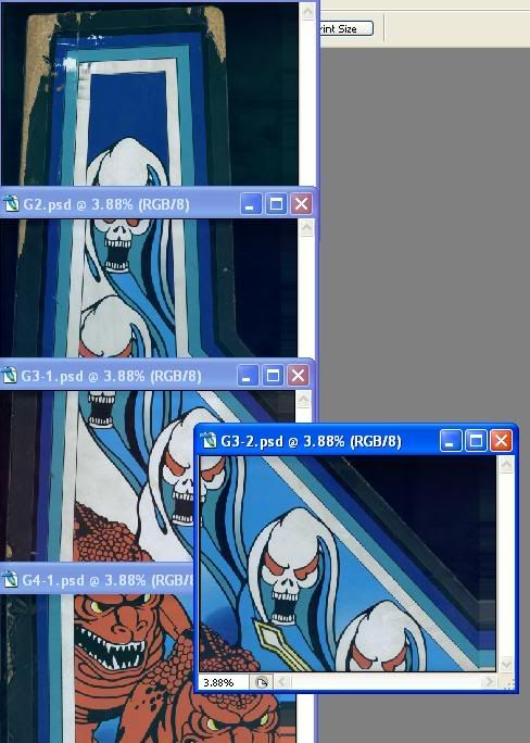

what's OUTSTANDING on your machine though is the fact that it carries the original gauntlet 1 sideart stickers which are much bigger than the ones you find on most of the gauntlet machines. compare the pic of your sideart with the other one i've attached ... see the difference?
unfortunately, there are no reproductions available for the original gauntlet sideart  :cry:
a lot of people - ME INCLUDED - are looking for those sidearts and in order to get them we'd need a scan so that someone could make a vector file out of it ...
 :angel: do you have the equipment and the time to help out the arcade community by doing a scan of your sideart?  :angel:
you would make more than one person happy, of that you can be sure!

I may be mistaken but aren't those called Gimbal joysticks?
Why yes...yes I do.  But I'm only helping out because of that cool font you used.  ;D

A little teaser for you:
This was just a test to see if my scanner would work.  It really doesn't like scanning upside down, but I think it will work out.  I need to clean to side art up and remove a lot of marks that are on it.  Once I do that, I'll do a good scan.  (some of these are skewed but I wasn't spending too much time lining things up)
teasing worked  ;) man, i can't wait for this to finally happen! thx a lot spyridon, i'm looking forward to your "good effort". you're the man, man!

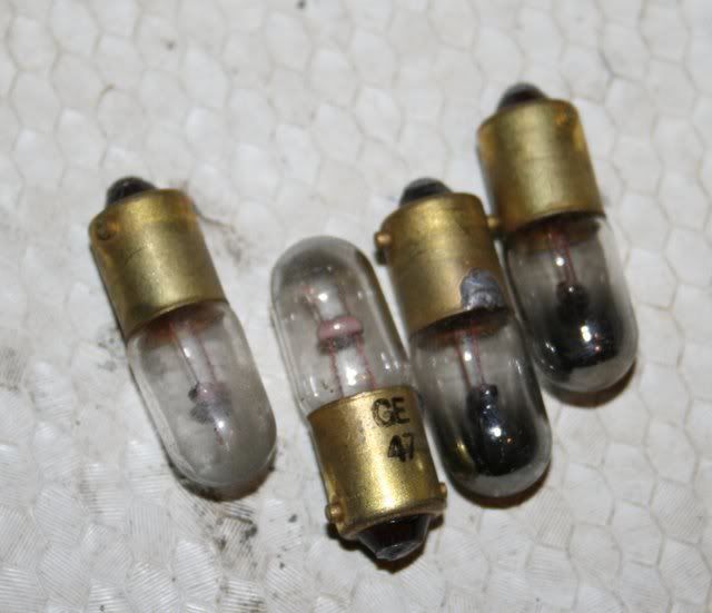

All four coin door bulbs were burnt out so I replaced them today.

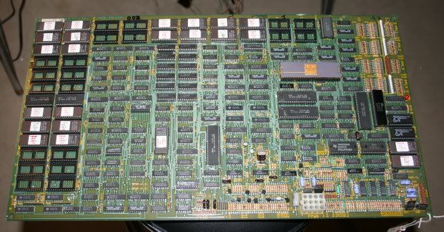

Also, my Gauntlet II PCB arrived

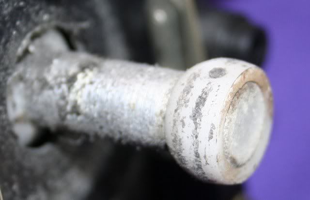

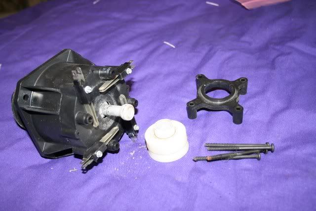

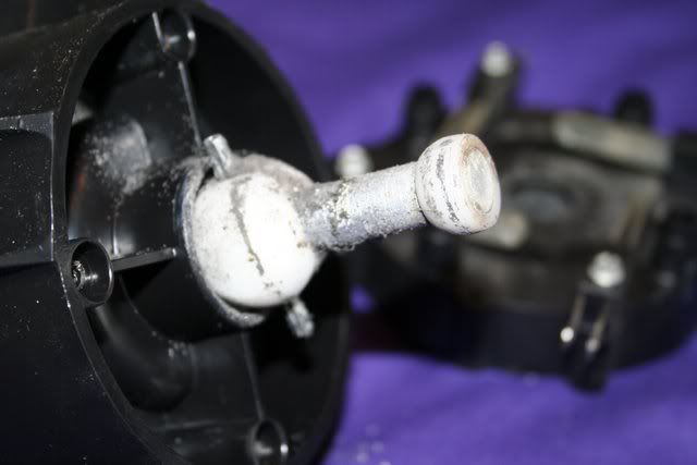

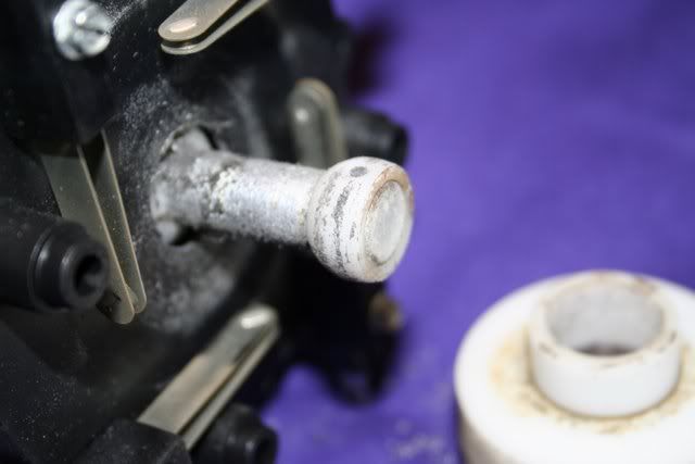

As mentioned above, I was having a problem with a few diaganols on a couple of joysticks.  I'd like to get this fully playable so I can get three people over for some good 4 player gameing.  I purchased a new set up Atari joystick plungers and pivot balls from Ram Controls.  David over there does some great Atari replacement parts.
First step was to remove the joystick from the control panel
4 screws on the bottom
Remove those and you end up with this:
The next part, containing the leaf switches, pulls right off
revealing the pivot ball:
The pin in the pivot ball took some work to remove, but I finally got it out.  However, the pin in the small piece at the end of the stick is in there really good.
I didn't have a good tool to get it out, so I'll have to stop here until I can figure out how to get it out.  Once out, I'll be able to swap the plunger and pivot ball with the new ones.  These should feel real nice after the rebuild.

Since you don't care about the old one, feel free to use destructive force on it.  Like a Dremel.

I need the piece at the end with the small pin in it.  I don't have a replacement for it.
SirPeale
  • Green Mountain Man
  • Posts: 12963
Re: Gauntlet
« Reply #29 on: August 26, 2009, 03:19:00 pm »
Oh, I thought that was one of the things that got replaced.
Well then...a rod the diameter of the pin, knock it out.
Majoraslayer
  • Posts: 24
  • Last login:February 27, 2024, 08:26:04 pm
Re: Gauntlet
« Reply #30 on: August 31, 2009, 11:37:47 am »
Perhaps you could tap a small nail into it to knock it out?  You might even try pushing on it with a thumbtack.
BTW, I loved this game as a kid.  It was one of the games I remember most!
Spyridon
  • Posts: 1480
Re: Gauntlet
« Reply #31 on: August 31, 2009, 02:10:18 pm »
The real problem is getting the joystick in a position to be able to hammer it.  I need a better vise setup than I have.  It's tough to get it into position as it's still in the bigger housing and moves around.
I just haven't gotten back to working on this but I think I'll be able to figure it out.

Spyridon
  • Posts: 1480
Re: Gauntlet
« Reply #34 on: September 01, 2009, 09:24:52 pm »
I picked up a pin punch today to try and get the joysticks apart.  It didn't go well.  It's difficult to get these to hold in a vise.  I ended up cracking the plastic piece at the end trying to get the vise tight enough.  I put everything back together and put the joystick back.  The rebuild will have to wait until another time.
I did spend some time trying to figure out why some of the diaganals weren't working as I wanted to at least get this fully playable.  I figured it out and its not a problem I've run into before.  The leaf switches needed to be cleaned.  I used a business card to clean off the ones that were giving me a problem and now it works perfectly.  When I pull this whole thing apart, I'll need to do all of them, but for now, everything works and I get invite some guys over for some 4 player Gauntlet!

Well, here are the pics of my Gauntlet cab I just picked up yesterday.  It works, but the joysticks and some buttons need some cleaning up as they sometimes don't go in the direction you want smoothly.  The screen also has some burn in, but it's from Gauntlet so I'm not worried.  Other than that the cabinet works fine.  I still have to clean it up (it's filthy in the pics)
I was a little disappointed at the sideart, I had thought it would go all the way up and that I could scan it for you guys but to no avail.  I've attached pics of the cab.  I also have the Total Carnage/Smash TV conversion as well if you need any references from that cab (was originally an Atari Gauntlet).
Let me know if there is anything I can do to help.

nice catch, but the sideart needs to be replaced 8) fortunately spyridon will help us out with scans of the original sideart soon  ;)
Nice pickup.
Clean those leaf switches.  That's what I found was the problem with hitting a few of the diaganols and one of the buttons.  If that doesn't work, you might want to go with the rebuild kit I described above (good luck getting it installed).  Screen burn on the right side is pretty typical of Gauntlet.  Yours looks to be a little worse than mine.  Luckily, I don't have too much burn on the left side which is more noticeable during game play.
nice catch, but the sideart needs to be replaced  fortunately spyridon will help us out with scans of the original sideart soon
Almost done with Pac-man and Centipede so I should be getting to the side art scanning soon.

I found a guy on ebay that has used Gauntlet joysticks.  Maybe you can pick some up for spare parts.
