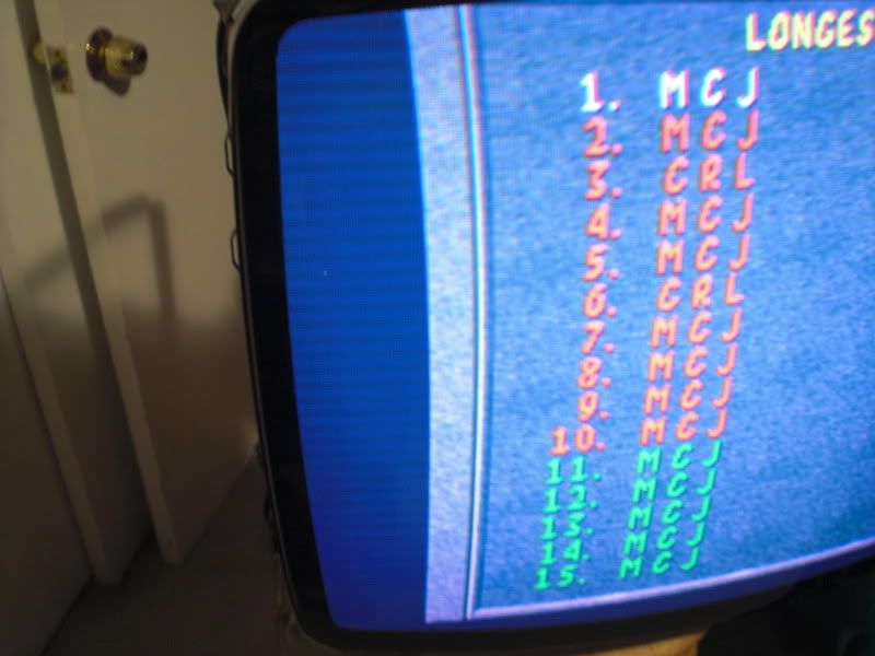

I recently acquired a WG U5000. It worked, but the picture was horrible. It had some resistors in series installed in the B+ pot location instead of a pot. I removed the resistors and installed the pot. I also installed a cap kit and a new flyback. After I hooked it up and and turned it on, all I got was a thin horizontal line across the screen and after a couple seconds, it went away and now all I hear is a faint 'ticking' and nothing else happens. Any ideas? Thanks in advance!

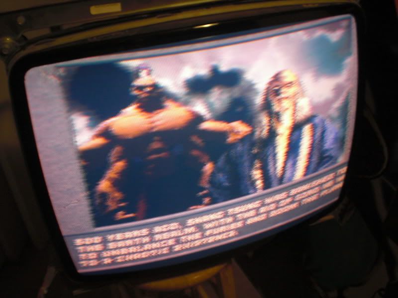

The HOT replacement got it up and running again, but the picture is the same as it was before I replaced the flyback and the cap kit. Neither one made any difference in the problems I am having. When I adjust the Horizontal Hold to where the picture stops shaking, I get a huge gap to the left and the screen is cut off. Adjusting the Horizontal Position makes no difference.
If I tweak the Horizontal Hold all the way to the left, the image fills the screen like it should but it's completely fuzzy and wavy. The focus pot on the flyback works normally. Any ideas?

Thanks. I'll check those caps. When I move the Horizontal Position pot, the image shakes a bit, but it does not move it left or right. When I adjust the Horizontal Hold, the image moves left and right as if it were the Horizontal Position.

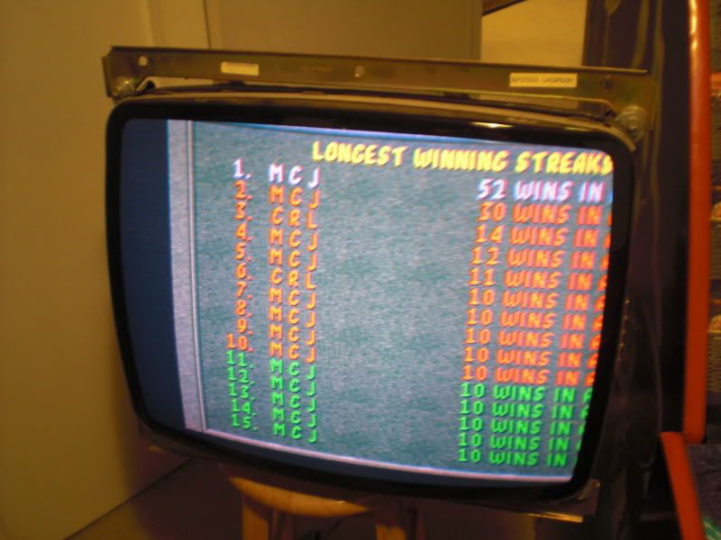

Real MK. This is not the monitor from the MK2 cab that it's next to. This is an extra monitor that I am using the MK2 cab to test it with. There is nothing wrong at all when I hook the cab's monitor back up. It's not the cab, or the game, or the wiring. It's something wrong witht he chassis.

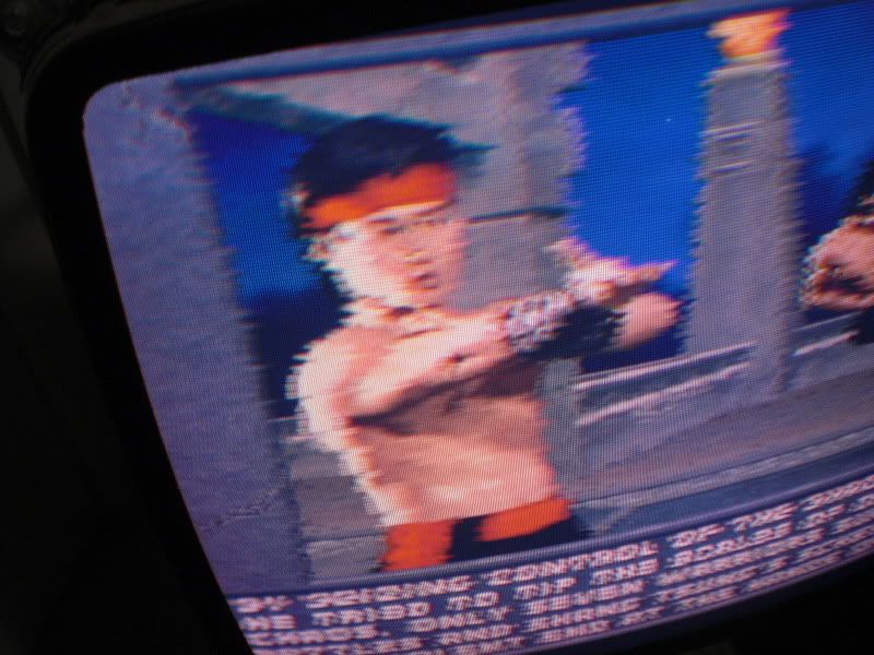

« Reply #12 on: May 29, 2009, 09:42:09 pm »
