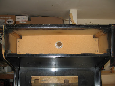

The Marquee brackets are a little bent but still usable, what's with the incandescent bulb?

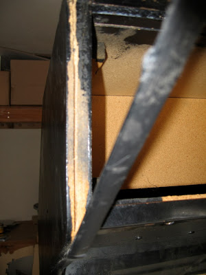

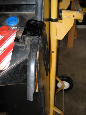

When I first looked at the cabinet I figured I could replace the broken t-molding, but it looks like the groove was routed left of center. I think they wanted to use half inch t-molding on 5/8". The funny thing is, it is left of center on both sides.
One of the first things I need to do is patch the t-molding groove and cut a new one.

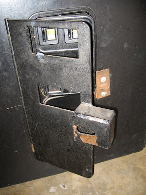

There is a lot of extra "Security Iron" on this cabinet, I'm guessing it wasn't in place at the world's nicest location. There were two heavy duty brackets bolting the Control Panel closed.

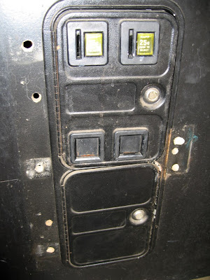

And the Coin Door had its own Vault Door.

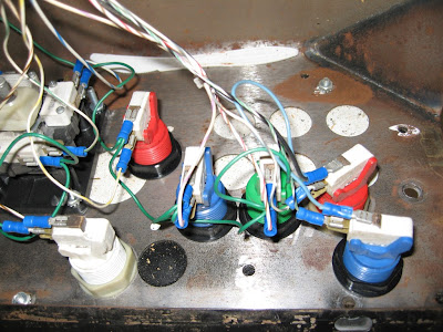

Something is very odd about this control panel. There are holes for the classic fighting game six button layout as well as joystick holes. However, new holes for the NeoGeo button layout were cut as well as slightly different joystick holes. The NeoGeo control panel overlay was stuck on over it and the plexi on top of that disguised the old holes.

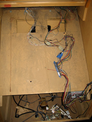

Remnants of the wiring harness are visible inside. It is a Jamma connector, but there are also a number of severed wires and other wires spliced together with electrical tape. It looks like an old blue button is still wired to the harness, but wasn't needed for the NeoGeo layout.
Now, where to start...

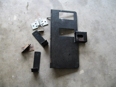

Well, the first thing I did was remove the security brackets and vault door. That is a lot of extra metal...
The coindoor is in decent shape, although I'm tempted to strip it and repaint. There are even more holes to be patched.
I need to decide how to proceed internally, the angled shelf inside isn't practical. I need to replace that with a shelf for the monitor. Then do I try to salvage the control panel, or build a larger box that will afford me a more comfortable layout?
I know I need to patch the T-molding grove and reroute it. Can anyone recommend the best material to use? I'm not sure if wood filler can stand up to being routed and then hold the molding in place.
I couldn't get a good picture of it, but the paint job is horrible. So I'll need to sand and repaint the cabinet as well.

Are the sides 5/8" thick?
Can't tell from the picture is the t-molding was trimmed, but they may have used offset t-molding, such as:
http://www.t-molding.com/store/product.php?productid=15&cat=8&page=1
Anyway, the cab looks to be in decent shape.  Sucks about all those extra holes.
You could always re-use the security hardware to keep any nosy friends out of the cab.  ;D
« Last Edit: March 23, 2009, 12:55:41 pm by Ralman »

With regards to the t-molding, I had an old ring-king cab like that with the "offset" groove. If you don't want to fill/reroute it, check the width of your side panels. I believe you can use this stuff: 13/16" offset t-molding.

You're correct, the sides are 3/4", not 5/8".
My guess is the slot was cut for that offset t-molding, but then regular 3/4" t-molding was used. Close examination shows one side of the t-molding has been trimmed away, and the far edge is painted to try to hide the fact the t-molding didn't cover it. It was also held in place by a number of nails, which have made a mess of the slot in several places.
I think I could use the offset t-molding, although its 13/16" vs 3/4", I'm tempted to patch and reroute the edges, just so I can use more colorful t-molding.

Personally I would be worried about trying to patch the slot and cut a new one.
Even if you can get the slot completely filled, you will have a very thin sliver of wood between the patched slot and the new one.  I don't know if that would hold up very well. There might be a chance of pulling out that sliver when cutting the new slot, leaving a something that is too wide to hold in the new molding.
Mind you I have never tried this, but maybe someone else on the board has done so.
You might want to try a test piece first to see if it is possible.  Cut a slot similar to the existing one, patch, and try cutting the second slot.
However, I remember that someone on the board puts on their t-molding by cutting off the ribbed section and gluing it on.  I believe it was psychotech.  A quick search shows that he has only done it with bartop cabs, not fullsize ones.
Of course gluing it on is more permanent than using the slot method.

I secured the speakers in place using small mounting squares and zip ties.
Next, I finished the coin door repaint and mounted that into the cabinet.
The plastic pieces from the coin door were in such rotten shape that I ordered new buttons, bezel and coin return flaps from Lizard Licks. It should look pretty good with those in place.
When I got the cabinet, it was missing two sets of bolts/brackets that help secure the coin door in place, anyone know of a place to order them?
Mikezilla
  • Posts: 1676
Re: Arcade Legacy - Mame Cabinet Project
« Reply #38 on: October 08, 2010, 12:32:00 pm »
Yeah I got a guy that might be able to help you out. His website is weird, but he has some good used items such as bolts, brackets etc...
http://thearcadeboneyard.com/CoinDoorParts.html
KagatoAMV
  • Posts: 108
  • Last login:October 23, 2020, 02:13:32 pm
« Reply #39 on: October 11, 2010, 10:25:24 am »
Thanks Mikezilla, that link is perfect, he let me order just 2 of the bracket/bolts I needed.

I got some work done this past weekend. The parts I ordered for the coin door showed up so I installed those
Mounting the control panel to the cabinet had a few rough spots. I ended up needing to sand the paint down so the bottom of the control panel would fit inside the cabinet properly.
In this pic you can see the control panel base, without the control panel itself. I still need to order some clamps to hold it in place. Inside you can see where the black control panel bottom meets the white cross piece I mounted inside. That is where the clamps will go.
The control panel slides out, once out far enough, I can reach inside and undo the two clamps holding the control panel to the base.
It is a little hard to see the details of the control panel in place because of the lack of contrast of all the semi-gloss black surfaces.
From this angle the way the control panel meets the cabinet is more visible.
