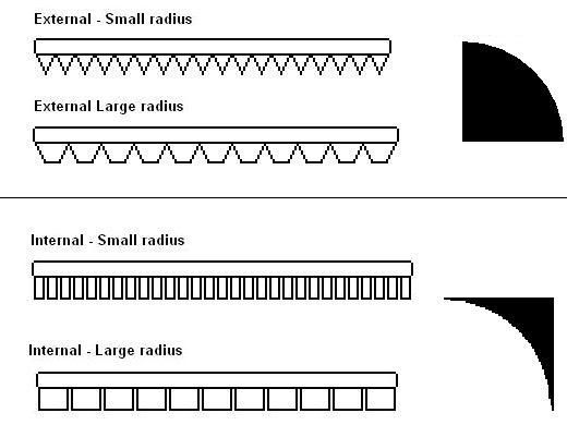

I decided to replace the T-molding on my old Kangaroo cab . . I've already ripped it out. Its the kind that goes all the way to the back, and down to the bottom. How many feet do you think I need to order, on both sides?
Also, in the wiki it mentions cutting "v" shaped slits when you come to corners? Can someone elaborate on this? I'm not sure what it means. Do you actually cut into the T-molding?

I can't help you with the amount of t-moulding you will need but it should be fairly easy to measure the the edges to determine how much you will need.
In regards to cutting v's you need to cut material away from the spine of the t-moulding to allow it to bend around corners. Have a look at the attached pic (paint skillz ahoy!  :laugh:):
For an external radius you need to cut v's to allow the t-moulding to bend. The tighter the radius, the more v's you will need and/or the larger v 'angle' you need to cut.
For internal radii's you can get away with just cutting slits into the t-moulding. Once again the tighter the radius, the closer the slits need to be.

I just use a utility knife and cut like the pics above.
Same.  I'm not even all that careful.
