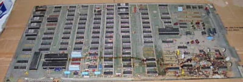

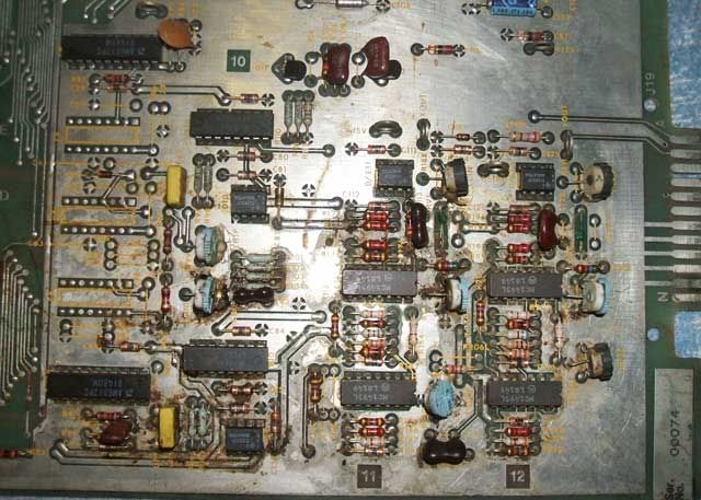

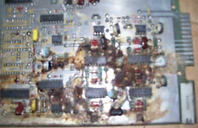

Okay, I've ended up getting another vector game board, (Space Duel) but it's had 'something spilled on it'.
Not in the game powered on, but in storage.. (reminder: get bags for my loose pcbs)
Still in the process of getting it shipped to me, so I need some advice
on how best to approach this without destroying the game...
What's some good cleaning materials? I guess first off I need to figure out what it is (soda, oil)
get what I can, then desolder some components, clean under them, resolder. Lots of work ahead.
a gamble, yes.. but worth it it I get it working.. :)

remove all your socketed chips, and stick that thing in the dishwasher.
Let dry completely, reinstall chips, and go from there.

Dishwasher - no detergent.
Then a toothbrush with 99% alcohol for those tough areas.
Dry thoroughly, and possibly take out socketed chips while drying. Even better to take out socket chips before the whole process if you want.

And afterwards, first thing you do to it once it is dry, is reflow pretty much all the solder joints and retin the edge contacts.  That will save you a lot of headaches later.

Just pulled a K7000 monitor chassis from the dishwasher last night.
Done this many times over now with all kinds of stuff.
The only thing that may get messed up by running a pcb through the dishwasher are any PAPER labels and such.
Pull all of the socketed chips otherwise moisture may get trapped around the legs.
(be sure to mark where they came from)
Top rack is a good idea.
DRY, DRY, DRY
Blow out from under any chips, pin connectors and anything else you might possibly think that water would get trapped under.
If you have something like old soda spilled on it you may want to spritz a little average household cleaner directly on that area and let it sit just a minute or two before running it through the wash.

If you have tough areas to clean I've had great success with 409 or 409 Orange cleaners and a tooth brush. Be sure to rinse very well when finished and dry before testing.
I worked in a grey market Apple repair depot in the mid 90s and we dishwashered boards regularly. It did wonders for the nasty boards that came in. All repairs were warrantied for 90 days to 6 months and we never had a redo over a problem related to cleaning.

« Reply #49 on: November 09, 2008, 09:29:29 am »
Just to be clear, I was at the controls when I derailed the thread. It is a Trinitron. And I appreciate the confusion with a real one. That was the goal.
(back, finally on topic:)
Okay, finally got the PCB. and some insight as to where it came from, basically a 'building chock full of games'.  :o
 More on that later (as amtrack announces a delay)
Ugh.. if that's soda, I'm quitting sodas. Here's what I've done so far, since the store was closed for the cleaner.
application of liberal amounts of alcohol applied with q-tip, 1/2 hour soak, then application of high-pressure air (4-60psi) over and over.
The most effective part of that, weirdly, was when moisture got in the air stream, it provided a dishwasher-like effect. ;'
I call it 'dry washing', since it pretty much knocked the
whatever-it-is bit by bit off without any apparent damage to the components..
Before: Scary muck with actual chunks of I-Am-Afraid-To-Think:
After:
Not bad for the initial cleanup. Using proper electronics cleaner should help with the rest. Main concern is bridges on the ICs.
