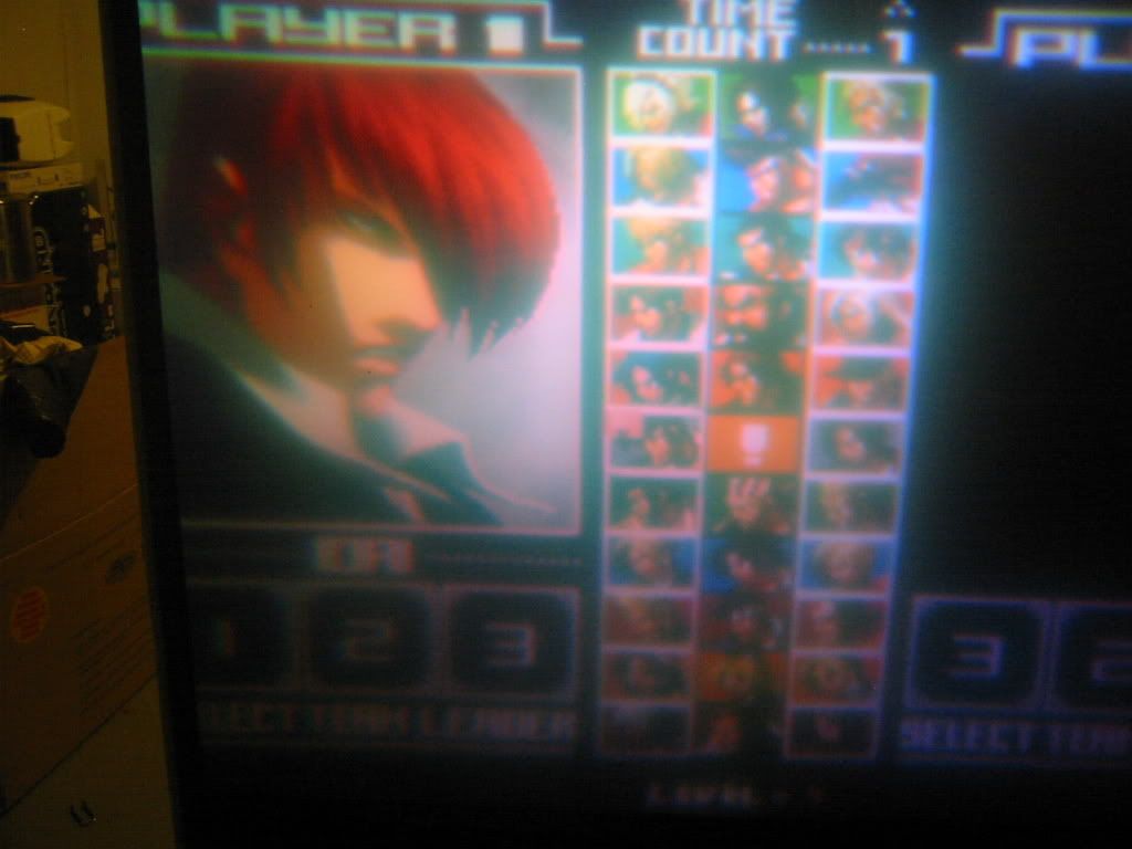

Author Topic: *updated* Repairing a projection screen arcade monitor. (See latest post)  (Read 21491 times)
payment_due
  • ---Probation---
  • Posts: 367
  • Last login:August 19, 2012, 11:04:24 pm
  • ---Probation---

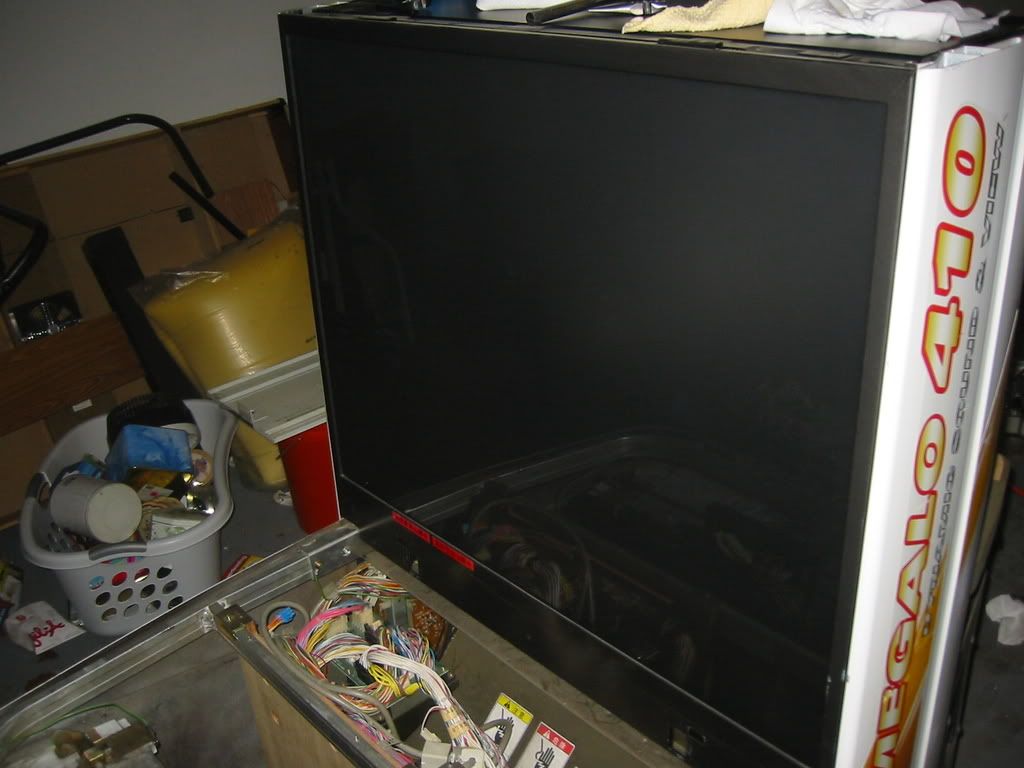

Are the screens on these types of Megalo candies fixable? The screen apparently is a little washed out. Is this a focus issue, or something deeper/worse?
Thanks for any help.

you need to clean the lens assemblies,you will need to remove the front screen and unbolt each lens,clean  everything
at worst the guns go flakey on these but thats an extreme

« Reply #27 on: October 26, 2008, 05:55:08 pm »
I hope so too.  I did a little research on the monitor itself.  And by 'little' I mean 'almost nothing came up in google'.  I tried searching for Hitachi C41-31S and got like 3 hits, all from other people saying they have one and asking a question.  It figures I'd have a nearly non-existent model of monitor.
It's so strange. It's not like the focus is off at all. I can see detail, it's just like looking at something through a dense fog. You can still see decently sharp, it's just.. hazy.
my MAMEcab progress blog: http://www.lealmedia.com/mame/

yep its gonna be a smoke/dirt residue on the lens and mirror,this is very easy to clean if you don't clean the internal lens
all you need to do is remove the gray screen surround(should be 2 side screws and 4 at the bottom),lift up and out to remove from cabinet
remove the plastic screen(make sure when you reinstall these they the correct way round)
 by removing one or two of the plastic brackets that hold the screens in place
you should now see a mirror and three lens,using glass cleaner and a soft cloth you can clean all three lens at the top only and the mirror
i bet your cloth will look black afterwards
try this,its a 10 minute job and safe-i bet you will see a massive improvement

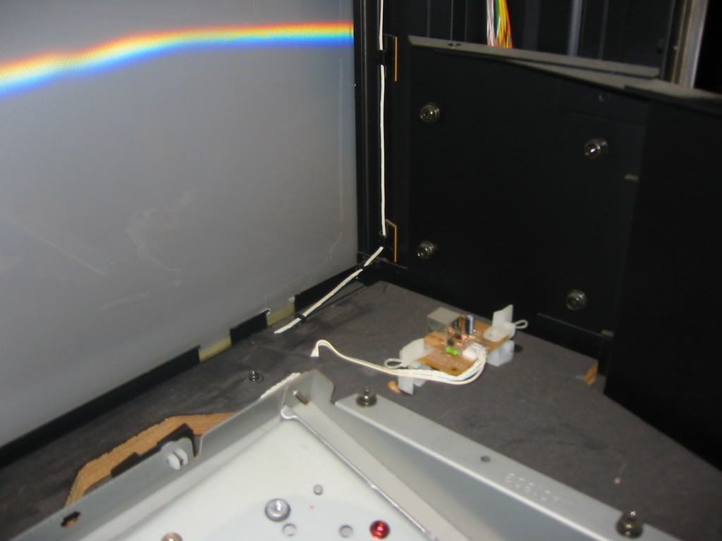

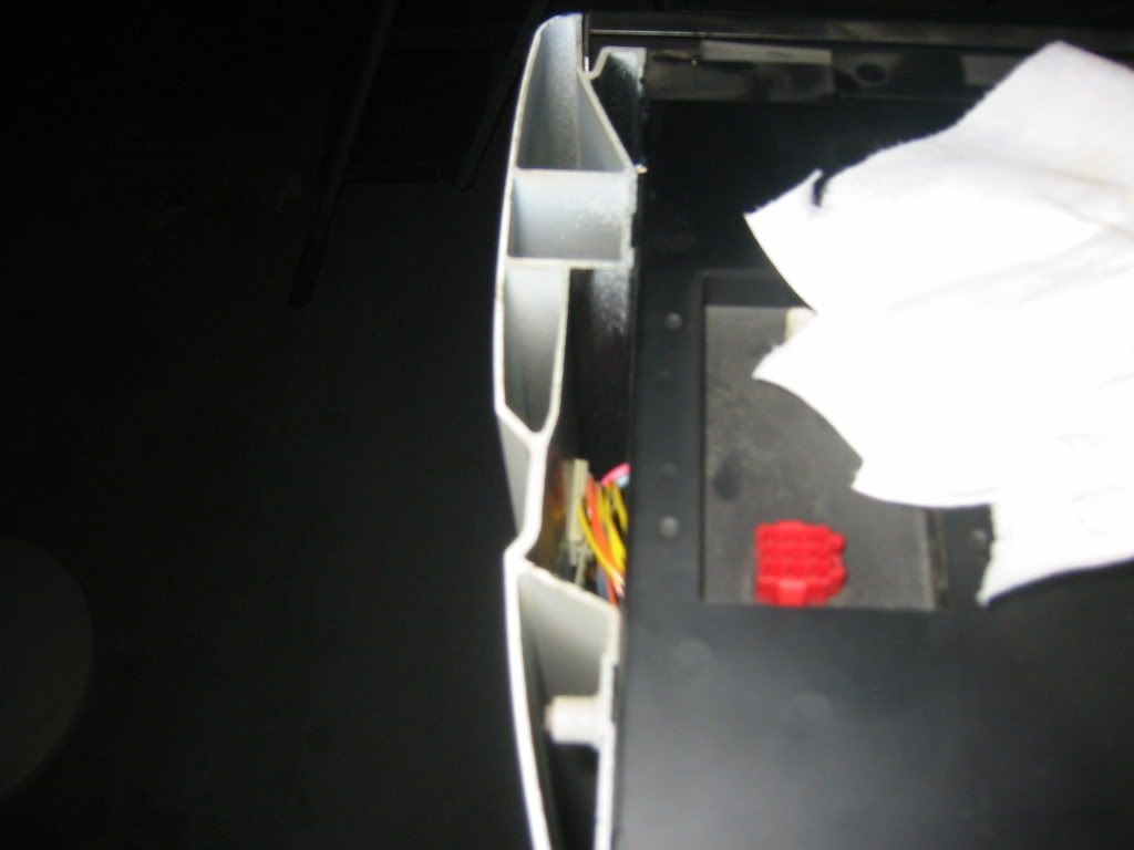

Re: Repairing a projection screen arcade monitor.
« Reply #29 on: October 26, 2008, 07:17:34 pm »

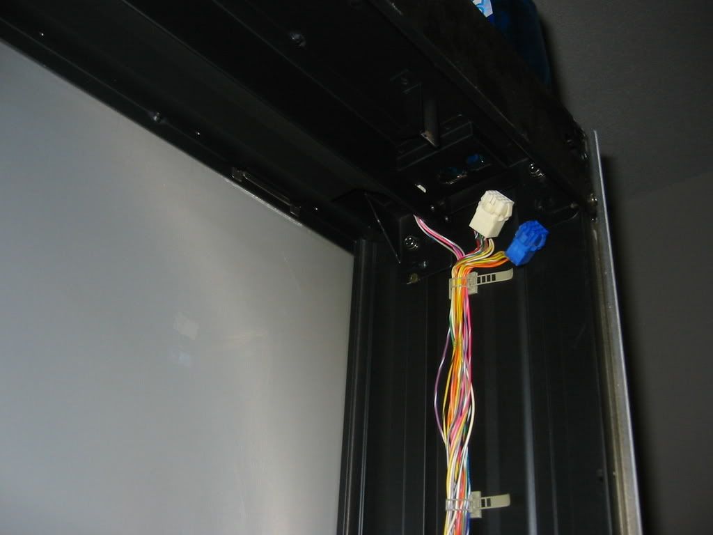

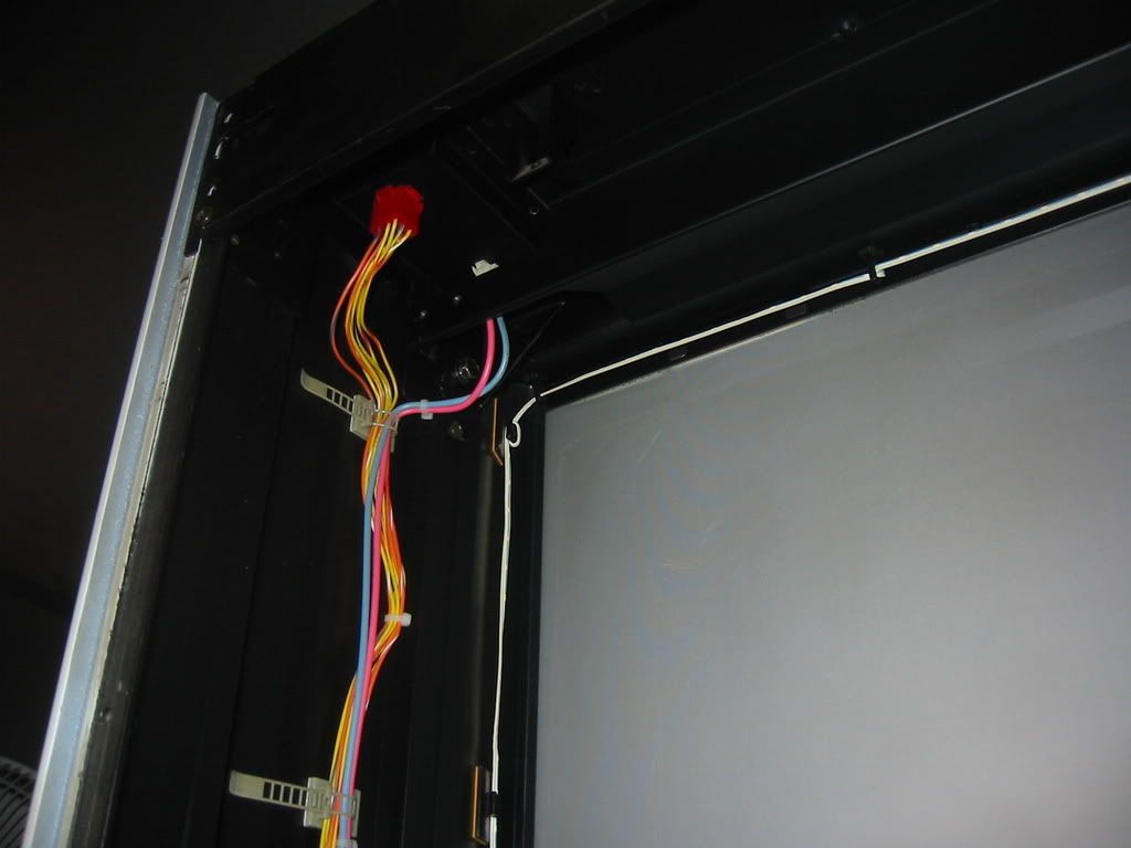

Well  I tried working on it a bit. Got the Marquee off, and I haven't made absolutely any headway with the glass.  But I was able to remove the BACKING plastic and I now have access to the massive mirror, which looks dirty on the OUTSIDE (the side facing the back plastic) and the Lenses actually look decently clean nothing crazy, but I'll clean them non the less.
Now my question - what do I clean WITH?   Alcohol? Windex? Water?

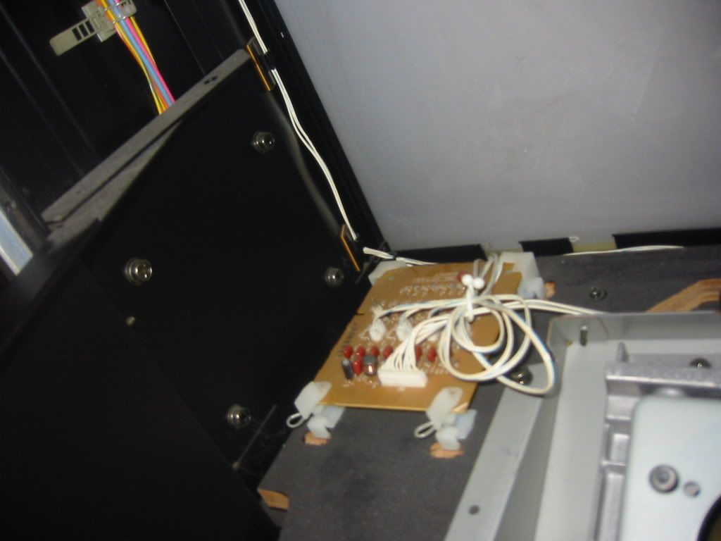

« Reply #41 on: October 27, 2008, 11:09:11 pm »
OK, here are some pictures.
First off, the front of the cab, missing the marquee header.
front
Inside the cab (entering from the back).  You can see how the plastic sheet is held, sort of.
Top left
Top Right
Bottom left
Bottom right
The sidepanels of the cab. Aluminum and very solid, I have no idea how to get these off.
sidepanel
The top, right under the marquee header. You can see where the two screens meet. The glass on the left, the plastic on the right.
top
You can also see a bracket that holds the outer border/brackets in place.  I can't seem to figure out how to get the plastic screen out witout trying to remove the entire glass assembly.  Furthermore, the cabinets construction seems to be undisturbed. So it's doubtful that someone removed the sheet to clean it and put it back incorrectly.  I could be wrong though.  If I run my fingers across the plastic screen, I don't feel any texture.  Should I? I almost want to say I should feel something like those flicker pictures, where if you hold it one way its picture A, and move it to the left or right and it becomes picture b, and you can run your fingernail accross it.  Does that make sense?  If so, should I be feeling something like that on the screen, or no?
« Last Edit: October 27, 2008, 11:42:18 pm by payment_due »
« Reply #42 on: October 28, 2008, 02:38:55 pm »
get me some pics,this time bring up a grid test pattern

« Reply #54 on: October 28, 2008, 08:38:04 pm »
OK, here are two more pics. I REALLY need to buy a camera. This thing has come in WAY handy.
Anyway, here's a crosshatch in test mode.
test mode
And here's a character select screen shot.
char select
Looks like my rigorous cleaning had no effect.   :dunno

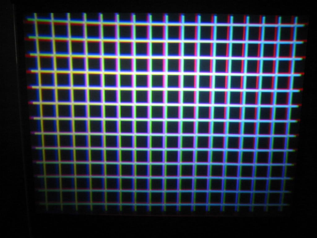

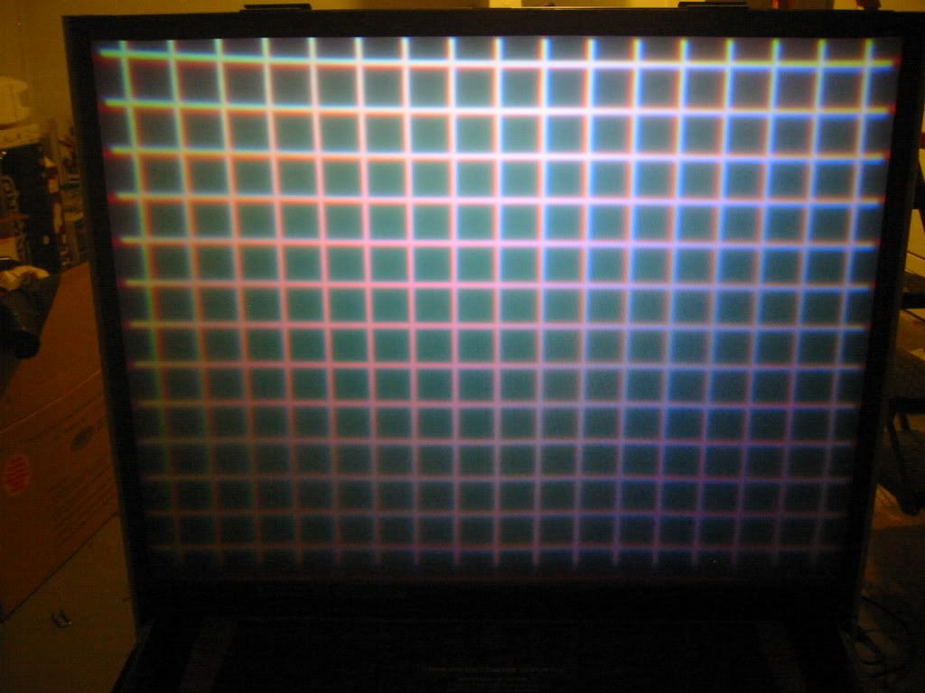

« Reply #58 on: November 15, 2008, 12:04:52 pm »
Serious update time.
Another very helpful member named gibbous gave me some tips about fixing this issue, and it looks like I'm making very good progress. I was able to replace the coolant liquid which was definitely the problem.  It had congealed and gotten very gross and 'applesaucy'. So I cleaned it out, replaced it with new coolant and the picture is MILES better.  It's sharp and looks great.
But here's a new problem. I'm currently out of focus. Here's a picture of a crosshatch before the new coolant:
And here's one after the new coolant, and out of focus. The red/green/blue aren't matching, apparently, but everything is nice and sharp! (Thanks Gibbous!)
The picture is a little fuzzy but that's because I'm Mr. Shakyhands Jr.
There are a few knobs I found on the cab but none of them seem to adjust the 3 colors together. They just stretch the screen, move it up/left/down/right, and adjust the brightness.
Anyone have any advice on fixing this up?
One thing of note: the liquid is not 100% full when i replaced it, as it's almost impossible to get that perfectly full because of the angles involved, as well as pressure.   The Red and Blue lamps are the ones that are about 95% full, where as the green lamp is about 99% full.  Could that be the culprit?

Re: *updated* Repairing a projection screen arcade monitor. (See latest post)
« Reply #59 on: November 15, 2008, 02:42:58 pm »
The convergence is off.
You'll have to research whether or not it's adjustable on that model.
(unless someone else here already knows)
Some have manual adjustments, some have on screen adjustments.
Thanks Kevin, it looks like you're right. Gibbous has informed me that it will need to be done via a remote control that costs way too much to even consider buying. $150.  I'm going to try and find the model of the remote, then maybe I'll be able to use my Harmony and program it.
Jeez, just when i thought I had the dang thing up and ready.  :banghead:
You have to wonder, why would the convergence be off if all I did was replace the coolant? I didn't put in the lenses incorrectly or move the lamps.  Why would this have happened?
« Last Edit: November 15, 2008, 03:58:33 pm by payment_due »

« Reply #61 on: November 15, 2008, 04:50:56 pm »
Some models have special chips for the convergence, could be a problem there as well.
Hard to say..... try adjustments first though of course.
grantspain
  • Posts: 6181
  • Last login:Today at 05:10:14 pm
« Reply #62 on: November 15, 2008, 05:31:05 pm »
convergence can go out when you move cabs,it looks like a minor adjustment-not like any ic failure
interesting about the lens fluid-i was not aware it would cause you specific problem,anyway always good to learn something new

« Reply #63 on: December 29, 2008, 02:39:39 pm »
I haven't taken pictures of it yet, but IT'S ALIIIIVE!  I ended up having to purchase a $130 remote (what a deal eh?) from the one human being in the solar system that has and sells them. I finally got it in the mail today and immediately went to work on it. I'd say it's about 99% perfect now.  There are a few things to consider like having to move it yet again and trying to get it into the house, making sure the lamp coolant is as close to full as possible, thus forcing me to open up the lamps again, re-adjusting the mirror, etc but once that's nice and fixed, it will be ready to transform into my MAMECab.
I'll post some pictures later today.

  • ---Probation---
« Reply #68 on: January 17, 2009, 03:40:42 pm »
just seen the cab again,yes i see what you mean-if you do put it on its side then make sure you are gentle and plenty of hands to help
if you drop it you will be back to square one
Cool, thanks for the help.
The convergence is still being a pain in the rear. I know I'll have to redo it once I move it again, but the corners are so picky.  I wish there was a 'factory reset' mode that would just reset everything straight.
