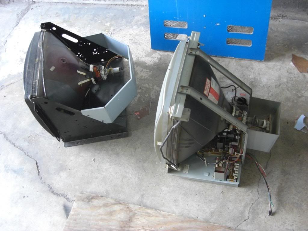

Well, I got the tube all changed out and started working on the control panel. Man, that plexi is bad!!

« Reply #25 on: October 16, 2008, 10:35:24 pm »
Could be needing a cap kit.
That's what I though. Any good resources?
Bob Roberts carries a kit:
XM-2001N 19" color- Atari    $5.00
Zanen Electronics as well: Phone:  888-449-2636:
#302     For Nintendo Sharp XM-1801N or XM-2001N 19" color monitor.
             Includes 24 parts. $7.95 ea.
Nice job on the tube swap, looks really good.
That control panel plexi did look horrible, but it's kinda good that they had put that on there...... most don't and then you're stuck with the nasty cpo.

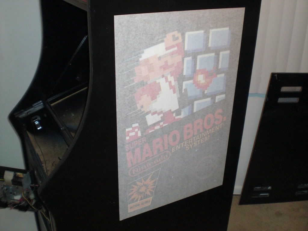

Ok, got the control panel completed. The plexi had to be completely replaced. Here are some pics...
Also replaced the marquee bulb and the coin door lights...
All that's left is my sideart.  VS. SMB never even had a dedicated cab, let-a-lone sideart, so here is what it will be...
It's being printed right now. I'll probably get it in the next couple of days. The sideart is going to end up being 19" (w) x 27" (h)

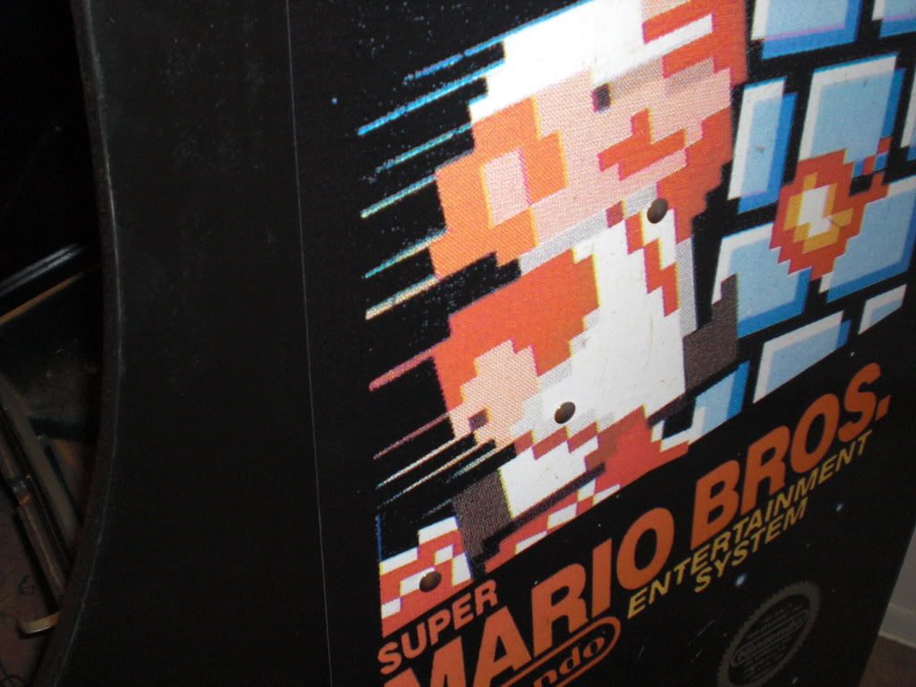

MK3FAN
  • Posts: 975
Re: Super Mario Brothers In A Pacman Cab
« Reply #33 on: October 18, 2008, 10:22:34 am »
The VS sideart was usually something like this..... kinda boring.
I like your idea.  :cheers:
I know, but since SMB did not have dedicated sideart, I thought this NES box art would look better that that generic one. Thanks.
