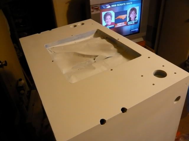

I recently picked up a Williams Indiana Jones(not the inferior IJ4 by Stern).  This machine has been a holy grail of mine since I first played one.  Yes, that horrible pun was intended.
It was in good shape with the normal cabinet fading.  I was just gonna live with it but decided what the hell, why not do a complete restoration down to the last nut and bolt?

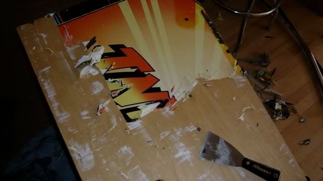

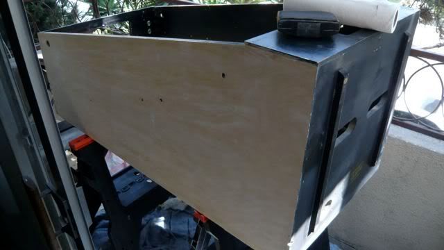

I have stripped the entire cabinet bare and I am in the middle of sanding and prepping the sides for new decals.  The original decals came off pretty easily with the help of a heat gun....
I have been patching holes and sanding like crazy.  I'm trying to get the sides as smooth as glass for the decals.

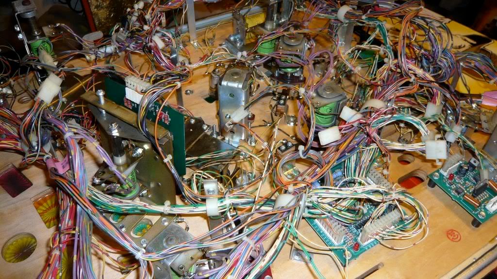

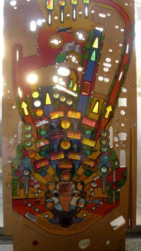

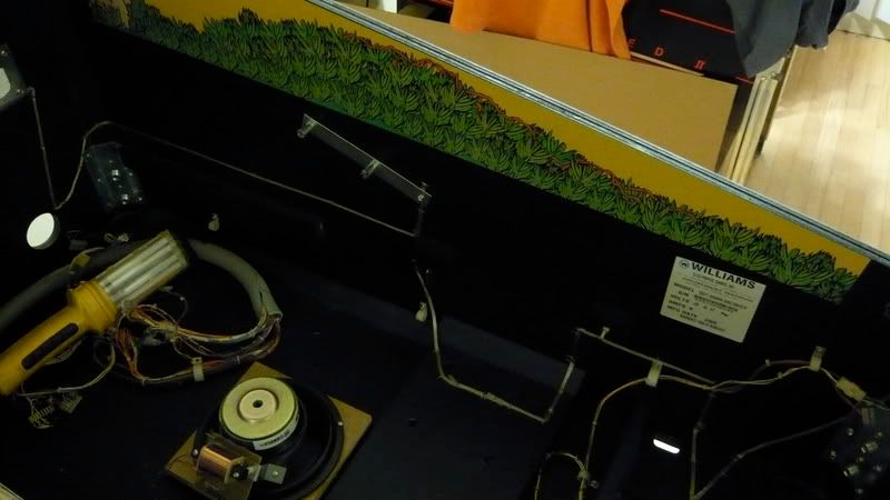

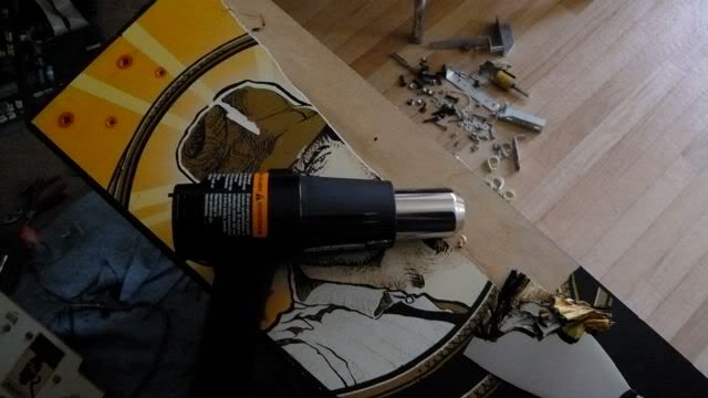

Here is the underside of the playfield before stripping everything from it.  Yeah, I'm pretty screwed with getting this thing back together.  Hopefully it looks worse than it is...
I took tons of pictures of the disassembly but something tells me I am going to have some questions during the reassembly.

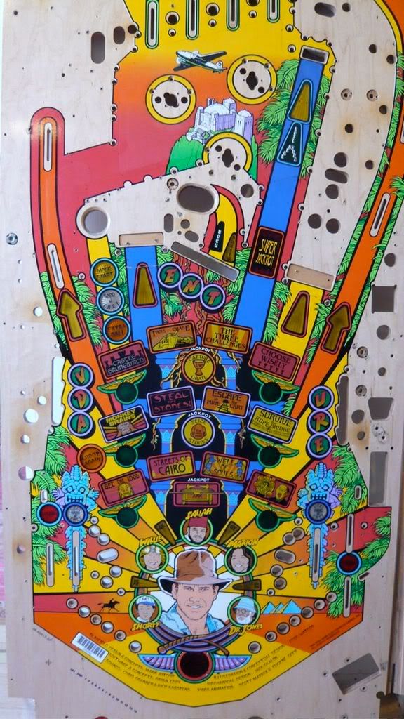

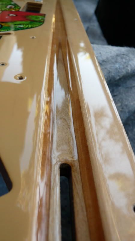

The playfield is in great shape with hardly any wear at all.  Since I am going overboard on this restoration, I begged Chris Hutchins at "High End Pins" to restore and clearcoat the playfield for me.  He finally agreed to squeeze it in for me.
Before clearcoat:

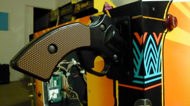

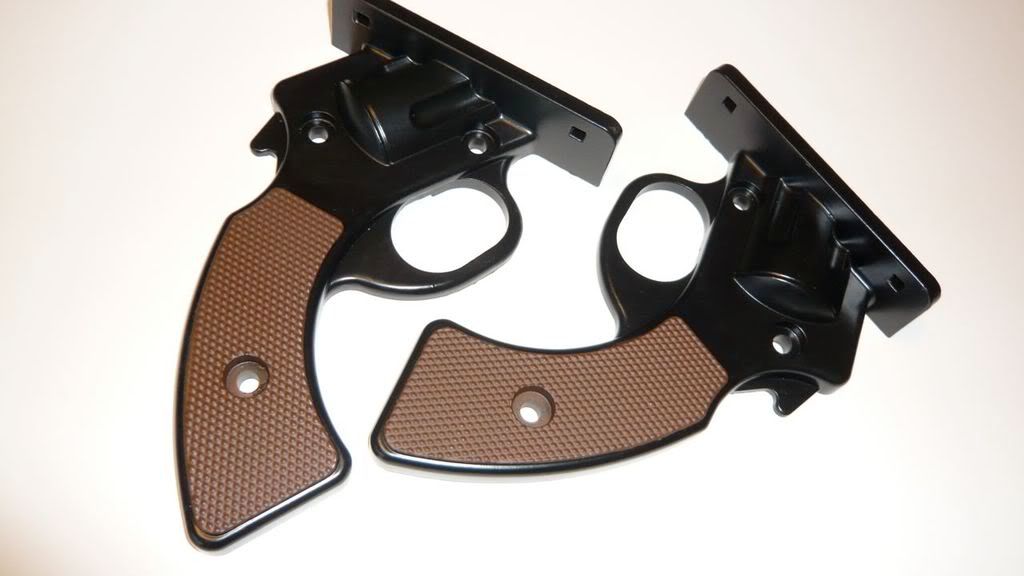

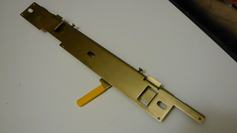

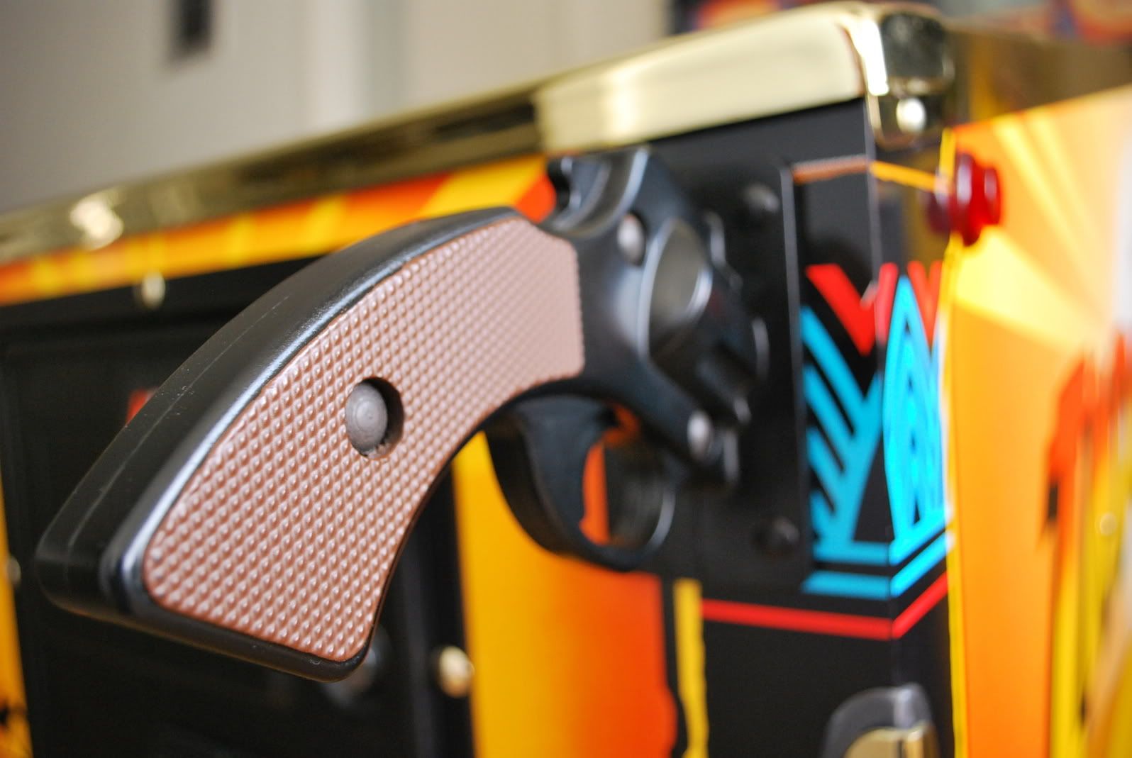

I just got finished with the shooter gun assembly.
I always thought having the gun plated looked lame so I had the gun powder coated satin black.  I then masked off everything but the handle with liquid mask.  Finally I shot it with brown Krylon. I think it turned out pretty damn sweet.

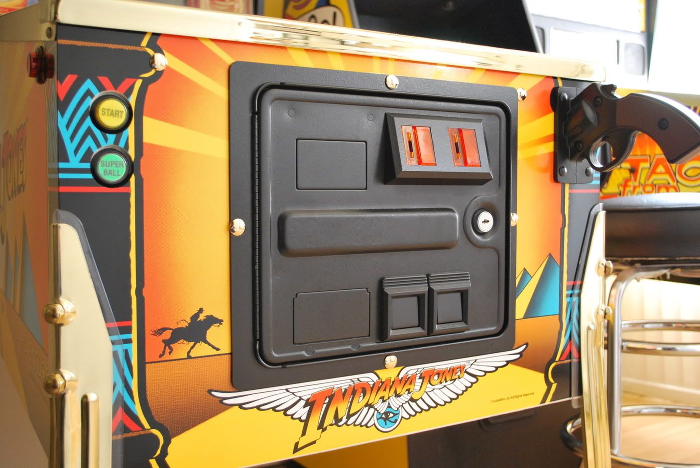

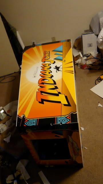

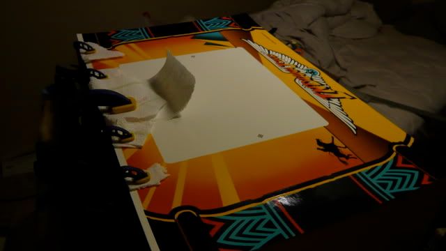

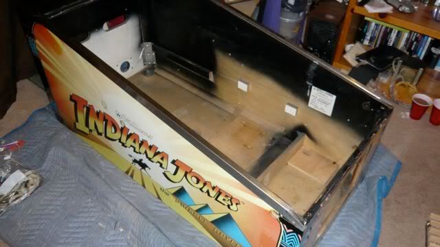

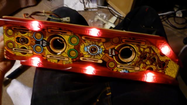

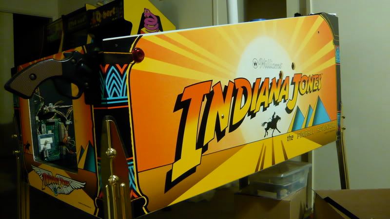

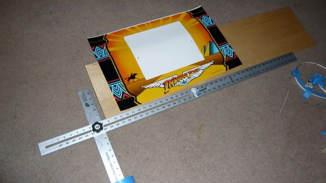

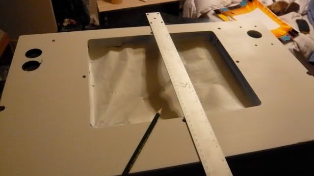

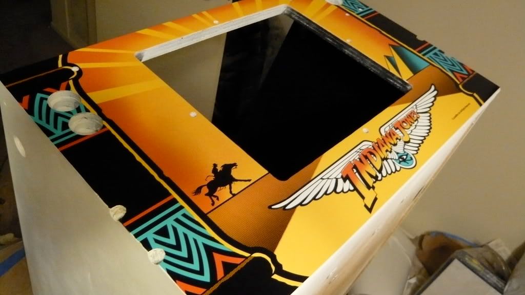

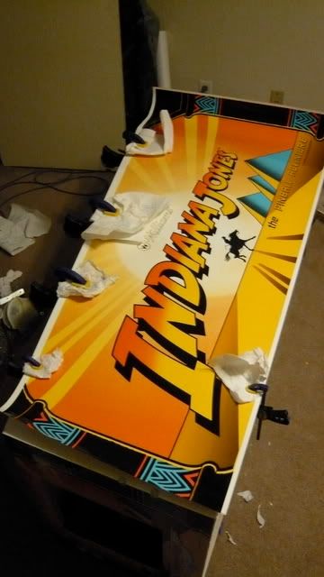

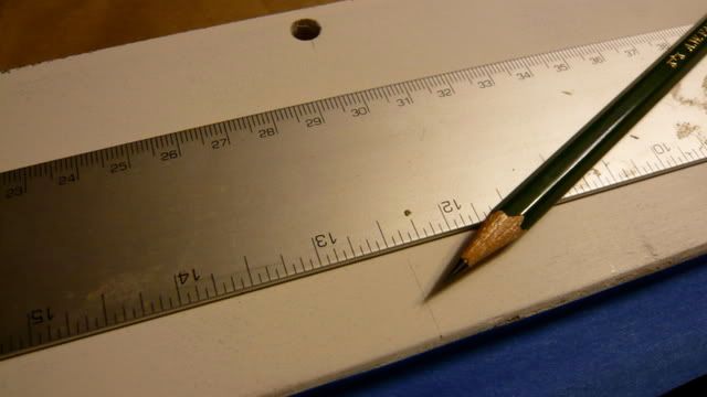

I installed the front and right side decal tonight.  They turned out really well.  The only trouble I had was right near the start button.  A piece of my dogs hair got under there and I had to slice the decal to get it out. Luckily it's barely noticeable.
Everything all primed and ready to go.  I didn't paint it black underneath like some people cause I think that the black paint can have a dulling effect under the decal.  I used Kilz primer sanded smooth with 400 grit.
First I measured and marked the center on the cabinet.  The center coin door bolt holes are dead-center so I just marked straight down from the middle of them.  I put a little mark with a pencil on the bottom of the cab.
Next I trimmed down the bottom and sides of the decal.  Trimming the side before install doesn't really matter but it's much easier to center when you have the bottom perfectly set how its going to be by cutting it with a t-square beforehand.
Front decal lined up and clamped.
Decal installed.
Side decal clamped.
Installed.
I'm really happy with everything so far.  I will never do one of these again though.  It takes so damn long and it's a bottomless money pit.  Being close to done with the tedious cabinet work is something to look forward to.

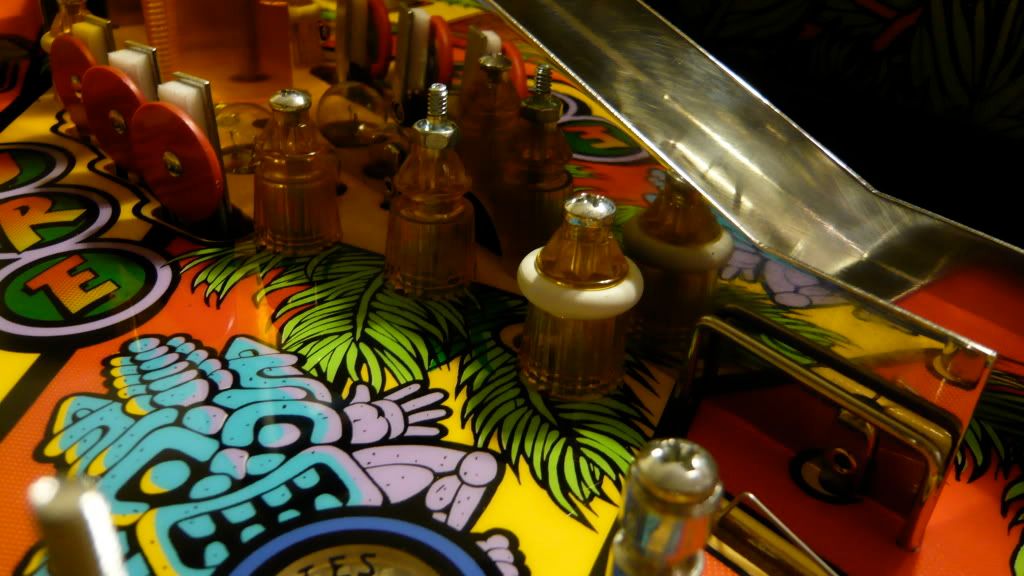

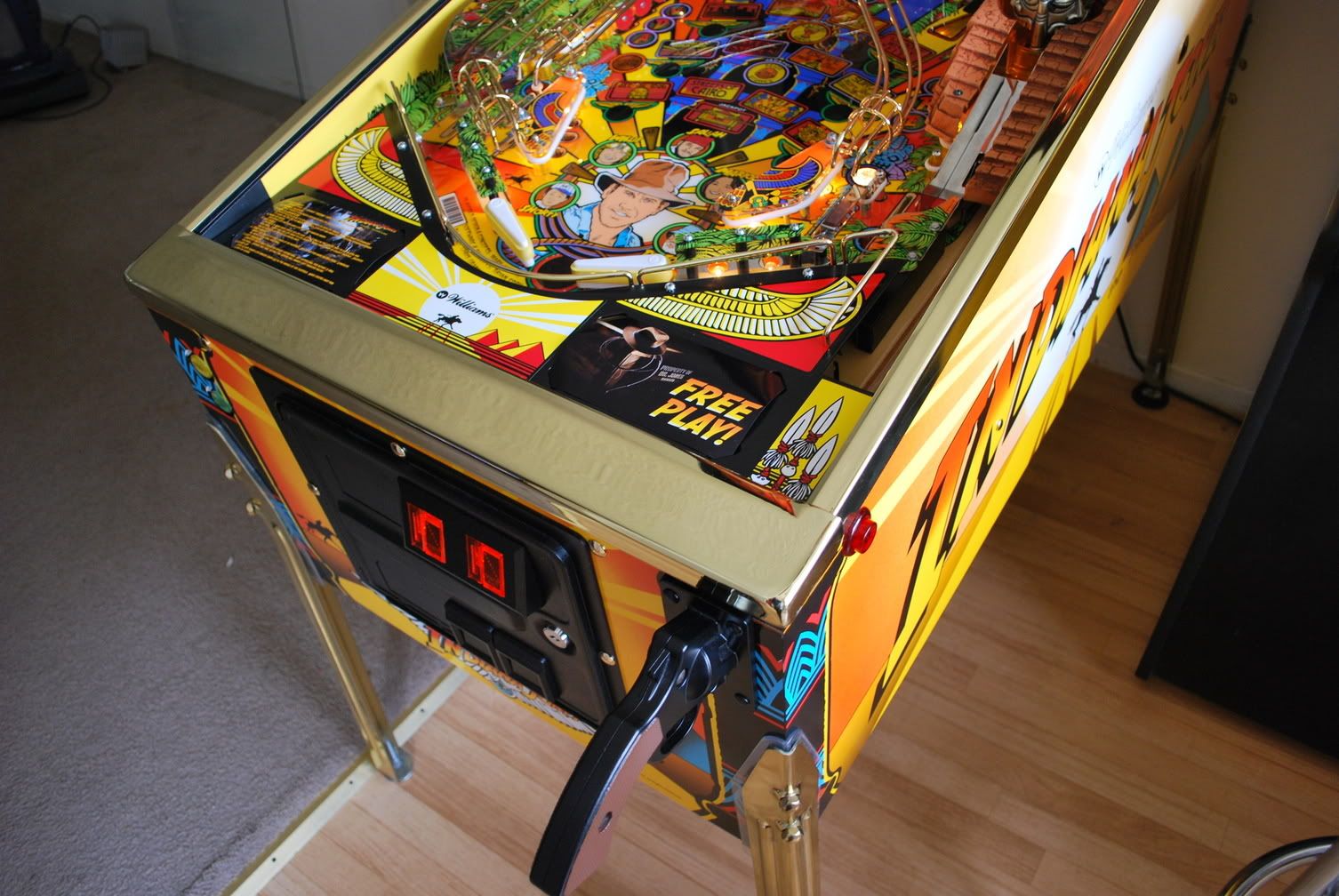

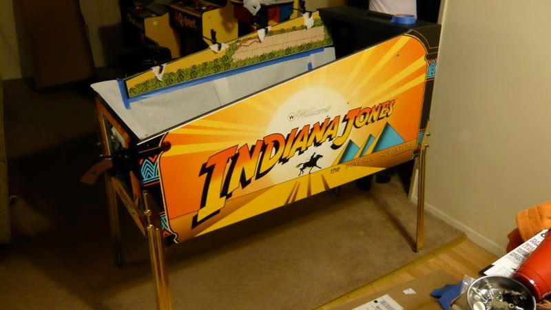

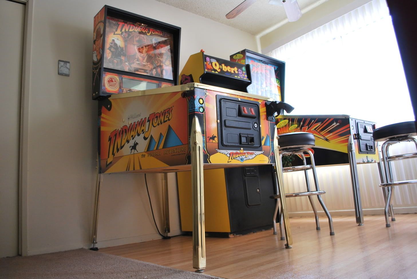

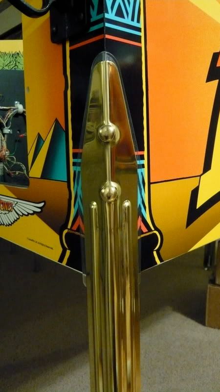

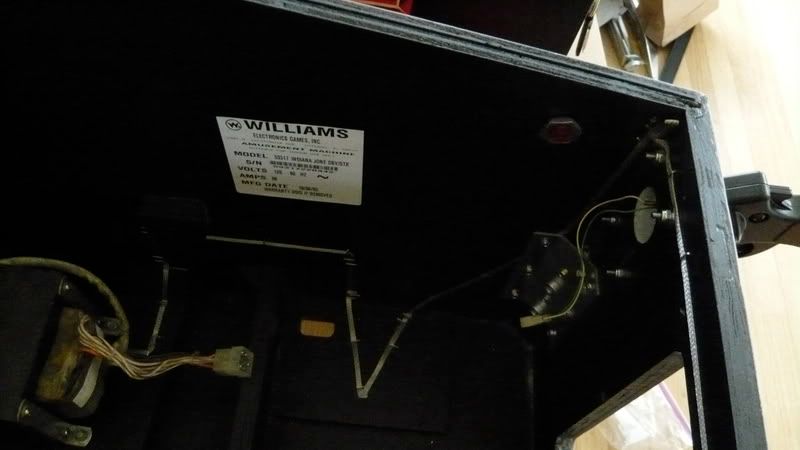

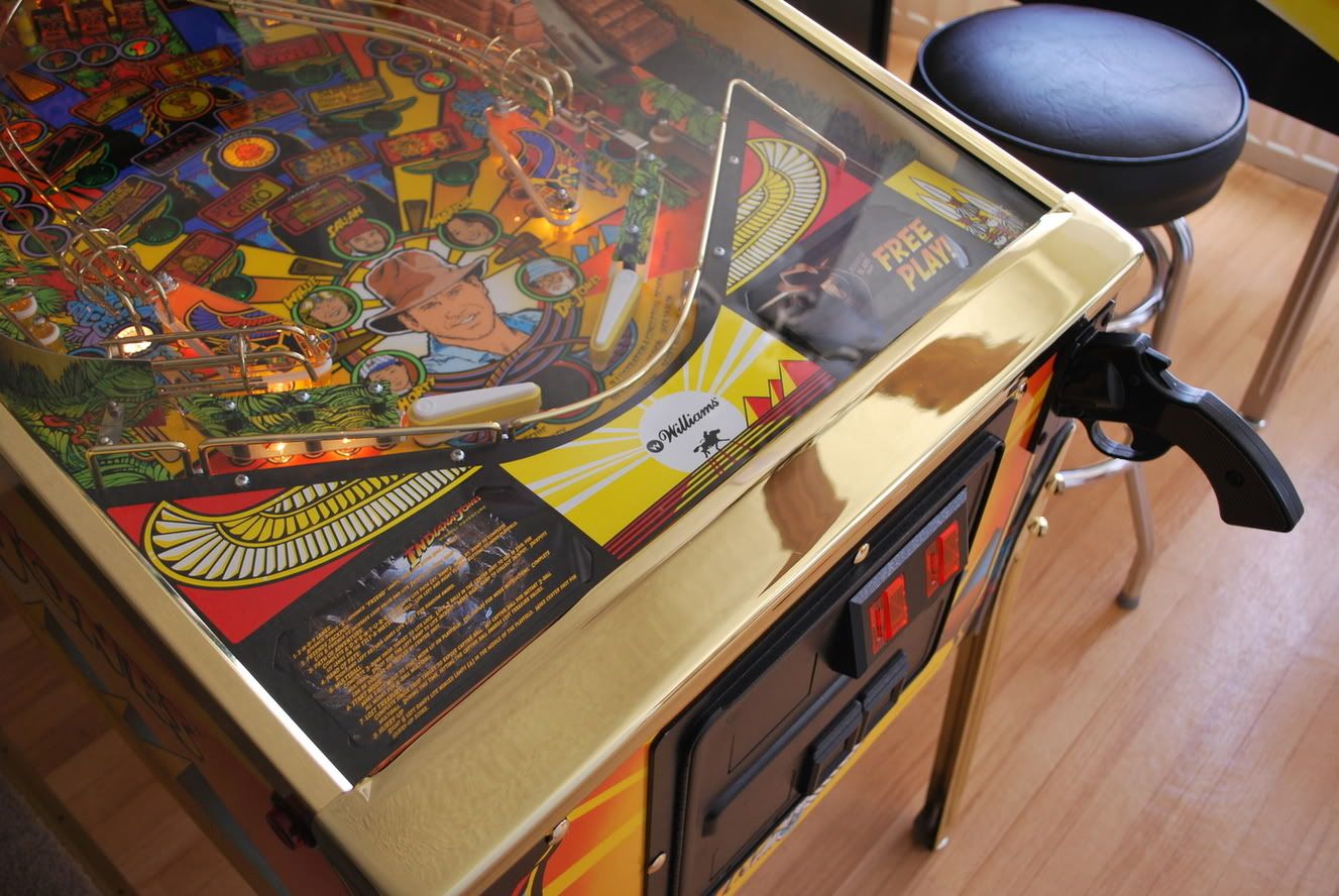

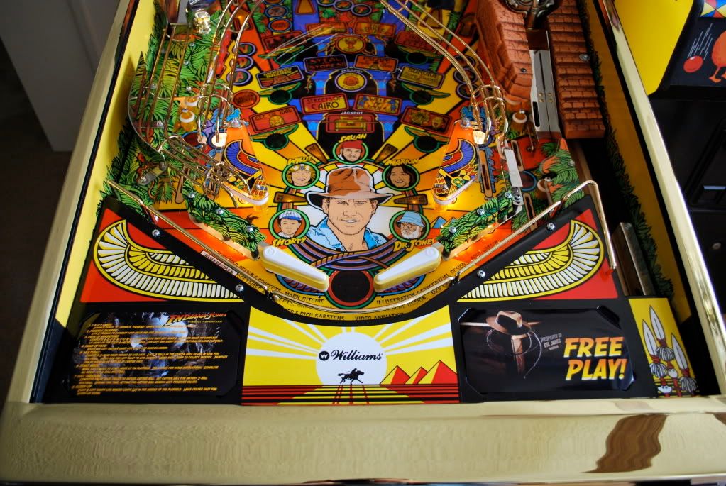

« Reply #19 on: November 09, 2008, 06:54:41 am »

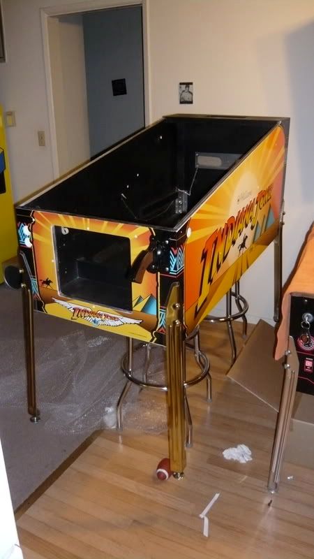

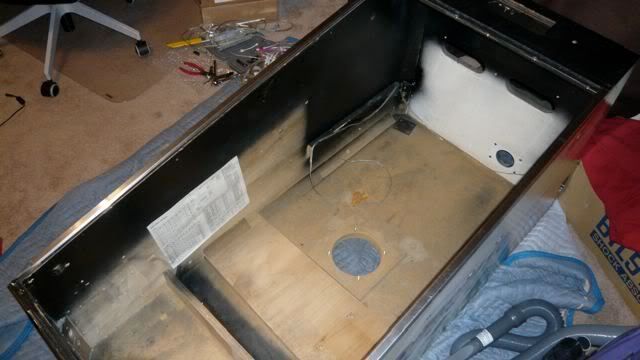

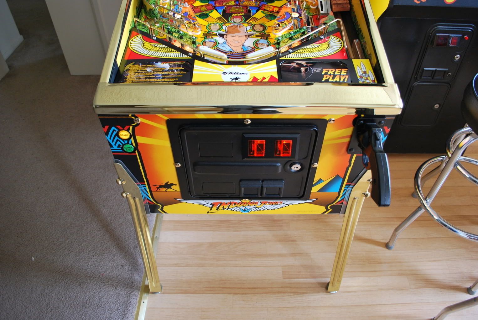

Made some progress...

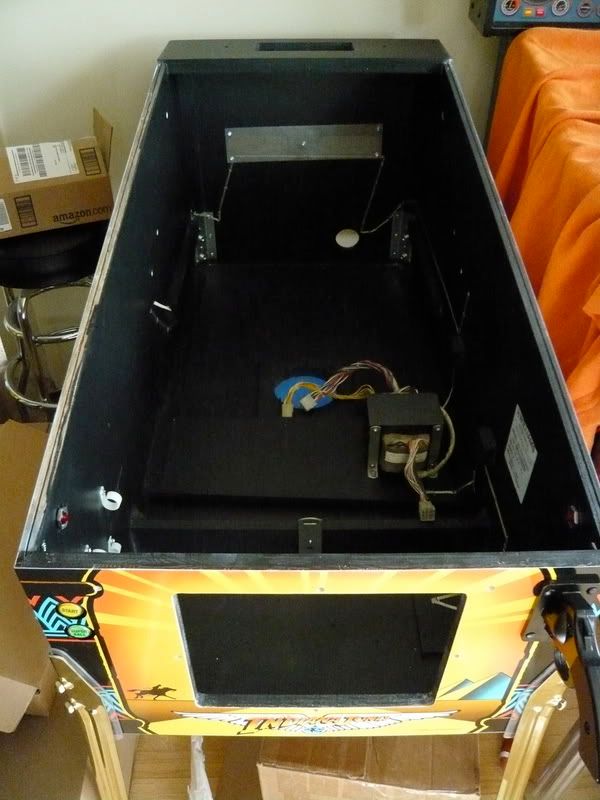

I finally got the cabinet up on it's legs.
As you can see, I painted the inside of the cabinet a satin black.
The legs are brass plated, highly polished legs from Pinball Life.  The finish is awesome.  I used some clear "Pincab" protectors to keep the legs from damaging the new decals.
Yummy...
Installed the shooter gun...

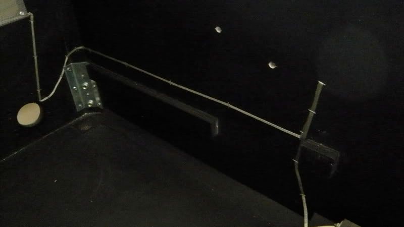

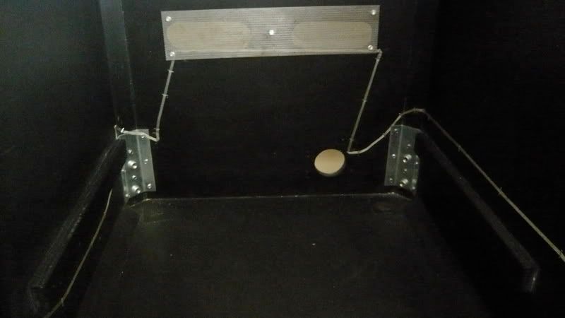

I installed all new grounding braid as well...
After installing the wiring harness I installed some side board decals from Treasure Cove.
The quality of the decals is is great.  A little pricey though...

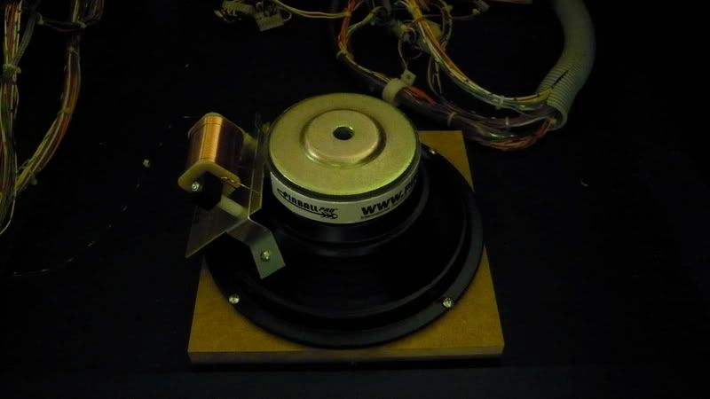

Also installed a Pinball Pro Subwoofer...

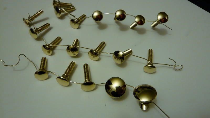

I went a little crazy and got all of the carriage bolts brass plated.  They turned out incredible!
After the Bears beat the undefeated Titans today, I will be installing the backboard head decals.  My playfield is coming back from clearcoat next week.  All of the cabinet work has been time consuming and nerve wracking.  I am looking forward to repopulating the playfield.

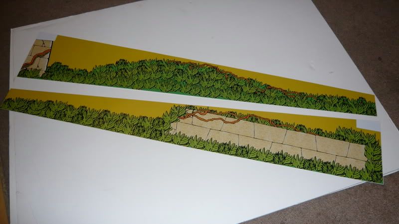

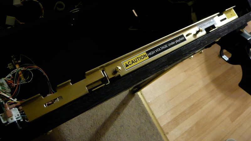

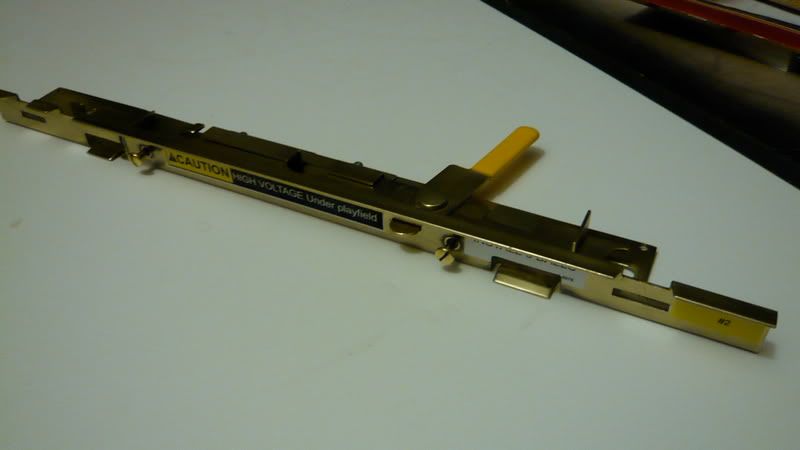

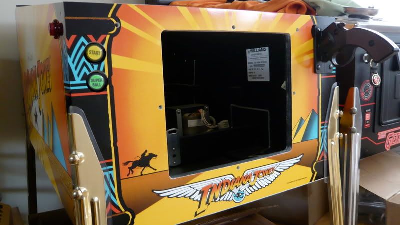

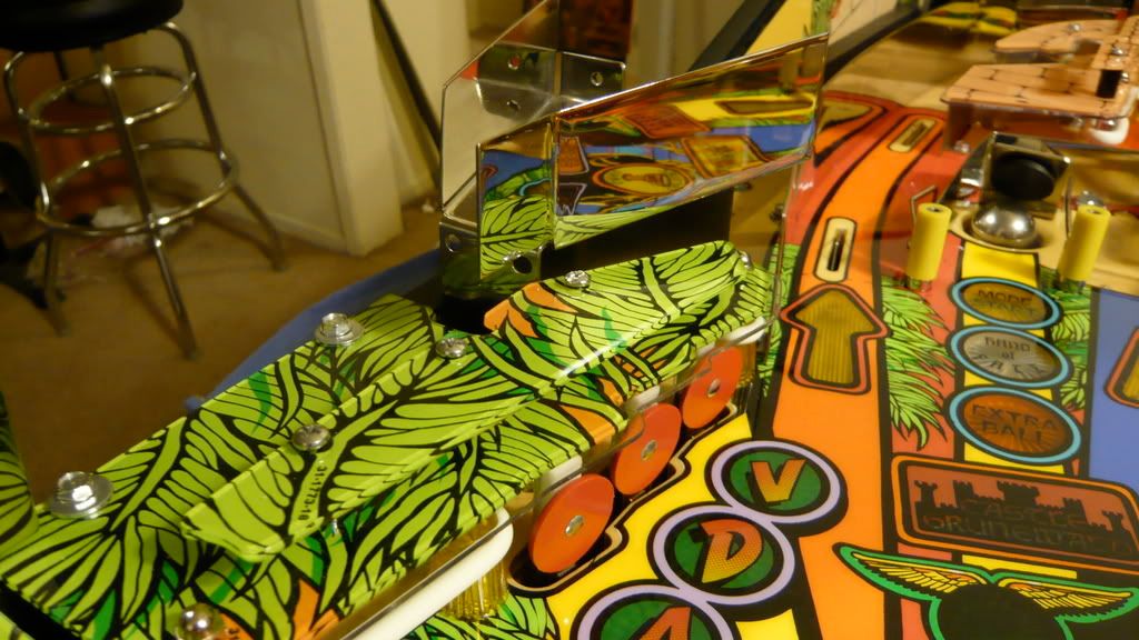

Had the lockdown latch brass plated and installed new "shop out" decals.
I used Plasti Dip to redo the handle.

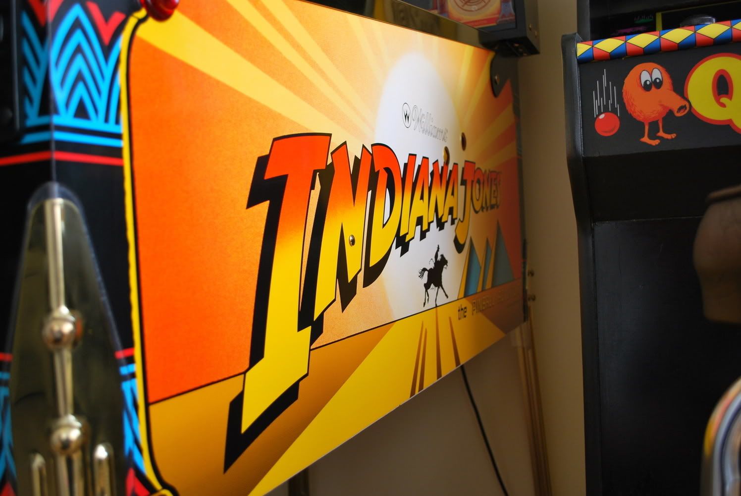

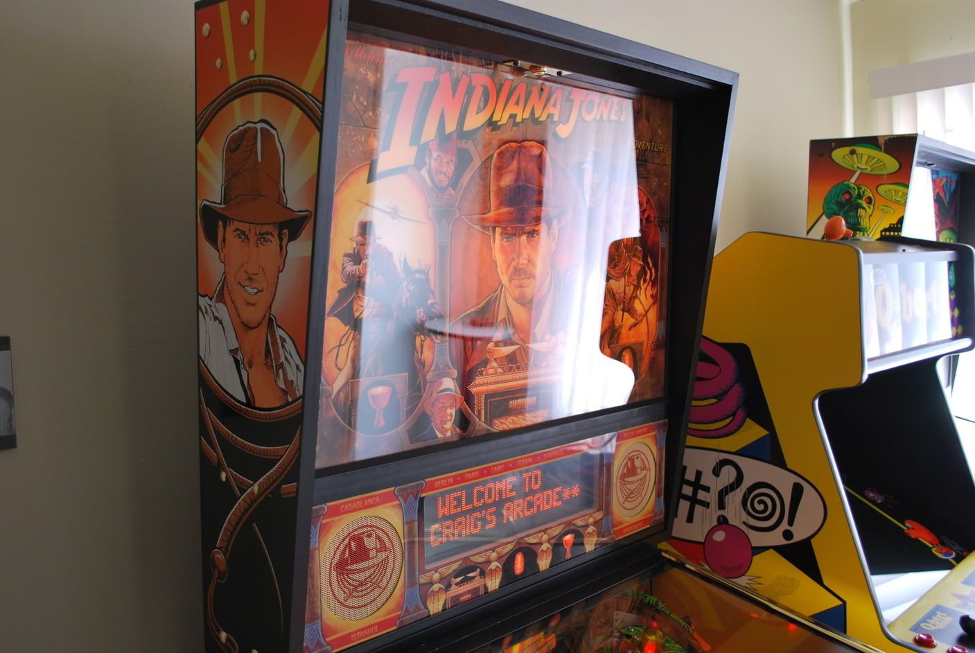

Wow, this thing is looking incredibly sharp! Since they are from treasure Cove, I am assuming those side skirt decals are completely aftermarket created? Either way they are really neat.
koolmoecraig
  • Posts: 1432
    • My Intervention
Re: Indiana Jones Restoration has begun!
« Reply #23 on: November 11, 2008, 01:22:59 pm »

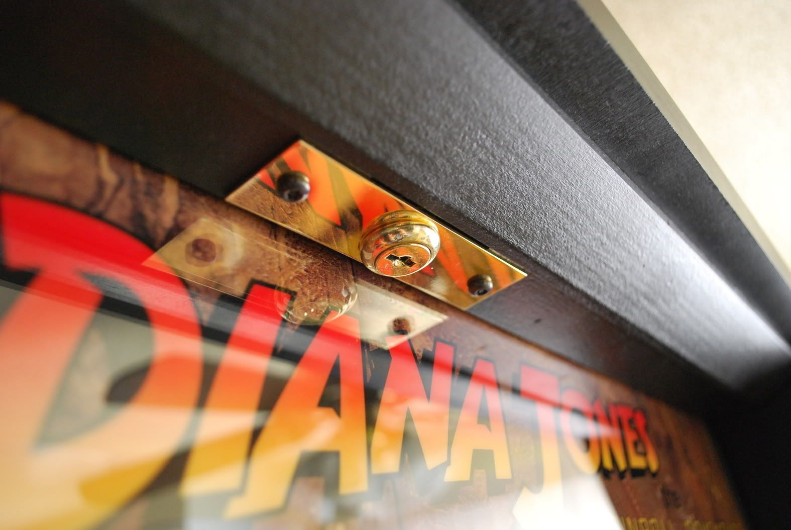

Thank you.
Yeah they are custom made.  Here is a pic of them installed.  Pretty sweet.

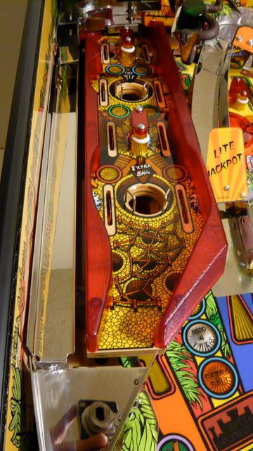

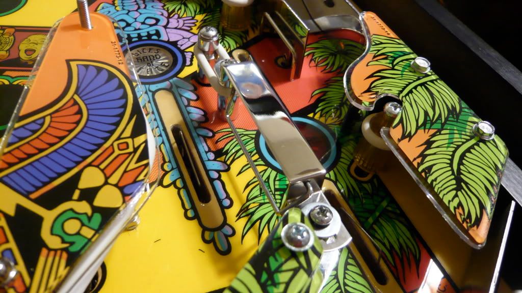

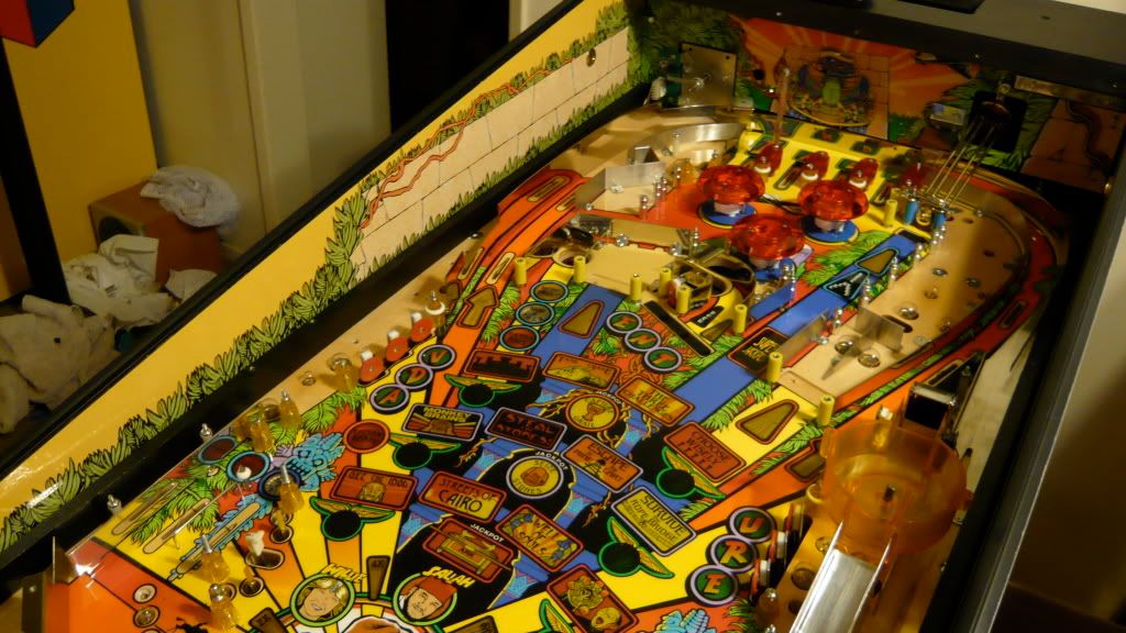

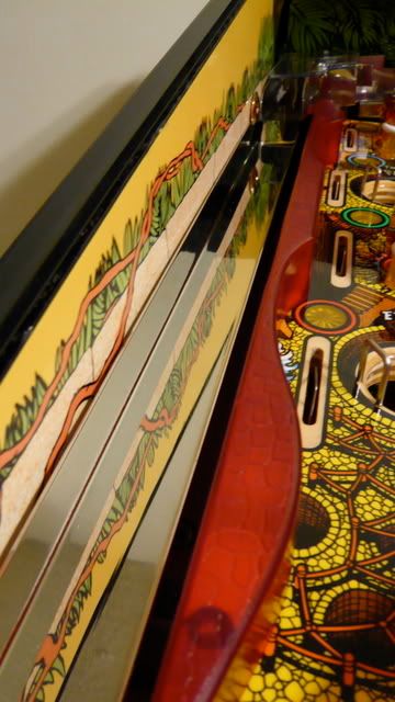

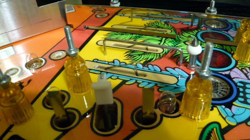

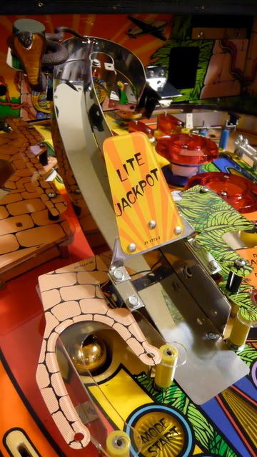

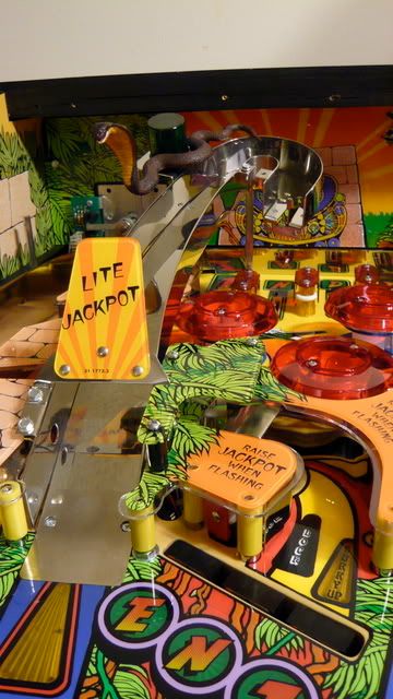

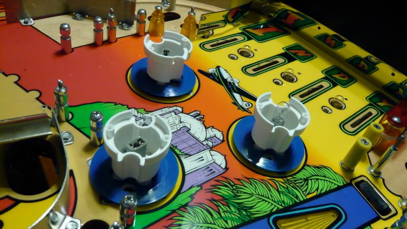

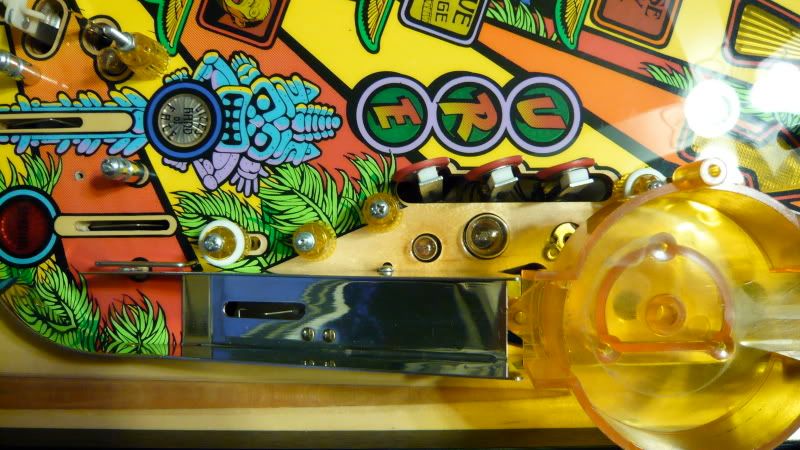

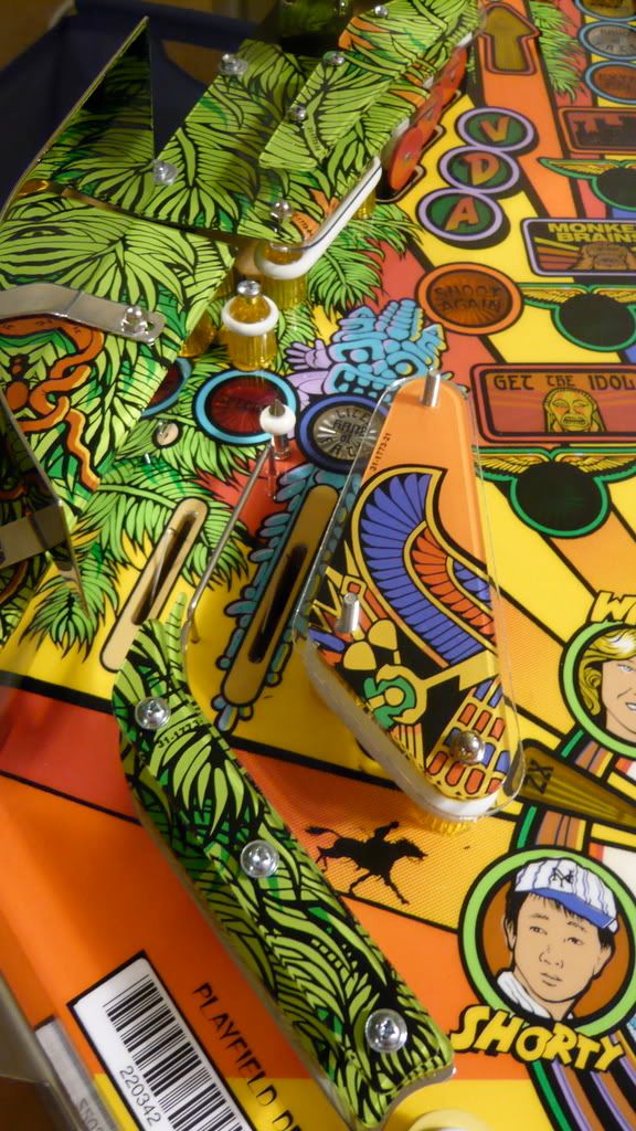

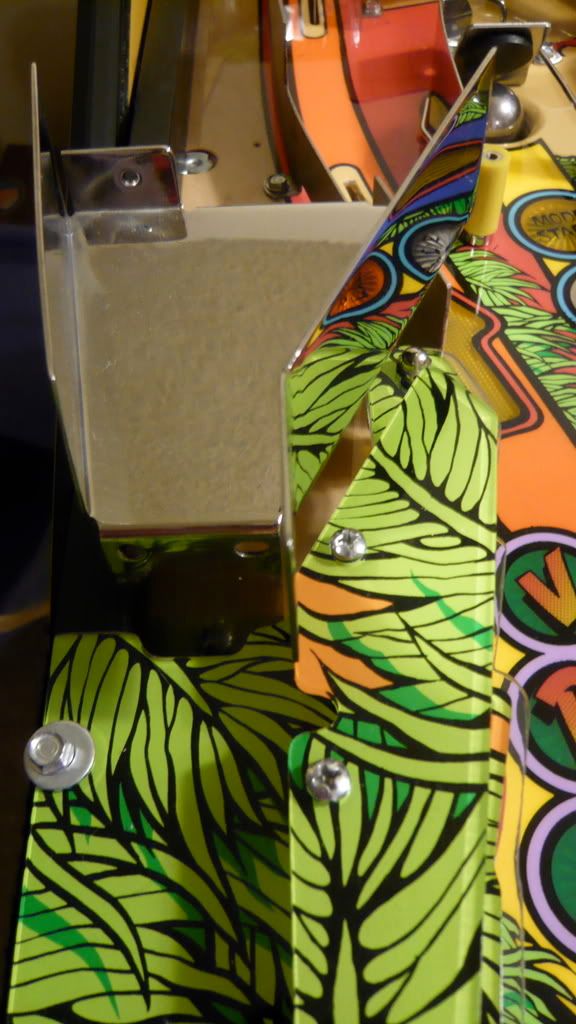

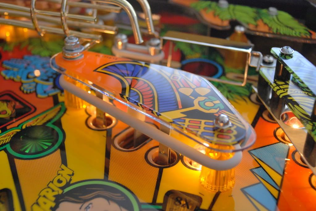

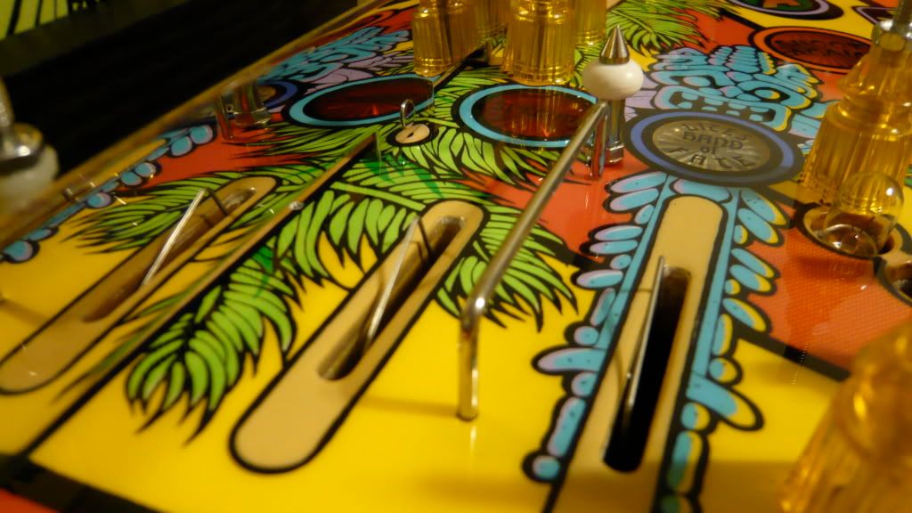

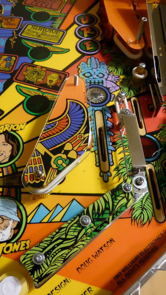

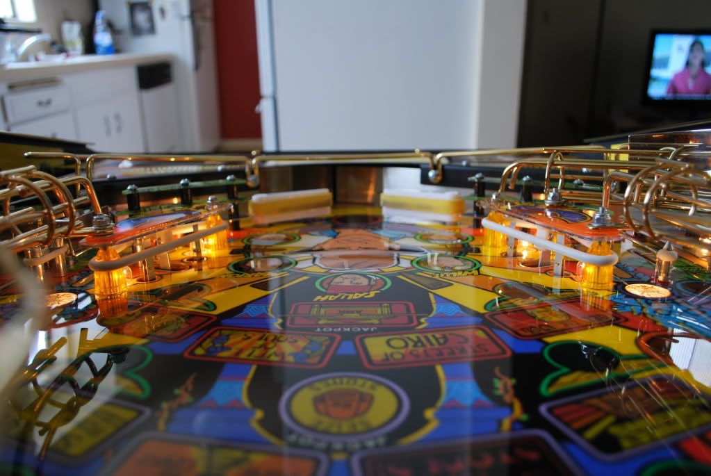

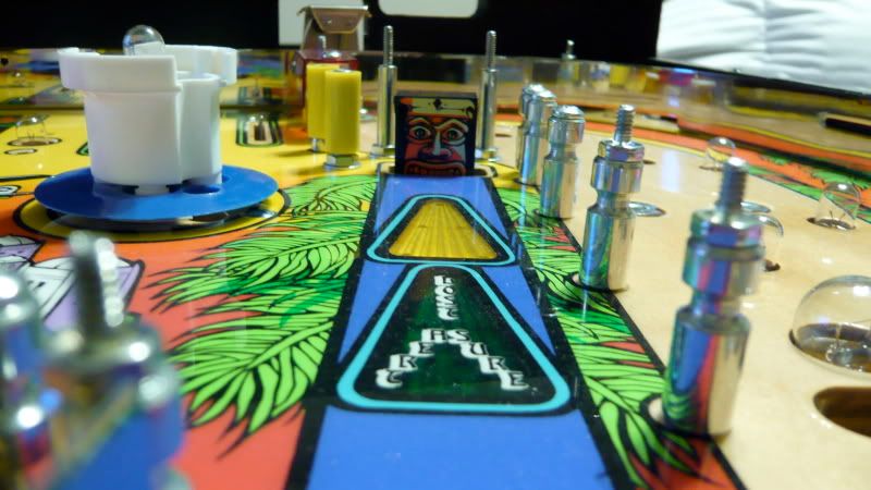

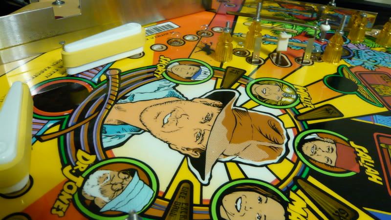

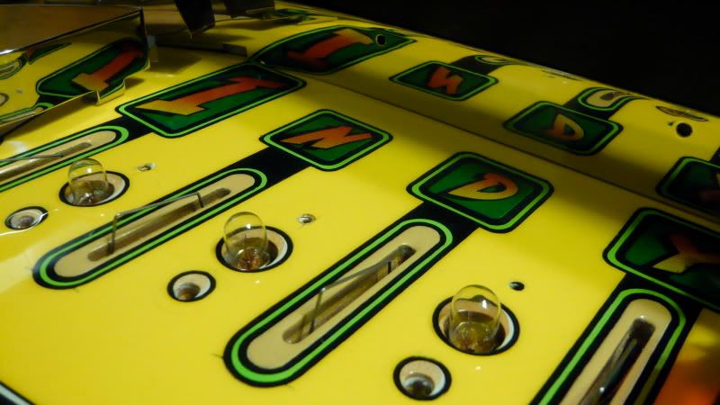

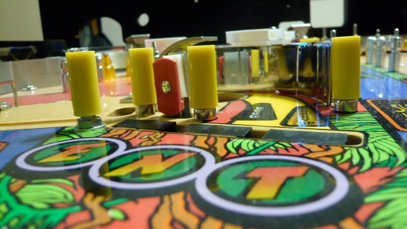

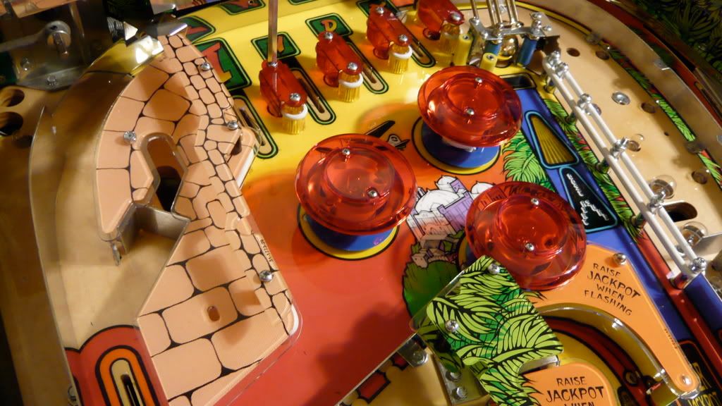

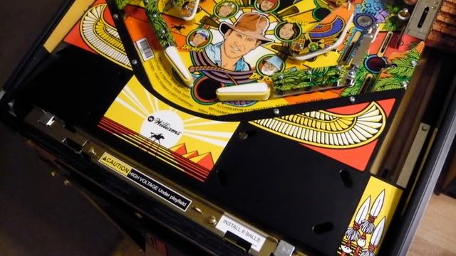

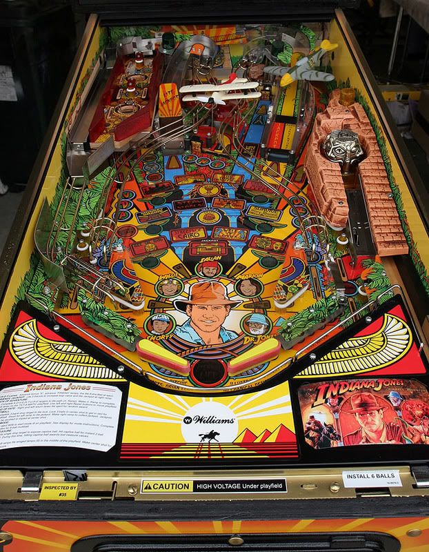

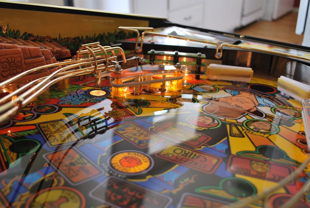

I got the playfield back from HEP today and it is simply stunning.  It was touched up around some of the inserts, minor repairs to the eject and saucer holes and clearcoated.
Perfection!
Shooter lane is perfect.

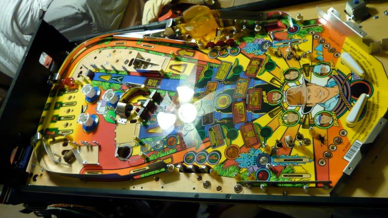

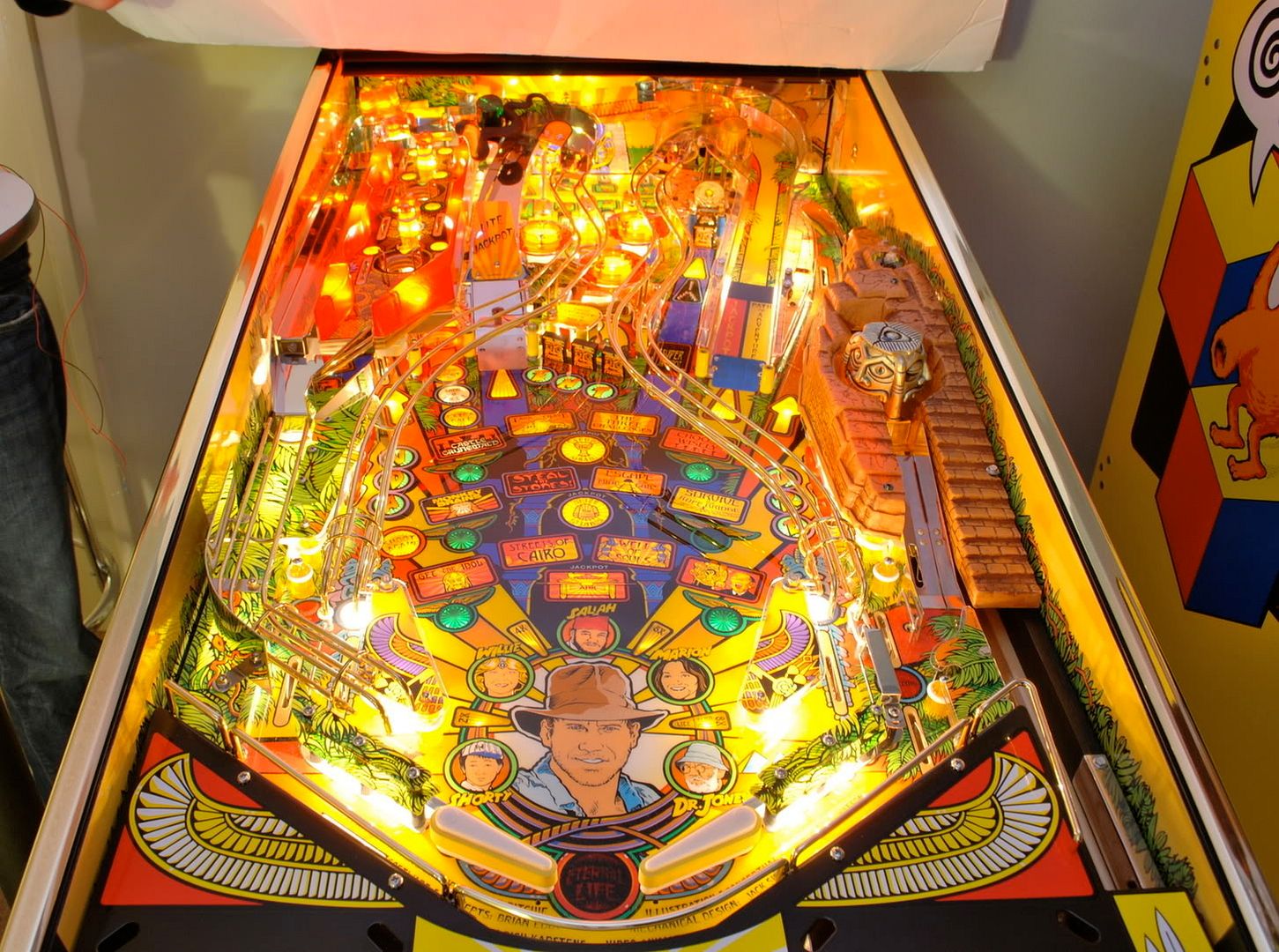

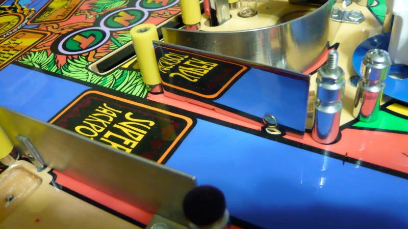

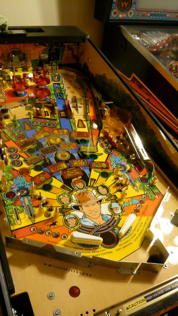

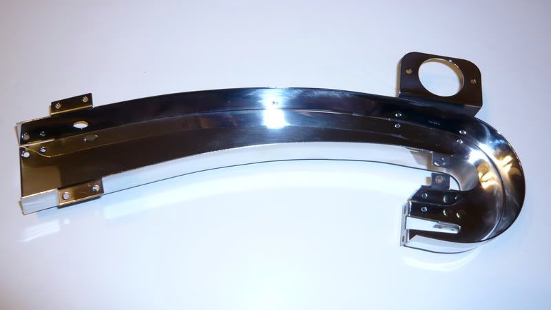

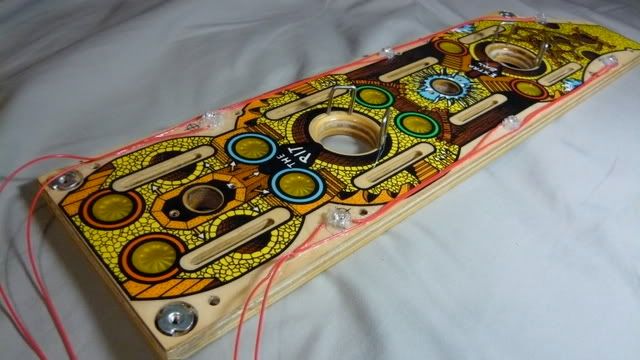

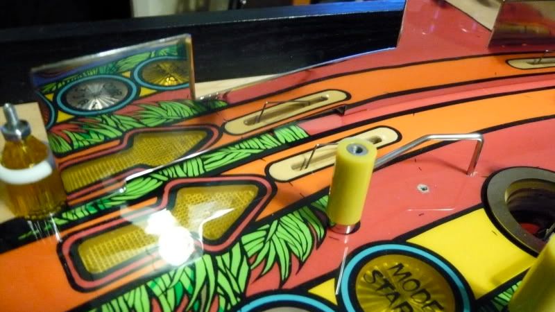

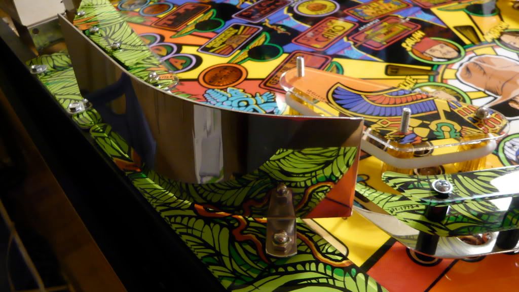

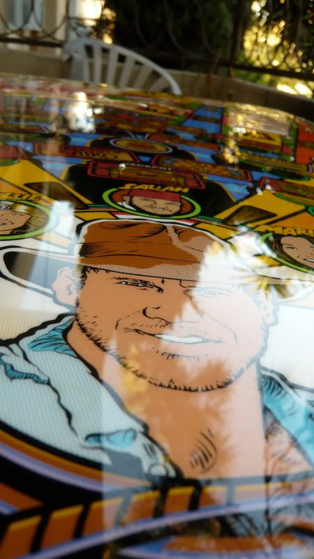

« Reply #27 on: November 19, 2008, 01:27:18 pm »

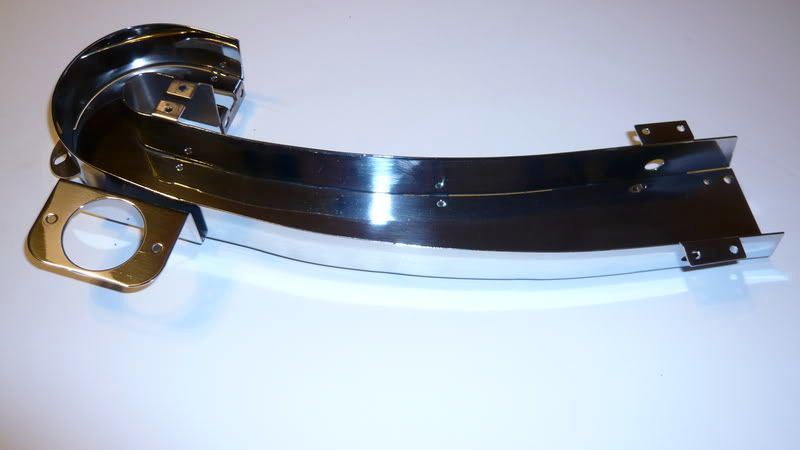

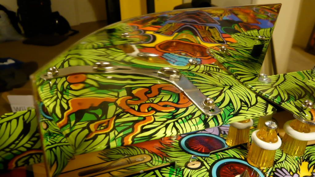

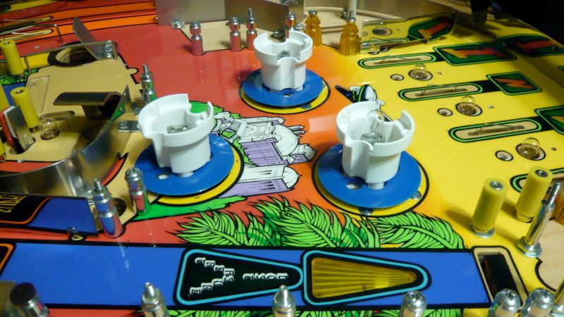

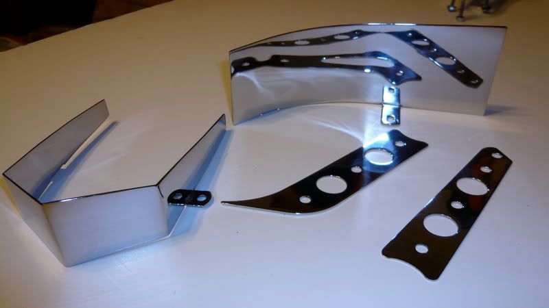

It took a long time but I finally finished polishing all of metal for my playfield.  It's not brushed like stock but all of the older machines used to use highly polished pieces and it looks incredible.  The mirror-like reflections really give the playfield an open feeling.  Plus they probably only stopped using it because of cost.
I'm waiting on my rotisserie.  Once that arrives I can begin reassembly.

Beautiful work so far.  :cheers:    I myself have only attempted a topside playfield teardown, clean, and reassemble.  This looks like a fun, albeit difficult, project.
Was the bronzing or clear coating expensive?
shardian
  • Posts: 9218
Re: Indiana Jones Restoration TONS OF PICS!
« Reply #29 on: December 02, 2008, 04:20:04 pm »
That clearcoat is amazing. I'm working on buffing a clearcoat right now. While mine may be shiny, it is not even close to the same league as that perfection your is.

I decided to go with blue bumper skirts instead of the red or yellow that everyone usually uses.  I think it picks up with the rest of the blue nicely...
koolmoecraig
  • Posts: 1432
    • My Intervention
« Reply #35 on: December 05, 2008, 09:10:10 pm »
The polished metal parts REALLY "extend" the playfield.  Of course, most of them wont be visible when everything is installed but they sure look pretty now!  The ones that are visible are gonna look great with light bouncing off of them.
« Last Edit: December 05, 2008, 09:12:39 pm by koolmoecraig »
koolmoecraig
  • Posts: 1432
    • My Intervention
« Reply #36 on: December 05, 2008, 09:31:52 pm »
Check out the ceiling fan reflection :)

Other than elbow grease, what did you use to shine your metal parts, ramps, etc.

I see you install the plastic protectors, doing so today here with my MB. Where did you order yours from, they look nice?.
A Dremel with some polishing rouge followed by Mothers aluminum wheel polish and about 100 cotton rags.
A Dremel. Damn. Never even occurred to me.

The protectors are from orbitpinball.com.  They have lots of great products.

Left ramp in.  I customized it with a little cobra.

I'm waiting for the side rails and wireforms to come back from being re-plated.  I wasn't happy at all with the original plating job.
Once I get the side rails back and installed, I can put the back board on.  Connect all the wires, get some playfield glass and I'll be good to go.  Assuming I didn't muck anything up during the tear down and rebuild.

Got the apron back from being re-powdercoated.  New decals installed.

Decided it would be cool to light up the "Path of Adventure".  I mounted 6 SMD LEDs that will be powered off of the 12vdc that goes to the Path's motor PCB.  It turned out great.  The LEDs are held in place by some clear RTV sealant.
Crotch shot :)

Installed the Path of Adventure and the outside ball return slide...

Unbolting parts, sending them to someone else, and bolting them back together is not a major project, Zero_Hour.
The only parts that I sent out were the playfield and brass.  Doesn't my cabinet work, metal polishing and mods count for anything?

I like how I can see your camera reflecting off the mirror finish you have on the ramp leaving the PoA.  Very Nice job.  Hope you enjoy playing it after all that work.

99.9% done.   Just need to install the air planes.  I think I'm going to leave off the bi-plane.  I like having the playfield less cluttered.

Went a little crazy with the brass plating...

I only have about 20 plays on it but it plays incredible.
Fast but not too fast.  Smooth as hell and the ball still bites.  Doesn't just float on the surface.
I'm really happy with it.  I wish someone would make white rubber rings that are more firm like the black rings.  The white ones play too "softly".

I'm picking mine up on Saturday. I'll be doing my gun like yours. MUCH better than the brass treatment.
