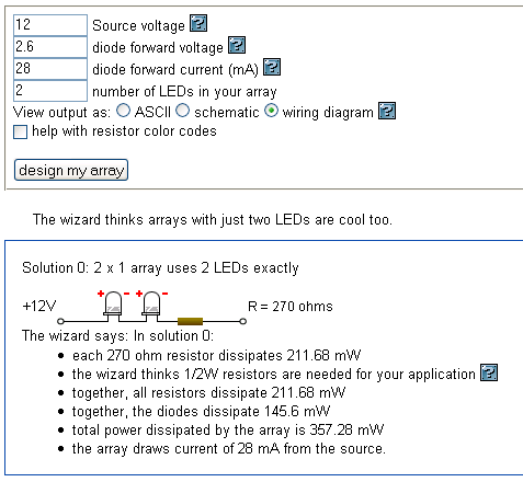

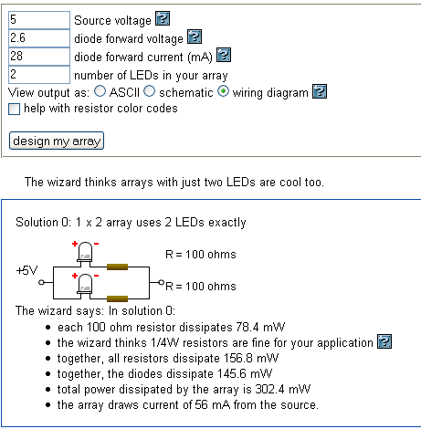

Hey. Just finishing up my cab, so I picked up 2 2.6 v 28mA red LEDs from Radioshack to use in the coindoor. I want to power them w/ my computers power supply. Does anyone know how to use the 5v or 12v lead to do this?

You can use either 5v or 12v.
Using the LED series/parallel array wizard at http://led.linear1.org/led.wiz gives the following results:
5v
12v

That calculator is a great tool. If you use 12V and hook them up in series, however, if one LED goes out then neither will light. You can still hook them in parallel using 12V by using 180Ohm resistors instead of the 270 in the diagram, FYI.
