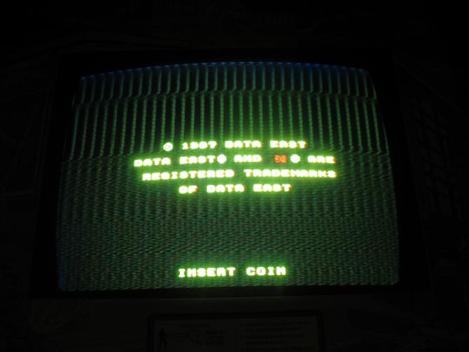

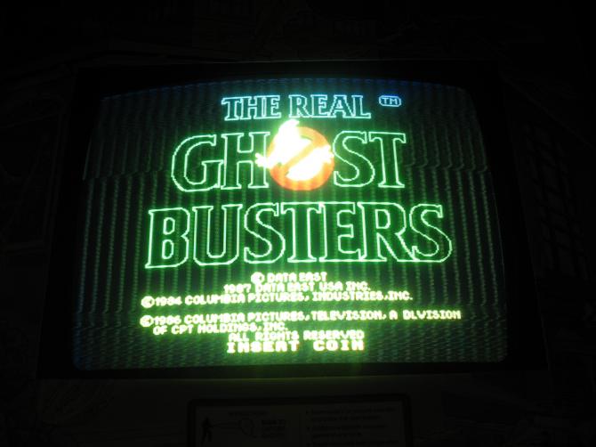

The Hantarex MTC900/E that I just got in a Real Ghostbusters cab has some problems.  I was wondering what might cause a large portion of the image to be missing the blue, but the top shows it.  What would be the best way to go about fixing it (if it's even possible).  Would it be worth it to replace the caps?  Can bad caps cause these kinds of color problems as well as wavy jailbars?  Thanks for your help!

a monitor of that age would benefit greatly from a full electrolitic cap change,also check for bad solder joints
the colour problem could also be down to gaussing issues

i think you colour issue is being caused by a faulty degauss or a magnet close to the screen(i.e a speaker),some mtc900 chassis had a push button degauss-does yours?

try turning the cab with it switched on,if the colours get better when you turn the cab or change somewhat then you def have a degauss issue(this could be component failure)
the lines on the pic could be a ground/earth issue

The image did indeed change colors when I rotated the cab.  I had it facing west when I took the photos in the first post, when I rotated it so the front of the cab faced south-east it looked the best, though it was still flawed.
The jailbars are sometimes not moving, ant the picture looks clear except for the light and dark banding, but usually most of the screen "jiggles" left and right with each line on the screen moving left and right very quickly independent of the lines above and below.  I don't know if that makes any sense.

I replaced the capacitors using a Bob Roberts cap kit and I replaced the blue transistors on the neckboard, and this is what I am left with:
At least the jailbars are gone  :)  The smudge in the upper left is on the plastic, not the monitor. Different inputs cause the monitor to "whine" at different frequencies, but the image looks the same the whole time.  It looks that way with no input, too.
Also: adjusting the pots on the neckboard doesn't change the output AT ALL (not brighter, not darker, nothing) and the brightness and contrast controls on the main board don't seem to affect the picture either.  The vertical hold pot seems to make a difference and the screen and convergence still affect the image, as well.

looks like the green drive transistor is full on
