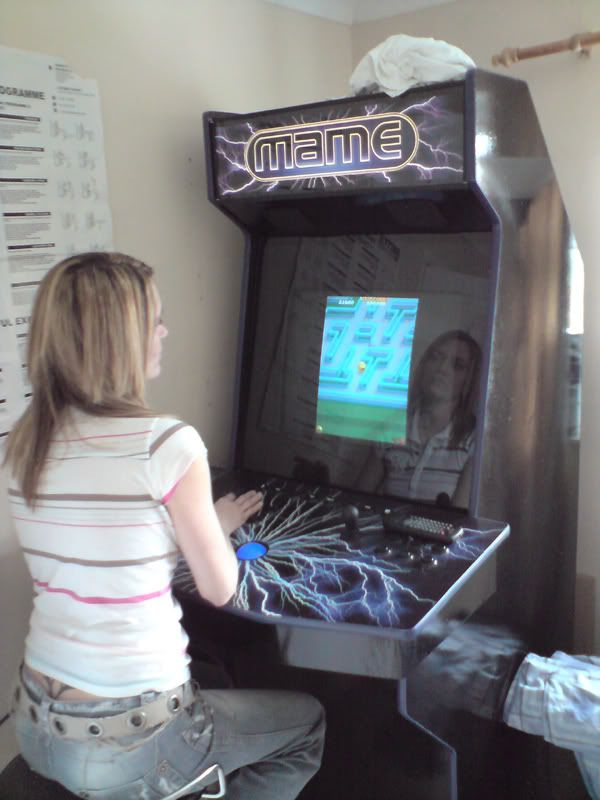

shock pic of my wife on my arcade cab!!!!!!!

your wife is hot  :cheers:

Man, she looks thrilled! (see her reflection) :)  My first post here btw...and yes, she looks hot. I like that tat...congrats, u have a hot wife! EDITED once I saw your avatar! :)
