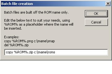

Here's how I'd create a batch file to delete ROMs I didn't want:
Launch ROMLister.  Go to Settings and Tools (the app will take you there the 1st time you start the program)
Download the required files and follow the instructions on that screen to create a merged .xml file. (This is a one time step)
OK, now for an example:
Say you didn't want mature games on your machine.
In the "category" section of the quick-find wizard, select mature, then hit GO!
ROMLister will spin for a bit, and then it should then display in the big window a listing of all the game names of all the titles that have "mature" for a category.
You should visually inspect this list to make sure that it's pulling up the games that are mature.
Now click the "batch file" radio button.
A popup dialog will appear:
In this dialog, we're going to tell ROMLister to make a batch file to move the ROMs that are mature somewhere else on your machine.
In the text window type:
move %ROM%.zip c:\badroms
and hit OK.
Hit the "Go!" button again.
This time in the big window, you should see a list, that looks like this:
move apparel.zip c:\badroms
move secolove.zip c:\badroms
move housemnq.zip c:\badroms
move housemn2.zip c:\badroms
move seiha.zip c:\badroms
move seiham.zip c:\badroms
move bijokkoy.zip c:\badroms
move iemoto.zip c:\badroms
If things in there look ok (ie, no spaces between the ROM name and ".zip")
then click the "output to" checkbox to "File" and hit GO! one last time.
A popup dialog will appear, asking you where to save the file.  Save it in your ROMs folder.  Save it as any filename you like, perhaps "no_mature.bat"
Then make sure you have a "badroms" folder off the root of your C: drive for the batch file to move your ROMs into.
Now you can go to your ROMs folder, locate "no_mature" and double click it.
The batch file will run, and move all those ROMs into your "badroms" folder on your C: drive.
tada.

Hate to bug you again, but the batch file does not seem to be working. I created a batch file, and it appeared to generate properly in the romlister prog. When I run the batch file from within my roms directory, with the batch file set to copy roms to a new folder within c:\mame called "vert roms", nothing happens.
When I pause the batch file, I notice that for each rom file it either says "The system cannot find the file name specified", or "The syntax of the command is incorrect". The error messages alternate.
A typical command line during the run of the batch file appears as so:
C:\mame\roms>copy rescue.zip C:\mame\vert roms
EDIT before I even finished typing:
It appears that due to the command line functionality, you cannot have spaces in your folder names. Just wanted to point that out for fellow command line retards like myself. After I renamed the folder and reset the batch file, it worked fine.
You can enclose folder names that have spaces with quotes to get it to work properly.
