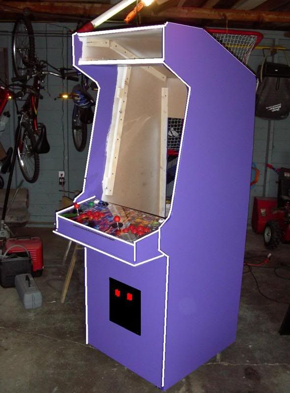

I started off with a plan in my head. Then changed it 23 times. Then I got 3 sheets of MDF wood.
I clamped 2 of them together, traced out the design I wanted, then cut with a table saw & jig saw.
Here's the side panels cut out
I then measured the correct distance and all to place some sliced up 2x4's (about 3/4 in thick) to support the top, back, and bottom pieces.
Then, I cut out the tops & back pieces

Now here I started screwing in the bottom front, back, and bottom to one side panel. I discovered that it's really important to have everything squared. Also, make sure your cuts are nice an straight.
Next, I attatched the other side panel.
And then the top pieces (notice the gaps, I have since re-cut those pieces)
Allright! Finally starting to look like something! (a fort for my boy  :))

Now on to the control panel. I originally was going to build a Defender cabinet because the cp looked really easy. But I wasn't happy with the edges on the cab. I wanted rounder edges. So I build a Street Fighter II - Champion Edition cabinet. However, the cp was made out of steel & had a really odd shape at both ends
So I had to figure out a control panel that's big enough for 2 joysticks, 12+ buttons, and a trackball & spinner. I also wanted it to "flip" out nicely so I can work on it if needed. Well, I wanted it similar to my Centipede cab. I am lucky to have a full sized Centipede game in my basement. I used this for reference many times. I kinda used Centipede's cp as a guide in my design.
Here, you can see how the Centipede cp opens up.
So, after many tried at it, I finally get a design I liked.
« Last Edit: June 27, 2008, 08:45:51 pm by KillerV »

My control panel will be simple at first. 2 joysticks, player 1 & 2 start buttons, an exit (PANIC! :P) button, and 6 buttons for each player.
I first made a cardboard template. It came out great.
Here's the stuff
Here's the cardboard
Here's the cardboard prototype in the cab
Next up, drilling and routing and cutting and coughing

OK, I'm back. I've been on vacation so I'm doing the family thing. But I was able to squeeze some work in on my cab.
Now back to the control panel
I started off testing my router skills on a scrap wood.
This is for the joystick
It aint pretty, but good enough for me.
After all that fun stuff I took the cardboard template/ prototype I made and traced all the holes onto my cp board wood. A little hard to see, but it's on there.
I then drilled out the button holes using a 1 1/8 paddle bit, it worked well.
Then I traced out the opening for the joystick to sit flush in the board, cut it out, then routed out the outer part of the hole. This looked like crap because I suck at routing, but it's all good cause no one will see it. ;D
So here it is after some primer
Next I cut some plexiglass to the same size as the cp. Layed it over the top and traced the holes.
I prefer cutting anything I can with scoring. Thats how I cut my plexi and it worked great.
I cut out the holes while the cp board was clamped over the plexi. I used the paddle bit for this. Now this is tricky, because it can crack the plaexi very easily. What I did was rin the drill at it's fasted speed and did'nt push down at all. The wieght of the drill was enough, and it just melted the plaexi holes out.
« Last Edit: July 03, 2008, 01:28:26 pm by KillerV »

OK, now lately I haven't been taking a lot of pics of my progress. I'm sorry, but when I get on a roll I can only think about what I'm doing. I wish I took more.
So anyways, I made the cp, bought a MARVEL comics poster and cut it out to fit underneath the plexi. It came out great.
The cp feels and looks great. I was really shocked at how cool it looked.
Now on to the color of the cab. I went with purple. Why? I don't know. I ordered purple t-moulding a while back and figured why not all purple.
With cp and t-moulding (and casters on the bottom)
Well that's all for now. Now the fun part, getting into my basement and wiring.

Personally, I really dig that purple!  I think it does go with a Marvel theme - and nice use of a Marvel poster!
Keep posting -enjoying seeing your cab come together.

that's very cool!
If it were mine, I'd use white buttone, balltops, and t-molding....it would fancy it up a bit, imo....but that cp art is awesome and the cab has a nice shape. cool stuff! Love the purple!

that's very cool!
Yeah, I'll probably change them. Maybe. It's finally in my basement, now it runnin' wires time ;D

You've got to put a coin door in there - all that space on the bottom just doesn't look right!
Oh yeah, I plan on it.

 ;D ;D ;D ;D ;D ....ms paint :) I also think luminated purple buttons and sticks would look awesome in there. Can't do that with ms paint though, lol.
Kinda looks like something from TRON. Which isn't a bad thing.
Good - it's more fun using it anyways, plus gives you an excuse to buy BYOAC tokens!
Two more things: I would add t-molding to the front and sides of the control panel\shelf assembly you have there. I think it would give it a more finished look.
Secondly - have you seen European hinges?
http://www.hardwaresource.com/newsdetail.asp?ID=12
It would replace that piano hinge you have there that  ruins the lines of the control panel. Just some suggestions...
