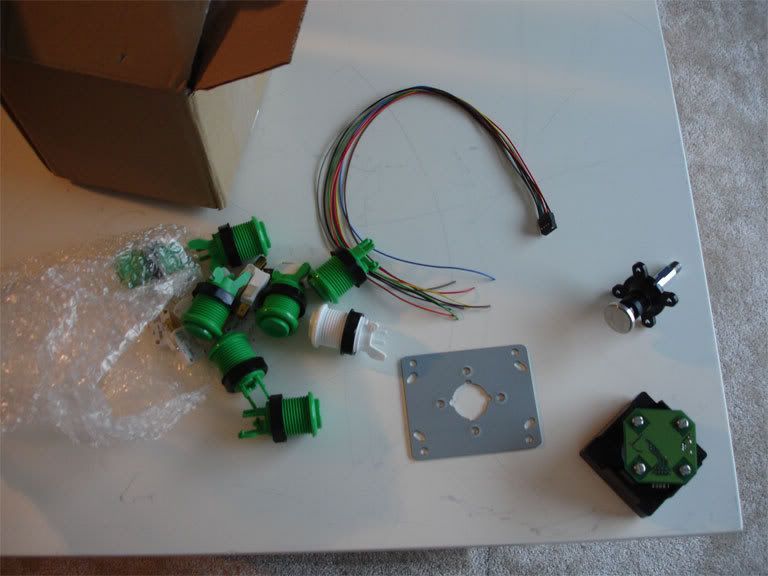

Alright so I got in my u360 and my buttons a few days ago from ultramarc.  Only problem I had was I ordered a balltop, but got the oval shaft u360 lol.  Andy was very quick to respond and is shipping me out the correct shaft to go with the unit.  He was very helpful in answering my questions as well.  Bartop kit was ordered tonight, so I should be hearing from Scott soon on that.  Here are some pictures:
On No it won't fit :)

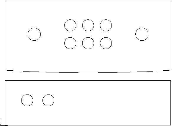

Nothing big to update, but I thought I'd share the design sketch that scott at mameroom sent yesterday for my bartop.  Gives a good idea of the layout:
« Last Edit: June 18, 2007, 06:47:33 pm by stephenp1983 »

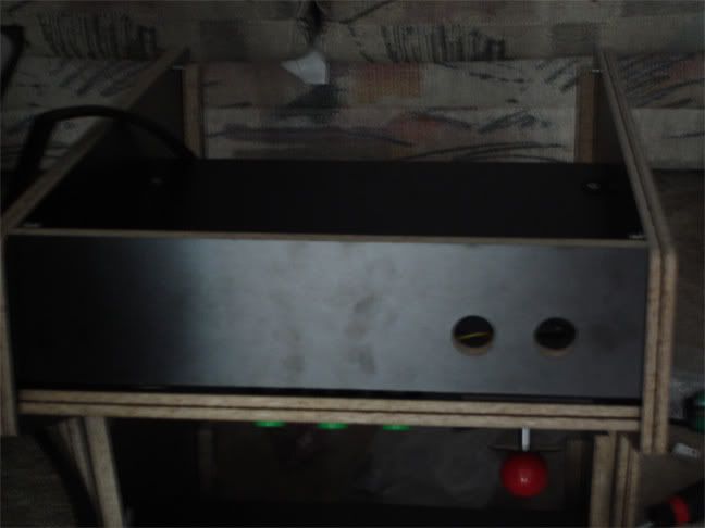

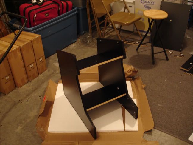

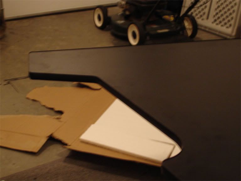

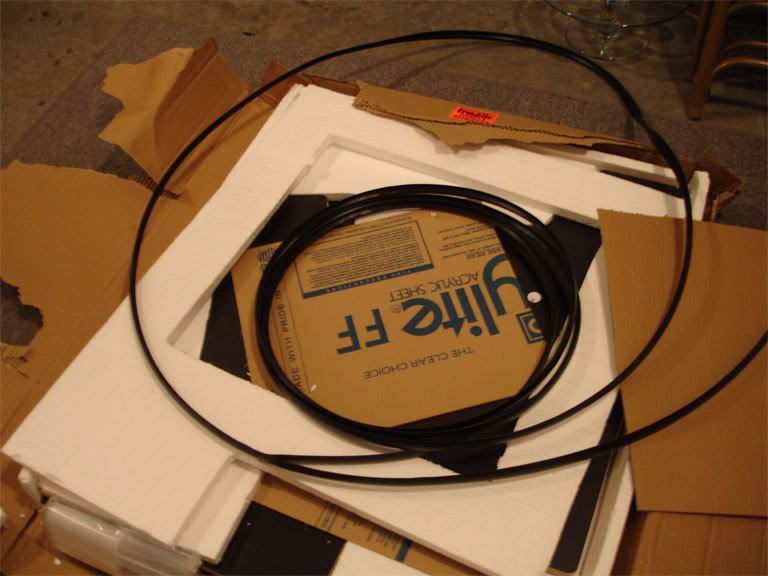

Alright here are some pictures so far from taking everything out of the box.  I'll start assemble on saturday or friday night, and begin the artwork now that I have the control panel measurements.

Is there a typical hole pattern they use?  Did it cost extra to customize your hole locations?
I can't wait to see your progress.  There are a few things I need to figure out before ordering my kit.  Mainly finding a monitor that works out with the bezel cutout size.  If you can post a pic of the bezel, I would much appreciate it.

He will customize the control panel for no extra charge.  As soon as I get the bezel out of the box I'll post a picture for you.  It should be sometime this saturday.

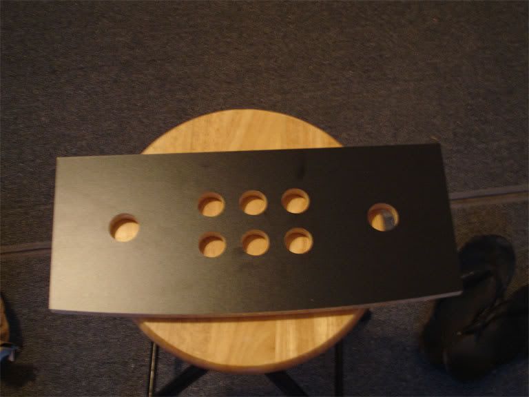

a few things I'm still trying to work out?

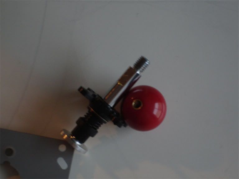

-mounting the joysticks.... All that was drilled out was 4 small holes to start a screw, I dont want to go through the other side so I need to find out what size to use.

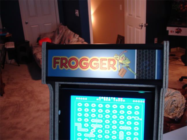

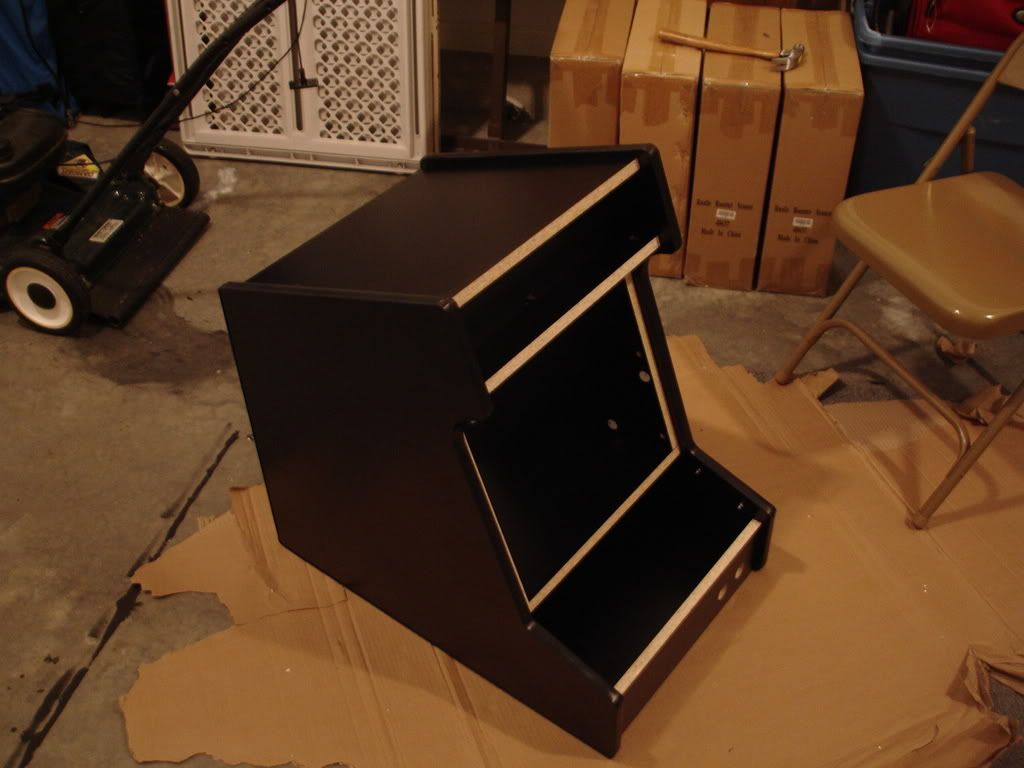

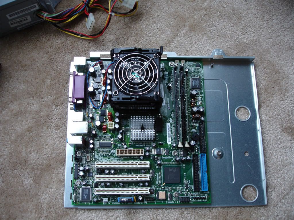

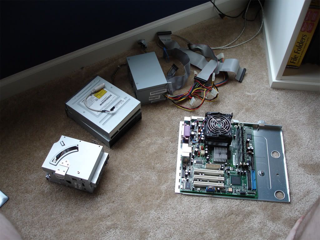

Alright, so I got alot done today despite being really busy with school work and diablo 2 ladder reset.
I was able to require a pretty good pc, an older p4 from my mother in law for fixing her new computer.  I think I'll take everyones advice and decase the thing and mount it on some mdf.
So here is where its at now, installing cams with your hand hurts like hell after awhile lol. Still holding off on the artwork as Ive been really busy with schoolwork.
« Last Edit: June 23, 2007, 08:07:55 pm by stephenp1983 »

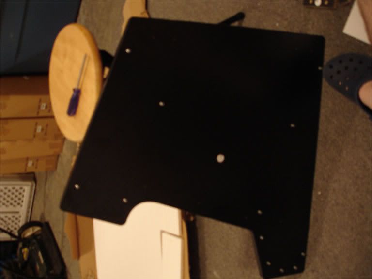

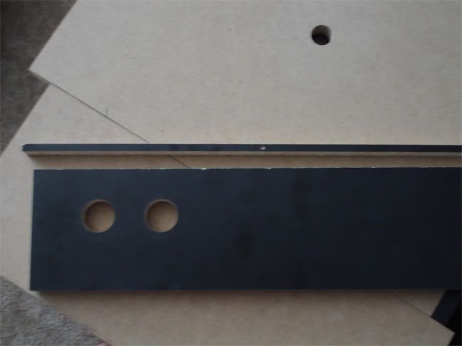

So I've run into my first problem.  The pieces that need to be attached to hold the bezel are about a millimeter too long.  They just won't go in where there suppose to.  I guess I'm going to have to get someone to trim a little off for me.

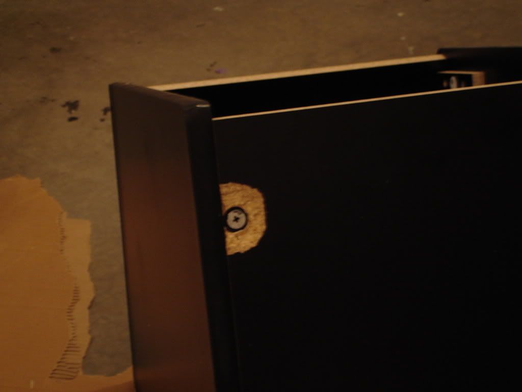

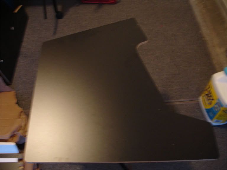

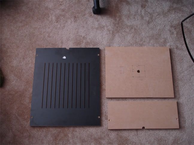

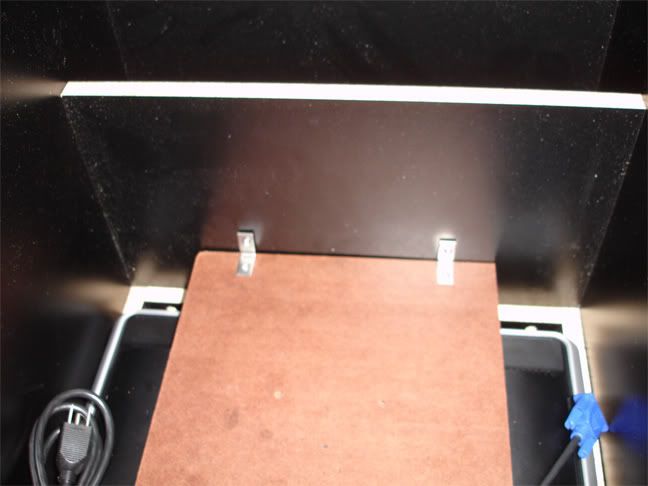

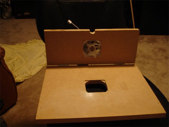

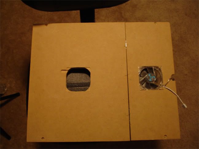

I'm a little pissed right now to be honest.  I've put everything together except the back and the control panel, and have run into some more problems.  First I had to wedge with all my might to get the bezel pieces in.  This lead to another problem when I put the bottom on.  The cabinet was way to tight, and I ended up having to take the tmolding off to even get it in there.  Well the directions say put tmolding on first, but dont take into account the tight fit.  I ended up busting one of the cam locks through the back.  Its still in there but a big piece is missing that I'll have to glue back on.
This leads to the  biggest design flaw of this kit imo, the back.  The rest of the cabinet is put together with cam locks which is great, however the back you screw on permantly.  This would be fine except it leaves not room for any pc maintaince.  Your suppose to screw the bezel on like this as well, so your left with no way to get in.  I'm probably not going to screw the bezel on and use it for an access point.
Oh yeah I went ahead and checked the back, and its too tight to fit in to, so I'll have to take the tmolding off a third time and try to wedge it in as well.
  • Posts: 7931
I wonder why it says t-mold first. Thats almost always last on my projects.

Im not sure either, I'm thinking about making my own back door with some sort of hendge on it for access.  Atleast the broken panel is on the bottom so you can't see it.

I like the first version of your CP artwork better.  One thing you might want to try for grins and giggles is to put frog images under the buttons so only the back legs stick out, up for the top row and down for the bottom row. Then you can put the button number between the legs.  ;D
For the busted out cam lock use some good quality wood glue and a clamp.  Make sure the cam is out of the hole or it may get glued in place.  If you have a power sander you might want to take a bit off the tight bottom and back panels before you try and squeeze them in place.

Thanks for the advice on the cam, I'll try that.  Thats an interesting idea on the buttons.  I did something similar when I had the trackball on there.  I'll do a mock up and see how it looks.

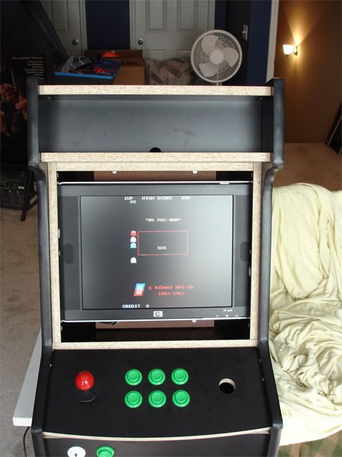

Here is where the progress is now.  I have pretty much everything together, minus the controller and the back.  I am waiting to finish to artwork and get it put on the controller before I add it on.
For the back I am thinking about cutting a new peice adding a hindge and cutting a whole for a pc fan.  This will allow me to work on the computer if I need to, and give a little more airflow.
I've also included a picture of where I accidently damaged the back, I'm going to try do glue it back later on.

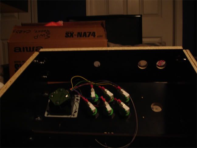

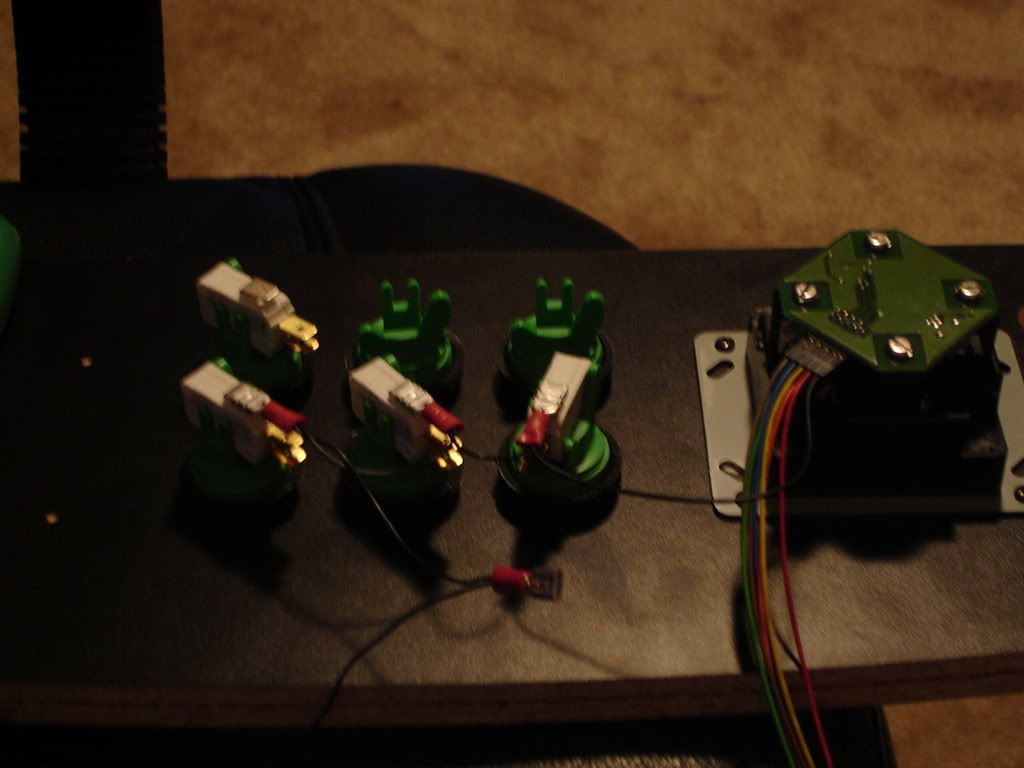

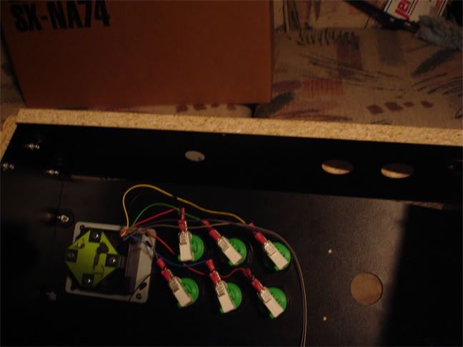

I decided to go ahead and start wiring the control panel, because I'm not sure when I'm going to have the art done.  Like I said before this is my first attempt at wiring, so I'm pretty excited but a little nervous as well.  I plugged in just the u360 the other night and it was awesome.  It was a total different feel than my happs 8  ways.  I was afraid I wouldn't like it, but I actually liked the feel.
stephenp1983
  • Posts: 691
  • Last login:March 24, 2024, 11:26:39 am
Re: Frogger Bartop for Dad (NEW PICTURES 7/02/2007 Wiring Started
« Reply #28 on: July 03, 2007, 12:46:57 pm »
Moment of truth coming up.... I have everything wired up minus the coin and player 1 buttons, so I figured I might as well see if this thing works.  Wish me luck

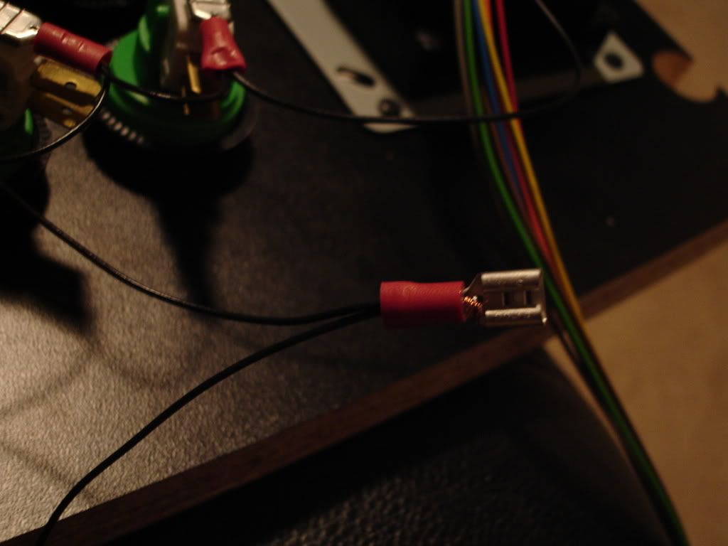

Looking at this pic I think that you are crimping the quick disconnects wrong.  You want to crimp them close to the blade not on the end.  The metal part of the blade where the wire makes contact dosen't reach all the way through the shield.  The one I am looking at is the one on the right at the top of this pic.  That crimp may have a good contact or it may not work 100% of the time.
TTFN

Success!!!  It may not be that pretty, but it works :)  I'm really excited about this, as wiring was the one thing I was really worried about doing myself.  Even though this is a 1 player with a wiring harness I feel I've come a long way from first having an xarcade, to second having timoe build and wire me a cp, to actually doing it myself.

I see what your saying, I am putting the wiring all the way through and not just putting it to where I'm crimping.  Is that what your refering to?  I have quite a bit of naked wiring running through the disconnect, I just crimped it on the end.  So are you saying I should crimp it further up and not on the end?
I appreciate your advice.
Thats correct.  You want to crimp the metal sleeve that goes around the bare wire.  This will keep the wire in place and give good contact for the signal to pass through.

Thanks I'll go back through and recrimp further up.

When crimping, position the crimp tool so that the part that pokes into the connector is in the middle of the barrel that surrounds the wire.  As previously mentioned, the insulation sleeve on that connector covers the barrel, and then some more over the wire.  Most likely the barrel is where the insulation is of the smaller diameter.  Center the crimp on that smaller diamater part and you should be fine.
Perhaps you already know this, but....
Before crimping, look at the barrel of the connector.  You should see that it's just a flat piece of metal that has been rolled to make a circle.  Thus, there is a seam.  You want the part of the crimp tool that 'pokes' into the barrel of the connector to poke into the side OPPOSITE the seam.  Looking at the pic that kaytrim quoted, the 'poke' should be on the back (which if that connector is crimped, then it is correct.)  IOW - don't crimp (poke) the seam into the wire.
Good luck,

I continue to run into problems with the kit and the way everything is lining up.  I am adding the control panel and front today, and there is just no way that they will fit on the kit the way its described.  I dont know if I the cuts are wrong or what, but I'm pretty pissed.  NO matter how you maneuver the peices that are not going to fit.  I plan on emailing scott to see what he says.

The only thing to do to fix this is to cut some of the bottom off of the coin/player 1 piece.  I'll have to let a guy at work do this as I dont have the tools to do so.  Its off by atleast a centimeter.

Here are some pictures of what I was refering to.  I emailed scott and he is going to try to remedy the situation by sending out a replacement part.  I must say he has had great customer service, I've just been a little bit frustrated with a couple of things on h is product.  Hopefully everything will work out:

Steve,
I just took a look at your early assembly pics and I see a possible reason for the problems.  Normally when I get one of these some assembly required furniture pieces you put one side on the floor.  then you attach all the horizontal pieces to the one side piece.  Finally you button it up by attaching the other side.
Now I am not there to look at the pieces nor have I built one of these cabs so I may be totally off base here.  I hope you can get all the little problems with assembly fixed and you are happy with the end result. :cheers:
TTFN

Thanks for the suggestion Kaytrim.  I think what your saying will work for most of the issues other than the last one I'm facing with the control panel.  The bottom and back pieces are just tight, but the front and control panel are just too big to fit on the pegs.  I sent the pictures to scott today to see what he says.  Thanks for the advice again.

With the help of a couple people at work I've been able to work through a few of the problems I've encountered.  For the piece that didn't fit one of my co workers cut off 1 centimeter off the piece and it fits without a problem now.
My other co worker started on the back replacement that I plant to use.  I will connect the two pieces with a piano hindge to allow for easier access.  I still haven't decided if I want to paint the mdf or use laminate to match the rest of the kit.

wiring is now complete, just waiting for my buddy at work to finish the back peice.  We decided it would be best to cut both the b ottom and top piece for fans.

Today I went ahead and decased the computer since I dont really have any work I can do on the bartop.  It went pretty well, although I had to get the drill out after I removed the mother board in order to get the metal piece that the risers sit on.  It was attached with some of the pieces that you can remove.  I finally got it off after about 15 minutes and got the motherboard put back on.
This hp has a speakers that came with it that dont attached to the sound card, but another similar piece that is attached directly to the motherboard.  This lets them work without having a seperate power supply which will help out on things.  You can see the attachment in on top of the dvd drive in the first picture:

Alright, its been awhile since I've posted, but I've been waiting for my buddy at work to get done with the modification to the back.  I think it turned out pretty nice.  He added fan's to the top and bottom, and made it so I could easily lift open the bottom section to do work.  Alot better than just putting everything in there and bolting it together :)
I started priming the back last night, and will try to finish up the painting by this weekend.

I spend the weekend painting the back piece which didn't turn out great, but hey its the back piece.  I also setup the computer and install mame etc on it.  Having a little problems with a gameex plugin to run the u360s but hopefully that will work out.  Next step is to attach the back and then fit the computer in.

Here some updated picture of everything running and the montior mounting.  For the monitor mount I got some hardboard at home depot and had them cut it to what size needed.  Then I just attached it to some L brackets and screwed everything to the cabinet.
Next step is to get the laptop mounted in the case, get all the wiring sorted, get the marquee light, and mount it.

« Reply #54 on: October 09, 2007, 12:00:58 pm »
Here are some pictures of the marquee once I got it installed.  All that I have left is the bezel and the sideart which I won't be doing right away.  The bezel didn't turn out to well when I spray painted the plexi, so I'm going to try something else out.
