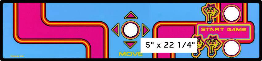

Today I started cleaning the CPO.  At first I tried using a paper towel and water, but this didn't work.
Next I tried using warm soapy water with a toothbrush, and this worked great!
This is a pic before cleaning.
This is after the first pass.  A small circle to the left of player two button.
Not the greatest pic, but it shows half cleaned.
WunderCade
  • Posts: 3041
Re: My Ms Pacman Project
« Reply #53 on: June 09, 2007, 12:30:16 pm »
Perhaps this has been asked already, but are you gonna stick with that cheesy Control Panel overlay or are you going to invest in an original?
