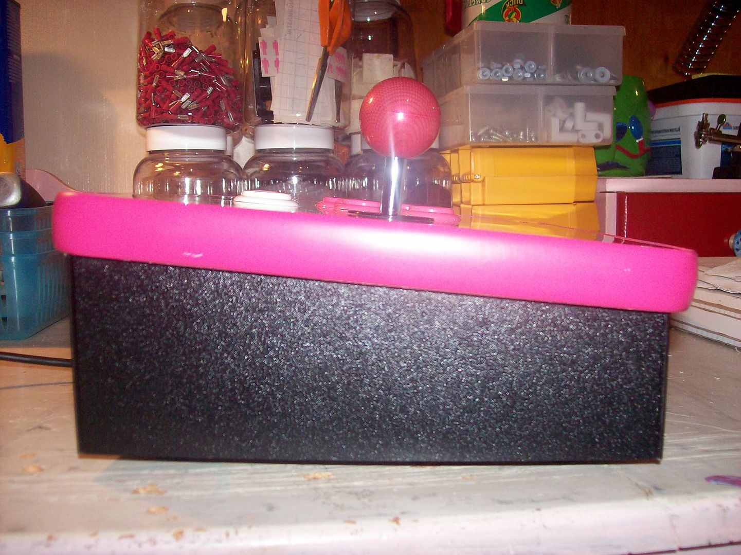

I've done both methods. I've done a chamfered plexi and I've done the 5/8ths with 1/8th plexi. The results were nice both ways.
as for the 5/8ths.... I had to buy a full sheet of plywood. lol. It turned out to be useful for building shelving inside the cabinet, creating the back, and creating supports for inside the cabinet. So, it wasn't a waste. The chamfer bit is also good to use around the trackball if you don't have a high-lip model. Here is a pic of the chamfer around the trackball:

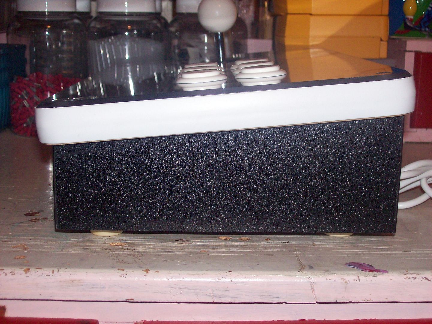

While the subject is up, any particular reason everyone chamfers outside the little black ring around the trackball? I just built a panel with 1/4" thick plexi, chamfered at a 45 degree angle right around the trackball. I've not hooked it to the encoder yet, but it sure seems to work well and feel good. Some may not like the 1/4" thick plexi, as it recesses the trackball quite a bit though.
Sorry about the quality of the picture, it's off my phone.
Edit: I was also considering putting my plexi above the t-molding and chamfering it down, until I realized that a lot of bad conversions just put the plexi on top. The chamfering would probably make it look a bit better, but still...
« Last Edit: January 31, 2007, 06:37:25 pm by Tahnok »

I like the bevel around your trackball, Lew. Looks nice. Tahnok, yours look nice too, but yeah, that's quite recessed. Isn't that a bit hard to play on?
It actually works really well for retro games, which is what it was designed for. It's easy to just use either your thumb or fingertips. Not to mention that the entire area around it glows like crazy due to the light leaking into the bezel. Golf and bowling games don't really work well with it though, since it's really the opposite of what you need for those (a high lip ball).
