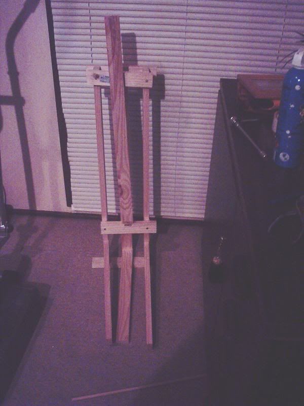

« Reply #46 on: October 10, 2005, 07:10:09 am »
I got a pic finally altho it looks crap i had to use the batterie from my remote and the cams dead again  ::)
But here it is :)
The design was tweaked when i was building i've got it all worked out now and it will look better than it does here.
I haven't got the mechanism done yet cause of rain but the rails at the bottom need to have the mechanism to be spaced properly.
Also the piece in the middle at the top folds out (hinged) so u can load the cans in without them dropping all the way down the rails and roll to the mechanism (the cans shouldn't be dropped)
I know it doesn't look too good right now but it was the test :p
http://i7.photobucket.com/albums/y279/aussie_ninja/vend.jpg
So what u guys think so far?

« Reply #47 on: October 10, 2005, 10:14:20 am »
Cool.  It's good to see you are progressing.  How tall do you plan on this being?  I am looking forward to seeing more.

« Reply #48 on: October 10, 2005, 08:50:38 pm »
Well right now its not really tall at all im at work so i can't measure for you but it holds quite afew cans :)
I was thinking of finding an old cabinet at a garage sale and strip it to make look like a vending machine and screw the rails etc inside the cabinet.
It works great right now i just gotta make the paddle for the cans to only comeout one at a time but the 15 degree angle is enough for the weight of the cans to push themselfs down even when its on the last can it will roll down which is good.
