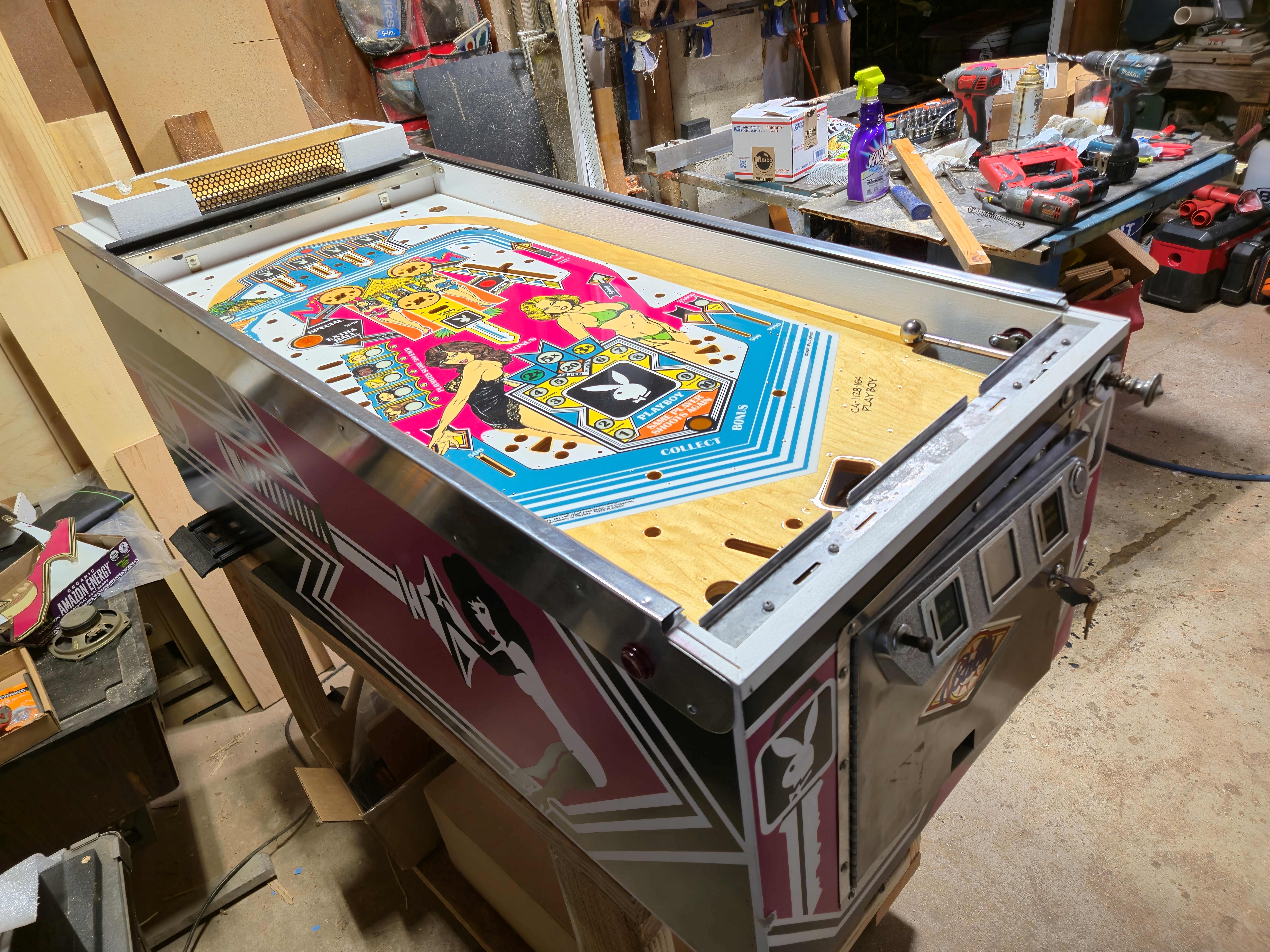

So this machine has a story already.
Chapter 1
Over a year ago this beast was listed on craigslist- so of course I had to go look.
A really odd haole (not from here white guy) who lived on the 4th floor of an old block apartment building in town (with his wife- who was a slightly younger than him Japanese woman who looked really pissed off about the whole situation) had this thing in the living room of what felt like a 400 sq ft studio.
It looked like a fun project but it needed a LOT.
Obvious termite damage (maybe still unmitigated even?!) a beat up playfield, broken plastics and rubbers, burned out bulbs, sound messed up, delaming backglass, etc.
The guy wanted far too much for it.
He also refused a polite (and generous!) offer given the thing's condition when I listed the $2k in stuff it would need to be the $3k machine he thought it was.
I left bummed because I knew he would just be destroying it to try to get more $$ out of it since he had NO clue wtf he was doing with anything apparently.

Chapter 2
I had written this thing off of course, until a few weeks ago when it popped up on facebook marketplace (which I grudingly check SPECIFICALLY for pins and arcade machines.)
HAD to be the same machine- except now it is on the OTHER (sparsely populated) side of the island.
The guy had only listed it that day and I was apparently the first person to send him a message- and actually had time to go look the next day- a Saturday.
Sure enough- same machine- except this guy (whose name is Guy! and he is a great guy actually) had bought a bunch of parts for it and cleaned the thing up quite a bit.  Way better than I had seen it.
So I asked him, "Where'd you get this?"  His reply?
I had to meet this really odd guy at a storage unit to see it- and he was a mess- really dirty, and stunk like he was homeless.  Said his wife had kicked him out and he was trying to get some $$ out of this thing.
Holy ---steaming pile of meadow muffin---.
He wanted what he had paid for it (less than the first clown wanted!) and was chalking what he spent on it up to getting to play it for a while, and knew it still needed more time and $$ and was ready to pass it on.
I gave him what he was asking for it and loaded it in the Element and brought it home!
Nikki loves it.  Laughs every time she sees it.
Today was "Look! They even gave the girl in the green suit some camel toe!"
Classic.

Chapter 3
So I get the thing home and already I know that even though Guy had treated the thing for termites and there weren't any still chewing away at it that thing has suffered.
The bottom of the cabinet where the bottom dado was cut in was tearing off, the backbox support pieces were like paper mache' in spots, and there was enough termite crap that had spilled back into the coffin in transit that I knew the wood in a bunch of places was in pretty bad shape.
Well, ---steaming pile of meadow muffin---, it's only a box, right?  Has to be easier than a video game cabinet, no?
Sure, the magenta color is completely burned out of the cabinet art, but at least I have an original to work from.
Turns out, there are a number of interesting details to a pinball machine cabinet, epecially if you are going to re-engineer it slightly so that you don't have to buy a few really expensive router bits (and maybe you are a little impatient too.)
A little glue and head scratching later and...
But of course if I am going through all of THIS trouble then I can't just leave that nasty playfield (which it turns out has had a bunch of termite damage also) in a NEW cabinet, can I?!
And, the slippery slope steepens.

I finally (after 4 tries at the saw table last night) succeeded in milling out a new bottom channel piece for the backbox which carries the glass.  That seems to be the only part of the backbox that termites destroyed.
Man was that a pain in the ass to get right.
I also got another coat of white enamel on everything, which was easy on the new coffin but getting the layer of nicotine and latex crap that someone rolled onto the backbox off sucked.
I need to go roll out those stencils so they'll be easy to work with since hopefully this coming week I can be spraying that thing.
Maybe one more layer of white rolled and sanded out and then a last coat of white sprayed for flatness and should be ready for color stenciling.

Still working at getting the paint finished on this monster.
Today's unexpected excitement was working on the playfiled rails.
When I rolled the thing over to pull the screws out I discovered that... there were no screws.
Somebody had glued these things on at some point- which I suppose makes sense, given that they were probably as violated by termites as various other parts of this box.
And I thought I was finished with all the wordwooking for this project.
So I got the reproduce those silly rail pieces too.
Joy.
At least they came out ok and were an excuse to actually get to see this magenta colored paint in all its glory.
Holy ---steaming pile of meadow muffin--- is it loud.
I also had gotten around to getting both of the rotisserie things built so I could get these playfields in a spot to start swapping stuff over.
I had forgotten that I really should seal the bottom of the new one with something so it got a really light coat of spar varnish.
Was afraid to roll it on and have gobs dripping though to the topside and destroying something so it got a really light brush treatment.
At least now MAYBE I can start pulling stuff apart now?
It occurred to me also that I'll need to clean these parts up (vinegar bath and rinse?) before I can put them on the new playfield.
Man this is going to take a while.

With all the stuff that I thought was cool with video machine crap that I built THIS stupid thread gets more views than all my other trash.
Go bots.
And holy crap, did I wind up with a post that doesn't involve dumb aspect ratio twisting?!
Anyway, I have suffered enough that I have a fwe days off of work and it hasn't rained much again recently either so I'm not suffering too much grass torture.
Love getting time to get projects out of my way.  NEVER thought that this thing would be running into such a saga of time between work stints.
I had some issue with glue coming off the mask of my stencils but after working through practically every solvent I had in the shop I arrived at naptha or mineral spirits being good to get the glue off and not solubilize my lovely stencil work.
I also bought a fresh loop of ground braid and decided that if I was going this deep I might as well replace all the screws too and make the rest of it prettier than it was when I got it.
The only part that really freaked me out about getting all this stuff back into the coffin was making sure that the plunger was going to line up with the shooter lane properly.
I did need to bore out the diamond shaped hole the plunger mounts through to get it good but I think it will be fine once I get the playfield stuff all swapped over.
I took the time to clean up the harness and I only really need to repin the connectors and reseat a few wires that someone had bypassed previously (why I still haven't sorted out actually.)
Once I had all of that back together and succeeded in getting the coind door seated and swinging nicely I figured it was time to drop the backbox on it and see if those holes lined up too.
Seems to be coming together finally.
With all the crap I have ordered for this thing already you would think I could've remembered to get some cabinet protectors and new leg bolts.
Lord knows I'm missing other stuff that I will only remember the day after I order some more bits and get porked for some more Djibouti level shipping costs.
Ah... if pinball machines could sink then they would have the same all encompassing neuroses inducing vibe as boats.

Any original parts going to be left in this thing?   :lol
Beautiful work.  There is an actually fun game on the other side of this, I promise.

So many parts had already been swapped out by the time I got this thing that at least reconstructing the bug eaten carcass seemed appropriate, but other than that I'm only replacing the lamp driver board with a new Alltek so that I can run warm white LEDs in it.
When I saw I could also get a new playfield to replace this slightly chewed but worn and yellowed one then it was game on.
The guys at CPR up in the GWN were great to deal with and the playfield really is a thing of beauty.
Of course at the rate things are going there may be no original wood left by the time I'm done though.
