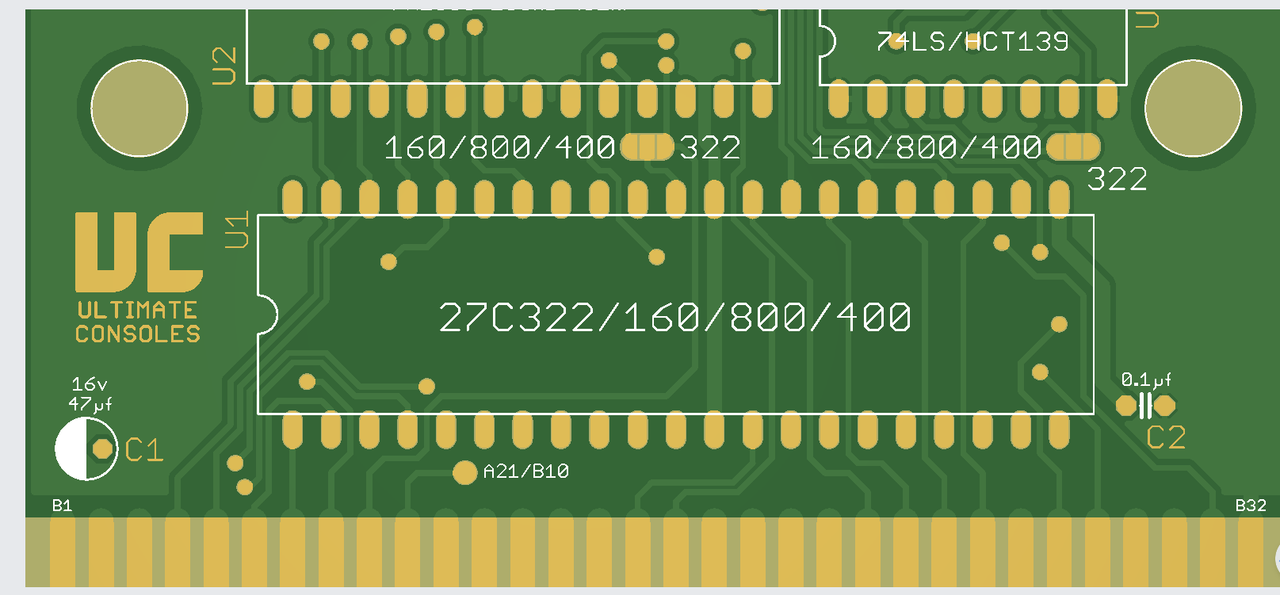

I shouldn't probably comment on how many hours this took me to figure out, but here we are.
Basically, to my understanding, SEGA used these ROMs:
M27C400 - 512KB
M27C800 - 1 megabyte
M27C160 - 2 megabytes
M27C322 - 4 megabytes
M27C400 is only 40 pins, so it is shifted one slot over on the PCB.  That means pin 1 on the chip is plugged into pin 2 on the PCB.  It does not have A18 or A19.
M27C800, M27C160, and M27C322 are 42 pins.
M27C800 does not have A19.  The pin is physically there and I think it's tied into 5V.  You have to cut this 5V connection and connect the pin to B8 if you want to use a bigger chip.
M27C160 has A19 and it's connected to B8 on the cartridge connector instead of the 5V line.  I think this is the most common PCB/ROM arrangement.
M27C322 has A20, it's on pin 32.  This needs to be tied into B9 on the cartridge connector.  If the board didn't originally have this ROM on it, this pin is connected to 5V and this needs to be cut.
So, unlike other consoles, Genesis ROMs don't care which chip they're burned to.  You just have to alter the PCB so that the console knows how to address the chip.
I have been very frustrated with the documentation I've found on line about all this.  Blurry photos and fuzzy memories.  So, I hope this is a little more clear.  At least it'll be good notes to myself some day, maybe.
If you make the connections as shown in the photo, you can make any board work with any ROM.  The only exception are the games bigger than 2MB with saves.  It has to be split across 2 2MB chips without significant reworking of the PCB and additional components.  2MB of the ROM on the chip on the bottom of the board, the rest on the top.  There's only a handful of these games and World Series Baseball 95 and 96 make excellent sacrificial lambs to become Beyond Oasis and Phantasy Star 4.  I'll post more information about these after I make one.

I considered a pi and a Kade and chose otherwise.  We are into retro gaming because it is expensive and inconvenient.
Anyway, here we go…
Here’s front and back of my new 4MB tester cart.  I used canola oil this time to keep it kosher/halal.  This is not haram.
You can see an EA cart in the foreground but that’s a rant for another day.
My package from China arrived today, the 4MB chips are in beautiful shape.
Cook cook cook cook…
And holy freaking sonic, it works!

So, enter this reproduction board:
https://www.tindie.com/products/ryanbatesrbg/repro-pcb-for-sega-genesis-mega-drive-eproms/
I emailed the creator and he had a few in stock.  I ordered them all. I will be placing an embarrassingly larger order soon.
He did a very, very nice job on these PCBs.  You can use surface mount or through hole parts.  The chips drop right in.  He put the 2MB / 4MB jumper on the back of the board so you can still change it when you make a mistake and have already soldered the EPROM on.  (there's another prominent seller that puts the jumper under the EPROM which is the dumbest design I've seen in ages.  It's a breathtakingly stupid setup)  The connector edge is beveled, the corners are rounded.  Every complaint people have about other repros has been addressed with these.
Here's Metal Dragon, a 4MB eprom, using actually correct parts values for the capacitors (47uF 16V for the electrolytic and 0.1uf for the other one).
And here's Mutant League Hockey, a 2MB chip, and "eh, kind of close enough" parts.  2x10uF caps or something like that and I can't even remember what the ceramic capacitor is.
And the PCBs drop in beautifully in both EA and Sega cases:
And here's where I confess I've made a rather expensive and large purchase of games.  So... whenever any of you is ready for some Genesis games, please get in touch.

Anyway, lots of progress this weekend.  Got my reproduction circuit boards in, actual flux, new components, couple of jugs of lighter fluid, new desoldering tips, and away we go.
By the 10th board, I had gotten reasonably decent at these SMD capacitors.  Tiny drop of flux, hold it in place with my left fingernail, touch it with the soldering iron that had a small drop of solder on it. Once one side was done, the other was easy.
The other capacitors are SMD 47uf 16V, but you can pop off the bottom and you have tiny little legs.  Those legs line up perfectly with the holes on these repro boards.  My only gripe on these repros is the guy didn't give the legs enough exposed copper on the back to have solder bite them into place easily, but he's going to make a revision one of these days.  It's still doable but you need to double check the joint.

One recent revelation has been that if a 2MB chip fails when it's around 1MB burnt... that means a 256Kb or 512Kb ROM will burn and play fine.  The chip will fail verification but the Genesis don't care.
So that's how Nephasth has MUSHA.  I will be testing this theory further on a chip failing around 400Kb with a copy of Rambo 3 (256Kb).  Rambo 3 is oddly a very good game that nobody owned except me back in the day.  Sells kinda high on the resale market from what I've seen.  My dusty brain recalls some invincibility trick I will have to refresh myself on, but it was still fun to play through.
I also had a 4MB chip with legs that crumbled into dust when I was messing with it.  I was able to scrape back the sides of the chip and get a metal nub exposed and solder some kynar wire to it.  It miraculously works, so now I've got a copy of Mortal Kombat 2 Unlimited with Kintaro Action Grip.

So, I sorted my rather large box of old pcbs into SEGA and everything else.  I’m actually very low on non-saving Genesis games, but I do have a few of these cartridges that split roms in half onto smaller chips to save money manufacturing.
That one on the right was formerly Joe Montana Sports Talk Football, a 1MB game split onto two 512kB chips,
I thought I would get away with just removing the bottom chip and putting Last Battle (512kB chip) on there.
Thus far I cannot get it to boot.
I subsequently pried off the mapper chip and the top rom.  They came off completely clean and left clear holes.  I’m starting to wonder about all that time I spent hunched over smoldering hog lard.
Anyway, no change.  I suspect one of the ROM lines is routed weird… like chip enable or something.  Two hours (and counting!)  spent on this in order to save $2 on a repro board.  No regrets.  I’ll chunk it in my “remove this eprom some day” pile.
But I did get Mystic Defender and Twinkle Tale going.  The price of a legit Twinkle Tale will curl your toes ($400ish).  I actually owned Mystic Defender back in the day.  The only person that did.  Level 4 is ---fracking--- impossible.  It’s so hard the attract mode is literally showing you how to beat it.  Still impossible.  I cannot crack this game even with Game Genie codes as they don’t work on the lava in level 4.  I spent a long time in code generator generator mode in the Fusion emulator and couldn’t come up with anything that worked.  Fun graphics glitches, tho!
Anyway, more to come….
« Last Edit: February 01, 2023, 01:28:22 am by pbj »

Paradoxically, the problem was the opposite of "unable to flush the system."  Anyway, I have some terrifying pictures I'll be happy to send you.  There will be blood.
 :lol
That experience with that SEGA PCB prompted me to check the box of sports games PCBs I've been holding onto for reasons unknown to me.  I found some interesting things out.
EA PCBs assembled in Puerto Rico in 1993 - ROM pops right off.  Any other PCB?  ROM or PCB cracks in half before the solder will give.  I spent 3 hours trying to desolder a chip and clean the holes on an EA PCB once.  Oh well, live and learn.  Seems to be total ---steaming pile of meadow muffin--- like FIFA soccer and international tennis.  Any other era the chips may as well be welded on.  On the pic below you may notice a damaged trace.... there is literally a damn factory jumper wire going off the ROM leg to enable 2MB mode.  I had a few with a slight variation that didn't need this jumper wire.  This was clearly done by hand and the ROMs are crooked because the chip sits on top of the wire.  You can also see the bottom left leg on chip U3 has been physically bent out and soldered to that capacitor.  Fun times.  What the hell was EA doing in Puerto Rico.... I'm sure it was a tax scheme.
Anyway, NFL Quarterback Club by Acclaim?  Even easier to pop off.
Tengen boards pop off pretty easily but the solder pads are delicate and I've had to scrap off some solder mask, fold the eprom leg over, solder to the trace, etc.  No big deal.
Here's a couple of examples.
  • Posts: 11116
  • Last login:October 03, 2026, 11:32:04 am
Re: Making SEGA Genesis cartridges
« Reply #151 on: February 01, 2023, 07:15:11 pm »
So the issue with that board was indeed the vE pin.  And then the 2MB connection was pulled high to 5V.  I depopulated another one of these boards to follow the traces so I wouldn’t have jumpers on the edge connector.
And now I have two copies of Last Battle….

In other news, I was quietly given some PCB plans for a reproduction board that will supposedly allow a 4MB rom to save to FeRAM.  It uses a 74LS74A flip flop and a 74LS139 2x4 decoder.  I'm pretending I know what those words mean.  I went through many, many PCBs and only found those chips on EA College Football and EA NHLPA93, which are both fairly early EA sports games.  So I went ahead and ordered some more from China.  74LS138N and 74HC00N were on tons of Sega / EA / Akklaim boards but I'm too dumb to look at the datasheets and figure out if they're compatible.  I'll make one cartridge with sockets and see what works, I suppose.  The weird FeRAM chip that literally only Sonic 3 used has also been ordered in bulk.
So, anyway, in theory this should enable me to play the 4MB homebrew that saves such as Cave Story, Sonic Hellfire Saga, Life on Mars, etc.  Those all work fine on $18-25 flashcards but reason left this conversation many, many months ago.
PCB Way is going to send me a run of 10 boards and we will see what happens in a few weeks.
74LS74A flip flop - A flip-flop is a circuit that comes with two stable states and is usually used to store binary data.  It works a bit like a push-on/push-off power switch where you can set/reset the current state to on or off as needed.
74LS139 2x4 decoder - When the Enable pin is at logic low, the chip uses 2 inputs (A and B) to select which one of four outputs to set to logic low.  (Y0-Y3) The chip contains two of these 2x4 decoders.
74LS138N 3x8 decoder - When the Enable pin is at logic low, the chip uses 3 inputs (A, B, and C) to select which one of the eight outputs to set to logic low.  (Y0-Y7)
74HC00N Quadruple 2-Input NAND Gates - This chip has four negated logic AND gates. If both inputs to the AND gate are logic high, the output is logic low.  If either or both input are logic low, the output is logic high.
None of these four chips have the same function or pinout.

So, I got my PCBs and components in and made a tester board.
Learn from me - don't use machine pin sockets for 30 year old recycled EPROMs.  I've subsequently ordered a ZIF socket I'm going to stack on top of it.
You can also see my high tech "edge beveling machine" in the background which consists of dragging the edge of the cartridge at an angle on sandpaper.  This is to make insertion easier and less likely to damage your console.
Anyway, I've got Cave Story booting and playing on a dedicated cart for the first time ever.  It's not saving, nor is it displaying the save game icon (hovering floppy disk), which I find very odd.  I guess there's some mechanism by which it detects your ability to save.  Buried deep on the Cage Story megadrive port website, he mentions that it uses 8kB saves but that he's modded the header to say 32kB to increase compatibility with flash carts.  Well, I had, of course, ordered 8kB FeRAM 1608 chips like what I thought was used on Sonic 3.  Modifying the header back to say 8kB saves didn't change anything.  So I busted out another $20 and ordered a stack of 1808 chips.   We shall see.
This PCB was designed on a French forum and they have the Megadrive section walled off.  I've registered and begged for access but so far no dice.  I'm hopeful that with an 1808 FeRAM chip that this board suddenly becomes compatible with SGDK designed games.  What is of slight interest is that the board supports a 4MB rom and saving games.  SEGA never accomplished this in the 90s.

Turns out I have to make "10 quality posts" before I can get into that section.

I've been badgering the Red Miso team for months and finally got one of their programmers to indulge me.  We went through..... many.... ROM revisions, but now we've got Sonic Hellfire Saga booting and saving on original hardware.  Every EPROM I own is currently being rotated through my Easy UV Bake oven this evening.
Sadly it's not saving on my French Ultimate Console boards, but it works perfectly on my arch nemesis the World Series Baseball 96 PCBs.
So if you want to find out how much I love you, ask me to make you one.
 :lol
They should be releasing the new version soon.  There's some bug fixes bundled into it, too.

So, I just spent a… lot… on World Series boards and it turned out the issue with my Ultimate Console PCBs was a lack of a reset line to the 74LS74 chip.
Still working with the Hellfire people to get it saving on these French boards but now I’ve got Sonic Complete and Cave Story saving correctly.

So, I messaged the guy that designed the PCBs and he says he has a personal copy that’s correct and what’s posted wasn’t the latest revision.  I found it simultaneously funny and sad that nobody has noticed this mistake in 7 years.  Really drives home what a tiny niche I’m living in.
Anyway, he claims tying pin 1 of the 74LS74 to Vcc will also make it work, but that some games may require it be tied in to the VRES line found on B27 of the cartridge.  I’ve already damaged my cartridge slot with jumper wires on the edge connectors (one of my female pins is now a folded over scrap of capacitor leg), so I am really trying to avoid doing that more.  So I may revise the Gerber files to either add this line to the chip, or at least a decent solder pad for a jumper wire safely removed from the male edge connector.
That being said, there’s a million places to tap into Vcc, including pin 14 of the same 74LS74.  I’ve done that and tested Cave Story, a new Hellfire Saga revision, and Sonic Complete.  All three saving correctly.  The poor Hellfire saga programmer is learning that the true hellfire was all the UV light I erased those EPROMs over and over in again along the way.  They should be releasing what I like to call the “shut pbj the ---fudgesicle--- up” revision publicly soon.
What this means is that the… let’s call it… sure… $50.. yeah… just $50 I blew on more copies of World Series Baseball 95 and 96 this weekend wasn’t needed.  And I also don’t have to desolder 84 pins unless I really want to.
But it also means I can make these from entirely new boards and components and no longer have to kill old games.
So here’s your first look at an entirely new (okay the eprom is 25 years old) Hellfire Saga.  This has been fun and I’ve come a long, long way…

I’m probably in two grand but I’ve been at this about 18 months.  EPROM prices have gone insane but I don’t think I’m quite ready for surface mount rom chips.  Give it six months and I’ll revisit that.
But cracking the issue with this Ultimate Console PCB has opened up a whole new world of modern homebrew games.  Hellfire Saga is actually quite good now that I’m allowing myself to play it beyond save testing.

One of the new boards populated.  These things take me almost an hour to assemble and test.
 :angry:
And here’s the “final product.”  Nearly $20 each in materials cost.   :embarassed:

I have a ton of 32pin m27c400 chips is there anyway to use them instead of 40pin m27c400?
  • Posts: 11116
« Reply #193 on: May 29, 2023, 06:47:01 pm »
Probably.  Do you have a datasheet?

« Reply #196 on: May 30, 2023, 09:06:25 am »
I think I found it.  It looks like it would work but you'd have to make some kind of adapter to reroute the pins.  The 27C160s are about 75-80 cents each in bulk, so I'll let you make that determination as to "is it worth it."
 :lol
 :lol
Thanks for the help, Yeah I believe it to be easier to just get the right ones. Do you have a suggestion on where to buy or is ebay the best option?

Well, how many is a "ton?"  It might be fun to program a chip and run a bunch of jumper wires.... once.
I get my EPROMs off AliExpress.  Last order was ~$35 shipped for 50 x 2MB (27C160) that I received last week.  It's been a total crap shoot with the quality.  Latest batch was actually shipped in antistatic sleeves of 5 chips and they're very clean.  I've burned 2 and they're fine so far.  I've had other batches where they've been thrown haphazardly into a bubble mailer.  Others have been stacks of ten neatly shrink wrapped.  The poorly shipped batch was actually mostly fine once I patiently straightened the legs.  One of the nice looking batches was about 30% useless.  Just embrace that all of this is a waste of money.  Don't bother with buying smaller than 2MB EPROMs because it's just a matter of pulling 2 pins high if you're using a 40 pin PCB and they're all the same price.
 :lol
Could you highlight the areas you had to cut on the back? Or let me know if the circled areas I have are correct. Im trying this with madden 93 and just want to make sure im cutting the correct places?

Your circles look correct.  I really, really suggest you try desoldering the Madden ROM before you spend too much time on that PCB.  It was taking me literally hours to pull parts off of them versus entirely stripping a SEGA PCB within 5 minutes.  If you come up with a quicker method for the EA boards, I would love to hear it.

Are you using M27C400 or M274002?  4002 has the wrong pin out.
Okay, assuming that you're using M27C400 and your PCB is the same as pictured here:
(found on this page:  https://www.pricecharting.com/game/sega-genesis/rbi-baseball-93 )
Pin 1 on the ROM is running to B7.  Pin 42 is being pulled high to 5V.  Your simplest fix is going to be cutting the trace on the back of the board for pin 42, and running a jumper wire from pin 42 to B8 on the edge connector.  That will tell the Genesis it's a 2MB EPROM.
Im using m27c160 on this one. I should have mentioned this is different from the other one I was working on. But that would make sense why the other board is not working being 4002 is different pinout.
Well this one is going to be a no go. I was redoing my connection from pin 42 to b8 and the pad lifted up. Oh well. Thanks anyway.

Put a jumper wire on pin 42 and try it pulled to ground and see if it boots.  If it doesn't, tie it back to 5V.  If that doesn't work, tie pins 1 and 42 together, and then try 5V and then ground.  One of those combinations will make it work.
If you have 42 pin holes on the PCB, there's no need to lift legs, but you may have to cut traces to properly isolate the pins before you add the jumper wires.
Here's a Forgotten Worlds (512Kb ROM) on a 40 pin PCB burned to a 2MB 42 pin EPROM.  I've lifted legs 1 and 42, jumped them together, and jumped to the 5V on the back of the PCB.

Pin 42 to ground worked. Thanks alot.

Where are you picking up 5v from? That might be what I need to fix that other pcb. The 40 pin one I have.

Yellow is a hypothetical jumper from pin 42 to 5V.  Blue is a jumper to ground.  Some games/chips work with one, some with the other.  Try both.

So pin 1 and 42 to 5v no go, but both to ground and I get the sega screen followed by a red screen. So some progress. This is the 40 pin nhl 93 pcb with the trace cuts and jumpers. Also just to note I have a socket installed and the legs are down but not touching pcb. I have tmnt hsh 1 mb image on 2mb eeprom.

Got my m27c322 roms today and programmed Mortal Kombat arcade edition and it works until the end of round one and freezes. Donor Cart was nfl qb club 96 which is a 4mb cart and my rom is 4mb any ideas?

Yep, remove those chips above your eprom and then add jumper wires that will reconnect your chip legs to the appropriate pin on the edge connector.  Look for traces that come off your eprom and go up to the chips and don’t have a direct connection going down.  Looks like maybe pin 9 off the eprom?

Is it because those are sram?
  • Posts: 11116
« Reply #242 on: July 07, 2023, 10:17:01 pm »
You put a non saving game on a saving PCB.  That means when the game is trying to load a certain part of the rom, it’s accessing those save game chips instead.  You need to remove or disable the chips and make a direct connection from the eprom to the edge connector.

Well I had read that the hack had a built-in feature to use SRAM to save the high scores but apparently it's not compatible.
From what I can tell by removing those two chips it doesn't interrupt the path from the eprom to the edge connector. Or I may be misunderstanding.

Removing the two chips worked, did not have to add jumpers. Thanks

I had some more pcbs printed up.  If you want one, chime in soon.  I think I have 30ish 2MB EPROMs laying around and this project is done
Have you tried to use the surface mount flash chips on these boards? Also have you ever tried doing a 6mb cart?

Mourix recently did some revisions on the open source Genesis FeRAM cartridge that can be found here:
https://github.com/soniccd123/Genesis-FeRAM-Cart
Which I think I have forked here:
https://github.com/pinballjim/Genesis-FeRAM-Cart
(the file is also attached)
Tested and fits in vintage Sega Genesis, 32X, and Electronic Arts shells.
Dumping the readme here as a backup:
This PCB layout has been modified to be universally compatible with Sega Genesis, 32X, and Electronic Arts cartridge shells. The file Cart_FeRAM_Holes.zip has been confirmed working with an order from PCBWay and with original shells.
All credit goes to Mourix for alteration of the existing PCB design. I simply measured holes and begged.
Original project can be found here:
Unedited readme from original project is below.
Genesis FeRAM Cart
A open Sega Genesis cartridge PCB with save feature
This projects uses a 27C322 4MB EPROM Chip and a FM1808 32KB FeRAM as save storage. It was developed in KiCAD and tested in real hardware.
In the actual state, this cartridge features:
Suports Genesis and 32X software
ROM Support for up to 4MB
Save support for all ROM sizes (Selection for <2MB/4MB by jumper)
32KB of FeRAM for saving
No need for battery for saving
Rudimentary ROM bank switch (Permits multiple games on same ROM)
This project is possible thanks to TmEE (NESdev Forums, SRAM wiring schematics) and Rene Richard (db-electronics on GitHUB, KiCAD libs for the Genesis cart connector).
Component List:
U1 74HC74;
U2 FM1808B;
U3 74HC139 (or LS);
U4 27C322 (May use other 27CXX memories with some minor modifications);
R1, R2, R3, R4 1K Resistors;
SW1 4 channel DIP Switch;
C1, C2, C3 10nF Capacitors;
How to use:
Bank Switching: The user may write multiple roms to the same EPROM, the DIP switch controls which area of the EPROM is read by the Genesis/Mega Drive; The minimum bank size is 256KB. Each of the switches connect a memory address line between the system and the EPROM: when the switch is on, the respective address line is controlled by the Sega Genesis; When off, the EPROM adress line is pulled-up and cut from Genesis control. the address lines are A20, A19, A18, A17 (considering LSB as A0). To select the desired bank, turn the switches on and off acordingly to the begining address that the ROM occupies in the EPROM.
Examples:
ROM_x begin at 0x100000 -> Switch just A19 off (pull-up);
ROM_y begin at 0x180000 -> Switch A19 and A18 off;
This technique may not be compatible with save supporting Genesis software.
How to make multirom file: Just use the CMD command "copy /b rom_x.bin + rom_y.bin + rom_z.bin rom_result.bin" to join them to one file. One may join how many ROMs he wants to, just be shure that the result file is smaller than the total size of the EPROM and that the ROMs fit correctly to each desired bank to make software switching possible.
JP1 jumper: This jumper is the result of some tests with varied sized Save RAM suporting software. This jumper is necessary for software bigger or smaller than 2MB to correctly save and detect the FeRAM. For software bigger than 2M, one must connect (with solder blob, 0K resistor, etc) the >2MB part of the jumper; for smaller or equal to 2MB software, one must do the same with the <2MB part of the jumper.
Other than that, just write to your EPROM and happy playing!

Hello, I actually used that board some months ago and checked the soldering several times, but I couldn’t get it to save the game. Did you manage to?

Nope.  Neither the Mourix version or the original design worked for me.  There’s a 32X cartridge shell 3D printer design that works with Genesis PCB screw layouts, so that’s how I’ll make 32X savers in the future.
I tried my hand at making NES bootlegs for Jaws Enhanced and that’s an absolute nightmare in comparison.  I’d post more about these projects here but despite that $30,000 investment this forum software is 30 years out of date and actively fights you.
I think that the original PCB has a design problem and no save function is available. In fact, soniccd123 doesn't answer questions about it.

Neither even boot up for me, much less save.  Oh well.   :)
The linked file will print a 32X shell that holds a Genesis PCB.  The 32X holes are wider spread normally.
