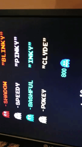

I turned on my cocktail cab for the first time in several months, and when it loaded into a game there were graphics errors on the side of the screen:
When I exited to the Windows XP desktop there were some color errors near the bottom of the screen, and eventually Windows crashed with BSOD (first time ever on this machine).
Shut down, took the card out, reseated, etc. Still happened. I connected a regular LCD monitor to the DVI port of the ArcadeVGA and got the same results:
Card is from early 2011 and this cabinet has seen very little use in its lifetime. Rarely ever used more than an hour at a time.
LOL! Had a huge reply to this and the forum logged me out... oh well.
Anyways, it kind of looks like interference from an appliance or electric motor running. Did you move the game to another room/outlet/circuit?
Try:
- Plugging into another outlet from another circuit (ran off different breaker), by relocating/using an extension cord.
- Plugging in another working PC to see if anomaly appears on it, too.
- Turn off any large appliances (especially recently bought units), or watch when AC/Electric Furnace cycles On/Off to see if it goes away.
- Think if the wife/family member might have been using a mixer/blender/hair dryer on the same circuit when you noticed this problem.
It looks like interference to me, from possibly an electric motor running.
These are just ideas... might be just grasping at straws though.
Good luck.

It's definitely the card. I pulled the card and used the onboard GPU, there were no problems. Then put the ArcadeVGA in another PC, and it had the same screen glitches as before.
Is there any correcting this? Could it be a corrupted BIOS, and if so, is the ArcadeVGA BIOS available for flashing with ATIFlash? Or is it definitely hardware? I'm not against GroovyMAME and CRT Emudriver, but since I have the ArcadeVGA and a cabinet with MAME all setup to use it I would like to just keep using it for this cabinet if at all possible.
The ArcadeVGA is an RV630 512MB card.

The AVGA BIOS is definitely proprietary. That said, contact Andy at Ultimarc and see if he can help on that front.
TBH it sounds more like a vRAM error or something though, and the card is dying.

Yeah guess I'll stick a fork in it.
