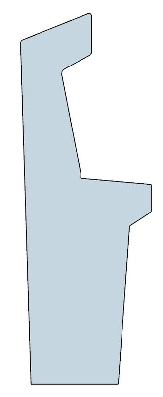

The design I'm going with is a two-player slim hybrid based off others I've seen here. It will house a 32" 1080P TCL TV which I've recently acquired and a PC that I've already built from the ground up that will play Mame and Steam Fighting games. From a construction standpoint, I'm not incredibly talented as woodworking is concerned but I do have a couple of friends who are helping and have more experience in that area. Where I excel is in the tech part, so I'm going to have fun setting up LED lighting and the controls and stuff like that. Thankfully I've got access to all the tools for free and I'm even getting the artwork printed by a friend for just a case of beer, so this will be a relatively cheap build. Oh, I'm also planning on completing it by Xmas eve :) Pretty sure I'll have lots of questions!
Here's the Sketchup design so far:

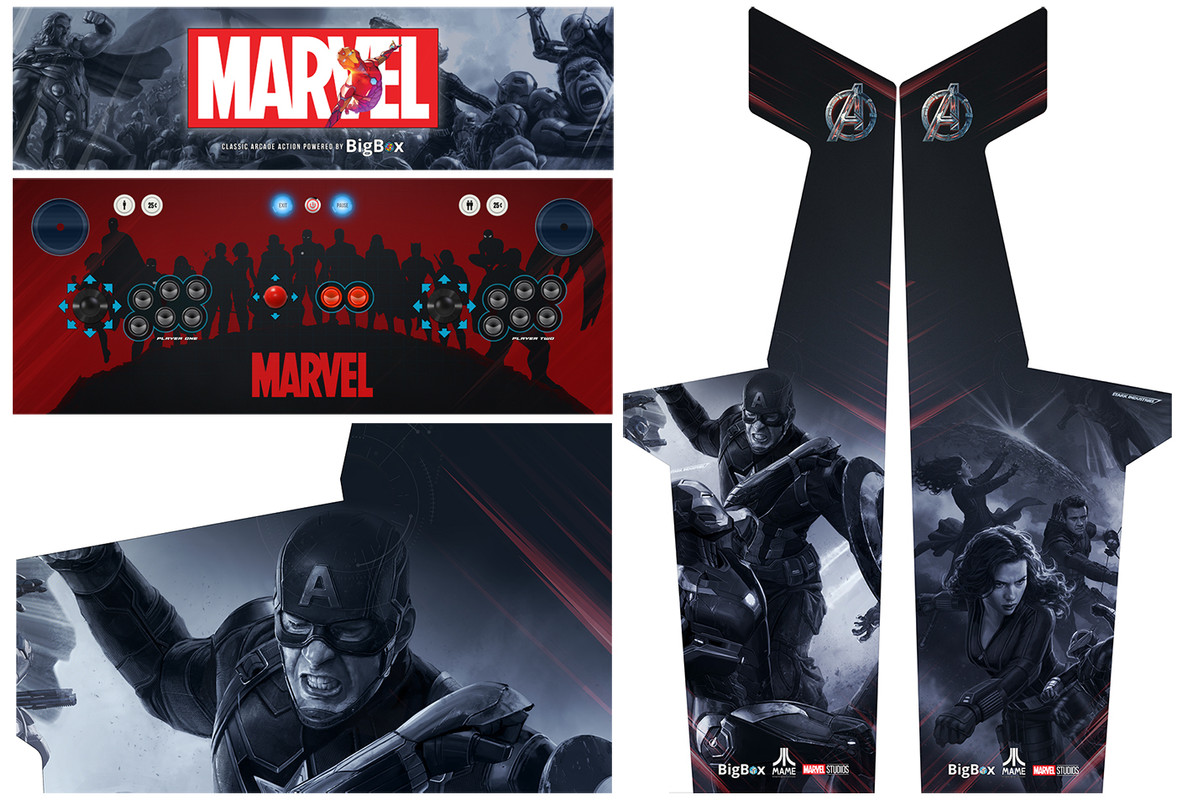

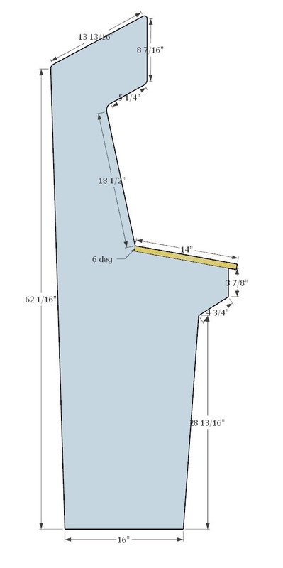

Take the advertising logos off of the artwork. It will look better. It is an arcade cab, not a NASCAR.
The cup holders are a bad idea. Just place a stand near the cab for drinks. Somebody will spill a beer all over that CP when they miss the cup holder.
I generally like arcade themed artwork, but this is much better than a jumbled collage that many people default to.
You could shorten up that 14 inches a bit to make the cab proportions look a little better.
Thanks for the feedback. Yeah I was worried about the cup holders and spills getting into the electronics. I've seen holders on the sides but thought they looked ugly. Wife didn't want a table next to it to put the beers on, hence why I built them in. Also that increased the CP size. I'll go back to the drawing board on that.. :)

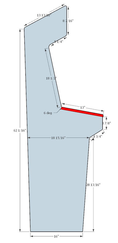

« Reply #4 on: December 06, 2019, 10:24:19 am »
Updated design and artwork based on Mike's suggestions.
Re: Scratch slim build 32" Mame Marvel theme
« Reply #5 on: December 06, 2019, 10:54:38 am »
Much better!

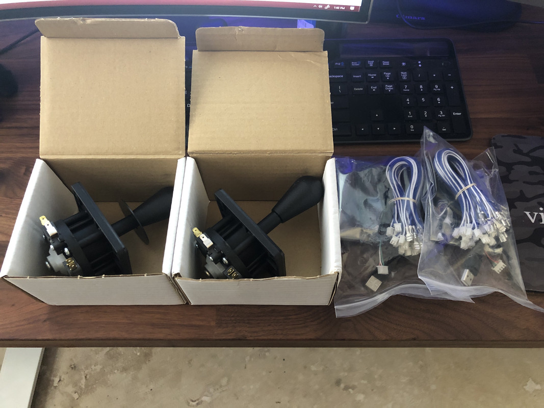

First Fedex delivery. Two Eurosticks and two Zero Delay boards. Starting to feel like Xmas already :)

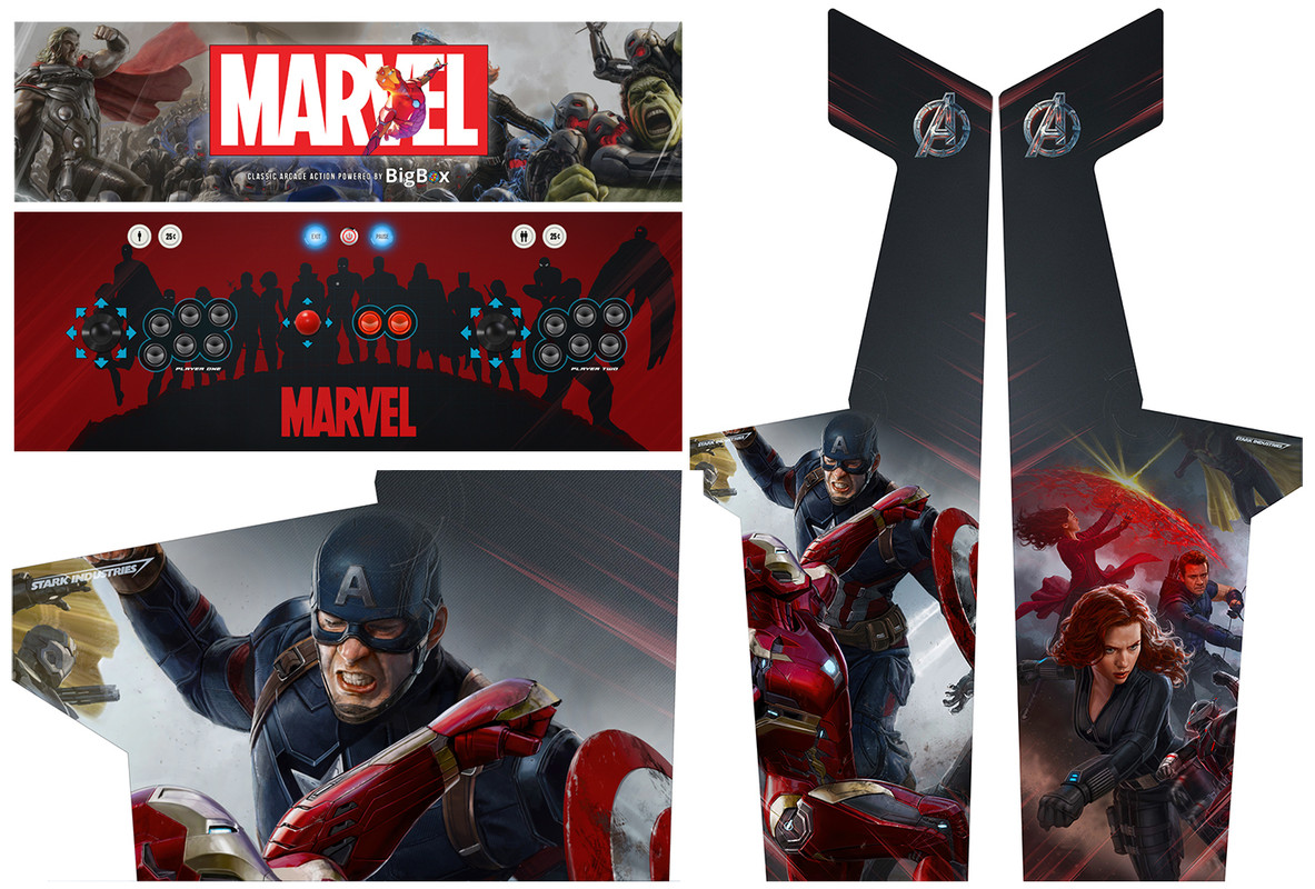

Mike read my mind.  The new design looks much better.
Although... about the artwork... I like the theme because Marvel stuff is cool and even arcade related but it seems like it should be a little more colorful.  I would not use movie art when there are so many cool comic designs out there.  Maybe it's just me.  I do like it but I think you can do better.
The side profile looks really nice.
Christmas Eve is super ambitious (*insert joke here how it take me forever to do anything*) and I'm definitely going to follow this thread.  Good luck!

Thanks! Yeah, I went back and forth on the design and whether to use the original colored images or more monochrome so we had a family vote and everyone liked the monochrome version. I think the more colors the busier it looks and I was trying to find a balance that looked cool while not too overpowering. This will be going in my main living room where it's got very minimal decor (aside from a big pool table in the middle). I'm still playing around with it though and will likely be tweaking until the last moment. I also did look at a lot of comic art but when you start narrowing it down to high res images it wasn't leaving a lot to choose from.
Here's how the sides look in color. I'm of course open to opinions if you think it's better. I'm also trying to get the model and images into a 3D modeling program but it's a bit of a learning curve for me. I'm hoping that a nice 3d render will help me finalize the design.
I'm basically on vacation for 2 weeks and was going to work on it every day, but agreed Xmas eve is a little ambitious lol.

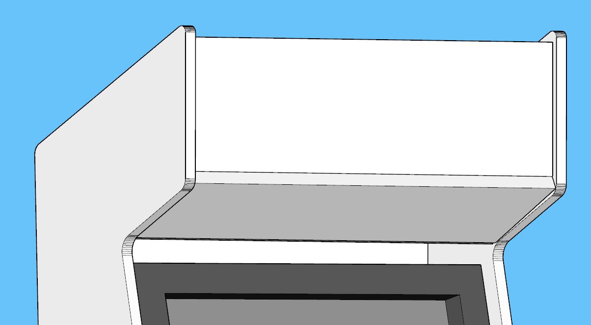

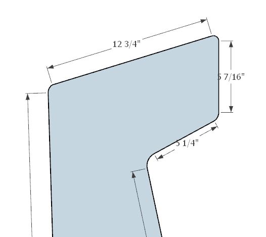

Trying to dial in the cab dimensions. While I was trying to get the Sketchup plan into more of a 3D model it struck me how big the marquee was and it looked a little odd to me. I'm wondering if a smaller (shorter) marquee would better?
5 1/2" Marquee:
How it currently looks in 3D at 8 1/2":
  • Posts: 5920
« Reply #11 on: December 07, 2019, 09:58:22 am »
That is one of the problems with a slim design. All of the other elements look out of scale.
You will just have to size the marquee for what looks right to you.

« Reply #12 on: December 08, 2019, 05:42:59 pm »
I haven't locked in my control panel yet, so far my options are:
1/2" MDF with 1/4" Plexi.
5/8" MDF with 1/8" Plexi.
3/4" MDF with Polycarbonate Laminate graphics.
Looks like my guy can print polycarbonate so that looks like the easiest option but I do like the look of the plexi though. Any opinions on this?
Final design and a rough stab at planning out the pieces for each cut. Did I miss anything? (note decided to go with 3/4" MDF for the CP and use Polycarbinate)
I've got a ton of packages arriving tomorrow, will post pics. I'm picking up the wood and hardware on Friday and through then I'll be prepping the workspace and making sure I have all the tools ready, not to mention reading back through all the build posts here as research. If all goes to plan, I'll be cutting the sides on Saturday morning! I can't wait!!
« Last Edit: December 09, 2019, 04:28:28 pm by mrl72 »

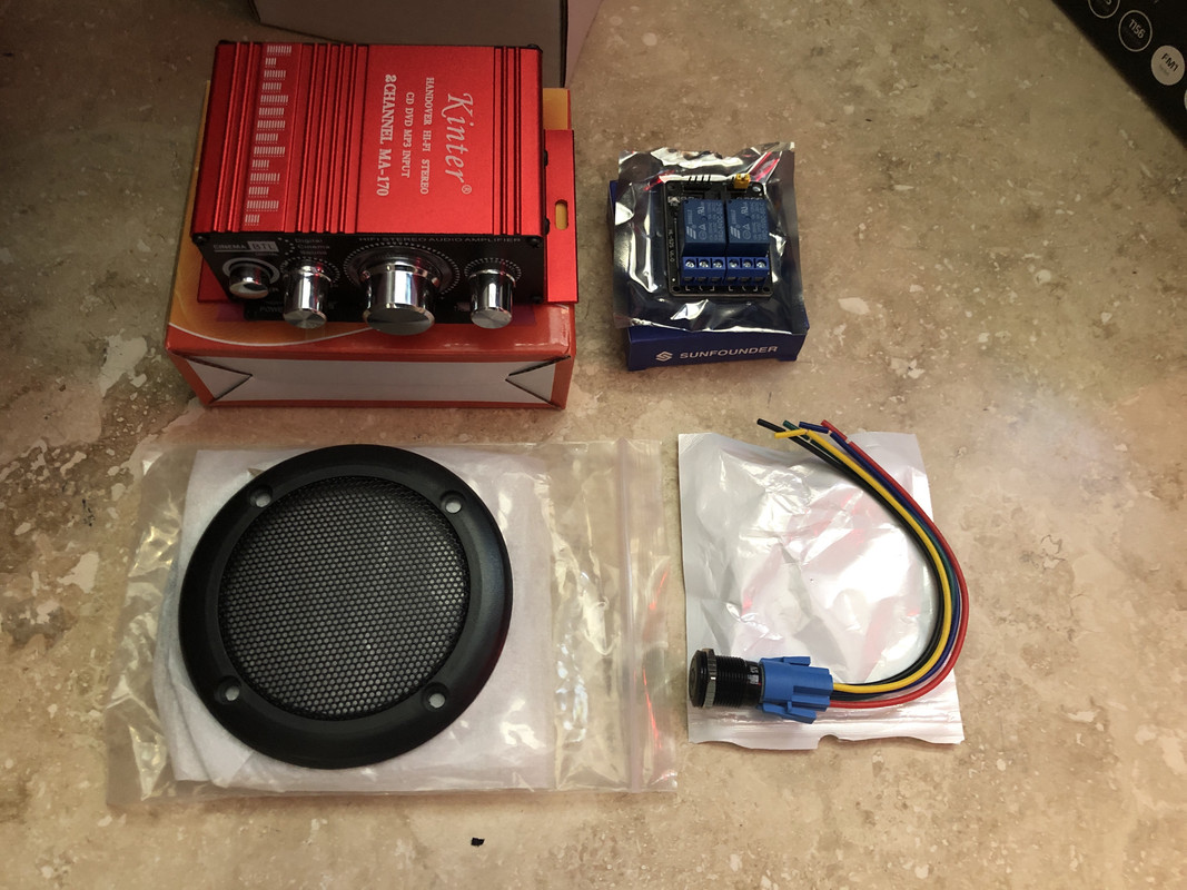

First delivery of the day:
Mini speaker amp.
Speaker grills.
2 channel relay
Power button.
The 2 channel relay will be connected to a Pi3 which will turn on the TV and cabinet LED lights when the power button is pressed. The Rpi3 will then send a WOL signal to the PC to wake it up. At least that's the plan :)

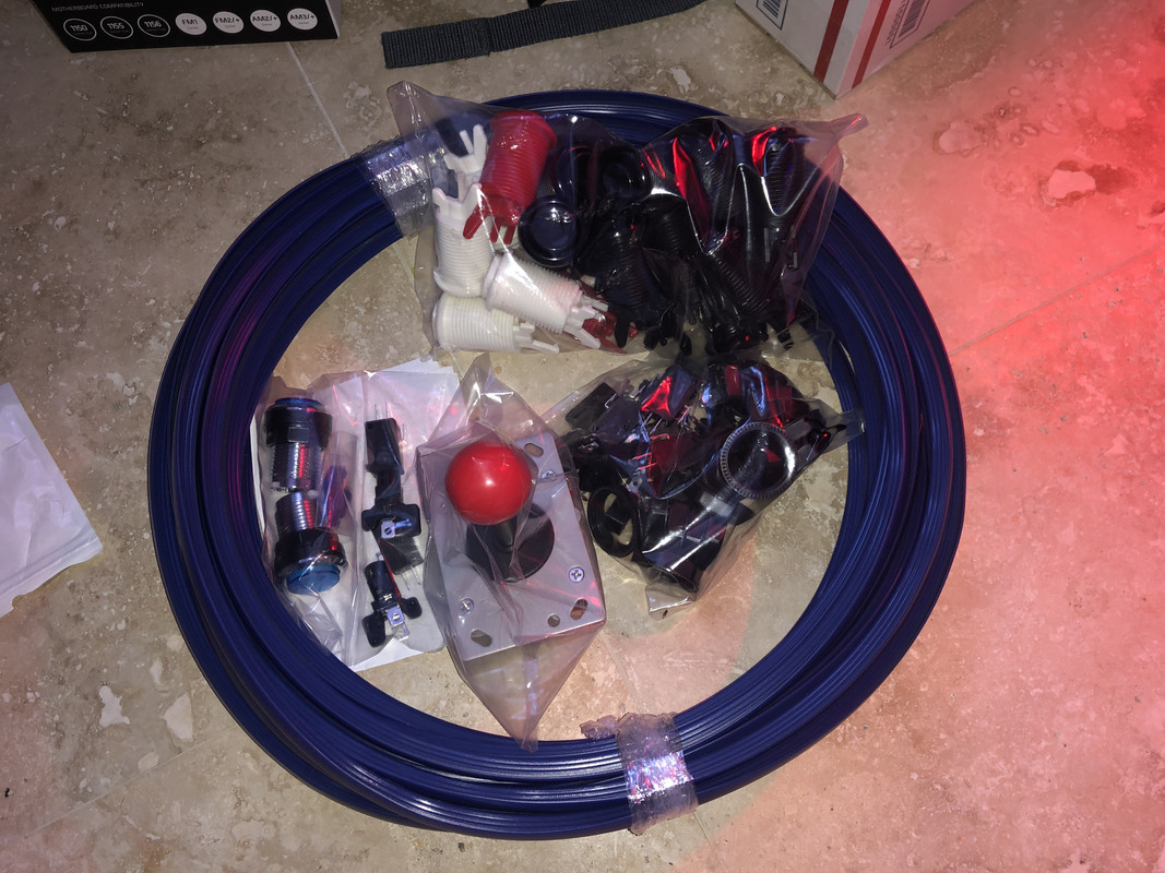

Second delivery from GGG:
A whole bunch of buttons and microswitches.
40ft t-molding in deep space blue.
Zippy joystick.
« Last Edit: December 09, 2019, 05:22:38 pm by mrl72 »

Fixed the CP angle which is now at 5deg.

On the CP - I mocked one up in particle board, tried two different layouts and set it at the height and angle from my design on the bench (with monitor ) and used it that way for a few days on/off..  It helped me decide on what I liked.
FWIW:  mine is 5 deg and feels comfortable to use for long periods of time.

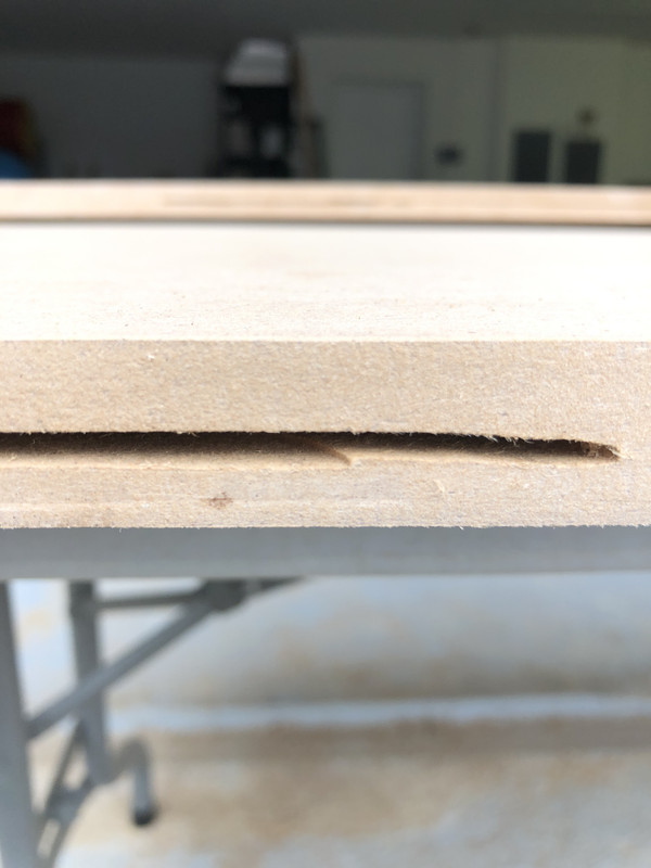

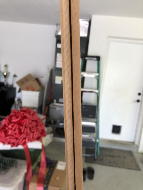

So my wife dragged me car shopping since Sunday so I didn't get much done. I did get the sides cut, although I changed the design quite a bit from my original plan as I didn't like it!
I got one side routed fine.
But I started on the second side and after I did the back fine when I moved to the front I'm now getting this. Anyone know what is causing this? I'm holding off doing anything more until I can find an answer.

« Reply #35 on: December 18, 2019, 10:30:22 am »
Are you keeping the router flat?
mrl72
  • Posts: 32
  • Last login:May 10, 2020, 04:26:57 pm
« Reply #36 on: December 18, 2019, 10:36:43 am »
Yeah. First side was perfect and I was just using it the same way on the 2nd side. I think it must be this bit as I noticed on the 2nd side it wasn't gliding as smooth. Cheap bit perhaps? Looks warped to me.
  • Posts: 5920
« Reply #37 on: December 18, 2019, 10:40:09 am »
Those cheap bits made out of Chinesium are not only garbage, they are dangerous.
  • Posts: 5920
« Reply #38 on: December 18, 2019, 10:45:18 am »
What is the outer diameter of the cutter? You need to slow down your router RPMs with larger diameter bits. It is especially important with low quality bits.

Most people just buy a router and never touch the speed control.

Thanks. This old router I have doesn't have a speed control on it. The RPM's are 22,000.
This is the make/model of the bit I got. Looks like the diameter is 9/16":
I've filled it with bondo for now and put it aside until I can get a better/new bit for it.

It seems odd to bend that bit like that. A half inch shank is pretty sturdy. Without watching you I can't be sure what is going on.
  • Posts: 5920
« Reply #42 on: December 18, 2019, 11:05:18 am »
I read some Yonico reviews.
It seems that wobble is a problem with them.
"Well, I machined the stock for some doors today using this set, but I decided to try to sort the wobble out first.
It turns out that the cause of the problem is the nuts used to hold the cutters onto the spindle. The spindle itself has a metric M8 thread, which surprised me for an American brand.
The nuts which are used are really badly made, as you can see below:
This resulted in the nut not clamping the cutter evenly, causing the wobble. Replacing the supplied nuts on both cutters with standard M8 nuts solved the problem."

Ah crap, that's not good. Thanks for finding that. Can you suggest another brand? I can't seem to find anything at the local hardware stores.

If you push the bit ALL THE WAY into the collet, the bit will not tighten properly even though you think it is..
It needs to be backed out so that it is only in the *fingers* part of the collet and not into the solid part at the bottom.
From the pic - the bit looks burned up..  I'd recommend a Whiteside slot cutter..
Finally - you may have tilted it a bit..  If you add a large secondary base to the router - it is much easier to manage on edges
HTH

The man speaks truth. Get a Whiteside cutter.  They are the only bits I buy anymore.
I got tired of bad cuts, worn bearings, and shattering bits.

Thanks both. I just ordered one online.

Are you sure the cutter isn't installed upside down?  It will still cut but not as easily as if it was properly installed and could move out of alignment.  A slot cutter should go through MDF like a hot knife through butter.  Almost no resistance whatsoever.

No clue, I’m figuring most of this out as I go along lol. The first side was exactly like cutting through butter, only when I moved to the 2nd side it started slowing down as if it was blunt. Then I noticed the slot was a lot wider in comparison.

cutters cut in one direction..  So if you cut counterclockwise around the part (assuming that is correct in your case) -  then go clockwise on the second side - your cutting backwards on the second side
make sense?

Excellent point.  The blade needs to spin in the right direction (eating into the piece) and then you must also move the router from one side of the piece to the other in that direction.  You should be able to feel the difference.
