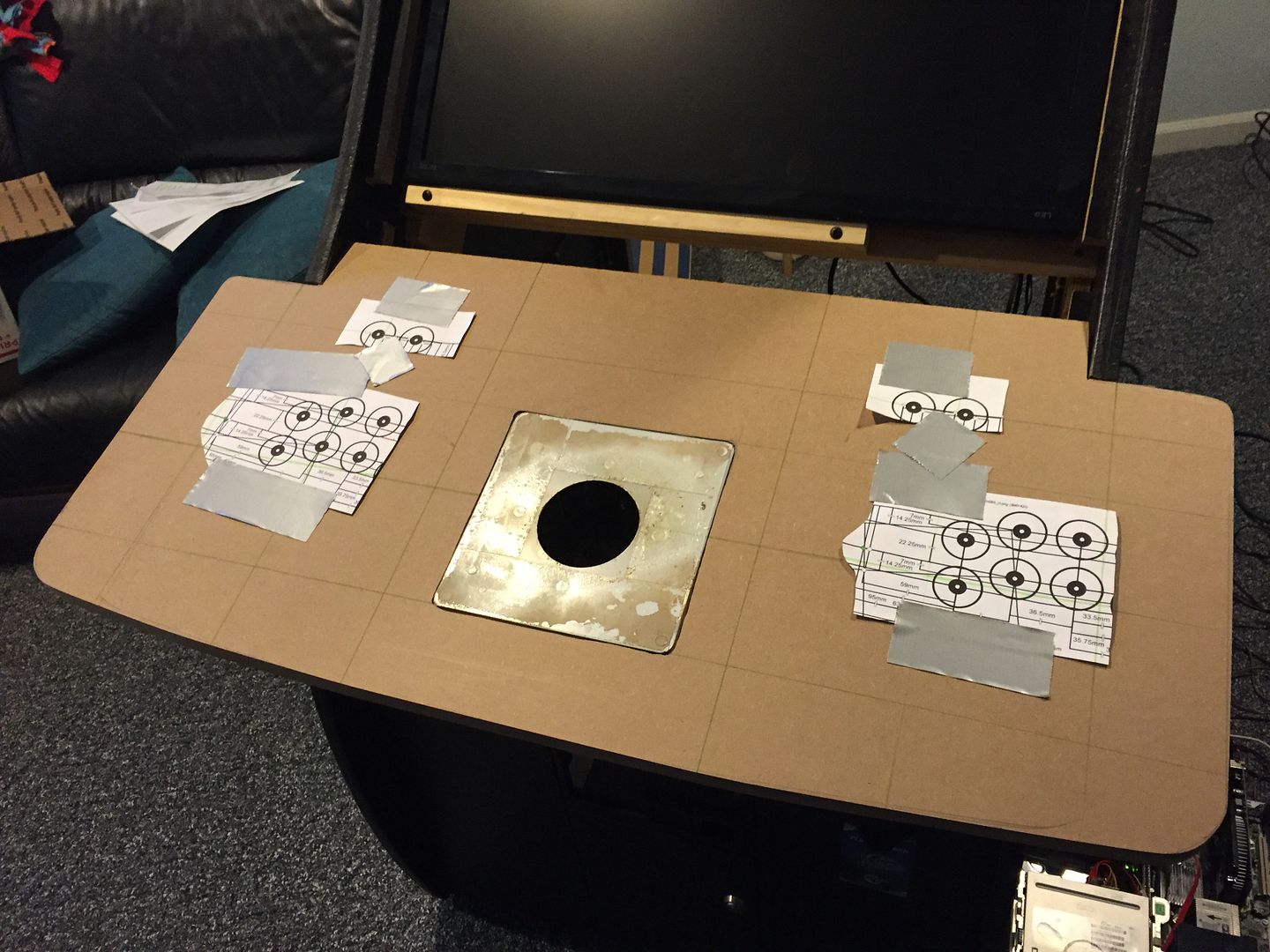

I know it seems picky, but to play Missile Command for an extended session I need the buttons farther from the trackball than what I could get with keeping the original panel as is.  My only other choice is to offset the trackball to the right of center and have a single joystick.
I'd rather compromise the total width than take the track ball more off center. Priority one and two are equal, and that is golf games and MC.
Here's an original panel so you can see the distance between trackball and buttons.

I have waffled about the CP design for days. I really tried to keep the original size, but 27" (inside dimension) just wasn't enough in my opinion to get an un-cramped trackball and two joys with six buttons without hurting the original feel of either Missile Command or golf games.
I thought about a 4 button layout, but I really like having the two mouse buttons on joy1b6 and joy2b6. With a trackball, navigating Windows is SOOOO easy, I just couldn't give it up.
I decided on a compromise; to shrink my first layout by 2 inches and add a small relief area on the sides of the cab under the CP top where the outboard buttons and joystick will need clearance. That takes the top panel from 30" to 35", so 2 1/2" on a side larger.
I cut a new top from 3/4" MDF (and a plastic topper while I was at it) that follows the contour of the original panel and I think it doesn't look too bulky.
I got as far as recessing in the trackball plate last night. I'll get the buttons and sticks in today and see just how much I'll need to modify the cab sides.
